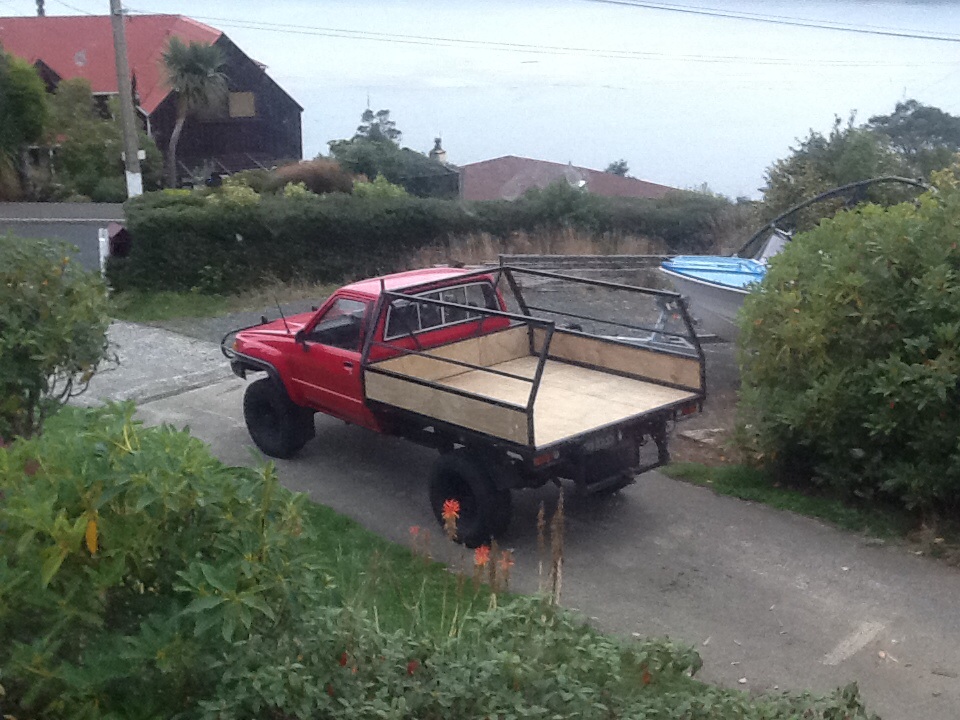

I have this tidy ole truck that I really enjoy. Has no rust no dents not even many scratches. As of recent I have installed a new deck, new radiator, new water pump, new hoses, new dizzy and plugs and have purchased a power steering unit to install.
The problem is I have just cracked the head I suspect.
Compression 140.150.150.210, white steam from exhaust, coolant blowing into resivour.
