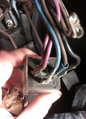

hope someone can help me, i bought a niva 2121 project.
i found that the flasher didn’t work when i used the signal arm or the distress contact, so my repair manual says change flasher relay, so i bought a new one, and here is my problem, my new one don’t look like the old on.
the old one has 3+1 terminals called X,P and L
and my new one has 5 terminals called C, C2, 31, 49 and 49a.
I’ve looked at the cars circuit diagram and i can’t figure out what goes where.

thanks, so just so o get this right, some of the five cables i got i my niva goes to the same pin?
It would be great if some could upload at picture of a flasher relay installed in a Niva.
I just think it's wierd that the wiring diagram shows 5 different wire go in to the relay 5 different places

thank for all the answers.
I'm pretty sure it's the right relay i bought, it allso looks right compared to the wiring diagram for that car model.
That plug your all talking about, has been removed by a previous owner, to fit the relay in the picture.
I've tryed connecting the new relay in diffenrent way with no luck, so now i'm thinking that it could be something else.
But i would still like if some one could take a picture of how the wires are connected to the relay, so i can be sure it's corect connected

I would ignore the wiring diagram and copy what is already there...
Try another 3 pin.....
Reading thru some of the niva forums... the 4 or 5 pin relays can be swapped for a 3 pin
Google is your friend

No not yet, but when i get it working i will let you know
But i'm beginning to think the i could be a bad ground connection or a erroded plug somewhere, my niva had stood still for about 7 years before i bought it, so it could be many thinks

i Finally firgured it out with some help
its was 3 different things:
1. the wrong breaker relay
2 there hvis a +wire missing on the relay
3 there was bad connections in the circuitbreaker panel.
but after sorting theres ting out i Finally got all the lights working
