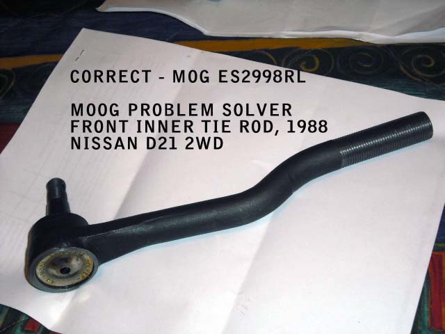

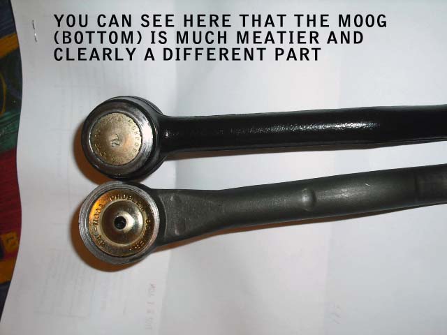

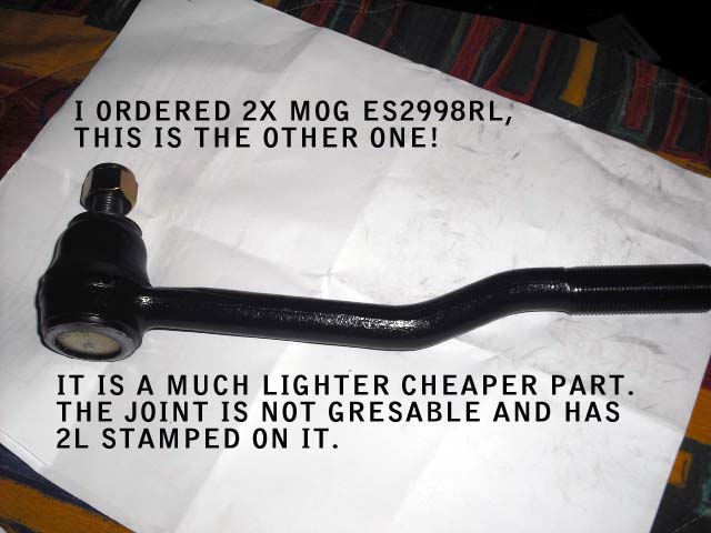

I got Moog TREs for the swap recently while in the US. The Moog 'Problem Solver' item is almost twice as heavy as a stock generic item. Its also 2-3mm thicker and has a 'patented design' wank wank balljoint pressed into it. I ordered 2x moog TREs and 2x cheapies as backup/comparison. They screwed up my order but got the right parts in the end. I also managed to get a Moog 2wd centerlink which I stuffed in my luggage.
Attached is pics with some part numbers.
I paid 27usd each for the Moog 2wd inners through rockauto.com, I had them shipped domestically but I am pretty sure rockauto do international shipping.
Also, alot of Moog and 555 parts are interchangeable/the same. If it says 555 or Moog on it, its the same heavy duty shit.
