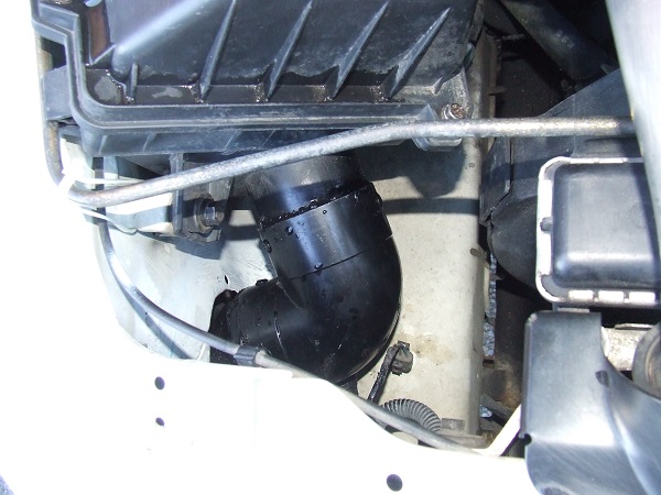

Postby Korando29 » Thu Jul 11, 2013 7:15 pm
After market snorkel imported and fitted - had to settle for fiberglass. Fitted by 4wd Upgrades in Chch. Something different! Getting a new bash plate made shortly - original one is hopeless. For interest sake standard ground clearance is 215mm from rear diff.

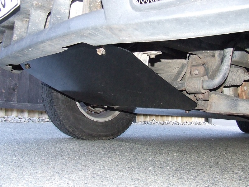

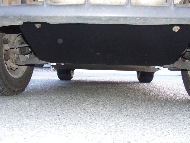

Postby Korando29 » Sat Aug 24, 2013 8:41 pm
Got rid of the original bash plate - too much ventilated and was worried about sharp things getting through! Replaced with one piece 3mm mild steel and taken back to the front drive shaft, 6 bolts though bit concerned about two bolt heads that may get the bash! Maintains front lowest point 215mm ground clearance, middle cross member 220mm. Goes okay up the Wilberforce Valley so far.

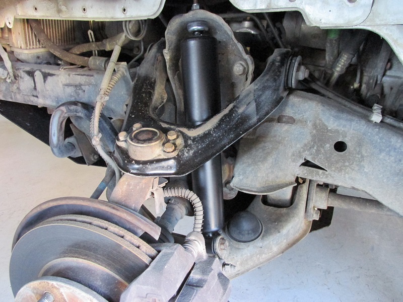

Postby Korando29 » Tue Jan 28, 2014 4:52 pm
Replaced the original front shocks due to too much bounce, with Monroe Adventures. Went for a drive, heaps more control in the rough and better cornering at speed on the highway.
