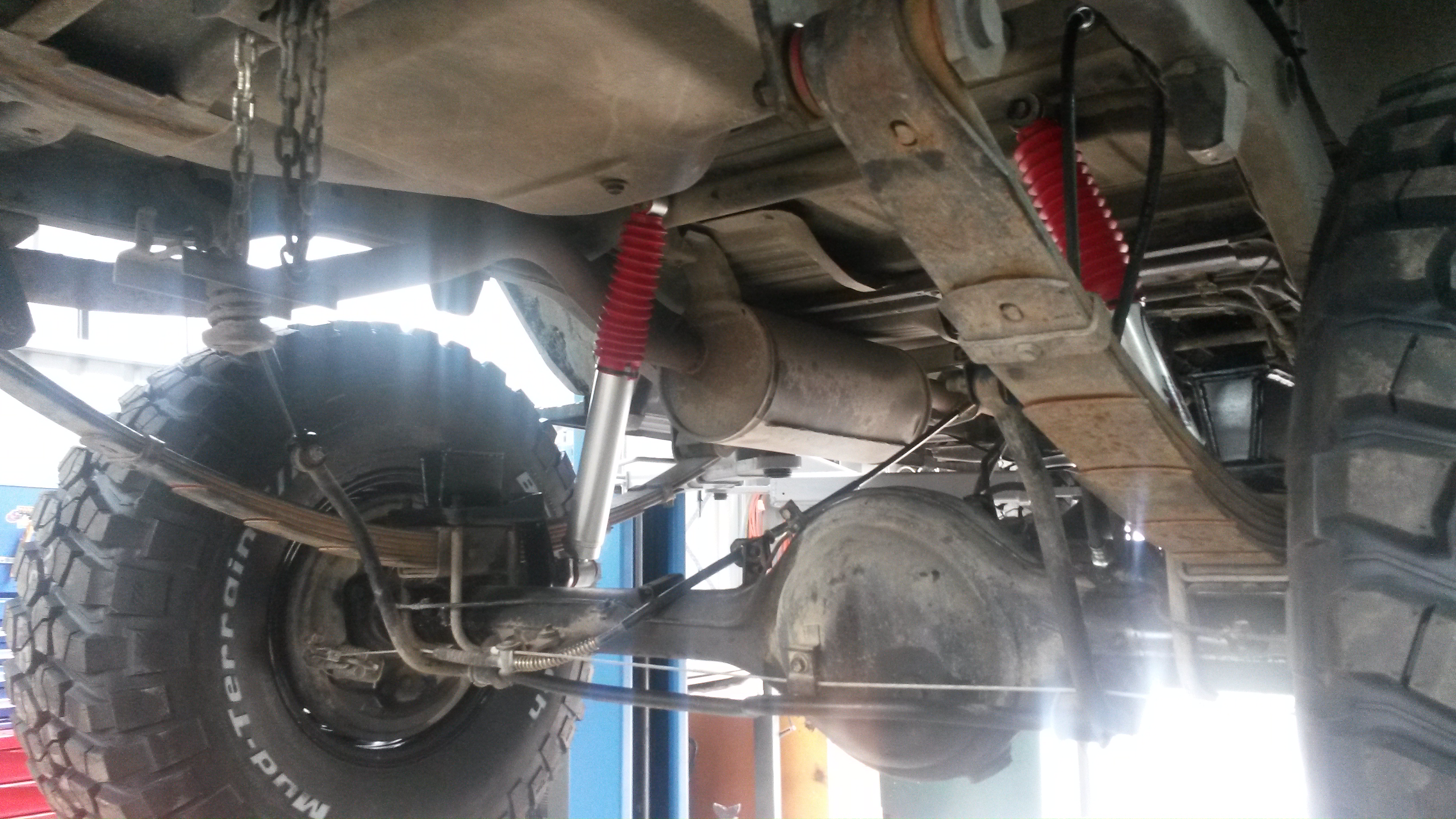

Heres a 60 series ive just finished a soa on.
