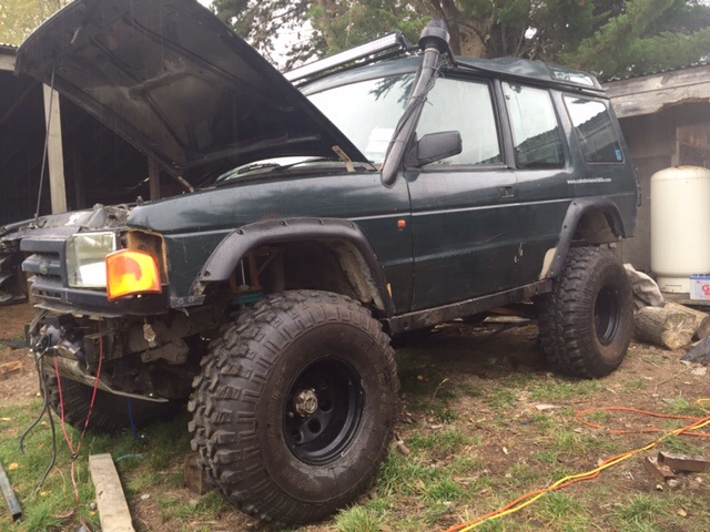

Started building side bars these will go over top of flares and mould into the side steps.

Playing round with mounting positions, will make all the side bars removable.

More photos to come.Trimmed up rear guards.Had to remove front solid flares and remount them back a bit to give more clearance. Front bar has been charged. Almost finished the bar work.

Hopefully it will be out of the shed soon, looking forward to having a clean up and getting some space back.
Have moved all the winch backwards, rear diff is now in, front pretty much in.Fitted new front springs.

Bit of an up date, I am hoping to have it out of the shed on Sunday so will take some better photos.
Just waiting on diff heads then I can start putting back together.
Have fitted 30mm wheel spacers now, this thing is wide and looks staunch

front finished, just have spot lights to mount

After some bloody late nights we got to the coast. I am really pleased with the way it's come out, gearing seems to be perfect and the big boosted 200tdi doesn't seem to be lacking in snot. Will lift rear another inch and era place front shocks.One of the issues I found were the brakes seem hard, almost like when your being towed you dont have much of a peddle, would this indicate a vacuum leak of some kind?There are afew other wee bits that need sorting but will do later

Bit of an up date, have done a couple of trips in it now but has been parked up for the last 2 months due to transfer case issue and not having any time to tinker with anything. Xmas is coming so perfect time to get some stuff done.
Once I had gear in the back it was sagging a lot , I have now fitted a pair of lifted 4" lifted 80 front springs in the back, time will tell if these flex like I want... I have my doubts but hey will see.
The front doesn't really flex so I am going to remove and only run one set of shocks in the front and will be fitting Superior Engineering Superflex arms.
Will be fitting a set of beadlock rims
Sorting a stereo
Fixing oil leaks
Getting some new battery's
Look into fitting rear mounted winch, I think I have room.

cheers man. Truck has been out of action for 6months now, split with the wife so its now time to get back into working on it. Iv used factory safari arms in the front which have been moved forward slightly. Transfer case has been causing me afew issues and i was to lazy to pull out and rebuild so thanks to Jase ( ClassicCruiserSpares) he has tracked me down another one. These are from a v8 110 Defender and i believe these are as rare as rocking horse shit... Im running 4.1 diffs and the 36s, seems to have enough power at this stage. Flying out to aussy in an hour so will try and bring back a set of Superflex Arms on the plane.
will keep updates coming.

New rims, redoing front bar. Time to put everything back together

Got a wide stance now, fitted new rear springs to lift ass end up
