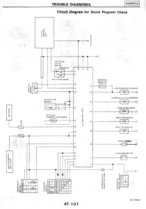

Just for reference, I'll add the TCU pinouts. Am thinking of utilizing the existing wiring.
Would be nice to have the option of full manual or normal. Possibly by relay shutting off the circuit for pins 28-(Power to TCU), and the circuits for pins 21, 22, 35, 36 and 7 and manually controlling these, pins 21, 22, 35, 36 and 7.
