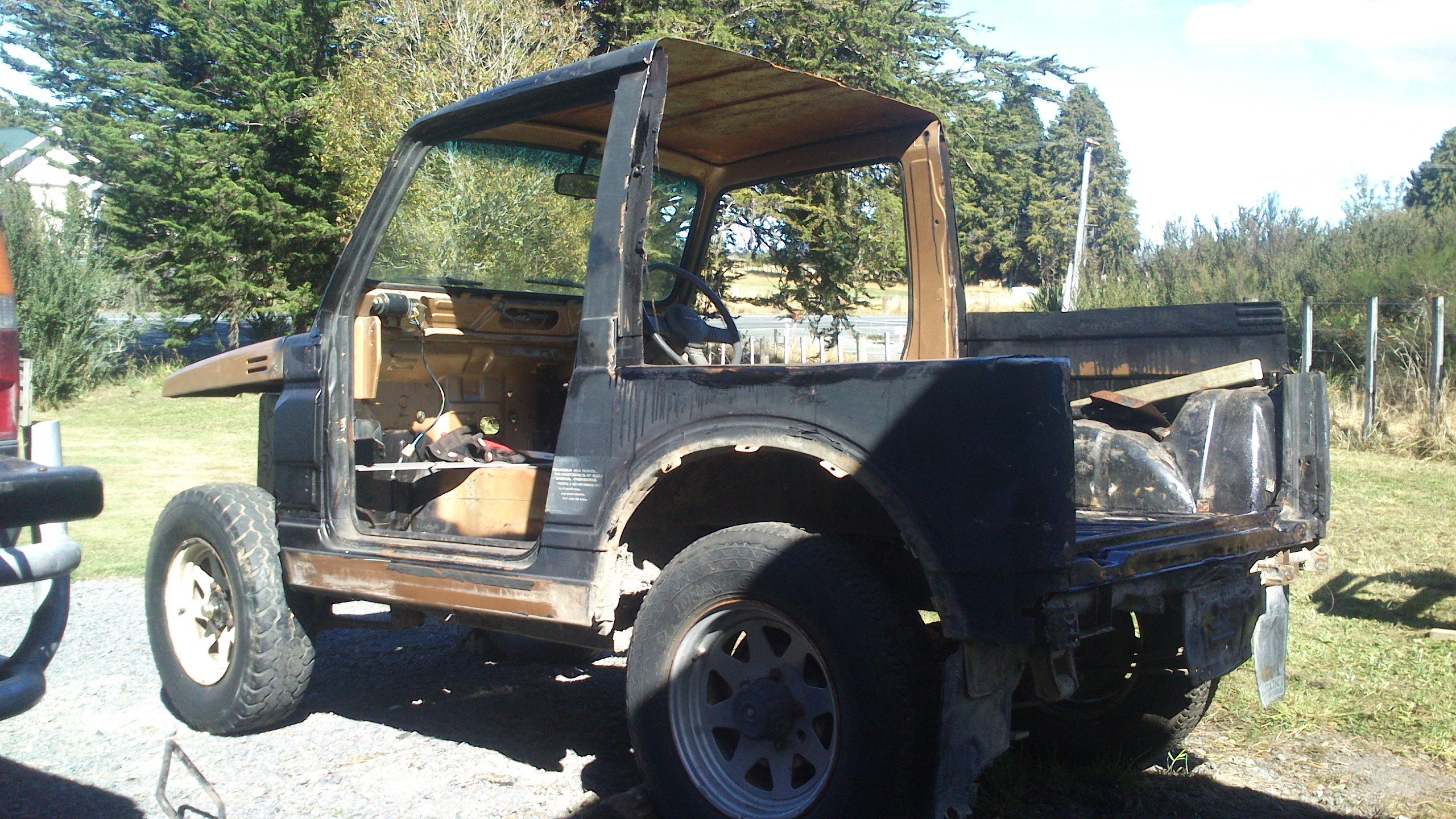

Well after a bit of a break from suzuki ownership and my daily hilux getting a bit baten up i decieded it was time for another project. A couple of months back picked up a 87 sj413 missing engine and box. Plans were for rear chop and 1.6 to 2L injected engine, basic coil setup and cage, winch etc. After getting stuck in chopping things up and fixing usual suzuki rust lost a bit of motivation and sat for a fair wile. Enter the next stage, a complete nissan silvia for a steal, Sr20de and manual gearbox and a nice fixed bucket seat. Soo one fine weekend out comes the engine curtosey of the neighbours tractor. Now to squeeze it in the zook, with new mounts and a bit of a body lift fits relativley nicely. Few more bits curtosey of the silvia and have hydraulic clutch all mounted up and working. Now plans are changing as they usually do. More power bigger wheels etc, the suzuki diffs aren't quite going to cut it, soo toyota enters the picture in the form of prado diffs, high pinion front and 4.88s. In between the buying car parts I picked up a 210 amp mig making progress come along alot faster. Enter this week, Time to give the diffs a freshen up and a bit more traction. Wekding the rear for now as its just a bush truck and off to the wreckers to find an lsd center for the front. Sold whats left of the silvia for wat i paid for it, more money for truck parts. Thats about where i'm up to for now, hopefully get the diffs back together this weekend weather dependant (no garage makes things harder). Will Try post Photos tomorrow

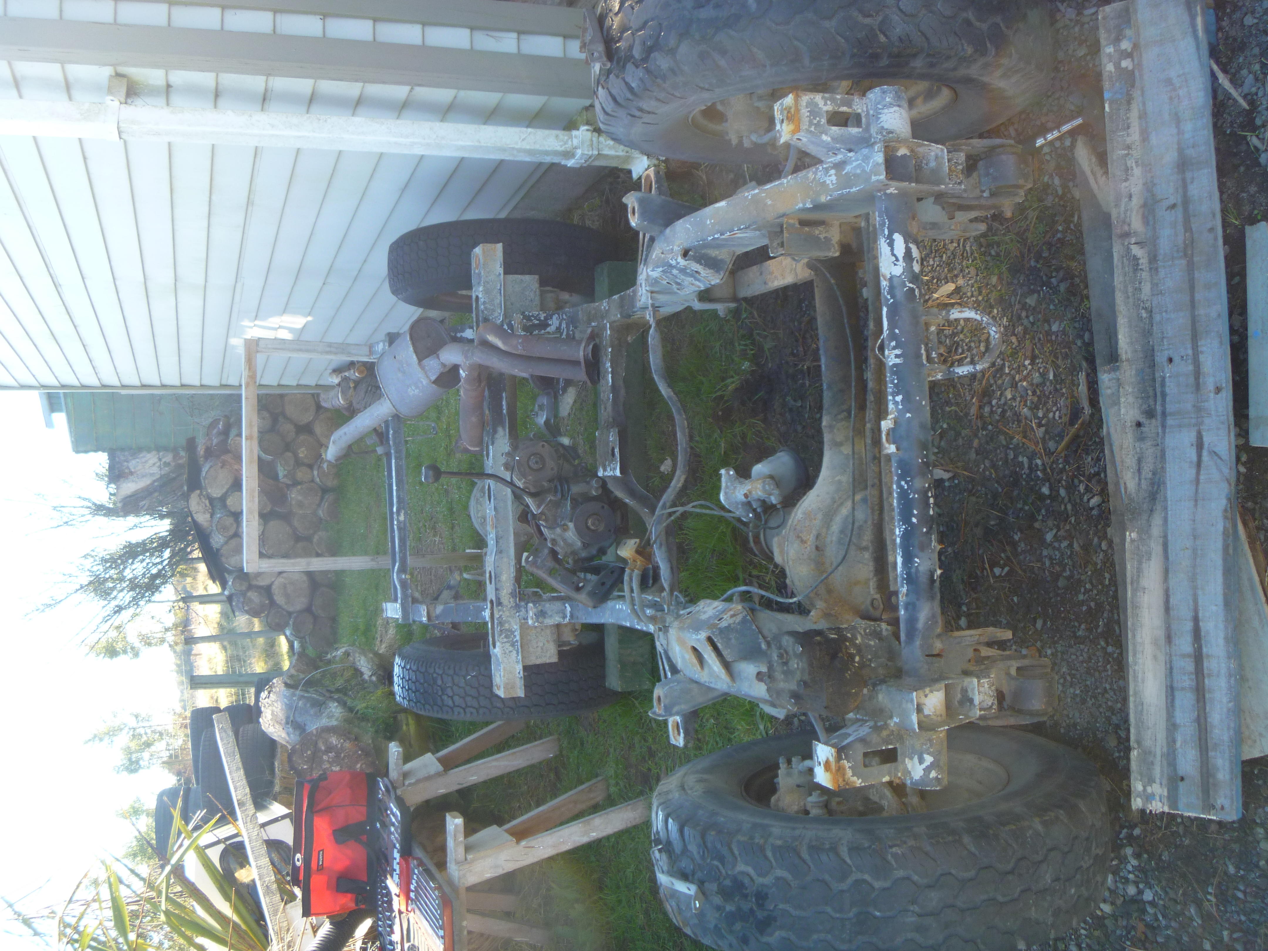

Few photos and a bit of an update. Picked up an LSD center for the front today and got the rear diff back together less brakes. Rear radius arms lined up with the original spring mounts so stuck the rear under just temporally, Will make proper mounts up further forward when time allows

Few more bits and pieces done. Prado diffs semi mounted, wheel base stretched about 400mm and rear gaurds cut to suit. Plan is for a copy of Dobbin engineerings X-Link on the front and trial a singal radius arm setup on the rear or triangulated 4 link if the radius arm setup doesnt work.

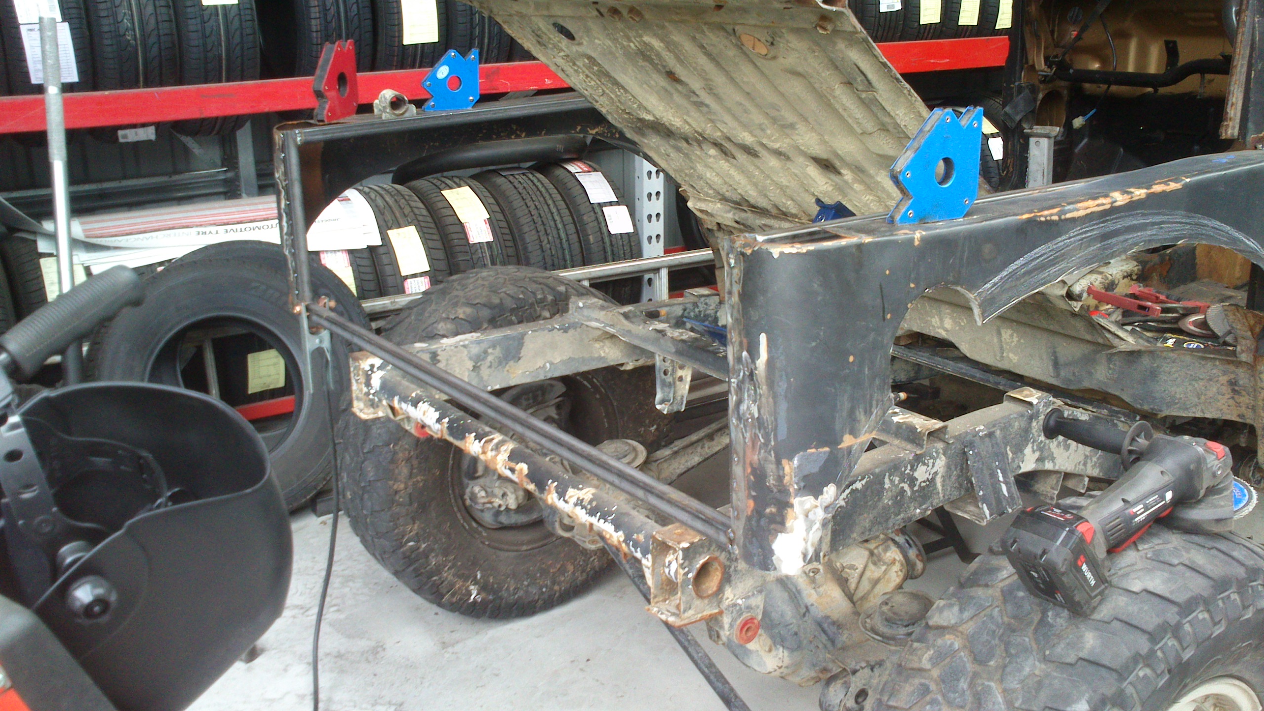

Well have been a bit slack in the way of updates. Have gone away from the radius arm setup and now running triangulated 4 link rear and planned three link or triangulated 4 link front, whatever has better clearance once i get the new custom sump fitted to the engine. Picked up a factory toyota locker for the rear, has been converted to air ram actuation, just need to change the c&p to 4.88. Rear diff all trussed and most of the mounts tacked on. Next step is make up the arms and test out the travel and make sure nothing binds. Will try get up photos asap

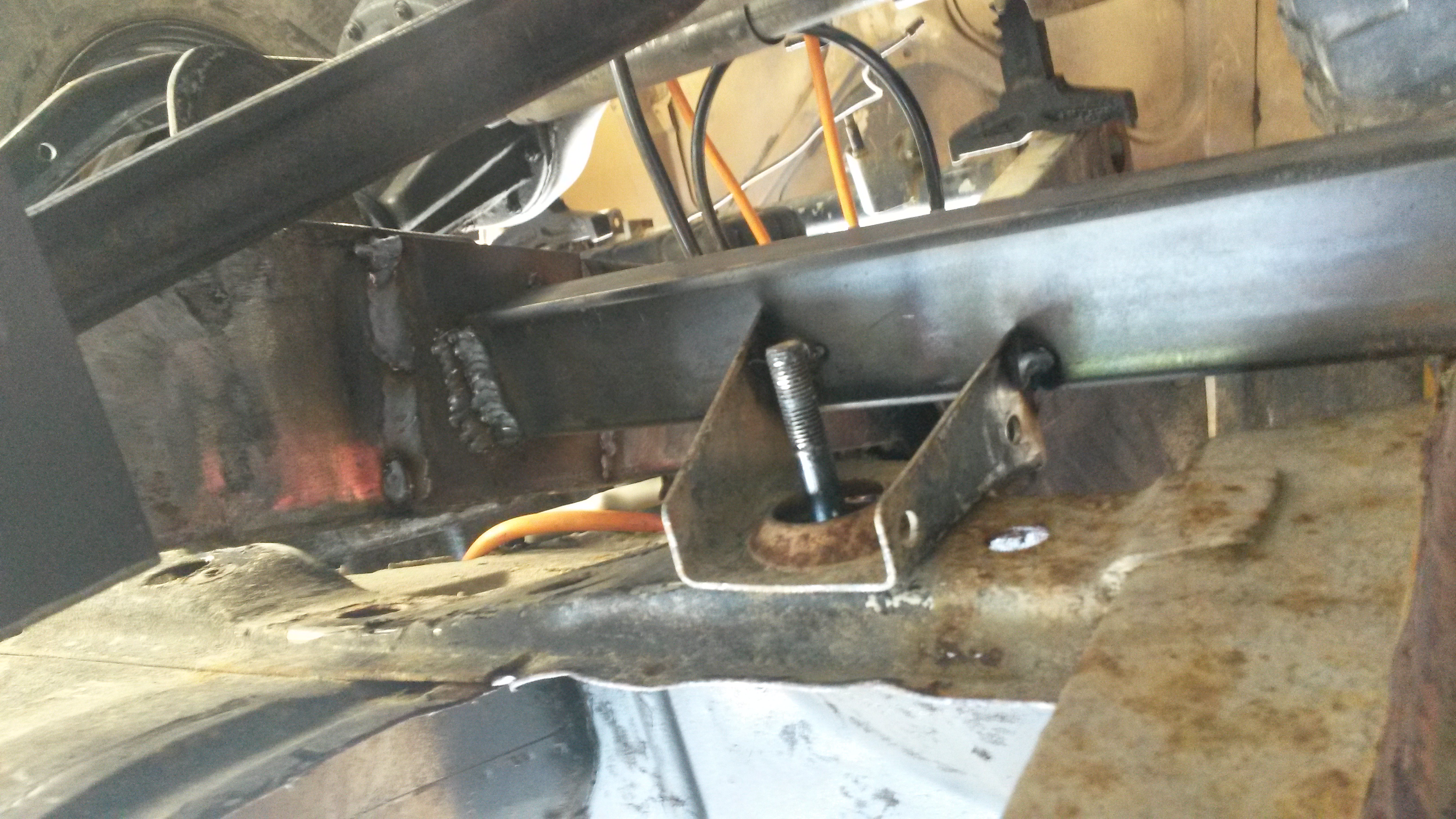

Those familiar with Sj zooks will know that the chassis rails flare out towards the back which did not work so well for the planned coilover mounting locations. Goodbye original xmembers and now the rails are parallel front to back. Didnt get much in the way of photos but new gbox xmember welded in and new rear done, will add more once transfer finds its new home

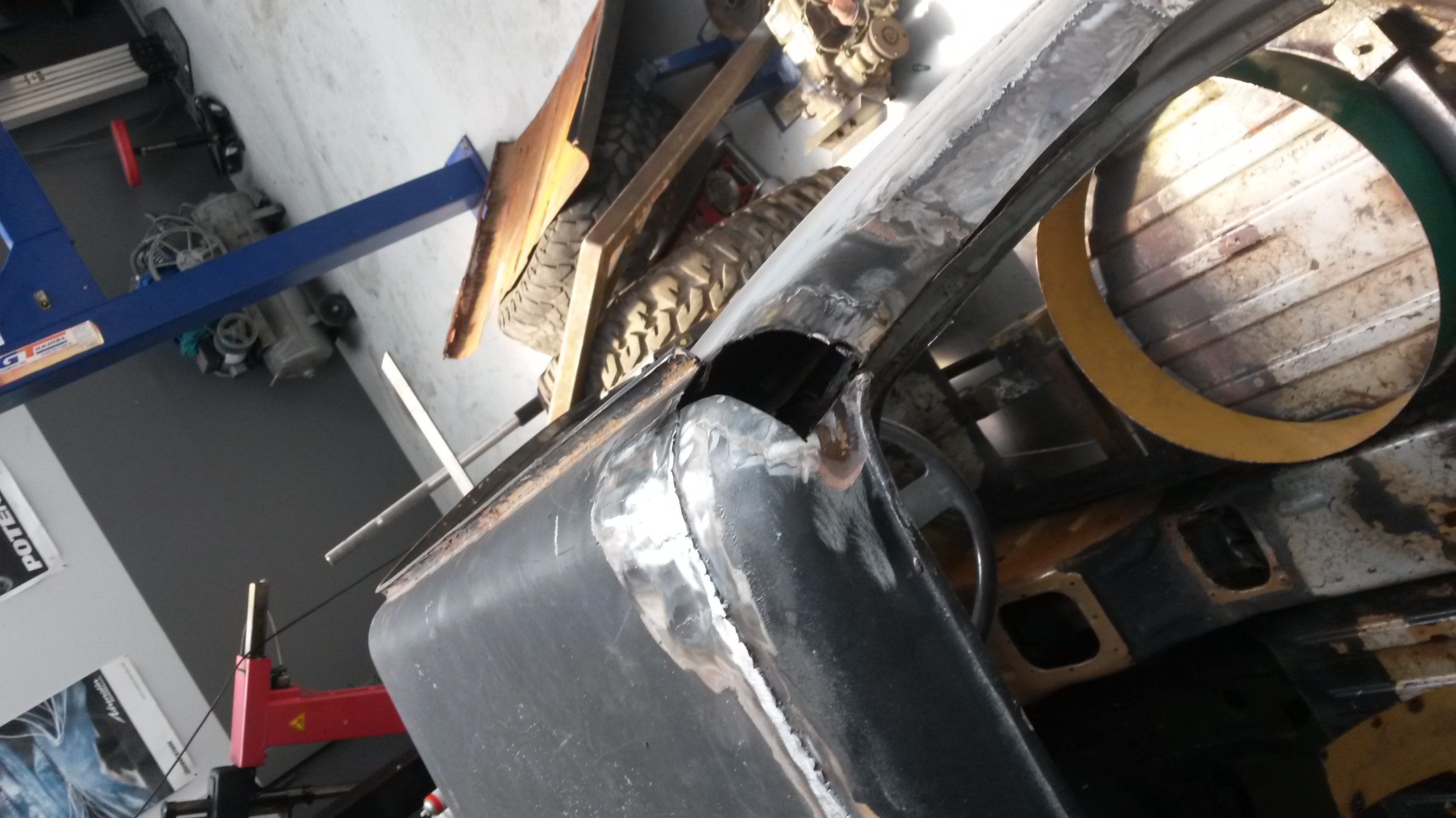

So having pushed the diff back rather a long way and running 37" tyres quite alot had to be cut out of the rear. Still want it to look like a zook so kept asmuch in the body as i could. Cut out rear wheel wells and lower section of c pillar. Remade the rear supports for fenders from light box section and cut gaurds to clear the massive rubber

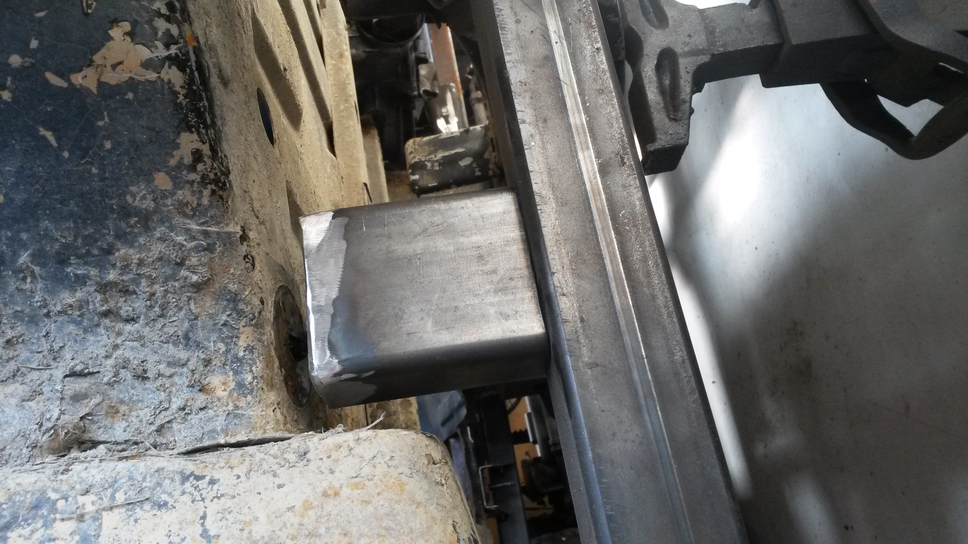

Got around to making the sliders, 50mm heavy wall, so shouldnt bent in a hurry. New body mounts in too so is finlly sitting right. New mounts gave approx 30mm body lift which was needed to clear gbox and engine without having to cut the tunnel and also allowing the transfer to be lifted up a bit for a flatter belly

Spent a bit of time getting some of the body work done. Cut out and patched afew rust holes and welded up the exterior join on the pillar, what a pain in the ass to weld. Still have afew body patches and floors to do aswell as the inner join on the pillar

Bought myself a new toy, 40a plasma cutter, works a treat cutting out suspension brackets and made cutting the old mounts off the diff a breeze. Decided to brace the rear housing and get to work on the 4 link mounts. Also had a package arrive from the states, 16 rod ends with missalignment spacers and weld bungs, all ready to make up the arms just need more tube
