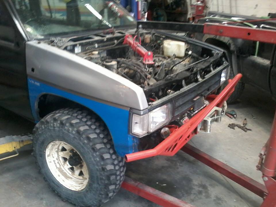

My front bar is now compelte...

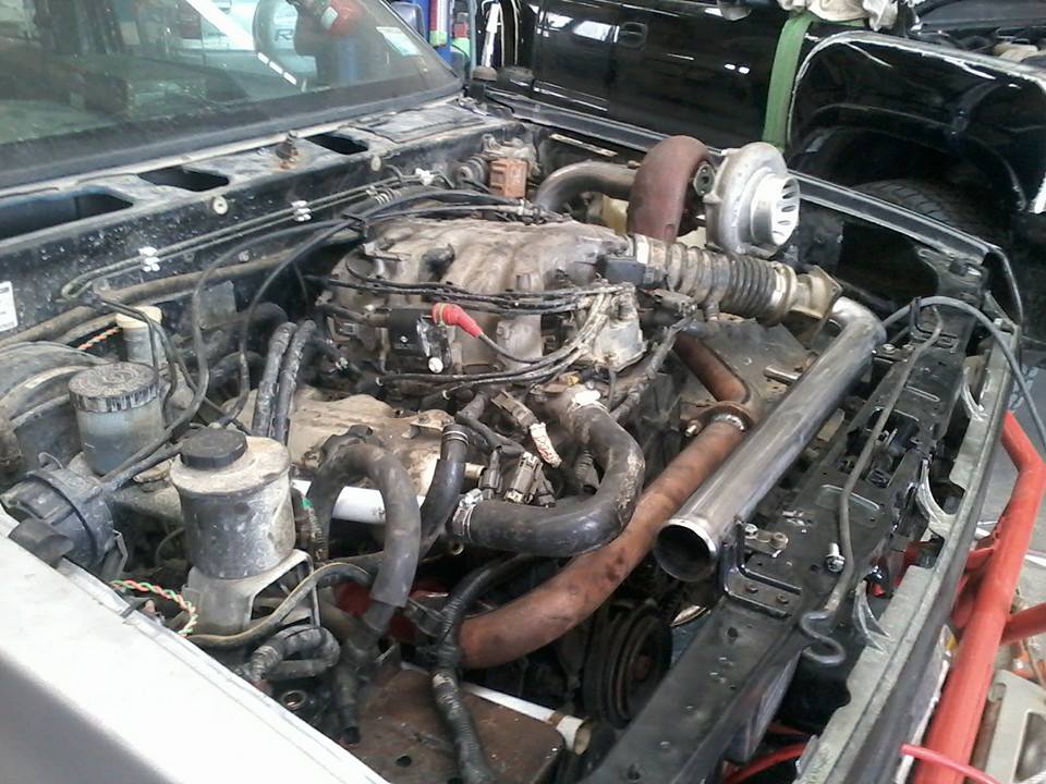

I've been running into issues with engine bay space. It may not be the most ideal setup, but i've got a nice little front mount intercooler now tucked in behind my winch, which is now set back a whole lot further. Because of this, I don't have room for my radiator. So i have now re-located the radiator to the back of the truck I will be removing the window on the side and replacing it with "lexan" sheet and a NACA duct to assist with the cooling. It has dual fans which are on separate circuits so that they can be run individually. I'm guessing it's probably going to turn the truck into a mobile sauna but i suppose we will soon see how it performs !

Here's a couple of photo's of how it's looking at the moment! I bought some new headlights and corner lights so it's starting to look pretty fresh!
And the intercooler setup so far...

You might need an expansion joint in the exhaust cross over pipe between the two banks, when the pipe heats up it expands and might force the two manifolds apart causing the blown gasket...
Re: 1994 Pathfinder Build
churchill wrote:You might need an expansion joint in the exhaust cross over pipe between the two banks, when the pipe heats up it expands and might force the two manifolds apart causing the blown gasket...
I can completely understand where you're coming from there! Just picking brains at the moment, but would it not be the same as the factory one then? Cause that doesn't have a flexy either?

Check this out, if this is the right manifold there is an expansion joint in the middle. scroll a little way down the page:
http://krasnoyarsk.baza.drom.ru/nissan-vg30det-kolektor-i-forsunki-12045535.html
according to calcs with a 600mm long pipe at 700 degrees the pipe lengthens by 5mm over room temp length.
