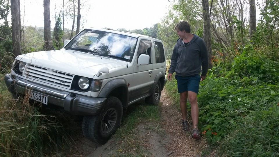

This had two wheels of the ground front left was just off the ground and rear right was about 20cm off the ground.

its not going to flex any more than it does now mate you can take the sway bar out to let the suspension move a bit freer and easier but you're limited by the design and amount of travel in the suspension linkage(s) changing the springs wont do anything to give it more flex it'll only change the ride height and spring rates etc, you need to get the arc welder out and do some serious redesigning of the suspension to get it to really flex up
Re: Pajero ideas.
Its a paj with a locked diff, if it doesn't get thru first go. Reverse up n do it again faster. It won't break easy.
My opinions with what you got especially with the diff lock, is all you need is a good set of muds and a winch and you couldn't ask for more realy.

i understand with the ifs that the fronts not gunna flex much at all but will removing the rear sway bar make that much difference in the rear i was quite a way off hitting bumpstops and my wheel lifted. maybe remove the rear sway bar and as longer shock as the spring could handle?

Its that trailing arm arrangement in the back that is kind of a PITA, the same as you would find in a coil sprung Land Rover.
Its uses a pin-type arm with a binding bushing that limits the potential wheel travel.
Dont just floor it to get through things fast, its bad practice and you'll break things.
Put a front locker in it and it will increase its offroad performance by about a million percent.

if you think the suspension isn't cycling through its maximum travel you could pop the shocks out and disconnect the sway bar and try and flex it up somewhere in the backyard to see if they are limiting travel but don't go getting big expectations just by the virtue of the suspension design its not going to have much in the way of flex its only designed for going over bumps not big axle twisters

Mite be the idea il see how she flexes with no restrictions thanks guys now just for the tires.
And Thanks for the info Josh i do like the idea of a front locker but not to keen on popping cvs to much i think im going to try finds a old starion rear diff (Hens teeth i know hahaha) and use the lsd carrier in that to have a rear locker and lsd up front so the steering is not being put under huge load.
Im not a huge fan of hitting things to hard either wound rather crawls up things thats why im trying to keep the rear on the ground as much as i can to prevent having to use to much momentum and start braking things.

I've got a V6 pajero front diff in my series 1 (leaf sprung which artics better than coil) and as long as you run oem cvs you will be very hard pressed to break them. I've also got simexes (33") and haven't smashed anything. The bell on a pajero cv is bigger than a safari cv, the axles are slightly smaller though . Don't waste your time on an lsd front. A locker is much better and is either on or off, an lsd can be either unpredictable or useless when a wheel lifts.
The design of most coil rear factory setups is to make a rear which is roadworthy and doesnt have excessive play, yet this limits articulation. Put some tractor linkages in for pivots though and its all very different...

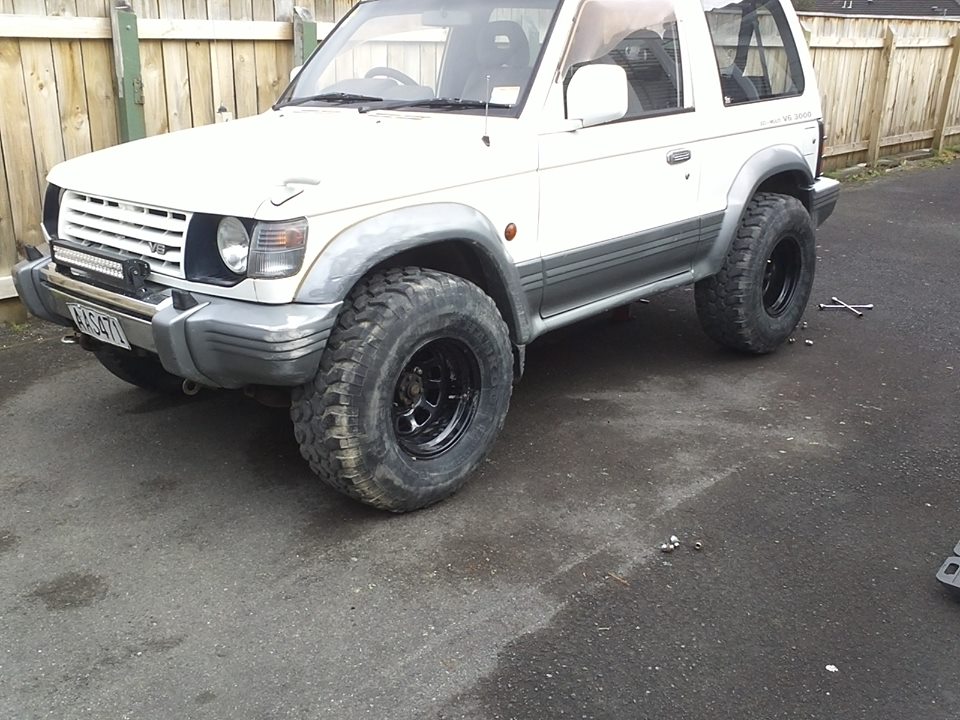

progress haha light bar. cb radio a few other little things.

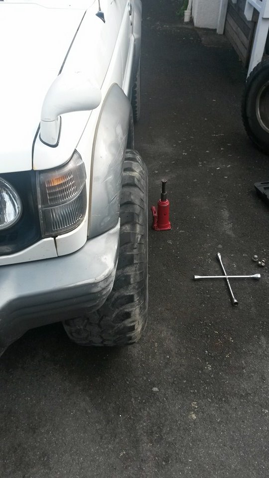

My major issue is sourcing or making a snorkel and tires i tried on my mate 33s on a 10inch rim with a -44 offset looked mad but rubbed alot only really on the front plastic bits of the bumper havent tried flexing it so unsure where else it rubs.
So what i am thinking of doing is building a bull bar to reduce were the tires will rubs on that front bumber.
Next question is what offset are you guys running with your 33s obviously -44 stuck out quite alot haha. or is it not worth going 33s and going to a 32.

Go 15x8 rims instead, will hold the bead much better and usually less offset so won't stick out as far.

yea thats what i was going to do i just tried the 15/10s just to see how narly it looked haha. i was thinking -22 offset but have herd 0 offset is the best in term of clearing the body.

Re: Pajero ideas.
just make ur own snorkle cost me $110
what sized light bar u get

yea mite make my own. and the light bar is just a cheap Asian one aye 20inch does the job tho haha
