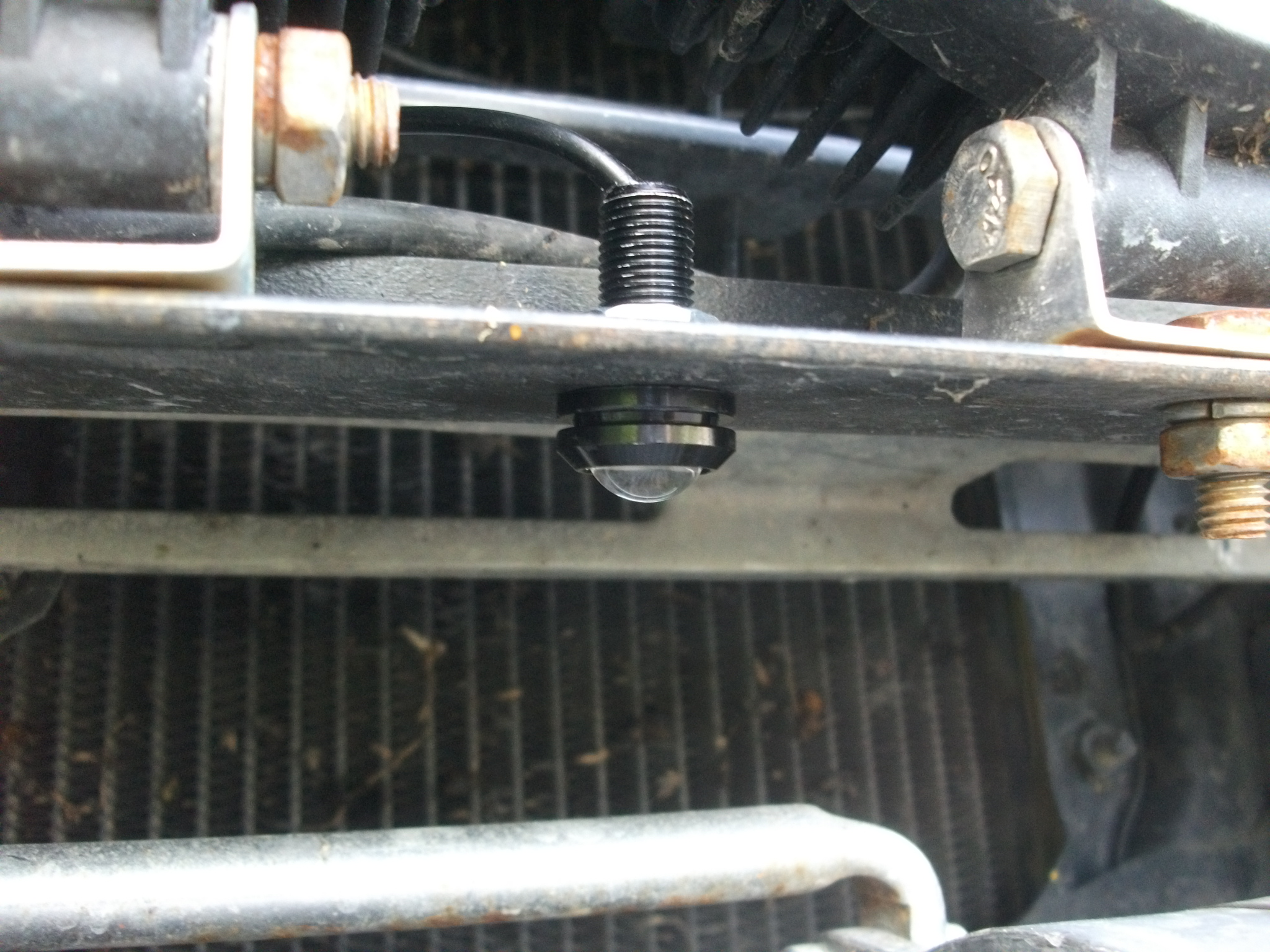

Fitted some small 3w LEDs over the winch drum, for those crap its dark and Im still winching moments
