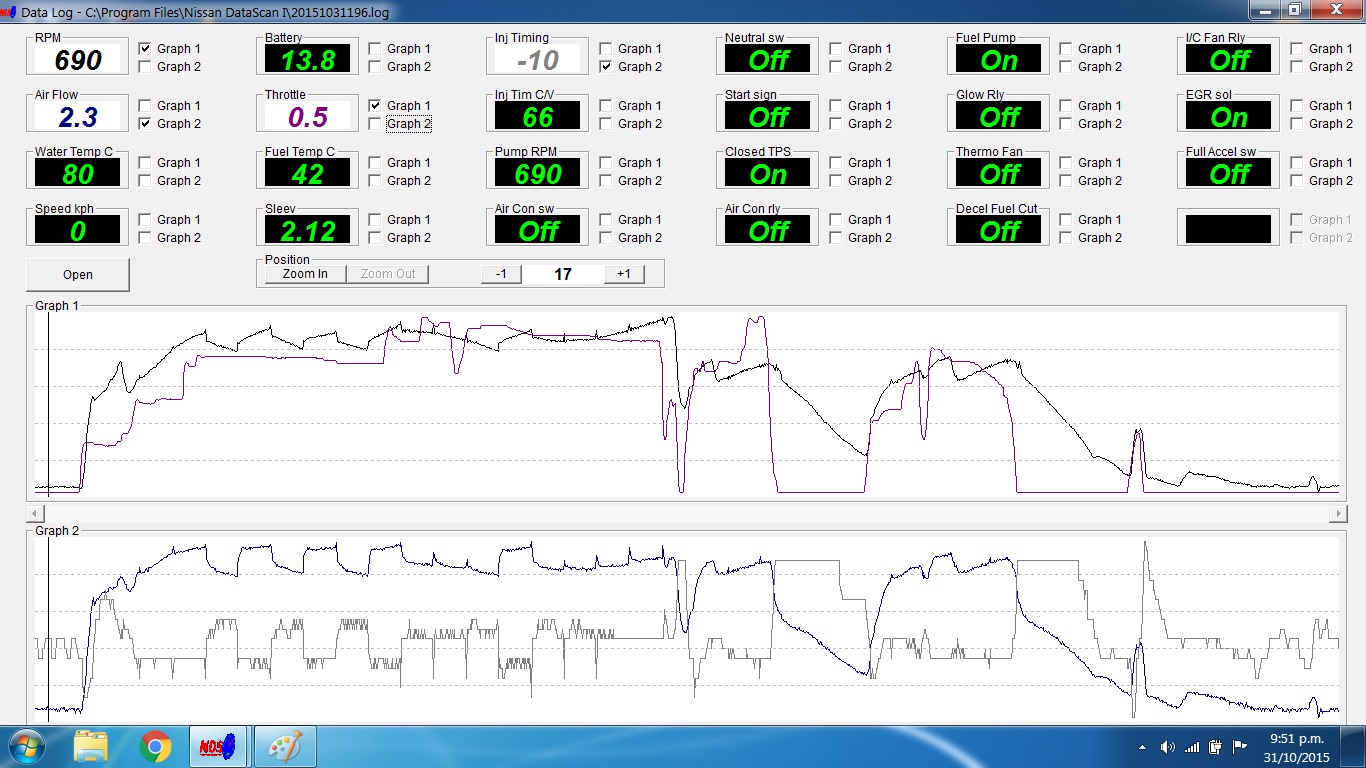

I'll just jump onto the laptop and upload this basic screenshot of the log print with the basic data showing.
The first half of the plot is the constant pull uphill from a stop, you can clearly see where the power is cutting in and out, not sure if this indicates a fuel/air sucking problem or not or where else to start looking.

Although taking a 2nd look at the graph, it seems maybe a little too rhythmic to be just fuel starving or sucking air?
I will admit that in changing the AFM plug from the 5pin to 4pin type I made a booboo, but as far as I could tell would've only damaged the afm if anything not the ecu, hence why I changed the afm but still reads exactly the same as before so reluctant to think that would be the cause..if only I had a spare ETI ecu laying around lol

3VILC wrote:Haha, I take it they are fairly interchangeable? I'm using the ZD one which has slightly bigger pipes (I thought this may be the problem, as the inlet pipe on the QD manifold is smaller than the hose a fraction, but double clamped it with screw up clamps didn't help). Might have to have a scavenge at pickapart in the morning before work.

if i read that picture right the TPS was only at .5 volts with ya foot on the gas....... ment to read .5 at idle.

Oh no that's only at the current selected graph point which happens to be the start (not moving) in that screenshot
The readings at the high point of the graph are about 3.1 to 3.9 except where foot isn't on the gas of course
