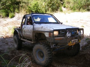

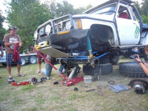

Below are a few pics just for interest sake.
Cheers Brad

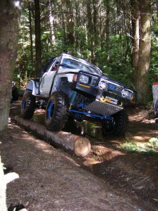

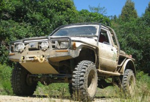

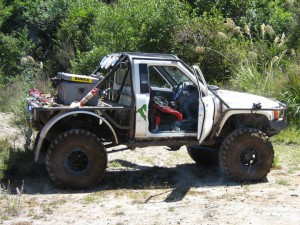

An a couple more
Cheers Brad
HYPERLUX
