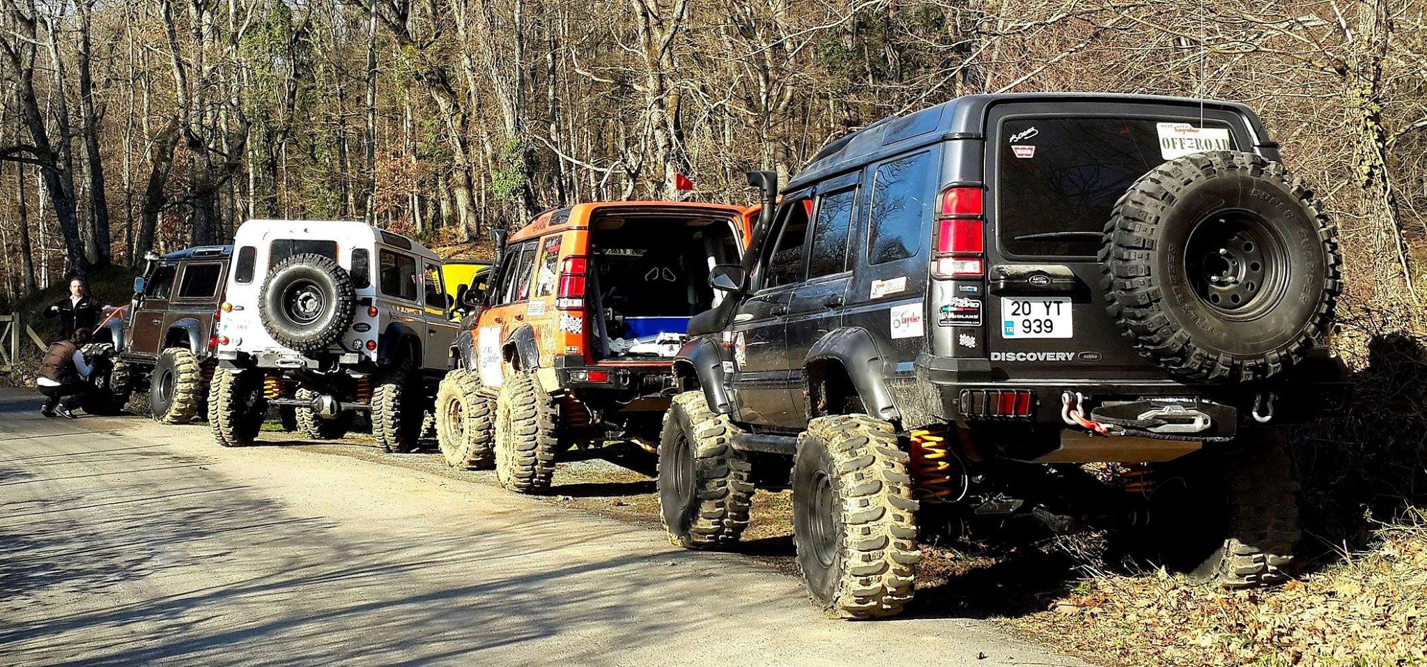

We looked into the legalities of chopping out the rear crossmember to fit a winch on mine. Lance the cert guy says no problem at all, a decent winch plate put in it's place would more than compensate for the existing crossmember.
Photo of some of the Turkish Land Rovers with Rear Winches. I have only seen them on their Disco 2's and Defenders so far, not seen one on a Disco 1. No idea how different the rear end is between the two.
The orange TD5 Turkish Disco runs a Warn 16000lb up front and a Tabor 12000lb at the rear
The blue Disco at the back runs Warn Zeon 12000 Winch Front, Warn 10000 Winch Rear.
