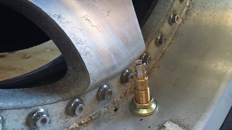

eBay brass dump valves, cheap as chips

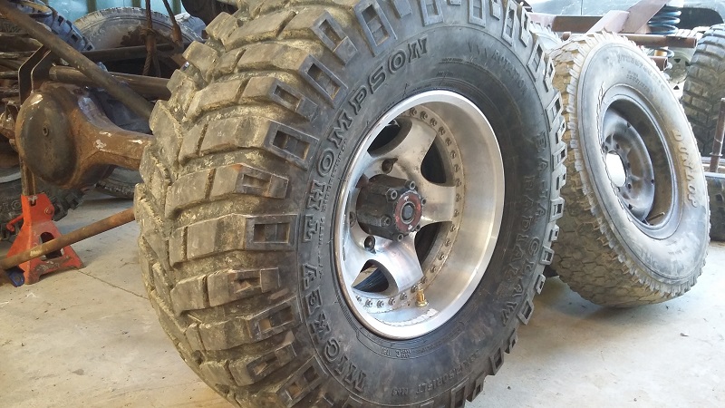

And my old mickey thompson baja claw 33 for the road but building it to fit 35s.

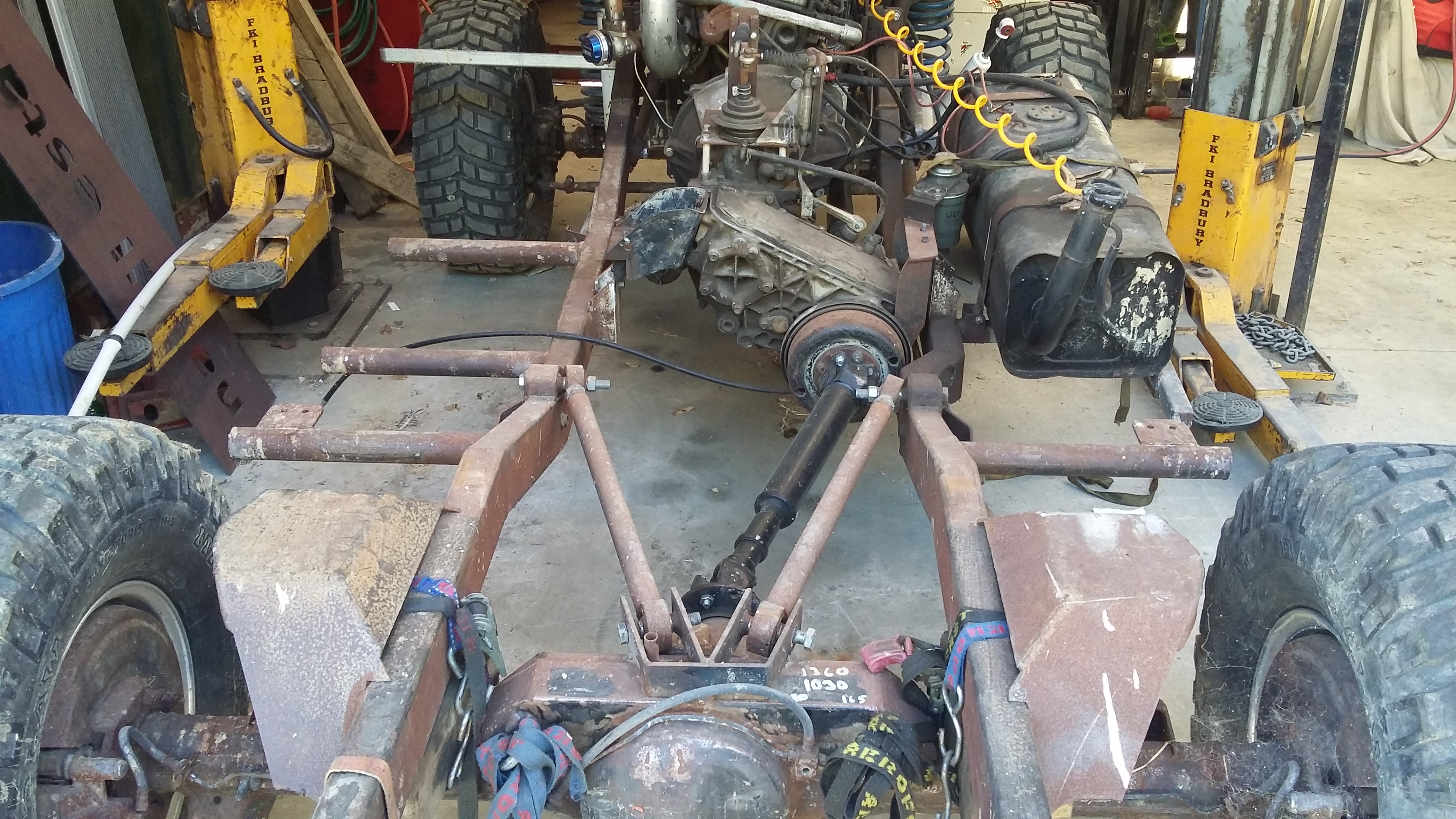

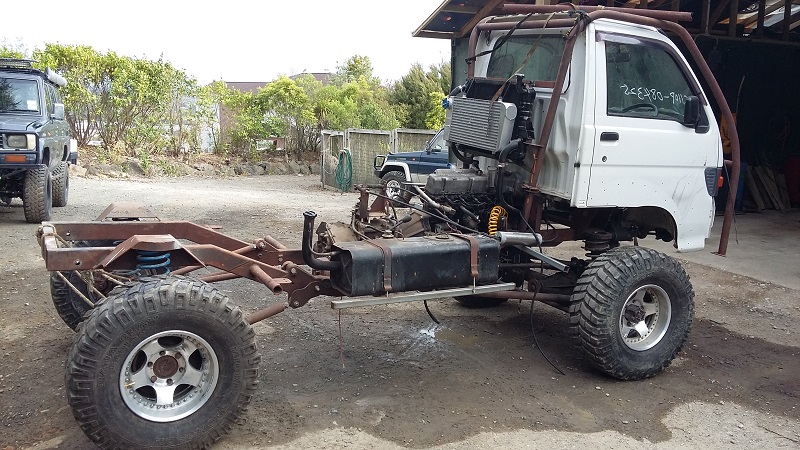

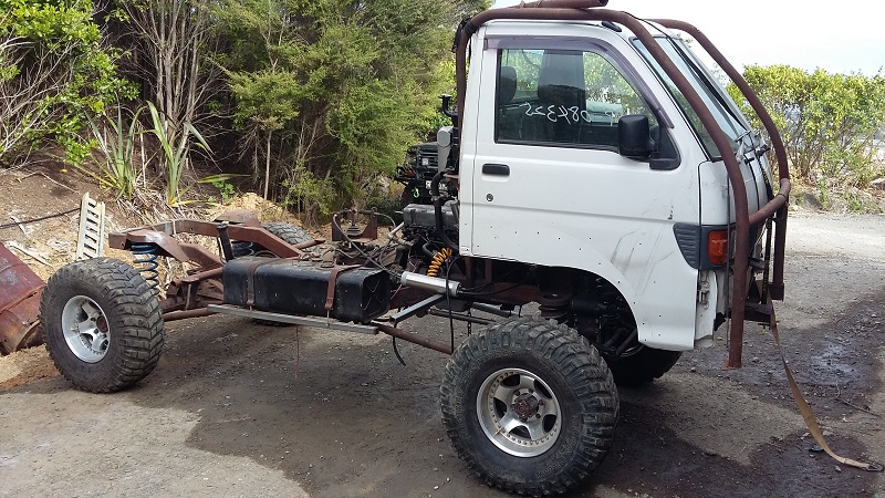

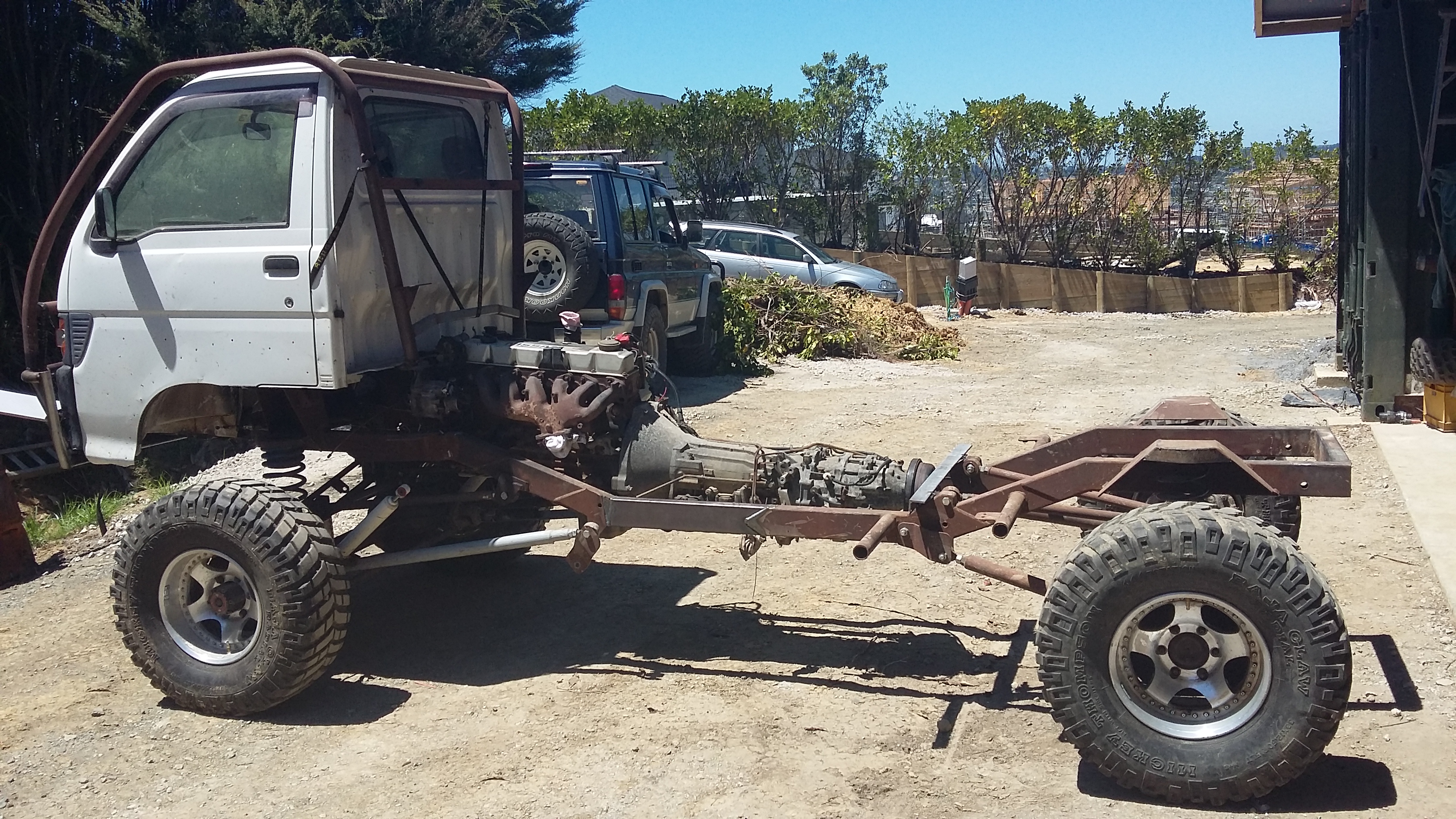

Rolling on all 4 steering and engine running mint. Clutch hooked up and breaks plumbed up to front. Drive shafts hooked up but thought i could get away with rear axle drive shaft misalignment but its just to much. Will drive with no springs in the back but fouls on droop.

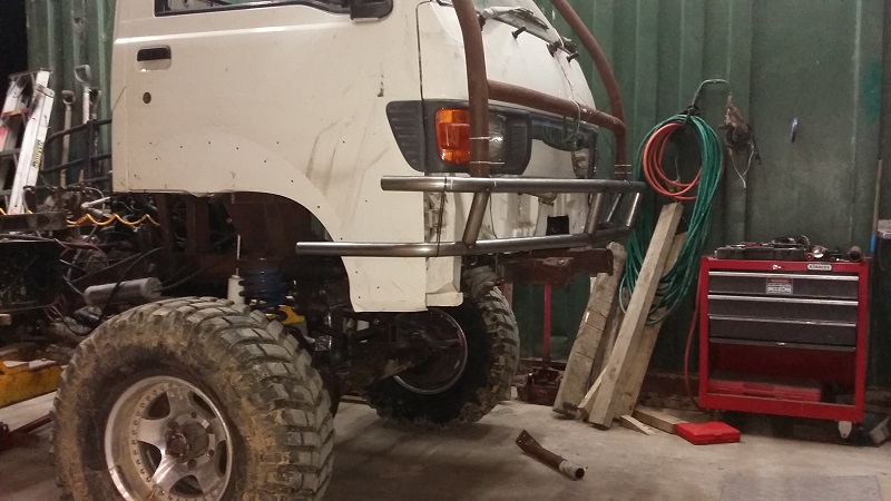

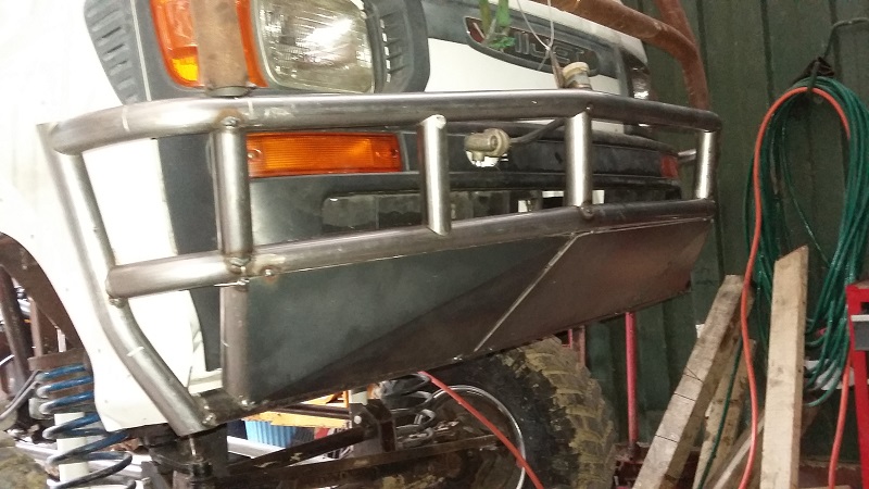

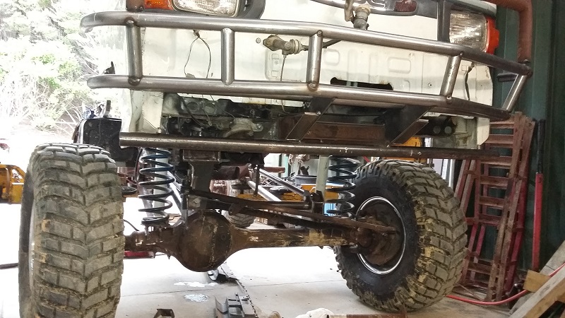

Started to build my front bumper while i save up for a new power plant and transmission.
Going for a silver top td42 and auto Deisel POWER

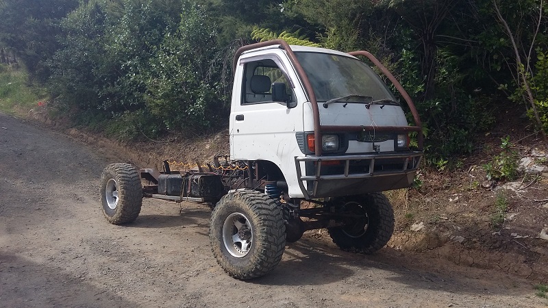

Re: Lobstrosity
All up to date. Love the flex with no springs and shocks out back ha ha to bad it cant be.
Bumped well on it way.
Going to move on to the roll cage next.

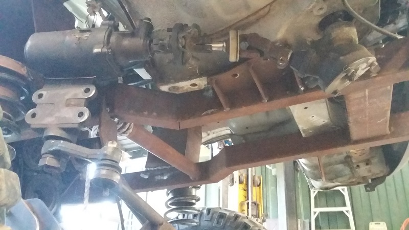

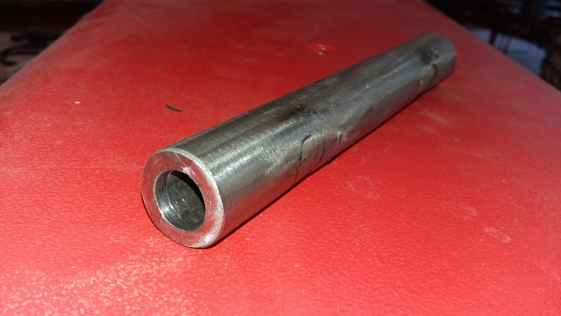

Is that a cut and weld on that steering shaft? Because if you want to cert it that's a big no no..that's what my cert man told me.
But otherwise looking forward to seeing it done!

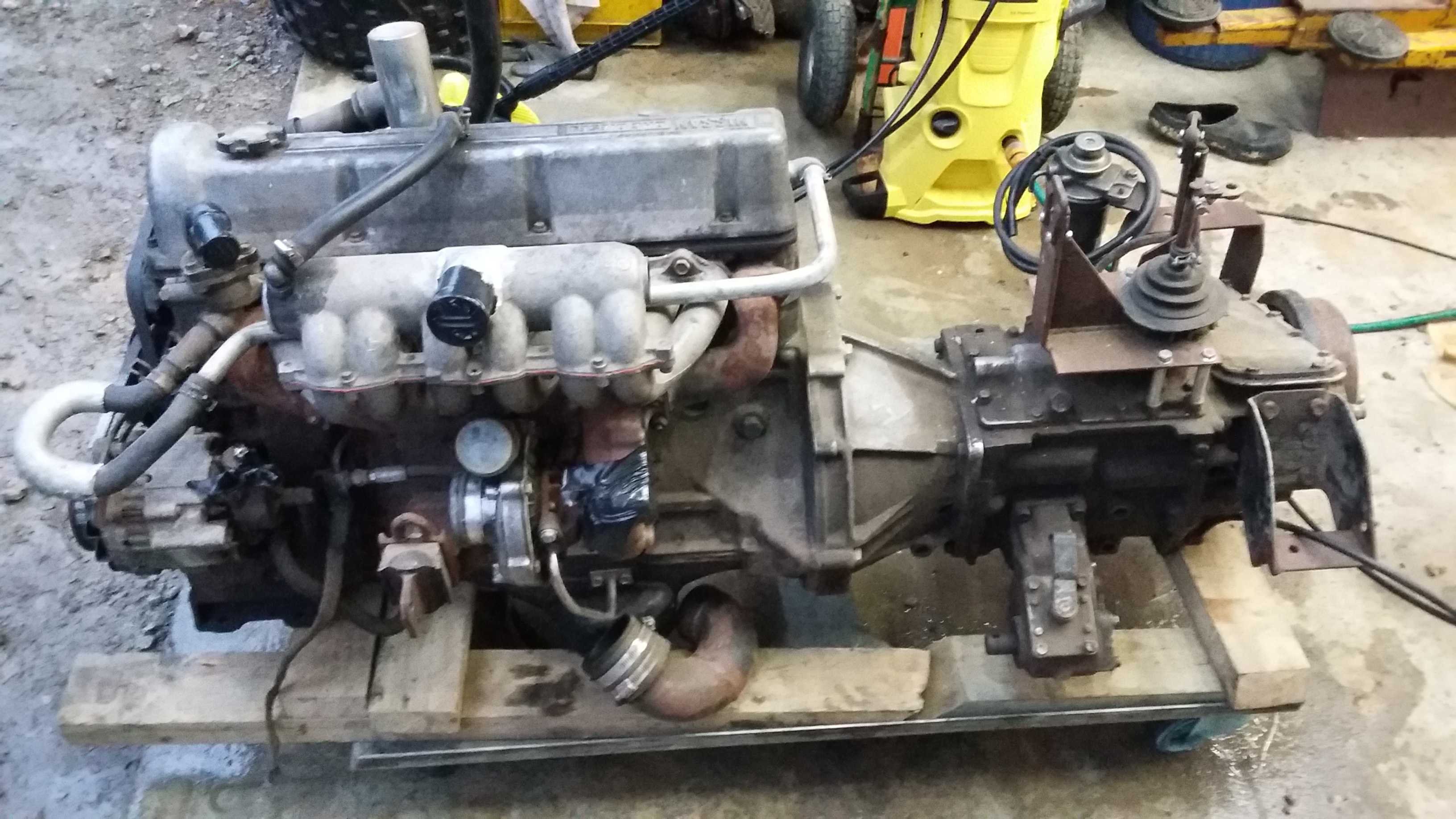

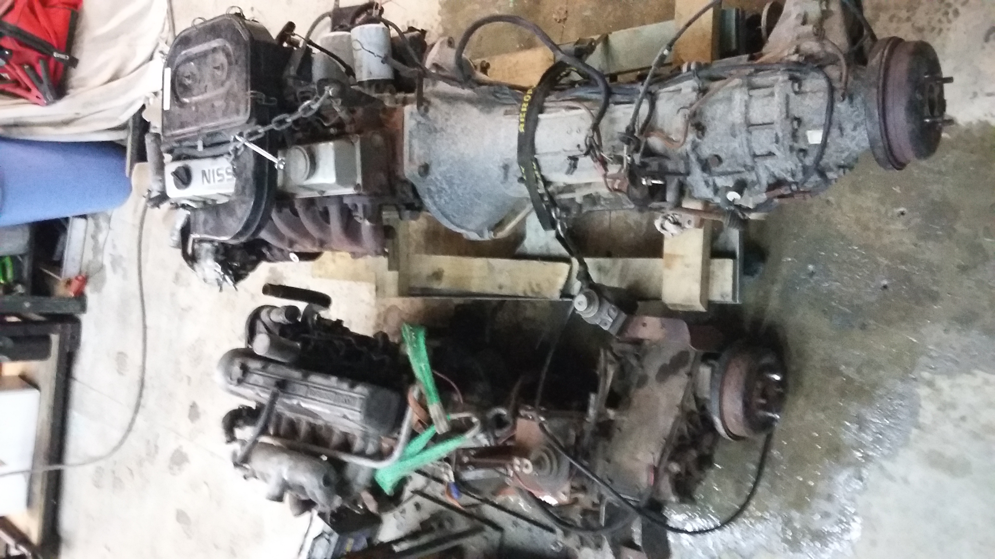

A quick 11 hour drive to New Plymouth - picked up a 4.2 silvertop with auto box. With 172k on the clock.
Started it up on the workshop floor... started after 2 cranks and no smoke - so stoked
So drive shaft angles are no longer an issue but its ####### long as hell so the hole truck is getting extended by 350mm!!!!!!

Re: Lobstrosity
good answer that
and yep long and heavy as well

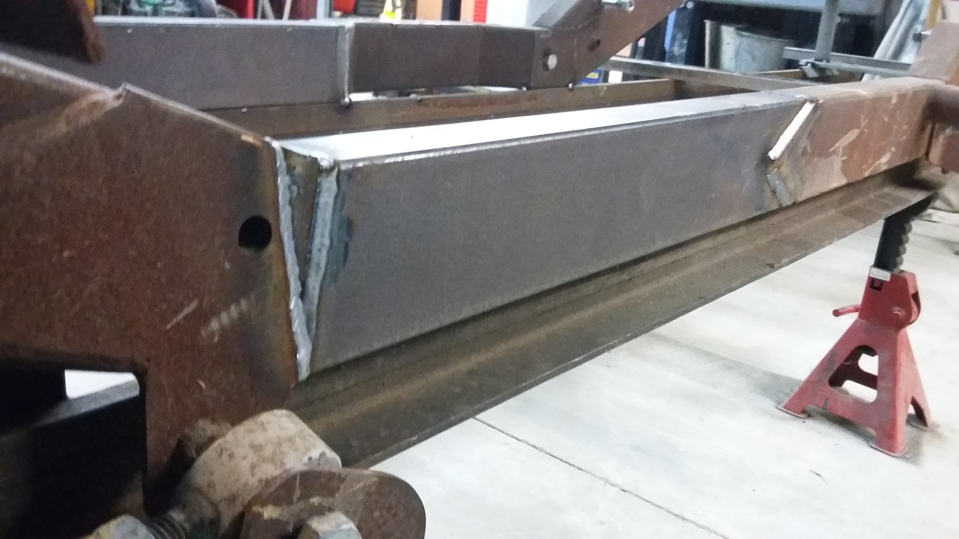

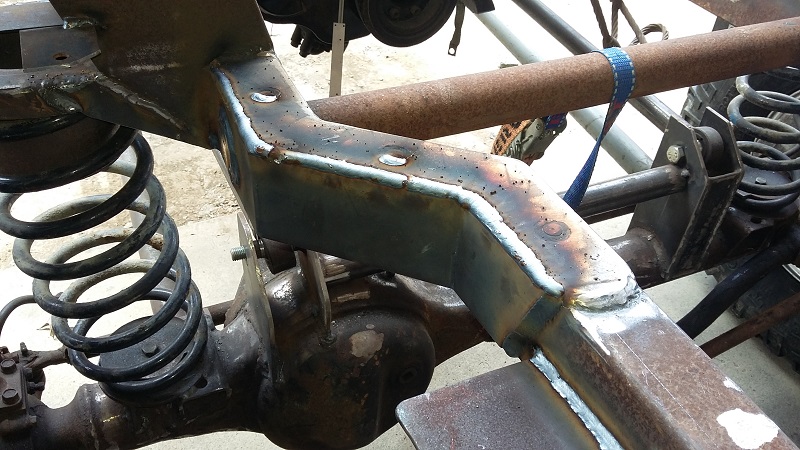

Got down to chopping it in half. Started a new job in the lift industry so have a few big steel rails that lifts run on and thought they would be perfect to use as a jig to line everything back together and stop it twisting as i weld it up.
Re: Lobstrosity
Extended and fully welded ready for a 5mm plate to stiffen the joins up. Also going to gusset the inside just to make certain its good and strong.
Using standard swb rear drive shaft.

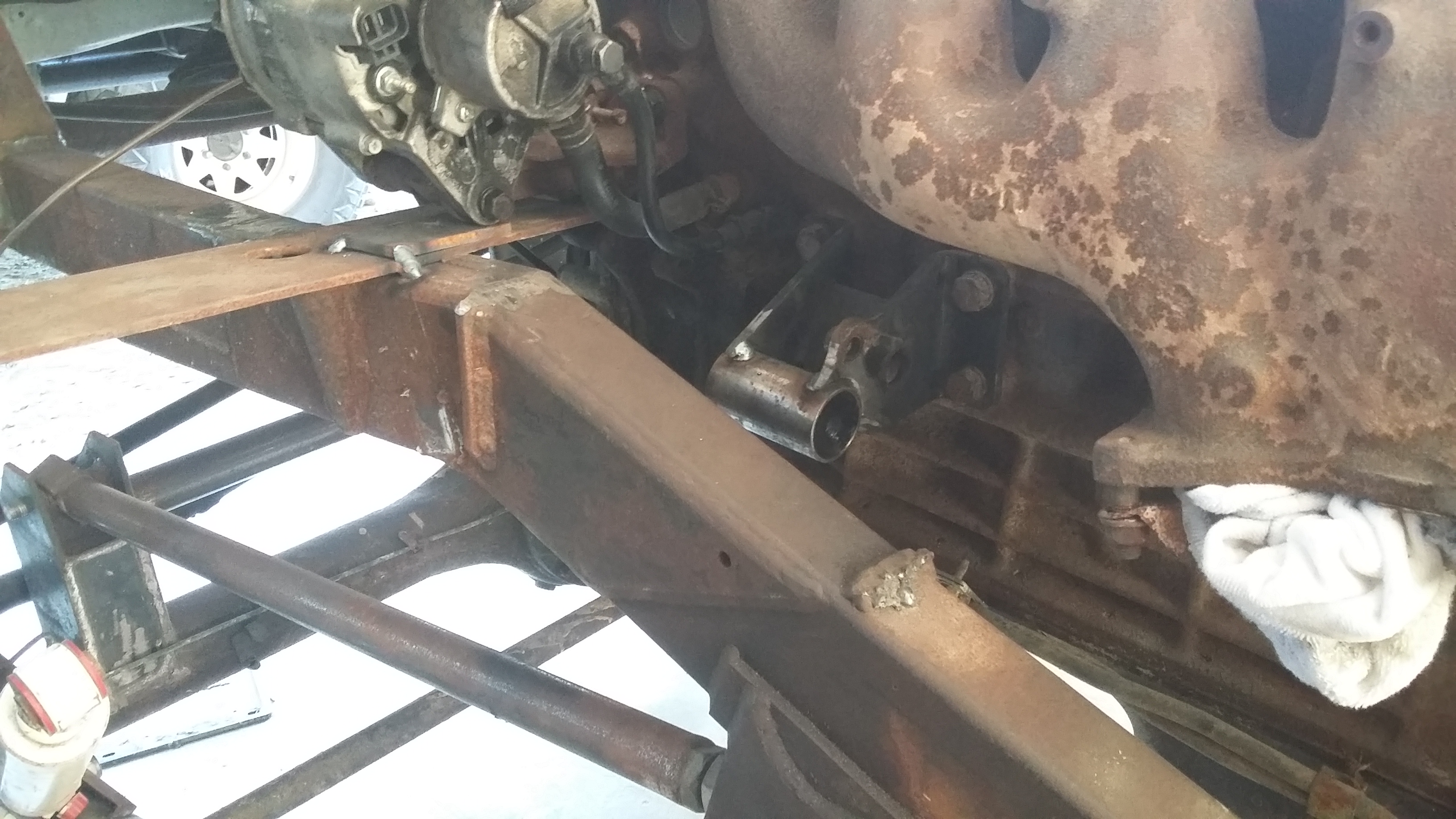

Re: Lobstrosity

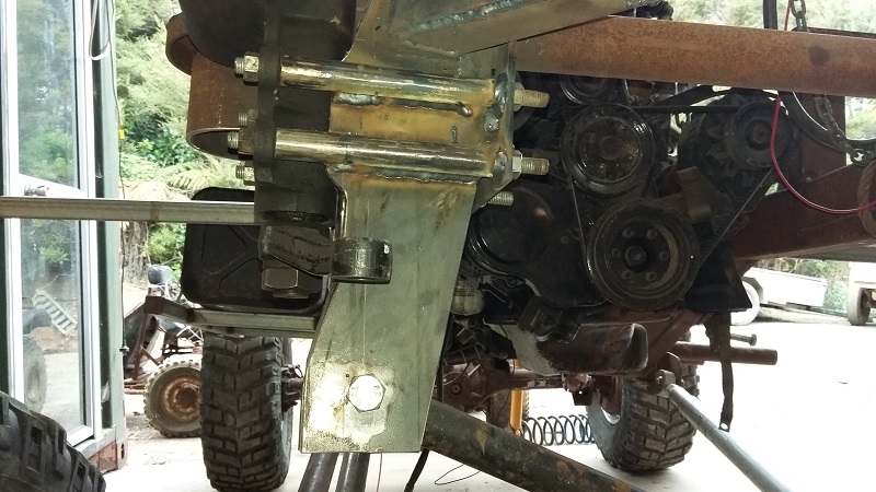

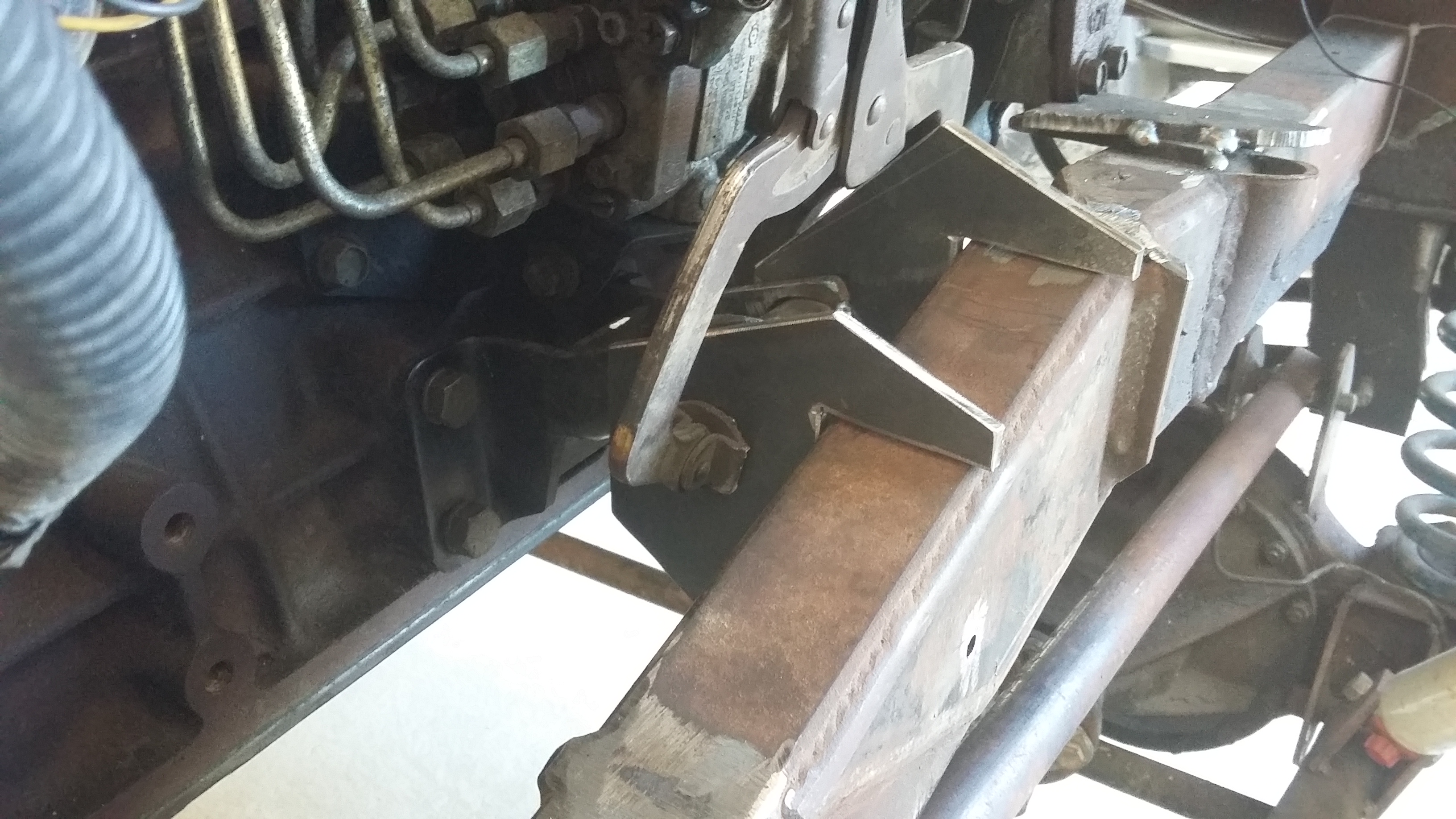

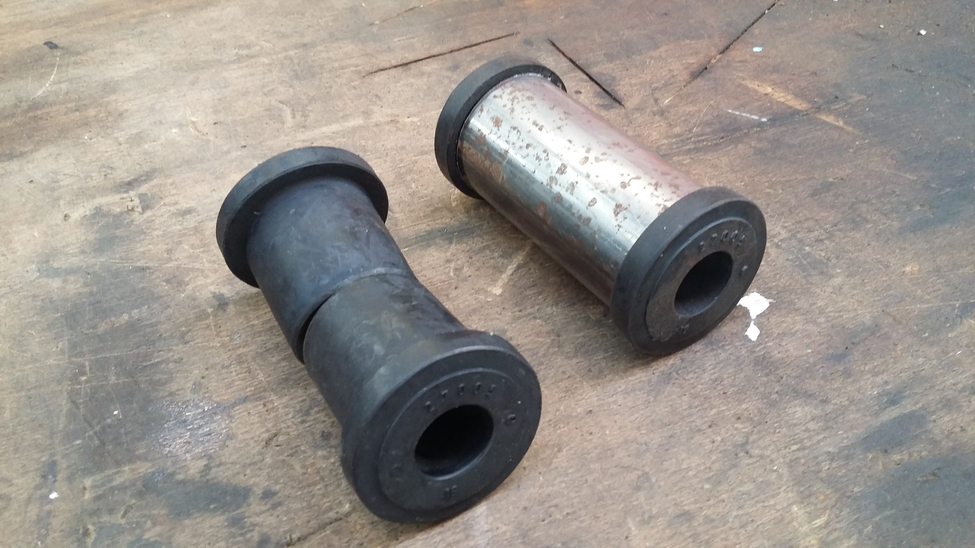

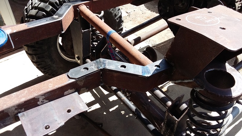

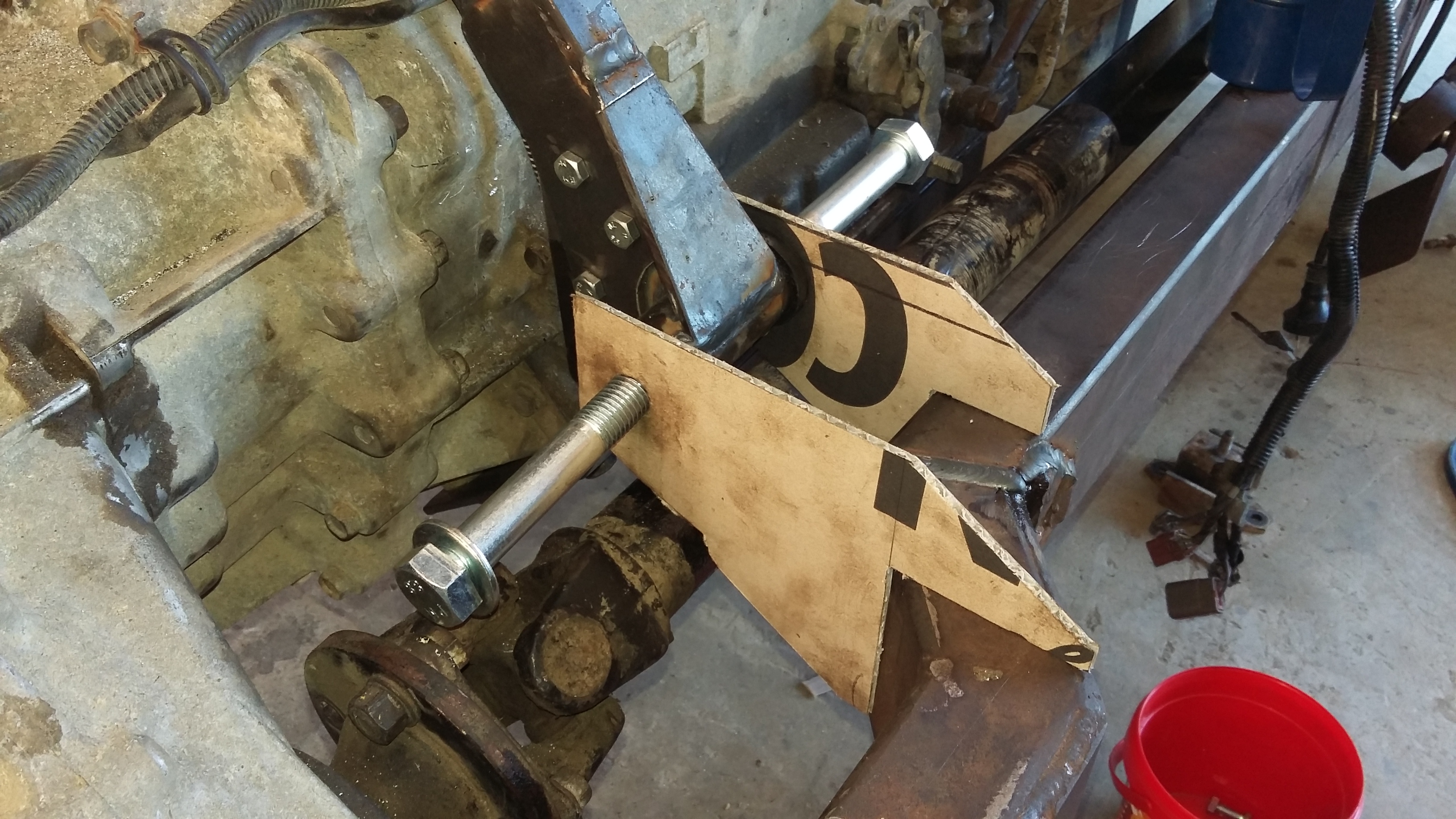

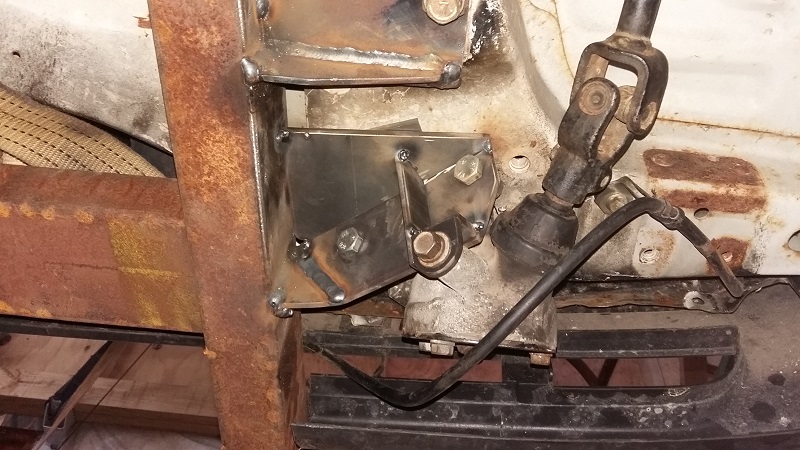

All the engine mounts where worn out and one missing. Thought i would make some super strong ones.
Found leaf spring bushes from Repco, 34 OD 18 ID for 5 bux each.
Used thick wall 1.5 inch tube and a M18 bolt with Nylocs
will do the same for the gearbox mount.
- mudlva
- Posts: 2918
Re: Lobstrosity
Use a m12 bolt and fit a 3mm wall crush tube otherwise you will destroy the rubber ends.
I used similar idea but used a l.c. radius arm bush.
Great feeling knowing that if the rubber lets go it still cannot part company from off the chassis mount.
Re: Lobstrosity
Dam wish i had realized that ha ha but your right. Easy ish to fix.
Thanks man
Thanks man

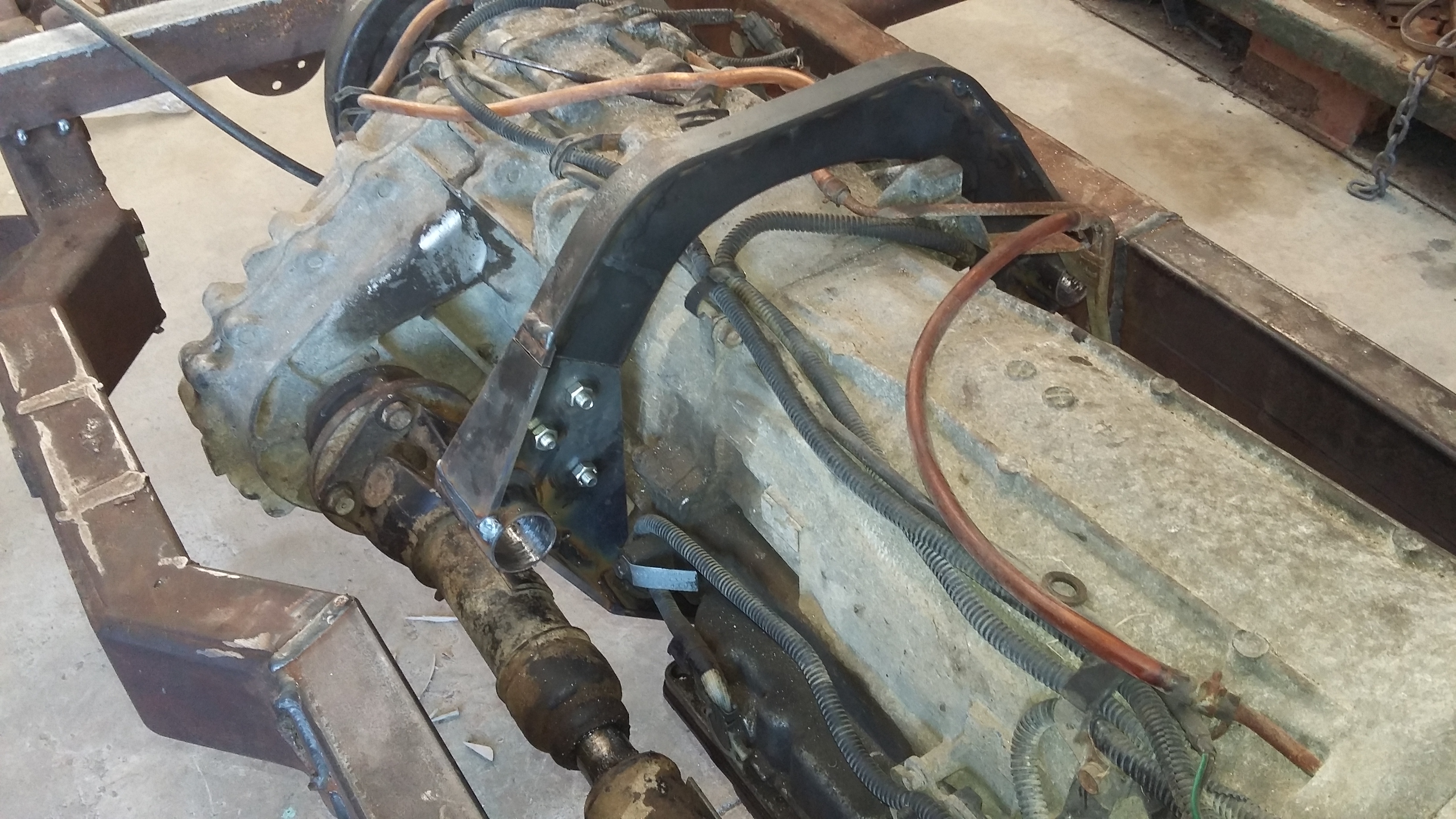

Re: Lobstrosity

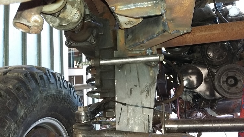

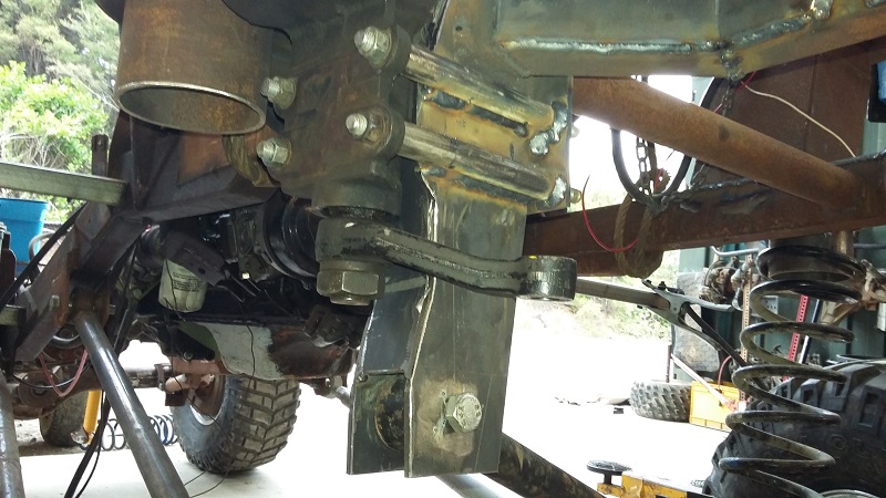

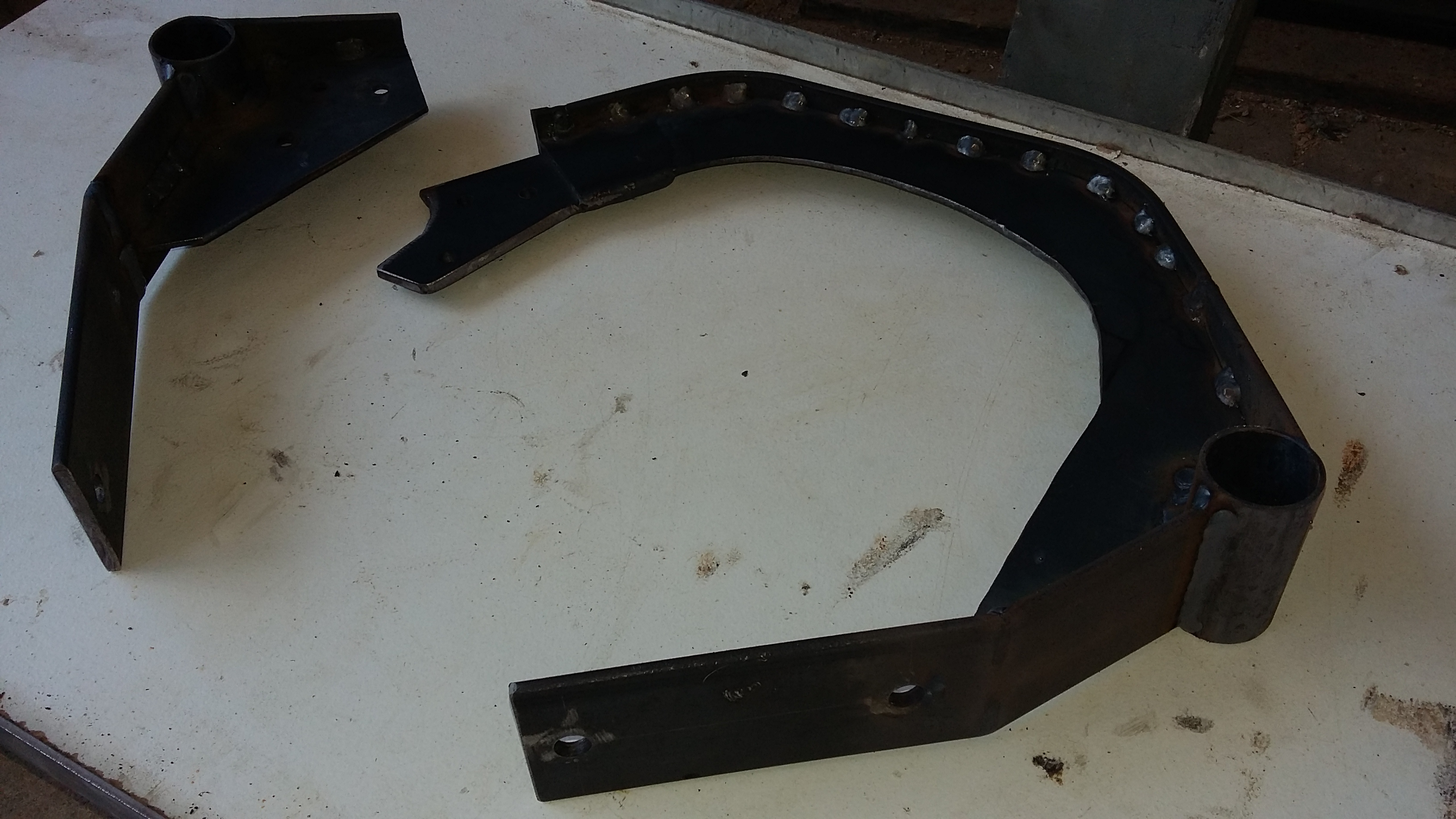

Rear gear box mount. Made a crazy wrap around mount to get it nice and high out the way of drive shaft.

This thing is sick.
