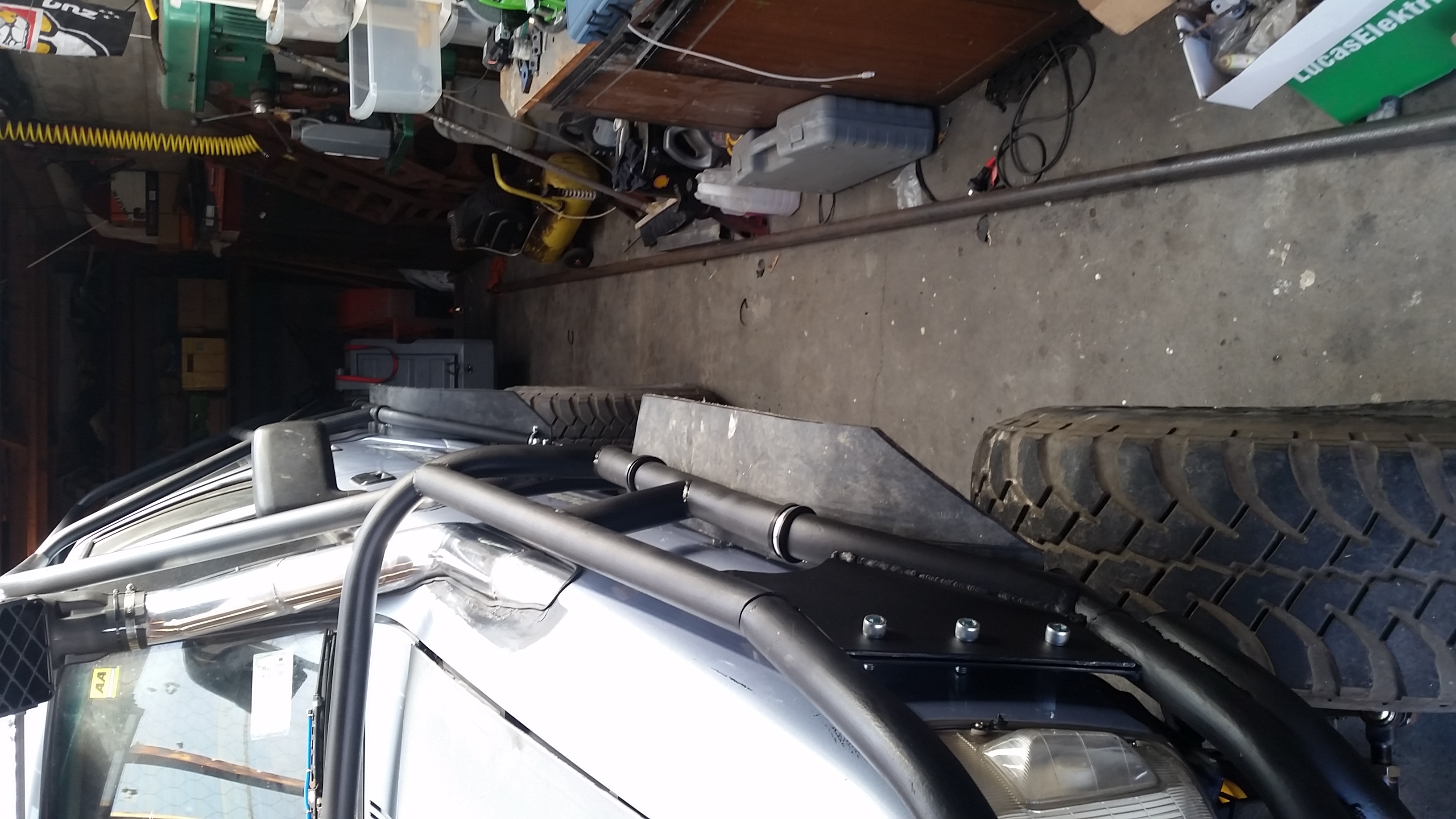

Few more things knocked off the to do list, picked up some never sieze and a bag full of bolts,
Finished bolting cage on. So that's Solid, finally got around to mounting the rear of sliders.

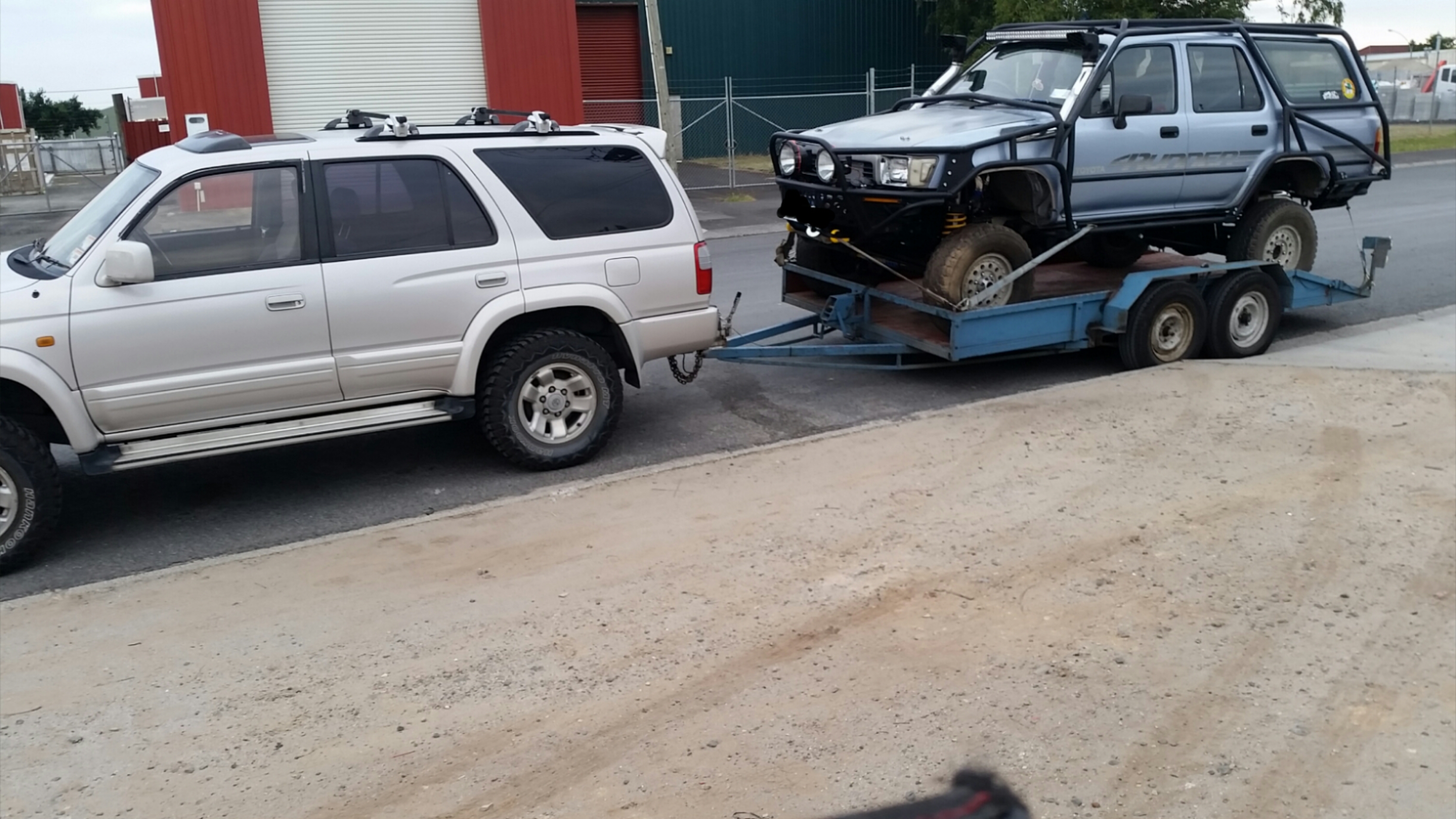

Borrowed a d plate and took for wheel alignment today, one thing there's a miss on the high boost setting as it hits 10psi.... will need to investigate.suspect it's actually a tune limit not quite right.runs sweet on low boost so will leave it there for now.
And they couldn't do wheel alignment as there machine wouldn't fit beadlocks.... so will attempt again next weekend.not working next sat so will trailer it there on some 31s.

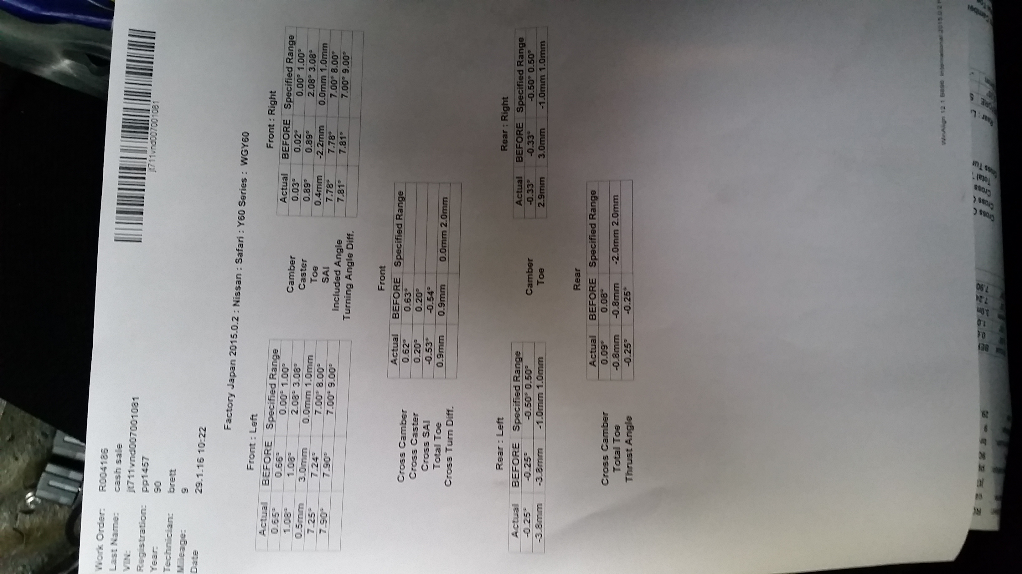

Just took spec sheet to Mr certifier, caster at about 1 degree no good....need to sort asap...will go look at options..maybe should bite the bullet on a set of superflex arms to help the non existent nissan flex...hmmm wallet doesn't really say yes but...

What is your caster angle?
Also you would want to know for sure that he will pass the Superflex arms as they have their own cert issues don't they?
Re: first surf build.
So diff needs to rotate back a hair, I had already extended front mounts lower than factory.could go further I surpose? He didn't think caster correction bushes would sort it,but as far as I can tell 1.5° would put me in spec?

Personally I'd be aiming for heaps more. Bigger tyres equals bigger caster requirement. I'm assuming that 2-3 degree is for factory 29 or 30" tyres? Guys seem to talk about 6 degrees at ride height for dessert racing. Can't remember what mine are now but think I was aiming for 5 degrees when I built my radius arm mounts.
Ask Neal if he will accept anything greater than the 3 degree "spec", if so, I'd aim for 4-6 degrees.

I'll give him a bell,perhaps that's why he said bushes wouldn't move it enough
Also I think you are only allowed +- .5 degree either side. Of factory settings . so 6 would be too much..

Yeah but what prey tell is "factory setting" For a Nissan axled, radius armed, 35" tyred, Turbo V8 surf?
Just rang him,more is ok. If it's 5 degrees that's sweet...not too concerned about being over.just under

Superflex arms are no problem to cert, Lchundy(spellings) big red 80 was in the workshop with them and he said no problem to cert if branded etc.
I have a feeling replacement Radius arms will be the best bet.. I have messaged Nathan on fb awaiting reply...now it's weather I can get a set before wensday otherwise no point going in for cert

Bugger iy wallet is much lighter...just coughed up for super flex arms from 4wdbits.... hopefully be here tomorrow. So new wheel alignment on Tuesday.
Quickest option to get sorted before wensday.hurt but it's ordered. Will hopefully make use of front shock abilities now as a bonus.
Righto. Kaiapoi arms would be ok if saf chassis,they fit aftermarket Dropbox to go to a bush rather than factory pin style...bit short time to go changing everything noe to do that.a bit cheaper than superflex by a fee hundred...
