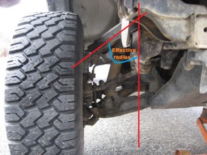

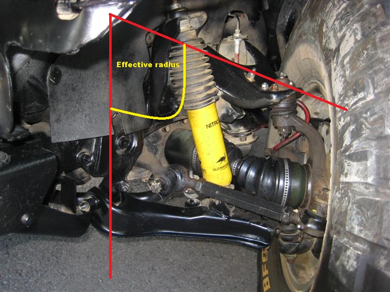

Mate i'm not a professional suspension engineer - you'll have to talk to DeRanged about that... and I am shit at maths. But I drew some pictures to illustrate the concept. Note radius angle in both is the middle of the upper balljoint - ie first pivot point.
First is a very durable production IFS with running gear, ie diff and CVs, at par or stronger than certain live axle models - Isuzu Trooper. Here the ride height is set slightly over factory, the radius is obviously much larger.
Second is quite possibly the most fragile and overrated production IFS - Toyota T-Bar. Here the ride height is set very high, the effective radius is much lower. As well as the change in spring - ie torsion bar - behaviour, it will wear out ten times faster at that static angle.
The reduction in radius directly correlates to the spring behaviour - same force, high A-Arm angle equals a stiff suspension, torsion bars dont deflect, and it doesnt comply to the terrain. But the difference is exponential, so a small reduction in radius equals a big difference in spring behaviour.
In my opinion, Independent suspension can be made to work extremely well off road, But the biggest mistake people make is 'torsion bar cranking.' It destroys performance and reduces the life of serviceable parts massively. The next level obviously is deleting torsion bars, but that requires a seperate thread altogether, which will come in due time In my opinion, torsion bars are the equivalent of leaf springs - antiquated, luddite technology.
