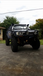

Postby skidmark » Sun Jan 17, 2016 8:08 pm
Masive update,indicators and load resistor fitted

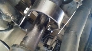

Postby skidmark » Sat Jan 23, 2016 8:01 pm
Borrowed a d plate and took for wheel alignment today, one thing there's a miss on the high boost setting as it hits 10psi.... will need to investigate.suspect it's actually a tune limit not quite right.runs sweet on low boost so will leave it there for now.
And they couldn't do wheel alignment as there machine wouldn't fit beadlocks.... so will attempt again next weekend.not working next sat so will trailer it there on some 31s.
Made driveshaft loop, hopefully up to spec, I didn't cover top as it backs onto a crossmember so it is fully enclosed still. 4 m10 bolts.

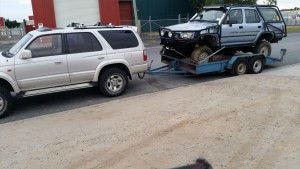

Postby skidmark » Fri Jan 29, 2016 5:03 pm
For wheel alignment sorted today ..Replaced drag link and tie rod with heavy duty stuff before hand so it's all nice and new for me certifier...but both diffs appear to be pointing in the same direction as a bonus!

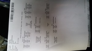

Postby skidmark » Thu Feb 04, 2016 8:11 am
Just took spec sheet to Mr certifier, caster at about 1 degree no good....need to sort asap...will go look at options..maybe should bite the bullet on a set of superflex arms to help the non existent nissan flex...hmmm wallet doesn't really say yes but...

What is your caster angle?
Also you would want to know for sure that he will pass the Superflex arms as they have their own cert issues don't they?
Supercharged VH45 Surf safari winch truck in the making
viewtopic.php?f=18&t=33527&hilit=checker%2A
skidmark
Posts: 616
Joined: Sun Sep 12, 2010 2:24 pm
Location: hamilton
Re: first surf build.
Postby skidmark » Thu Feb 04, 2016 9:09 am
So diff needs to rotate back a hair, I had already extended front mounts lower than factory.could go further I surpose? He didn't think caster correction bushes would sort it,but as far as I can tell 1.5° would put me in spec?
modified surf, hardly drive it seem to keep modifying it....
