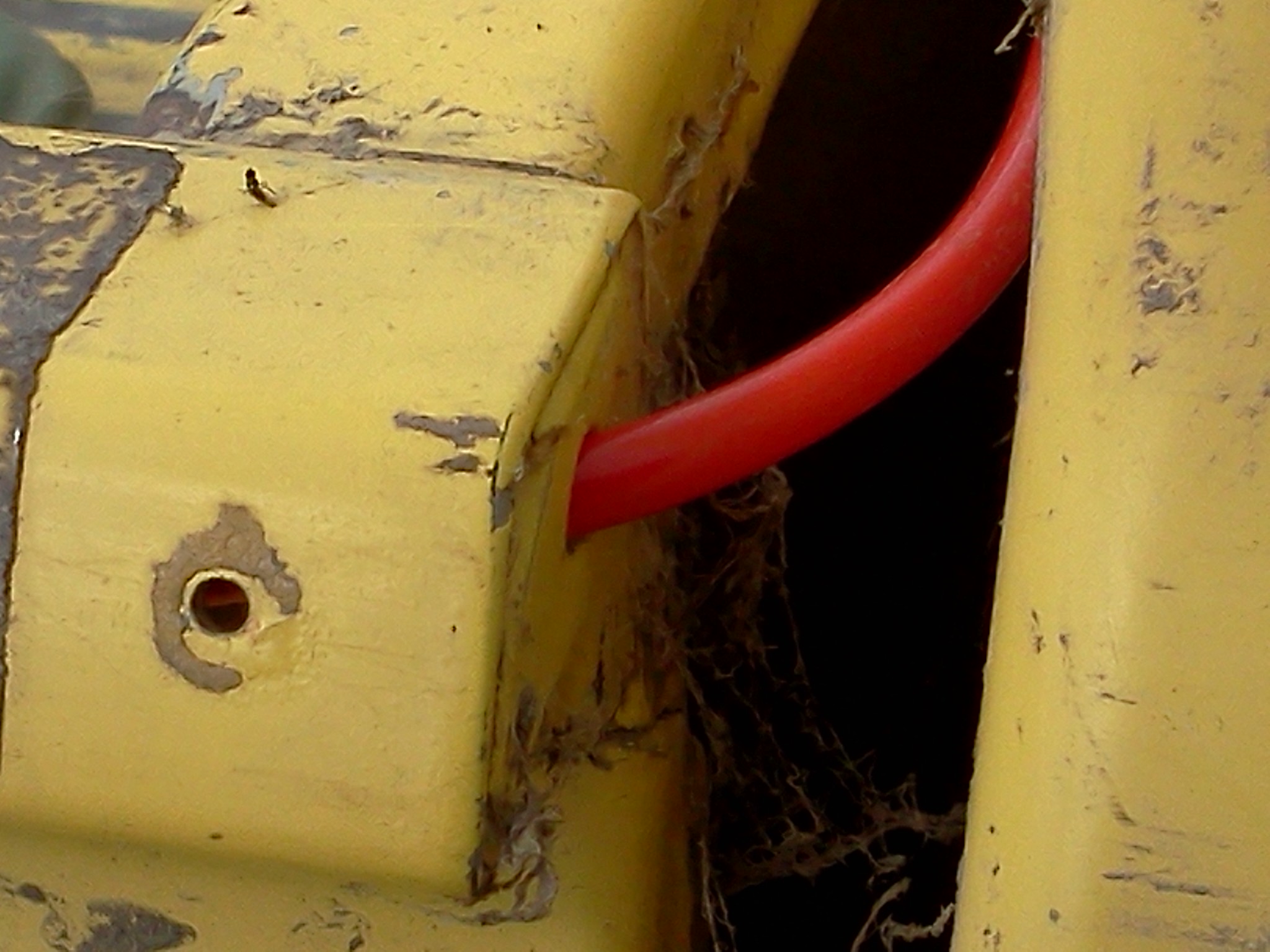

Quick question Where did you run your diff breather too?

Cheers, the rear one comes up between cab and tray(hilux DC ute) and sits just under tie down return for tray.
The front one comes up under steering column and is tied off on the vacuum lines for the brake booster.

Ran a thin chain or steel cable up with the breather hose and cable tie the hose to it. The chain will "slice" mud and shit as it feeds over the diff preventing the hose from getting ripped off

Was thinking what to do about that, great idea :idea:

Haha yep its what i do to protect the locker hose.
I use chain as its easier to adjust to accomindate maximum travel lenght
