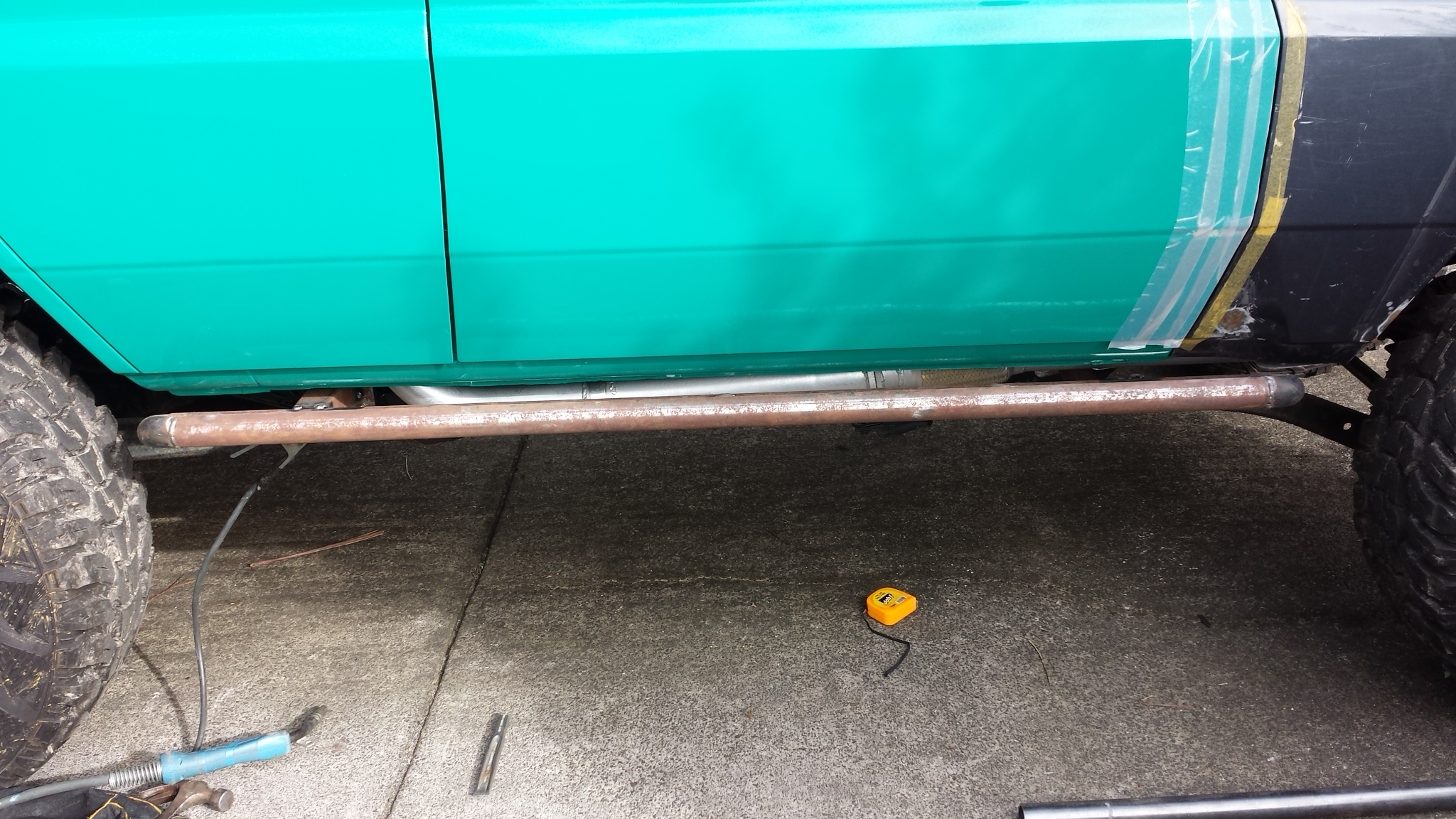

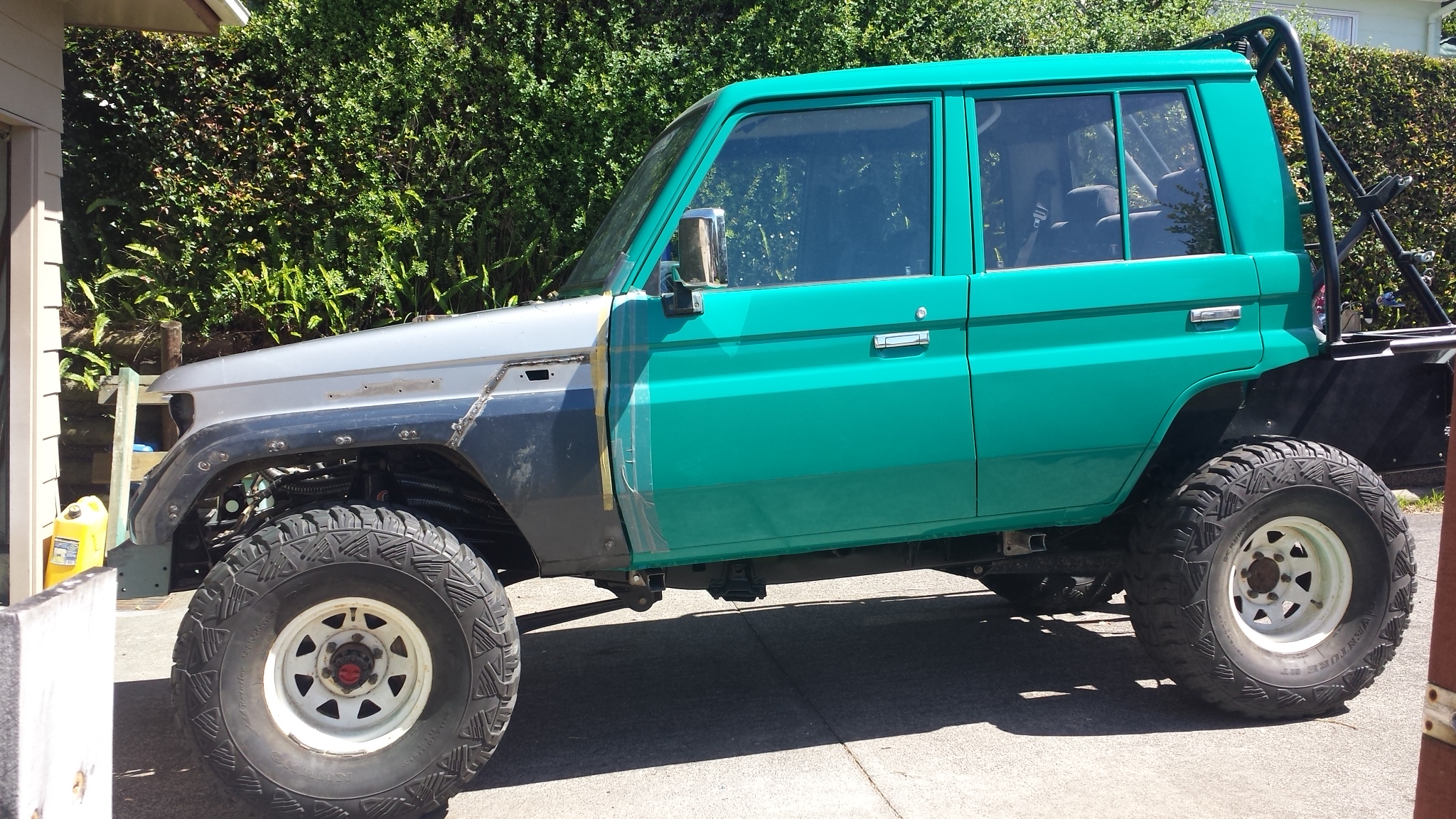

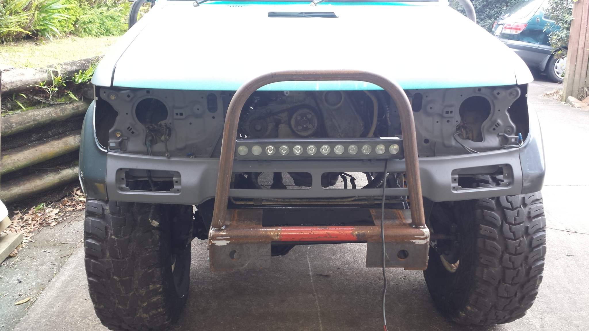

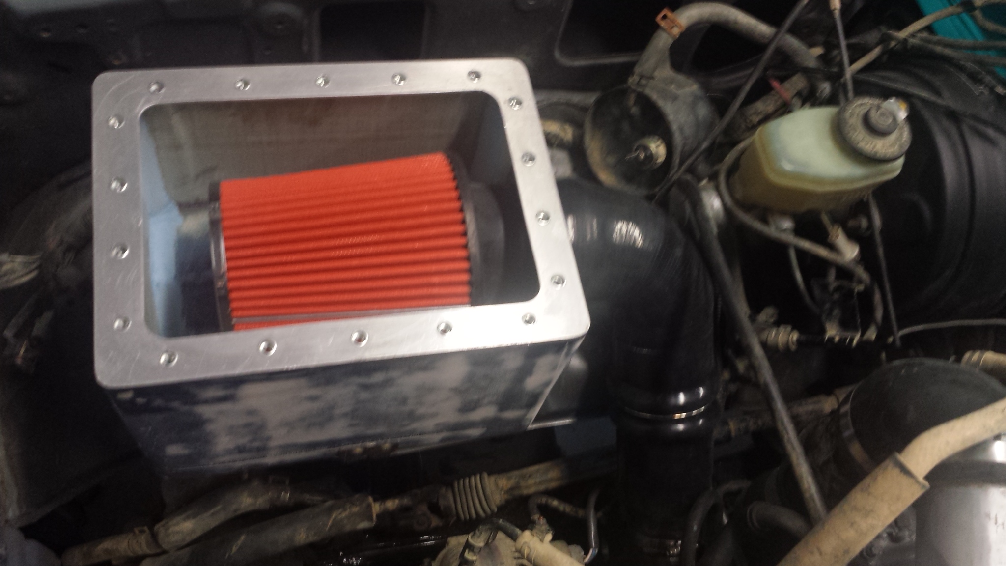

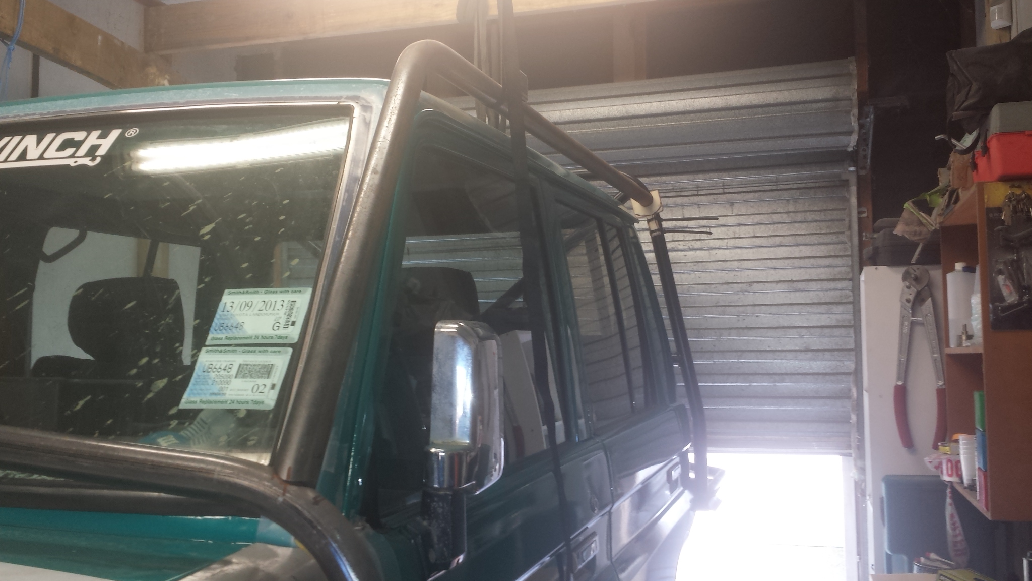

Another update in the project.
Bit more painted and mocking up front guards.
Also started exocage and sliders.

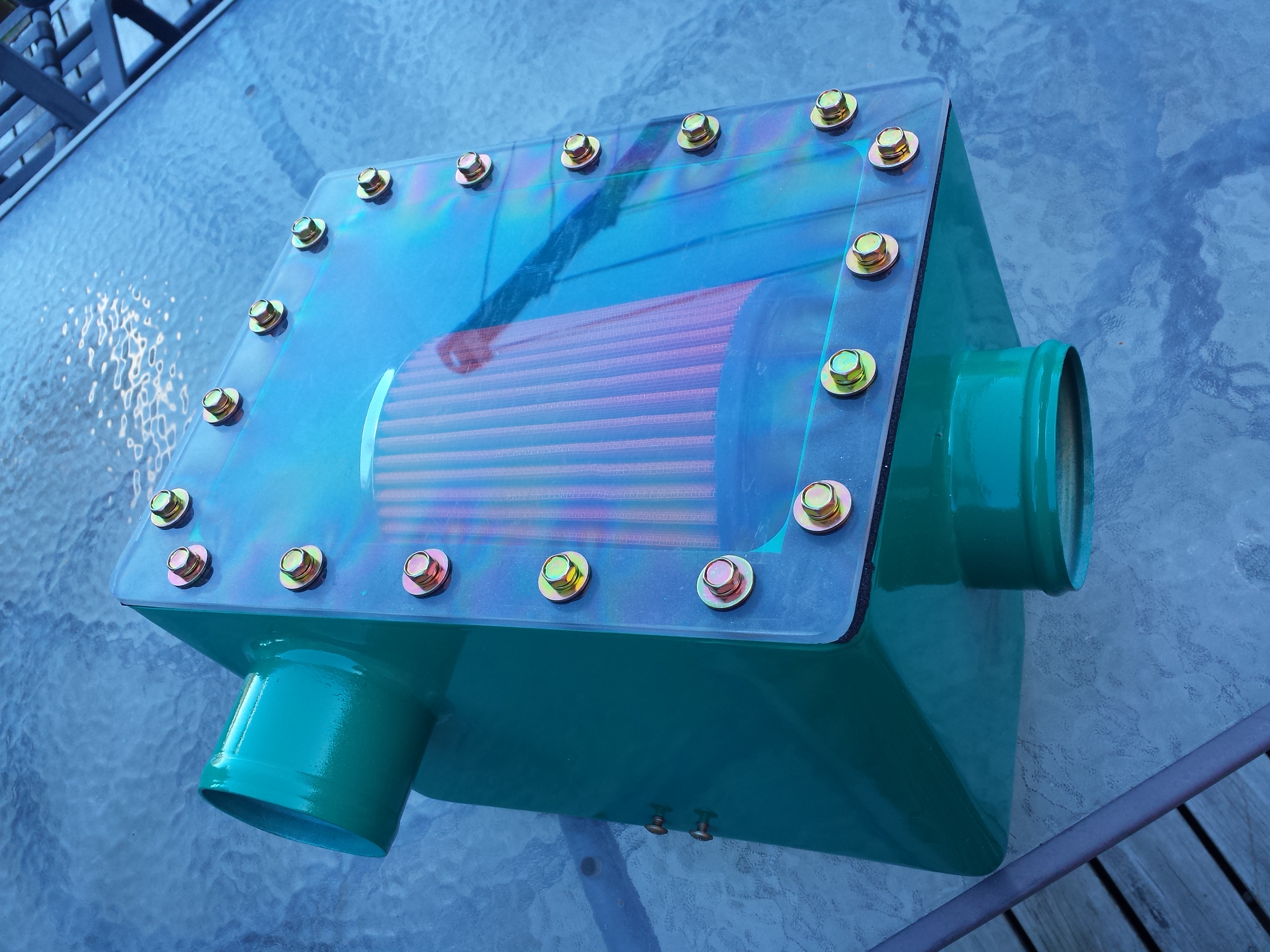

Some work done on airbox.
Using 32nb pipe... Coming along nicely...
Pics say a thousand words...
Cheers Calvin

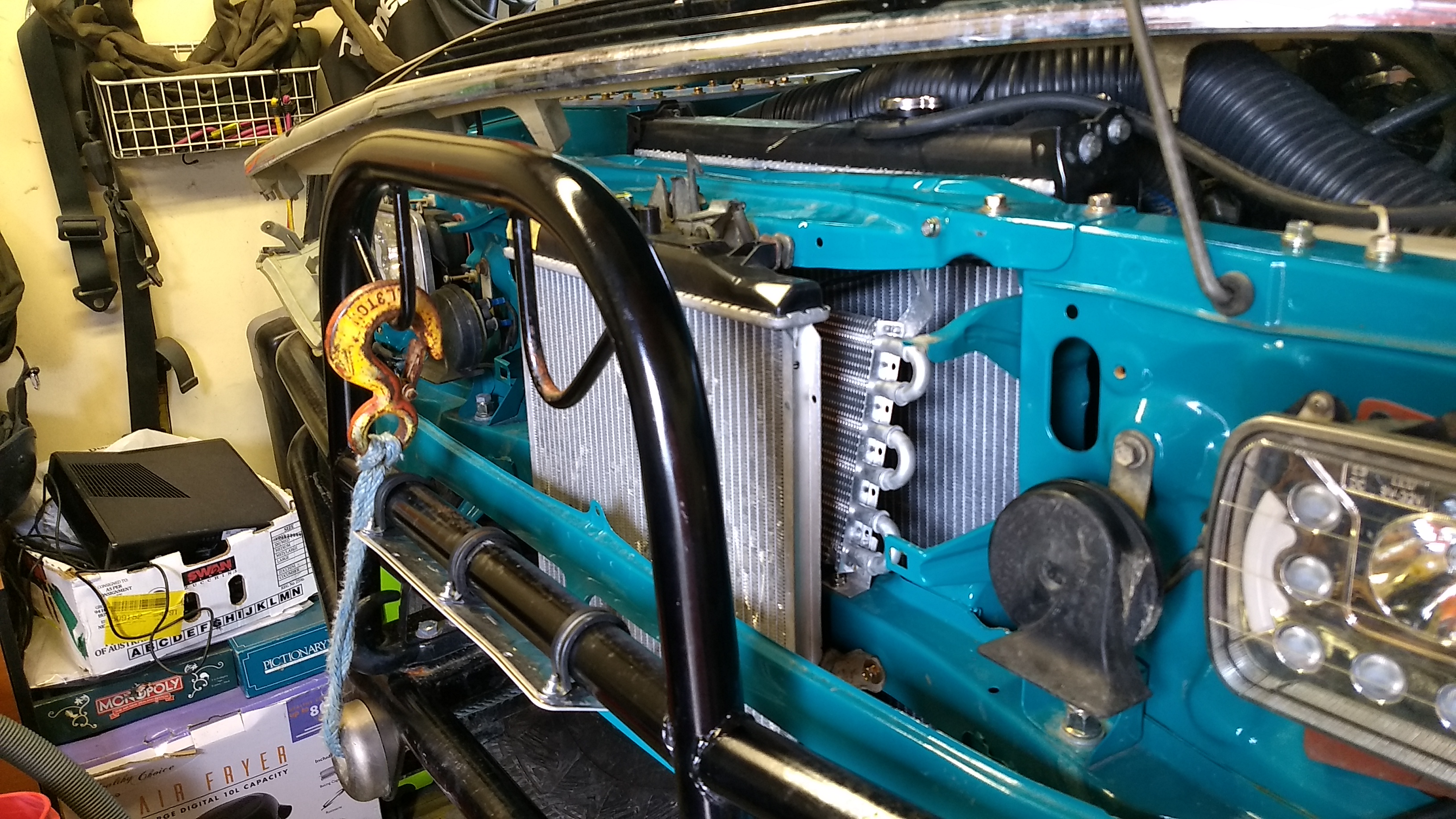

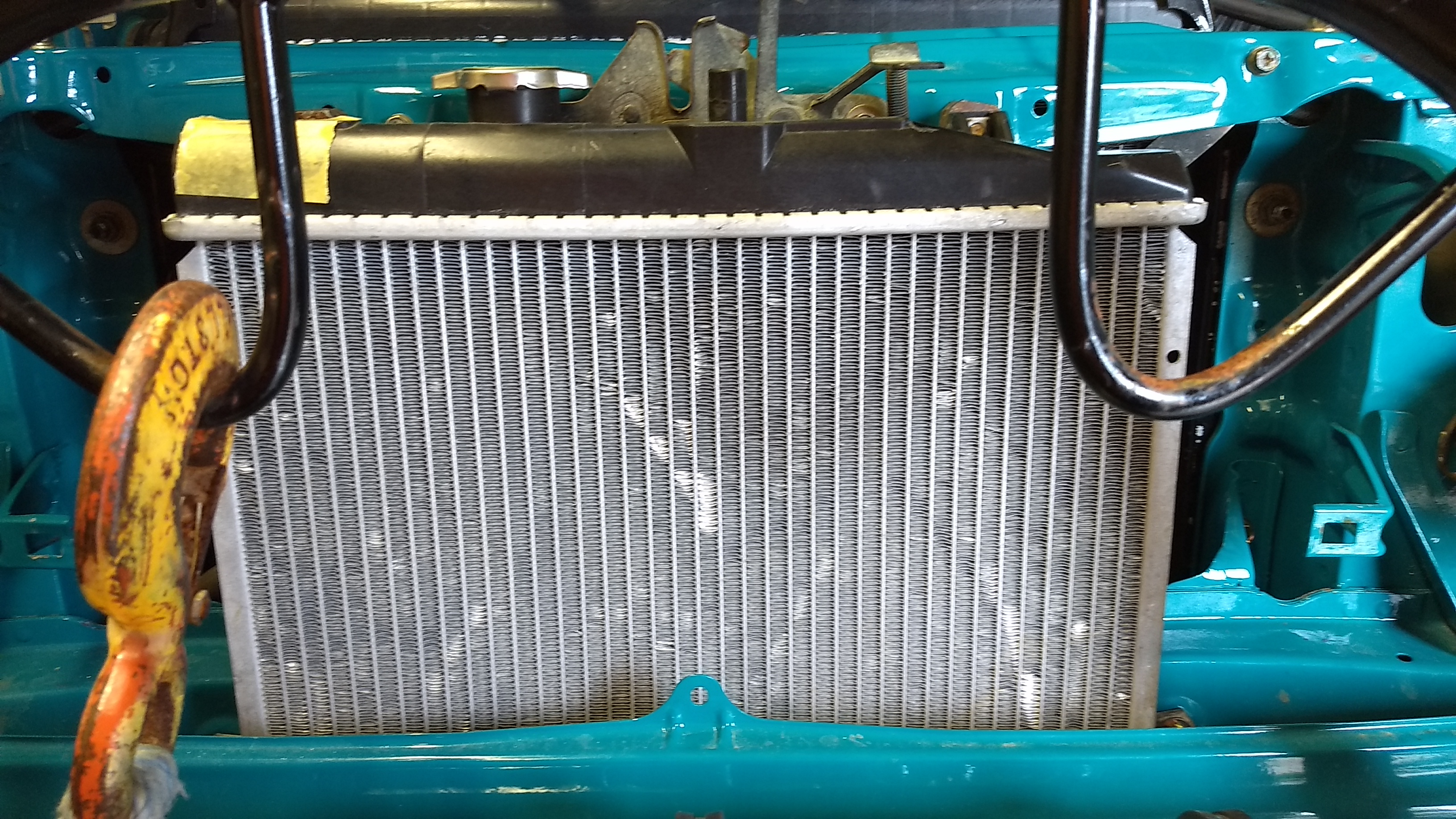

I originally had a read mount radiator, worked fine off road but I had troubles keeping her cool on road, the fans pretty much stayed on all the time.
My concern was if I ever lost fans then I am dead in the water as it WILL overheat.
So made the decision to put it back to factory with a radiator up the front.
This had the effect of having to move my Intercooler radiator.
But with some cunning placement of vibration dampeners I found in in my box of bits and some factory holes in the radiator support panel a new home was located.
