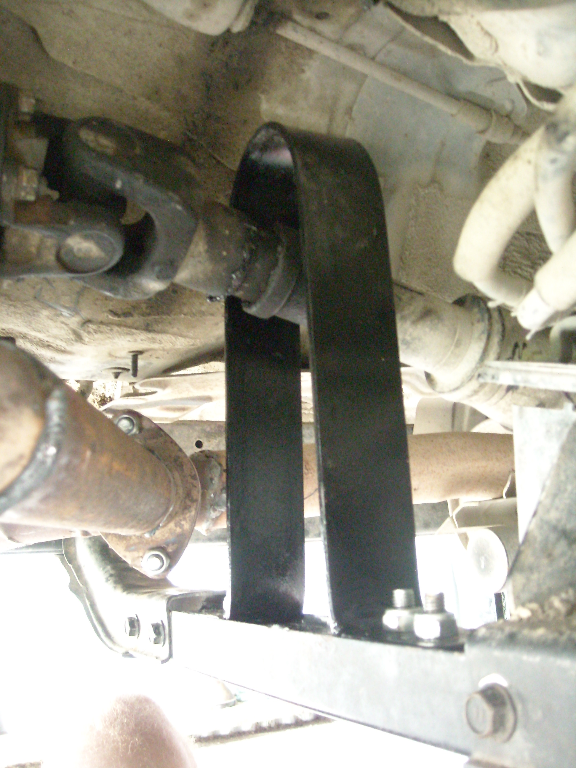

rear driveshaft hoop done. 50x5mm flat & 4x 10mm 8.8 bolts so hopefully pass cert.

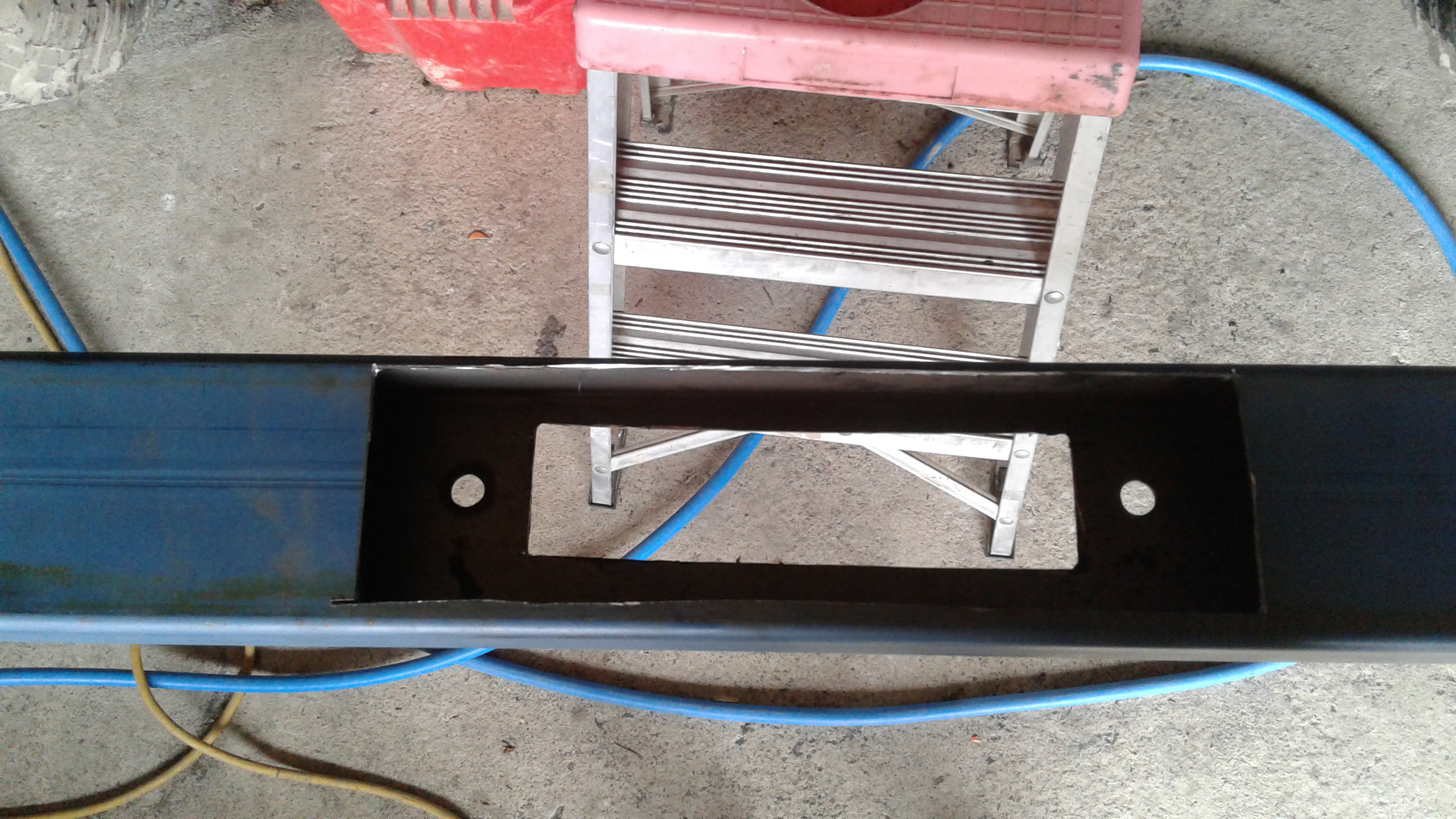

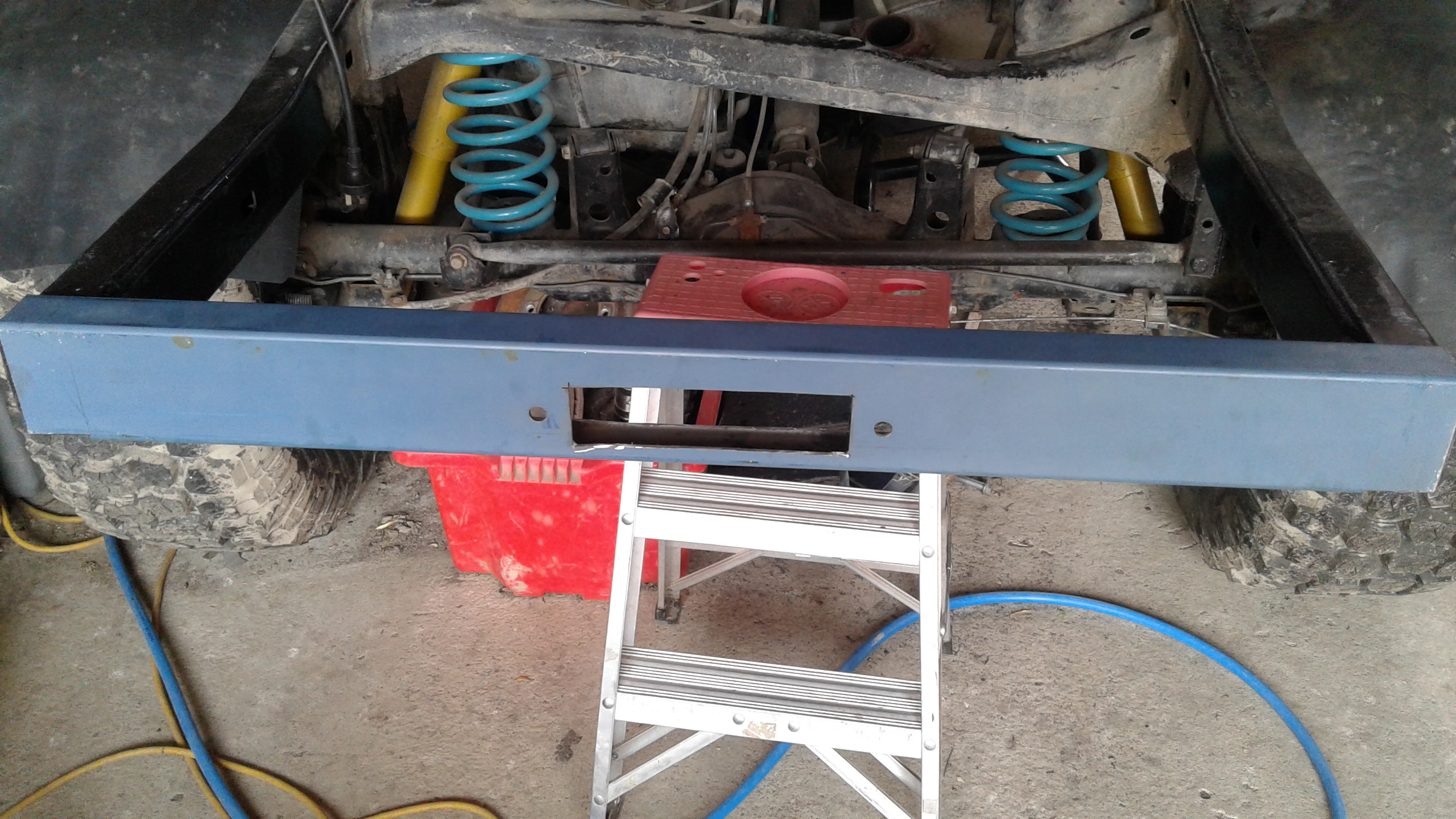

front bar made.
thanks baden.
next job bar off, paint it. next weekend swap rear diff for the prado diff & 4" lifted springs. bleed brakes. then fit (hopefully can figure it out) the TRD supercharger etc.

Re: 96 v6 surf
1st coat of paint tonight.

tonight's jobs are put another coat of paint onto front bar, & trim shroud because fan blades are hitting it, new viscous hub is a bit longer than the old one.

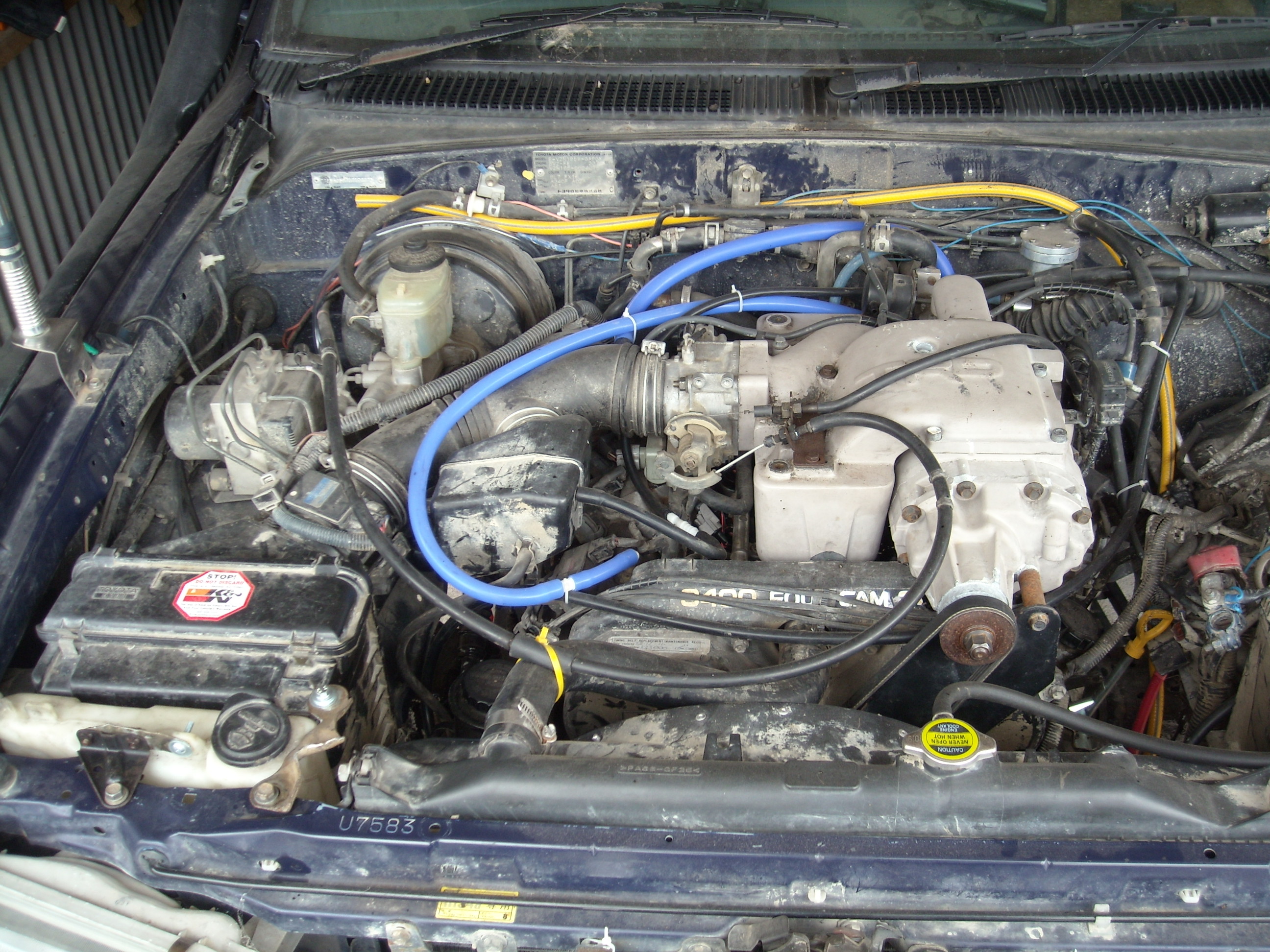

supercharger on, hoses hooked up. can't try it cos it won't start.

bar on, lights fitted apart from indicators. winch in but rope not on yet. bash plate will go on when I have made some 90 degree bends for the trans cooler hoses. still need to swap hubs to surf ones, will be a bit wider then to match rear.

That's a pretty neat fit with the supercharger with regards to manifolds etc, nice and compact
Toyhatsu Bitsalux
Re: 96 v6 surf
Mehrts wrote:That's a pretty neat fit with the supercharger with regards to manifolds etc, nice and compact
TRD, so just bolts into place. vacuum hoses are different lengths but otherwise straight swap.

is now running, ended up being a plug unplugged behind dash but still vacuum to sort.

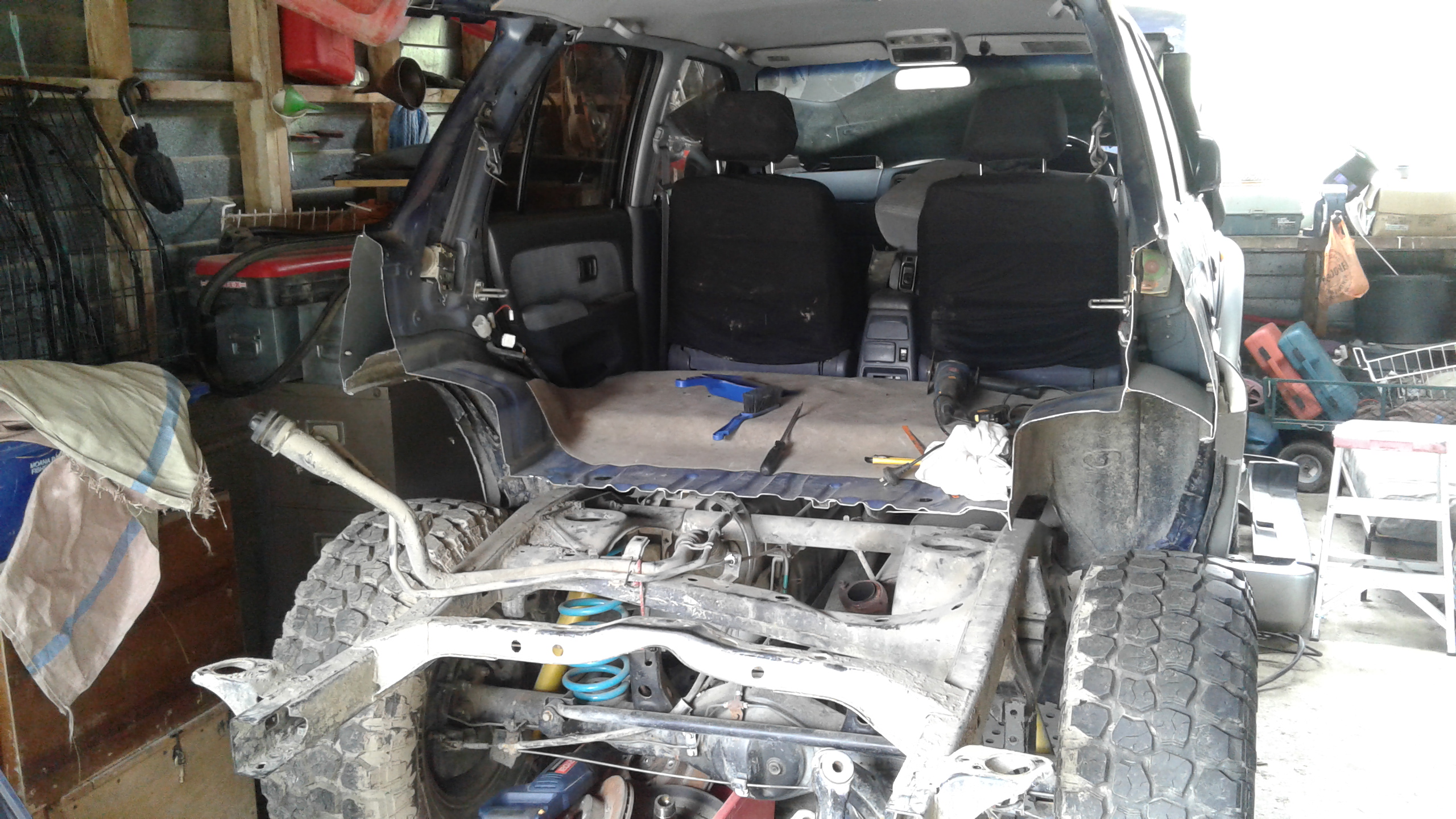

back nearly stripped out ready for cutting. roof lining to unclip and windows to take out.
seats can stay there until back is in right place then take them out.

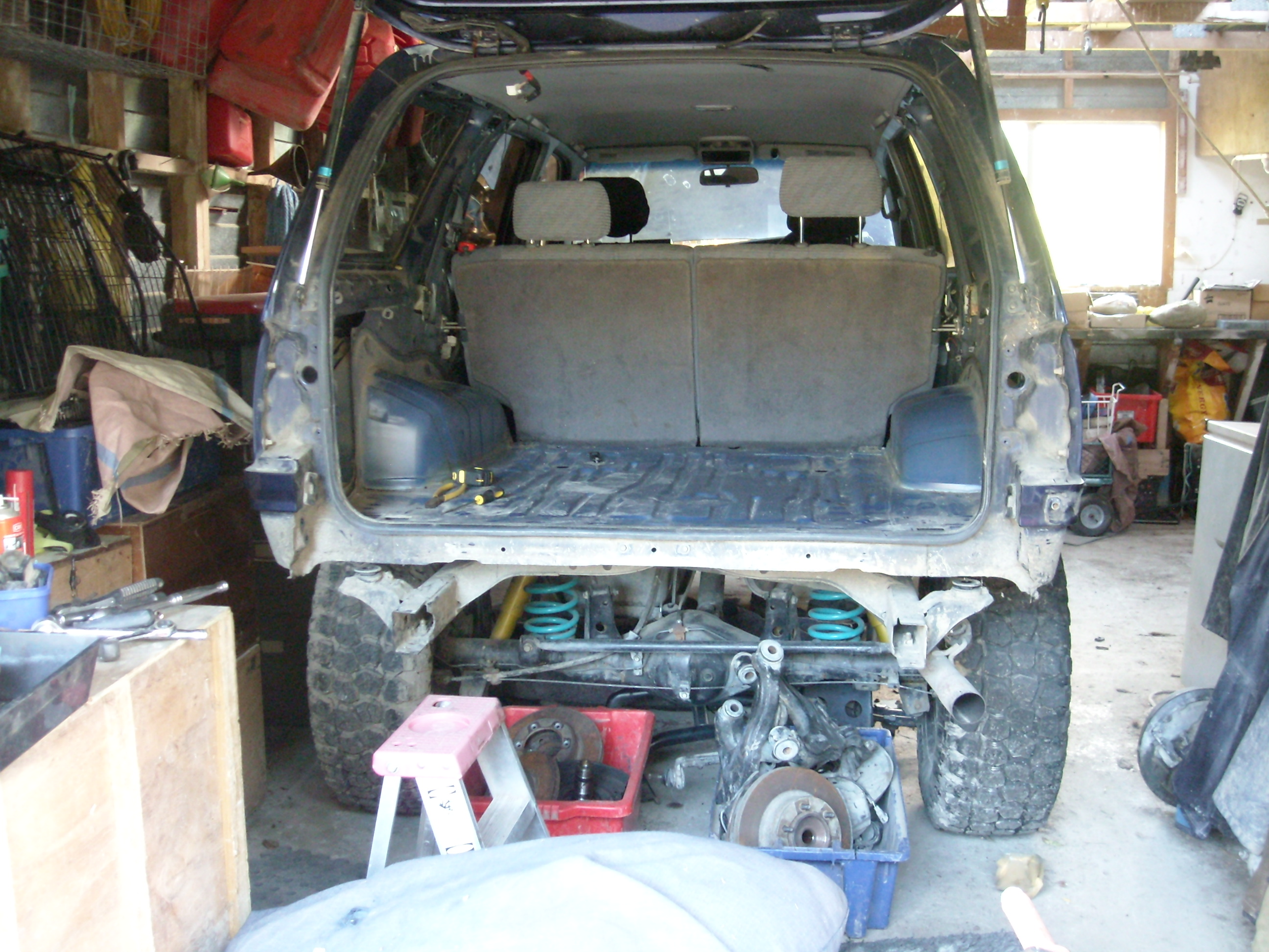

Re: 96 v6 surf
no going back now.
Re: 96 v6 surf
Now just got to measure where it's going to fit and cut it neater. seat belts dictate where back goes.

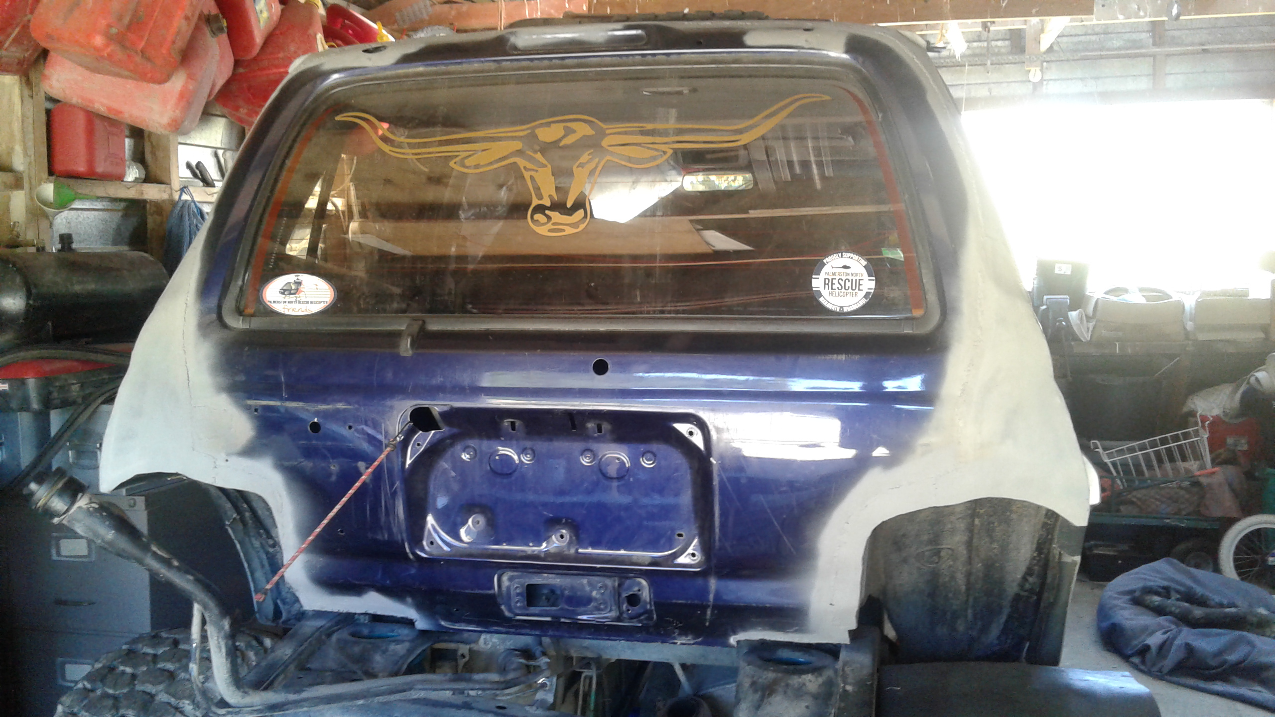

A bit done, partly bird pood in. A few gaps where not cut flush, will cut guards and pull gaps closed, won't be visible behind deck anyway.

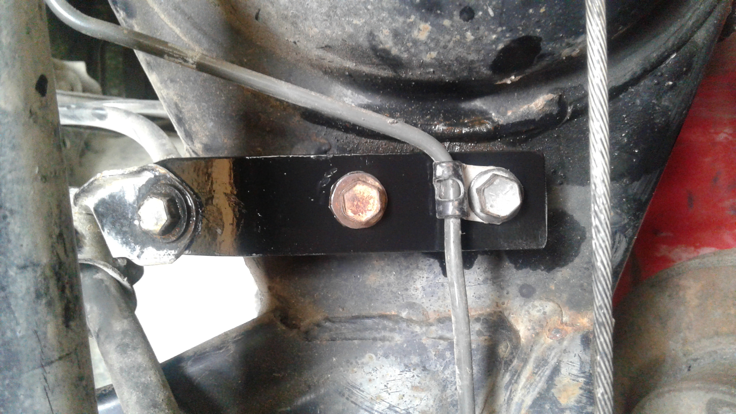

Big achievement for the weekend, made an extension for handbrake cable holder thingy

I'm pretty sure that drive shaft hoop will require another piece in the middle to encapsulate the drive shaft more . If it broke and traveled the length of the u bend it would have no trouble whipping all that off

sirLachlan wrote:I'm pretty sure that drive shaft hoop will require another piece in the middle to encapsulate the drive shaft more .
I have wondered if that would be the case, so will end up making another piece to bolt in centre closer to the driveshaft. another job added to the list.

All closed in, just some bog to smooth off and paint. quite pleased considering it's the first time i've used a mig.

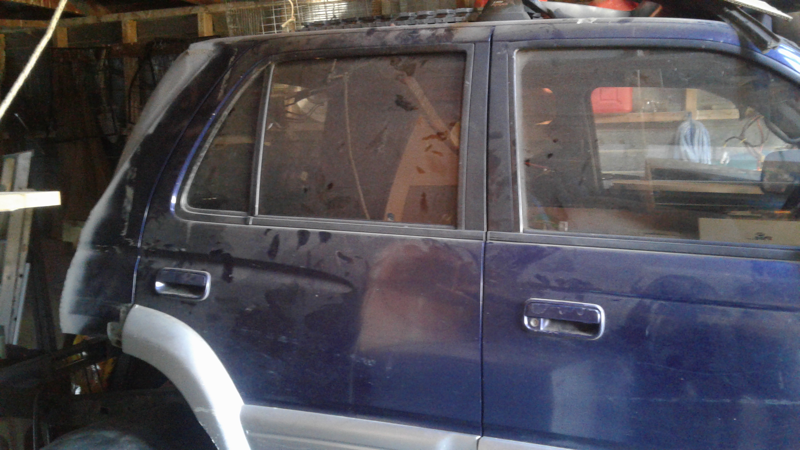

BlakeNZ wrote:Any side on photos?
have tried to take a sideish on photo but not much room in shed, i'll add off my phone.
