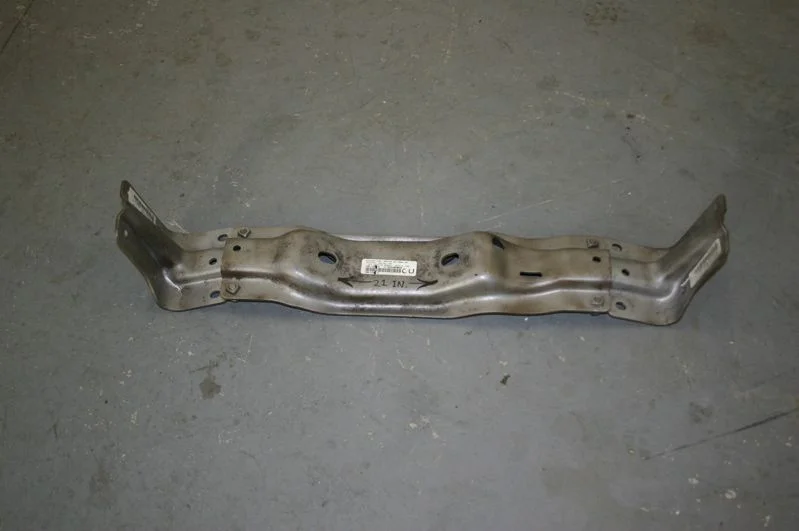

Pj_Marsh
Posts: 193
Joined: Mon Feb 20, 2012 5:46 pm
Re: 60 series crossmember
Postby Pj_Marsh » Fri Apr 22, 2016 4:54 pm
should be approx 530 mm. Hard to tell without the right mounts, but it will look a bit like this:

Postby derk » Fri Apr 22, 2016 5:26 pm
is there some reason you cant or don't want to use a late model 40 series crossmember (other than them being a bit hard to find) you'll only be shifting it a short distance from where they usually mount so it should be the right width to fit your chassis
Pj_Marsh
Posts: 193
Postby Pj_Marsh » Fri Apr 22, 2016 5:53 pm
I'd give it a try if I could find one, what year would i find one on? Also, does it use those L-brackets? Have to find a pair of those too
