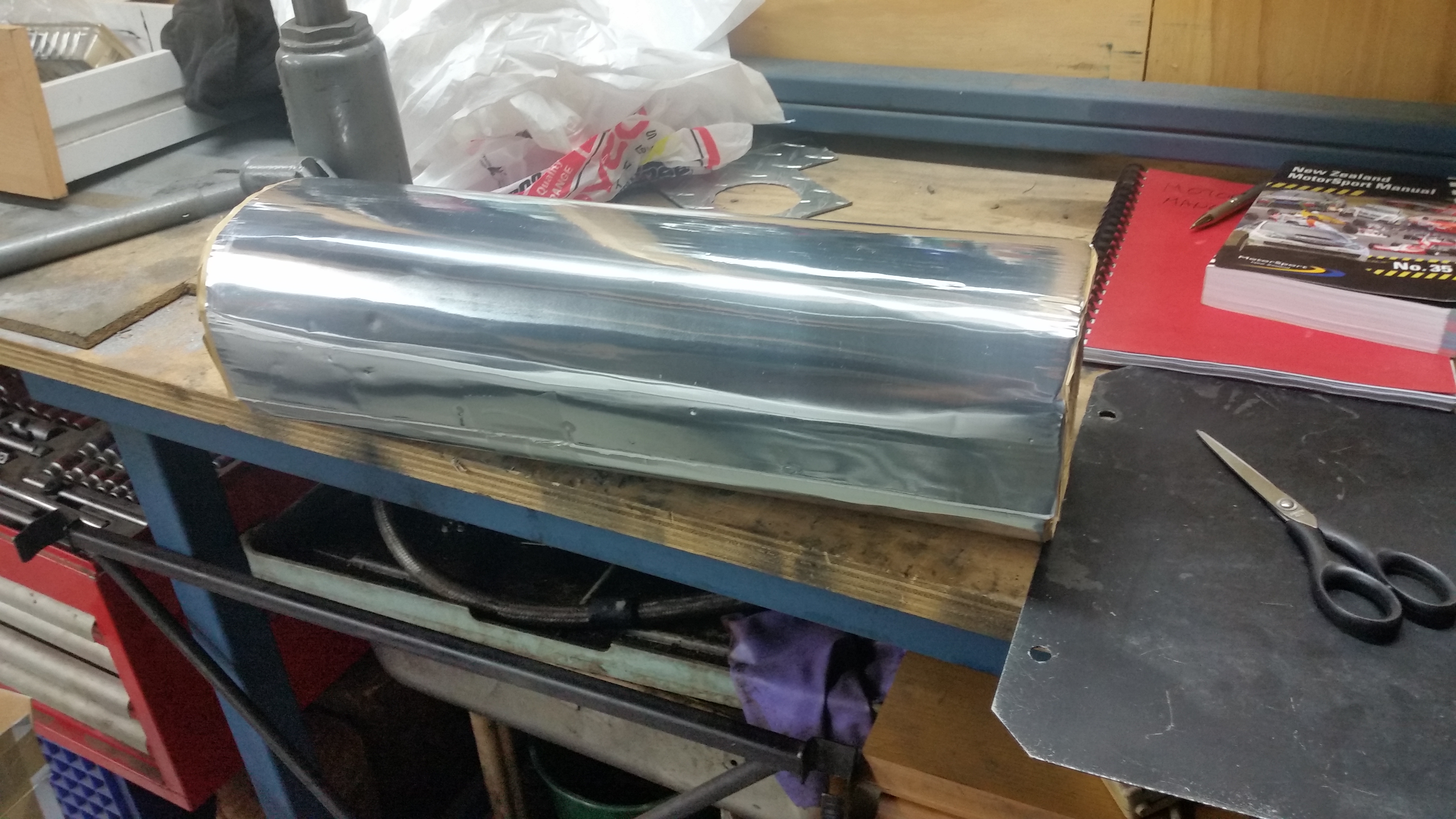

Im removing my reserve fuel tank as it's always leaked, even with the POR15 tank sealer in their so, time to make a new one from alloy so I don't have to carry around jerry cans. Also planning on making another primary tank with internal fuel pump and surge tank so I don't have to listen to the noise of the external fuel pump whining, which gets a bit tiring at the end of a long day.

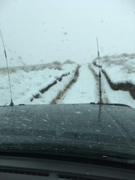

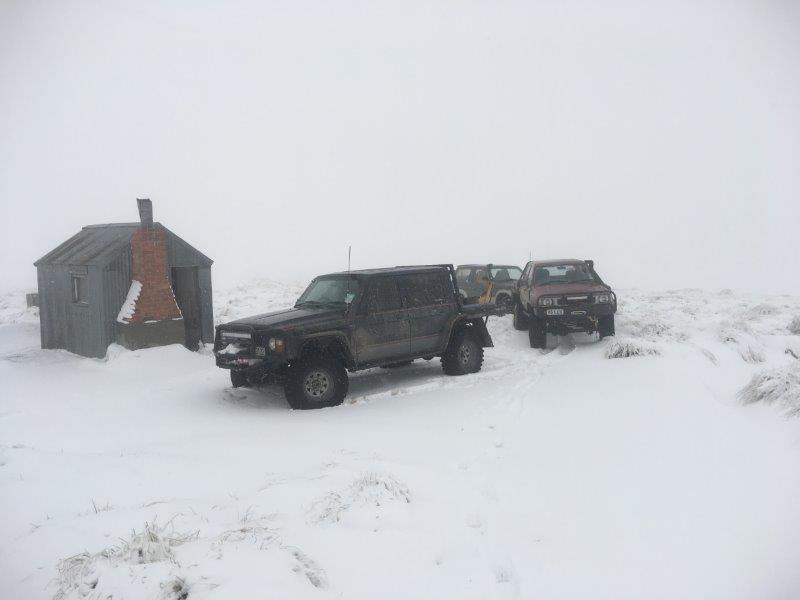

Gave some fellas a tow that had got over the snow while it was frozen, thawed out and they found it a bit tougher to get back

So after a bit of a play in the snow we headed over the Nevis. Couldn't even take the old Woman range to get their, so went via the old clyde-cromwell road, came out at Bannockburn and headed up and over.

Finally bought some sound deadening. 6m roll 460mm wide for $165 to the door step off trademe.
Just did little trial on part of seat box tonight. Will rip out the whole seat box on Saturday.
Thought I'd take a few pics of this one. I'm not planning on sticking any to steel at this stage, only alloy.
Want to do entire seat box, floor, rear bulk head, doors and double layer the gearbox tunnel and I think that will pretty much shag the roll.
Re: V8 Land Rover project
I need to get some of this now, have changed my plan. Have bought a new moulded marine carpet for the 80, and want to put stick stuff like this to it as a backing. are you going to glue it? let us know what the sound absorption's like.
Who knew Prados could fly?
So this is the seatbox and underside of the floor all done. Also took it for a small test drive from Cromwell to the new place in Tauranga Noticeably better. Also managed to do the rear bulk head with the one roll and the gearbox tunnel got a couple of layers for good measure.
It seems to be handelling the underside of the truck fine in terms of heat and oil but I haven't hit it with the water blaster yet which is probably the only thing which would make a real mess of it.
Other than that, any joins it spooges out, kinda has the consistency of dried up chewing gum. I overlapped everything because I figured it would kinda deform and seal where the panels join more than if I had cut them short. Also less likely to peel off I figured.
Next up is a roof liner I think. Try reduce the tin can effect
