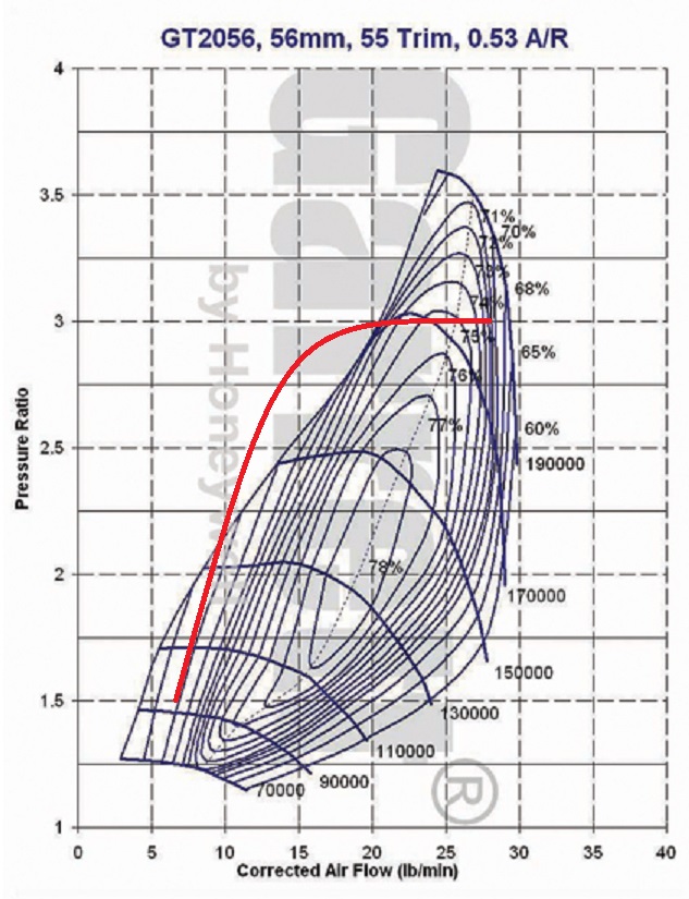

Ive seen the antisurge vs non antisurge on compressor maps, it pulls the efficiency more to the left with the antisurge housing.
Im convinced im getting surge beyond where an antisurge housing would help. If I had some way to bring the boost up slower, it would work. No problems at 18psi. But if we go to 30psi, lock into a gear, 3000rpm is @ 30psi = sweet but 2000rpm is also @ 30psi = big flutter. Luckily I was able to identify the problem the instant I heard the flutter and didnt keep plodding round with a grenade on the side of my motor. Easily avoidable with throttle control or reducing total boost.
I know the compressor is to large but I dont care. It can work if controlled right.
I need it controlled so that 2000rpm is 18psi and then 3000rpm is 30psi. According to the compressor map, this will work. According to my real world testing, this will work. But the damn diesel will make 30psi at 2000rpm. Boom.

Thought I'd post this just in case someone with the same problem stumbles across this thread.
Here is what I had
Heres what I have now
The first was massive surge because the compressor was too large/turbine housing too small resulting in the boost building to quickly for the engine to consume it.
After contemplating buying yet another turbo $$$ and building yet another downpipe I was able to buy this thing here https://sirhclabs.com/ (mods remove if not allowed) and control the boost by only the engine speed - rpms and more importantly in my case - airflow. The cortex ebc seems a powerful unit for the price - to get similar control from other well known brands I was looking at $900+. I couldnt find many reviews online so I took the plunge and so far I'm happy as. hope it lasts and hope someone finds this information useful.
