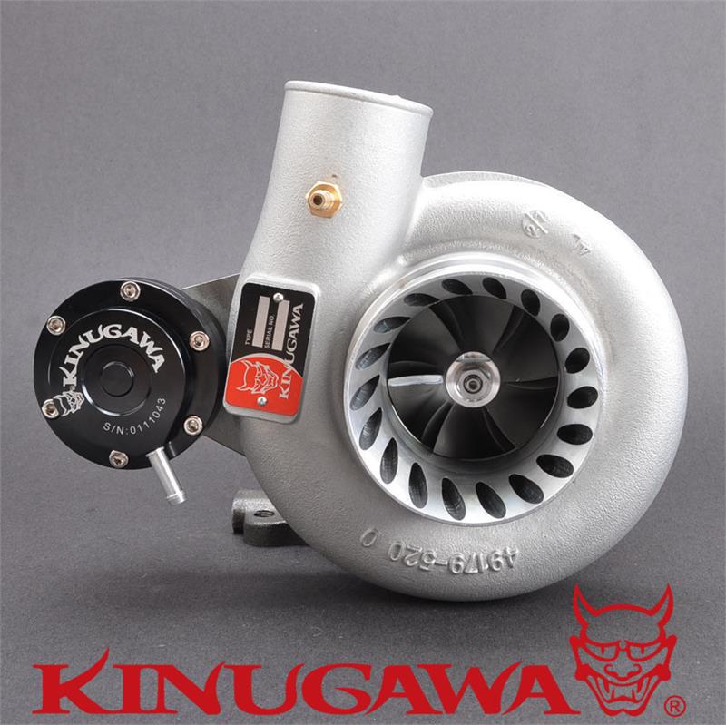

Does that Kinagawa turbo have the antisurge housing on it?
Ive got one on my td42 and it makes the noises ur talking about? and its just the antisurge housing doing its thing, sounds exactly like a blow off valve when you get of the gas

Nah, dont have a pic, easy to tell though, has a heap of holes drilled around the inlet to the compressor
Madaz
Posts: 1040
Joined: Mon Sep 05, 2005 12:00 pm
Re: Diesel turbo compressor surge/"bark"
Postby Madaz » Thu Apr 28, 2016 2:21 pm
Kinugawa-Turbocharger-3-Anti-Surge-DSM-Eclipse-EVO-1-3-VR4-TD06SL2-20G-7cm-Hsg-301.jpg

Postby fh2014 » Thu Apr 28, 2016 2:36 pm
no surge arrestor here.

Propper compressor surge like you describe is very hard on a turbo . And this isnt internet waffle no bov will wreck your turbo blah blah . This is compressor surge will kill it
All those holes drilled in the housing are for anti surge
They bleed a specific amount of air back around the tips of the wheel to combat surge
Honestly if you want a legitimate result talk to steve murch .

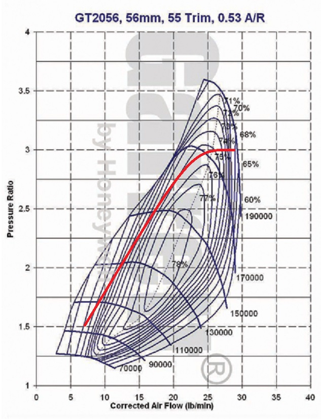

Thought I'd post this just in case someone with the same problem stumbles across this thread.
Here is what I had
Heres what I have now
The first was massive surge because the compressor was too large/turbine housing too small resulting in the boost building to quickly for the engine to consume it.
After contemplating buying yet another turbo $$$ and building yet another downpipe I was able to buy this thing here https://sirhclabs.com/ (mods remove if not allowed) and control the boost by only the engine speed - rpms and more importantly in my case - airflow. The cortex ebc seems a powerful unit for the price - to get similar control from other well known brands I was looking at $900+. I couldnt find many reviews online so I took the plunge and so far I'm happy as. hope it lasts and hope someone finds this information useful.
dvk-kp wrote:I had a Turbo Smart e boost street in my laurel and I could control how it came on boost with it. Worked well. Works up to 40 psi too. Can't see why it wouldn't do th same on a diesel.
I looked at this, good entry level unit but can only control boost with a speed signal, not an RPM signal.
