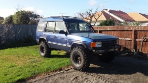

I have just done a dual battery conversion in my D1. Relocated the power steer res and a few other bits and bobs and now have two batteries in stockish locations.
Have a pair of 650CCA's and have an upgraded 150amp alternator.

Mattman wrote:New truck small.jpg
You got a build thread of this???? Looks really nicely built

Will do a build thread shortly, in the next few weeks hope to have it mostly complete for the first part of the project.
When I got it it was certed for 33 as and the lift and had a very well done guard chop.
Land cruiser 80 series diffs, elocker front, auto locker rear, chromolly axles and cvs, 5in lift with dislocation cones, beadlocked 35s, winch, fual batteries, big alternator, side bars, onboard air.
Phase 2 is ute chop, rear mount radiator, 4.8 gears, exo.
Matt.
