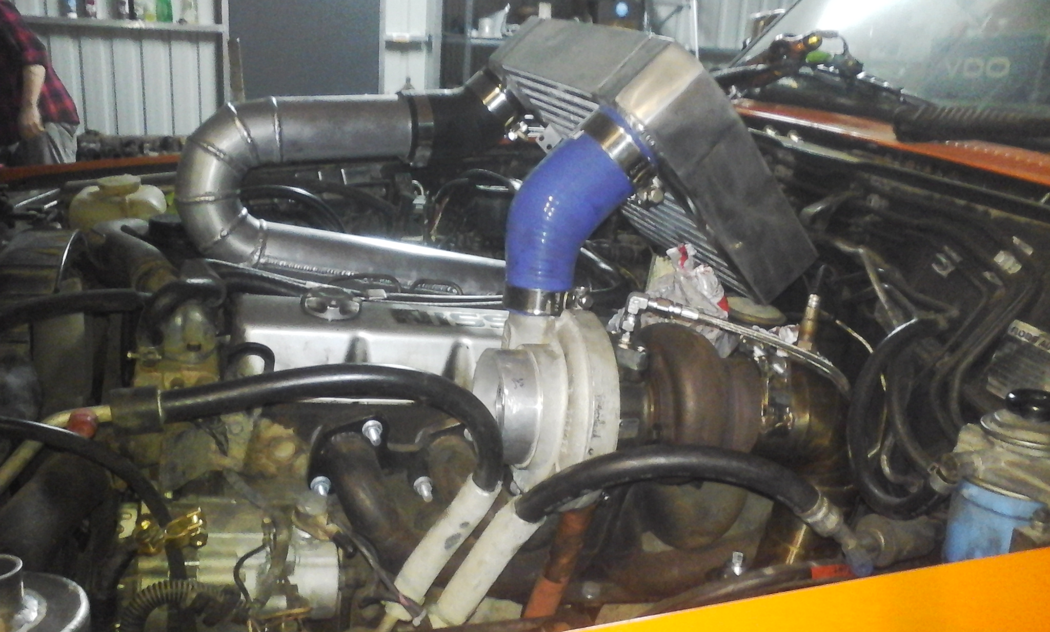

you can't pile up intake charge when you have intake cycle vacuuming it away, wedge shape is just to maintain air velocity and volume down the length of the manifold.
i'm running one on my gq currently with very lean afr's and 450c max egt's , very happy with it plenty of potential to crank it up.

i think its time for the next evolution.
a quick google search will reveal a miriad of 24valve diesel in europe making up to 550hp.
is that even feasible on a td42? probably not...but one thing you do notice is the use of the standard manifold,
insignificant you may suggest? until you dig further an touch on volumetric efficiency harmonics and resonance.
so the theory of it is with each valve closure a pressure wave bounces back up the inlet runner at the speed of sound until it bounces off something else till it returns and repeats the bouncing back and forth till the valve reopens,
so by running a longer runner there will be less bounces and the pressure wave can be timed to be right at the valve in time for opening ie tuned length.
beauty of this is the calculators are all on the web already.
next step is fitting 280mm runners to the next manifold so that on every valve opening the 6th cycle of the pressure wave has arrived at the valve just as it opens
problems are only a problem if you not willing to learn how to find solutions

slidenyo wrote:i think its time for the next evolution.
they are not far off that.
however they are breaking cranks rather regully which is imposing a limit.
the 2 valve per cyl head does make it very difficult.
most of that is all great in theory.
its also relative to the stye if intake port and big part of those calc's are vacuum based. on a lowish rpm diesel thats almost always on boost, the calc's don't translate into real world performance.
if you read through whats been tried and tested over the last 20 years or so, you will see that they actually recommend very short runners for the TD42.
slidenyo

yeah i wonder what my 290k engine is poking out now?
i know its surprisingly quick to other motorists but its not 550hp fast by any means.
have to tutu further an see what changes with different intake.
tweake pressure waves like sound waves will diminish with collisions with solids and other waves , losing potential energy that could assist in charging the cylinder.
like a tunnel rammed petrol motor you are utilising these pressure waves to increase v.e an essentially get boost for free.
on mr turbo diesel the benefit would be easier cylinder filling , even air distribution?
might just start by lopping a cylinder off a couple qd32 intakes an blast them together

slidenyo wrote:tweake pressure waves like sound waves will diminish with collisions with solids and other waves , losing potential energy that could assist in charging the cylinder.
this is why i say go chat to to guys like old mav. there is a reason that it never worked for them and they spend huge amount of flow bench and dyno time on it. save your self the time and $$$.
you can make a tuned manifold easy enough and it will "work" but that doesn't mean its going to match everything else and be better than the typical intake mods.
your only looking at one small part of the whole picture.
what works in theory doesn't necessarily work in practice.
tuning the manifold is all good but is it going to be enough to counteract what you loose in plumbing losses and also manifold volume.
by making long runners your adding quite a bit of volume which is going to add lag.
you still need a big enough plenum to achieve even air distribution.
keep in mind the long qd32 manifold is the atmo version. the turbo version uses a short runner manifold.

a big turbo I have ,plus a balanced engine, the high big volume intake all add up to a reasonable system,
