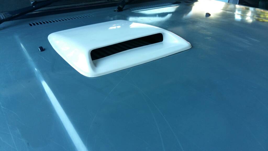

I am planning to do a custom scoop with two air channels so that front and back get a fair portion of wind. at the moment I have the scoop as used on HIlux, came with kit.

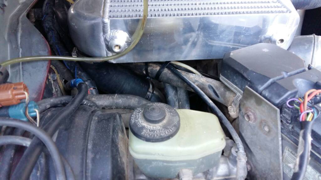

another one...the core is slightly wider than the factory IC but 3" thickness.

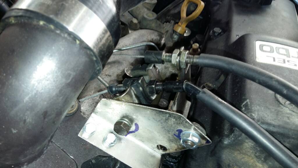

I have run a hose from wastegate to the adapter for the throttle body to receive pressure input from there instead of at the turbo outlet.
Finally I have changed the Fuel Pump setting by doing an extra 1/4 turn. At this setting there is absolutely no smoke at no time, not after start and not during full throttle. I guess there is some potential left but first I need to pass my road worthyness test in september.
that was pretty much it

Re: KZJ78 Intercooler and other Upgrades
Nice truck and some good work going on there. Great to see people giving it a go.
Intercooler looks like it would work fine for normal driving but slow off road would get heated up by the turbo below it. Suggest a heat shield and a fan if it would fit?

kbushnz wrote:Nice truck and some good work going on there. Great to see people giving it a go.
Thanks Calvin!
You are right and I´m also worried about the heat in that compartment. the engine bay is so cramped and the IC basically rests on the AC tubes and next to it is the Webasto heater. Nevertheless I plan to do something like heat shield and fan. for the heat shield I´m not sure how to do it best. I don´t dare to cover the heat shield of the turbo with another layer of insulation as this metal sheet has some cooling slits. would this matter? regarding the fan I´ve seen a lot on Ebay like 8" diameter but I would really need something more compact as I can´t put another 3" layer on the IC itself. Any ideas?

so, I followed Calvin´s advice and gave it another shot...
space is too tight for a fan underneath the IC so I decided to put in an additional heatshield just between the heat shield of the turbo (there are cooling slits right up to the IC ) and the IC itself. would say there is a clearance of about 2,5 " between the two.
was thinking how to do that and was searching the garage for some tin sheet when I found the lid of an old Wok pan
as I like the recycling idea in general I just started to cut it out and bend it into shape an screwed it to the cylinder head.
as there is a nice airstream from the visco fan I finally decided to place some rubber mat from on top of the fan shroud to the lower side of the IC. this way there might be some air stream to blow away the hot air between the to metal sheets. or not. we will see. trial and error but better than before I guess. hope it won´t harm the turbo ?
[/attachment]
[/attachment]

so....did like 4000 km now with the IC fitted and still glad I did it. good torque and accelaration.
put in an 8" fan below the IC now to support it at low speeds. as it´s autumn now so we are having temperatures at below 10 celsius, summer will tell how it works.

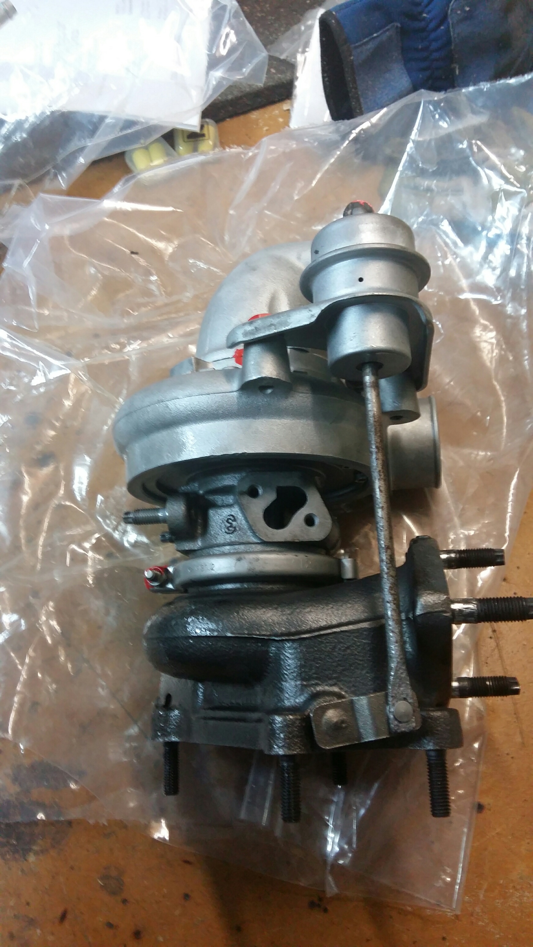

so, having said this I searched for my old turbo which was quite worn and rattling and took it to a turbo shop. found that the waste gate exit hat a crack as well and the turbine was grinding on the insides. anyways they said it´s a solid basis for revamp and I decided to go for a bigger wheel which is 4-5mm bigger in diameter cnc cut etc., the upgrade vs revamp is only about 200 euro plus so why not whilest at it? totals to 650.
have to wait for another week until i get it back. they promise the same boost at lower turbo revs plus the reserve of extra air at max. revs.
will set it to 0,9 - 1.0 bar then.
it will take me some time to install the turbo as autumn has arrived quickly and I need to find time and space inside my cramped garage.

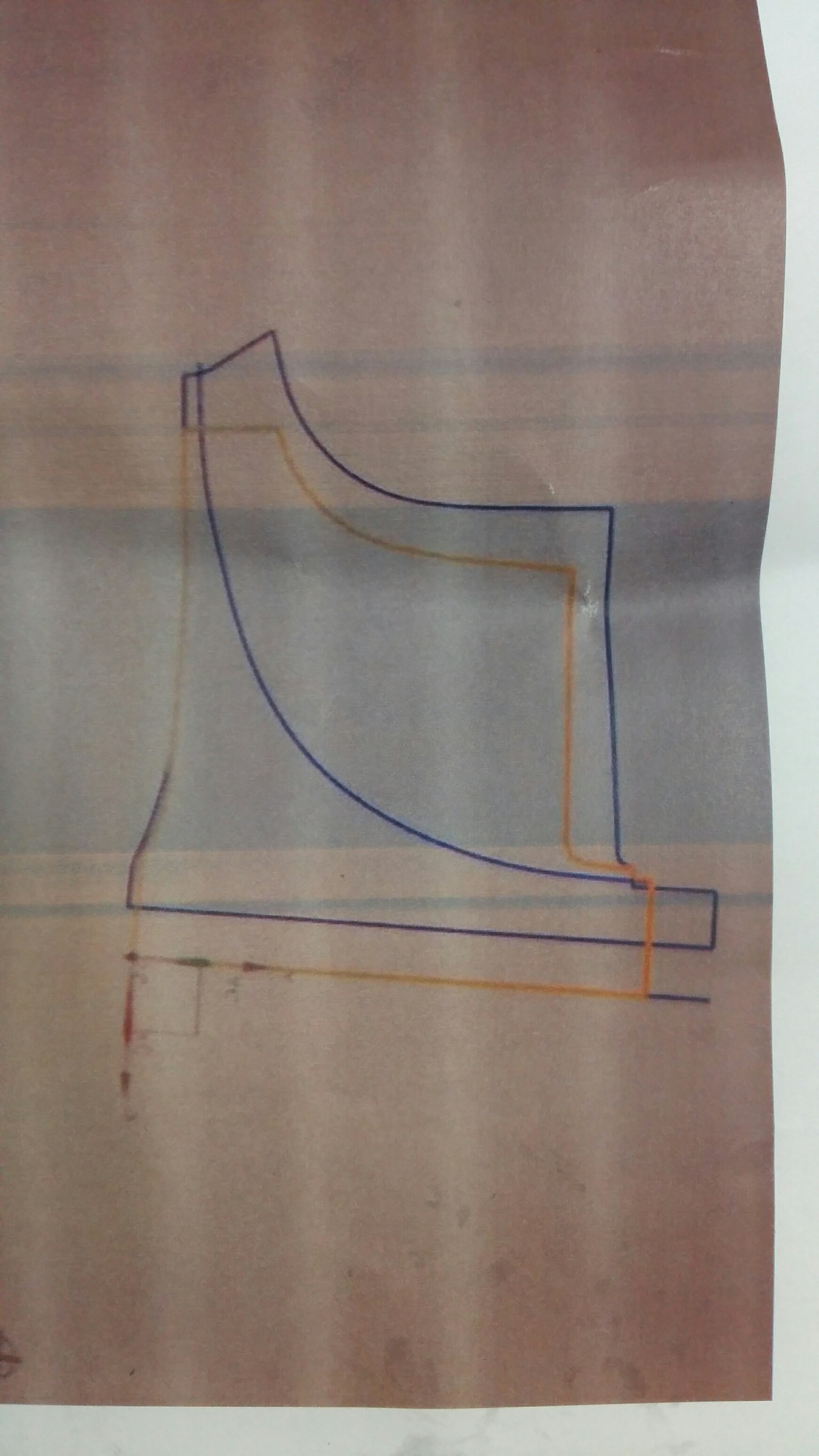

refurbished turbo is here.
they threw in a bigger compressor wheel, the latter plus 5mm in diameter... altough i said please don´t go too far.
will have to try I guess.
I will install it on friday and report back
