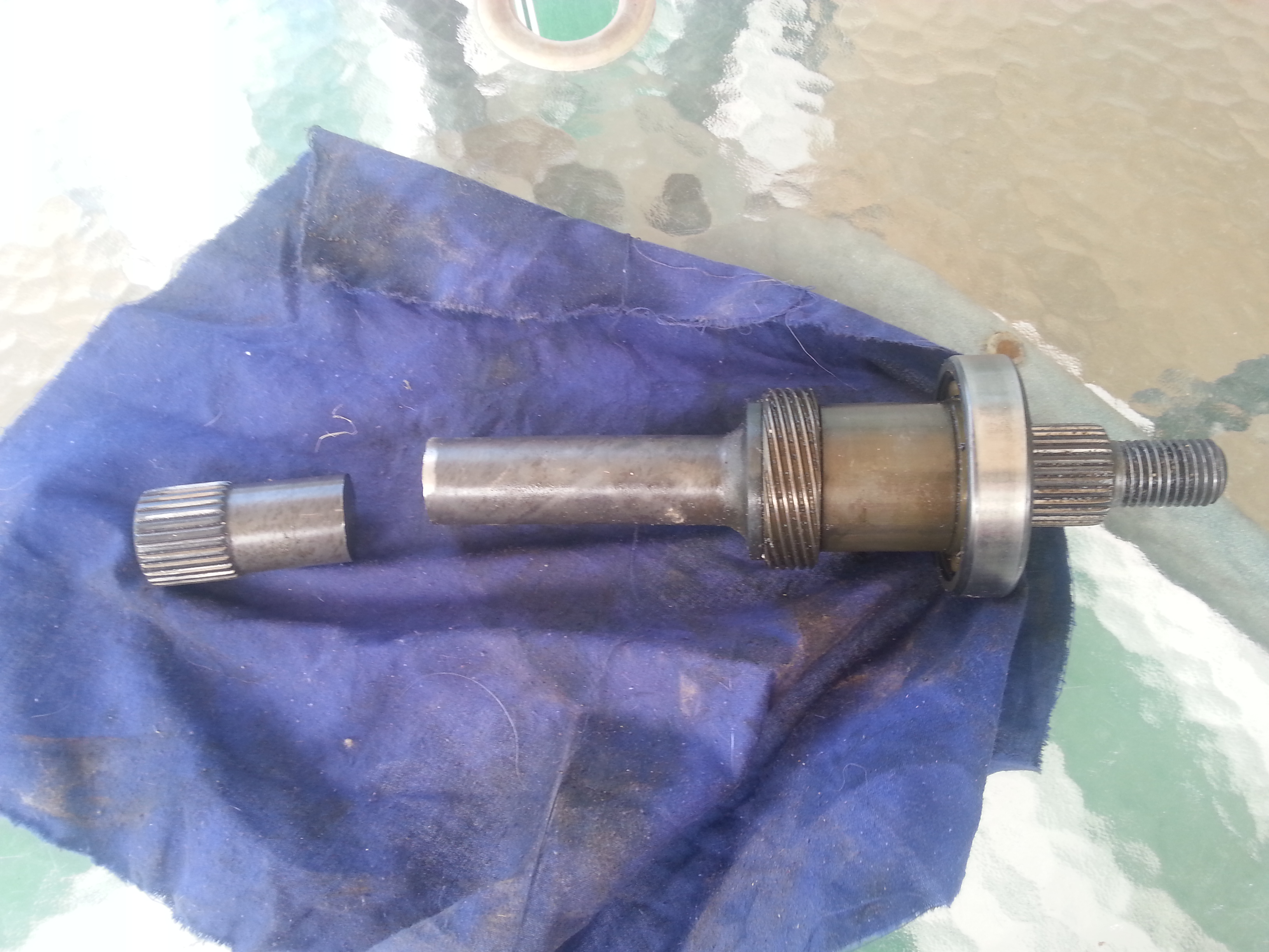

Almost to the top and bent the rear trailing arm climbing the last rock step. Collateral damage the whole engine/gearbox got shoved forward - broken mounts and fan disintegrated on front crossmember after chopping a power steering hose but radiator OK. No drive at rear - thought it was a diff pinion, but removed rear driveshaft and drove out in FWD. Turns out the rear output shaft has sheared.
So if anyone has a spare Landrover LT230 transfer Box lying around - I'm after parts....

Safari axles - cos I had a set and heard horror stories about how weak the Landrover diffs were. Surprisingly easy to fit - but I do have a mate with an engineering business. LSD front and ARB rear diffs. 4.1 ratio diffs are perfect with 35in tyres too. I expected the diff pinion or UJ to break with the extreme driveshaft angle but I guess the LR output shaft was the weakest point...

Thanks for the offer - but I found a gearbox locally.
