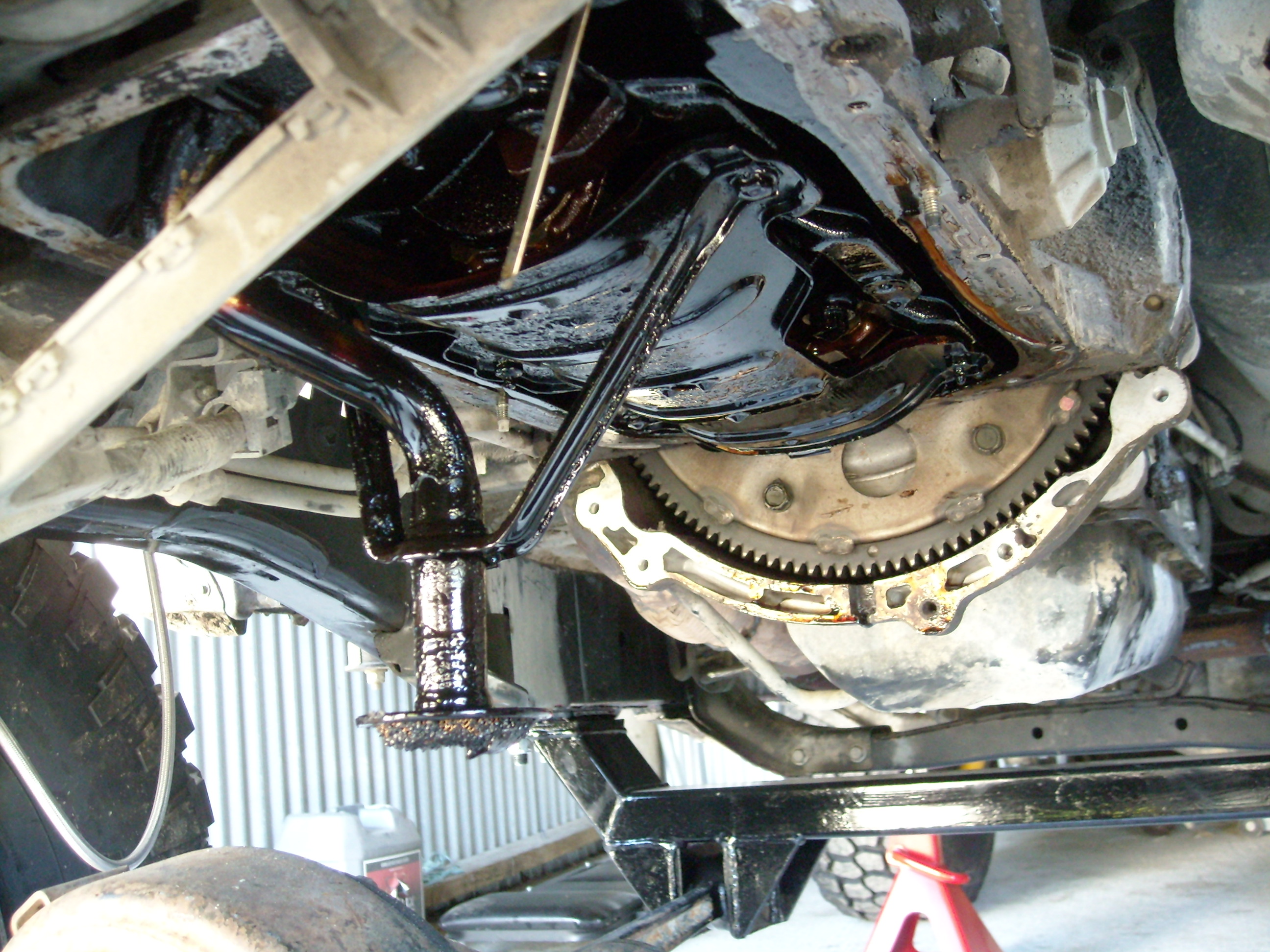

rear driveshaft hoop done. 50x5mm flat & 4x 10mm 8.8 bolts so hopefully pass cert.

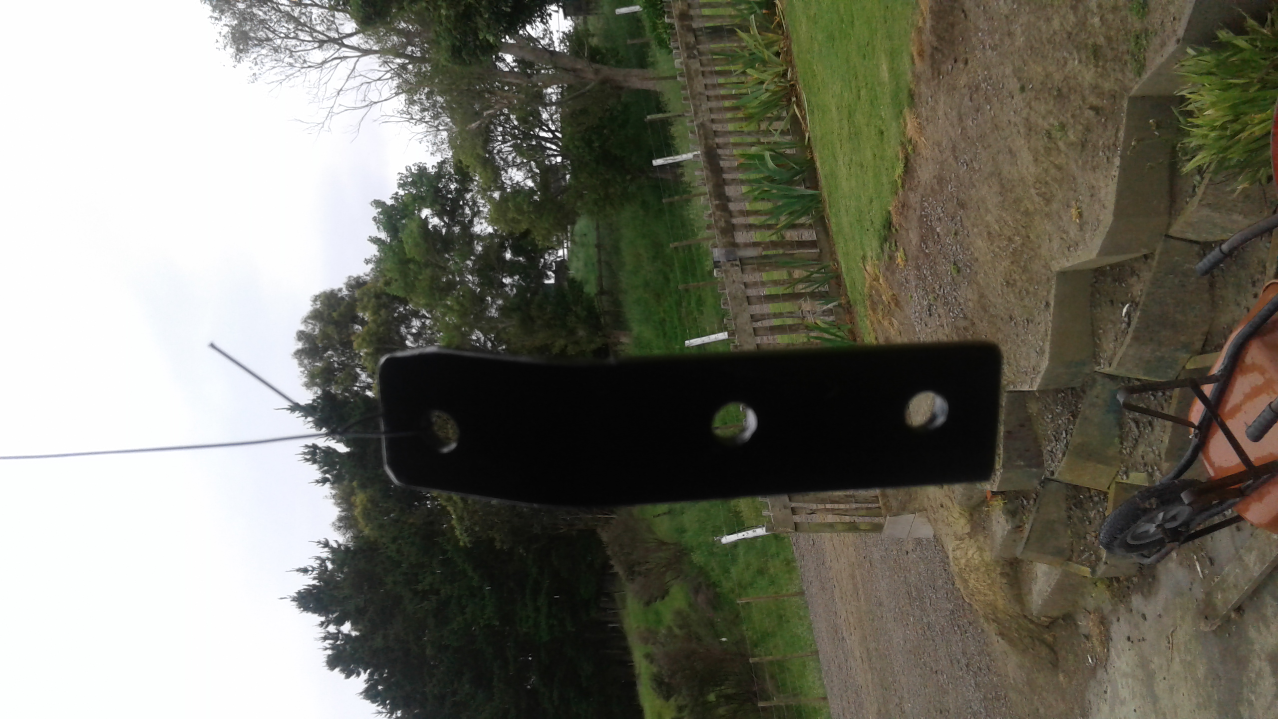

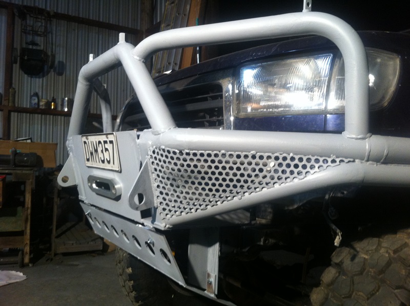

front bar made.
thanks baden.
next job bar off, paint it. next weekend swap rear diff for the prado diff & 4" lifted springs. bleed brakes. then fit (hopefully can figure it out) the TRD supercharger etc.

tonight's jobs are put another coat of paint onto front bar, & trim shroud because fan blades are hitting it, new viscous hub is a bit longer than the old one.

bar on, lights fitted apart from indicators. winch in but rope not on yet. bash plate will go on when I have made some 90 degree bends for the trans cooler hoses. still need to swap hubs to surf ones, will be a bit wider then to match rear.

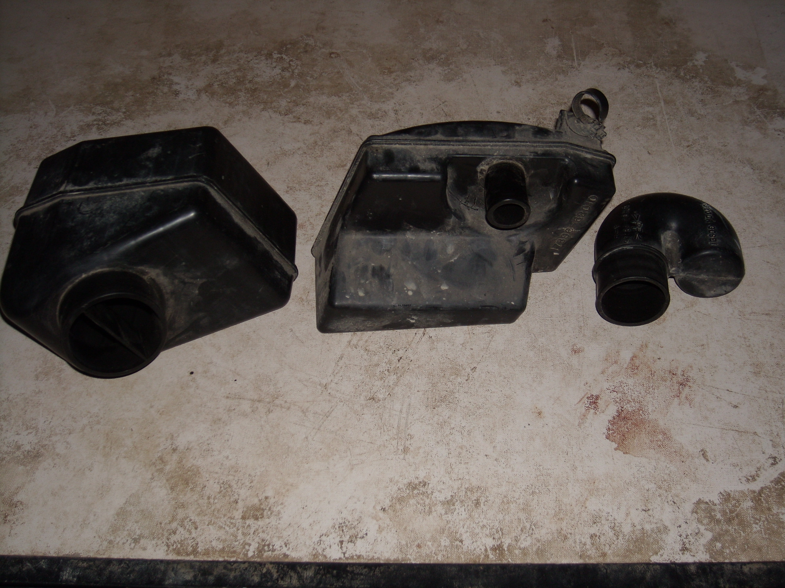

removed intake silencers, americans reckon a gain of 5-7RWHP so must do something, :) and supposed to sound gruntier too. :D
hopefully let the supercharger breath a little bit easier. 8)
removed these.

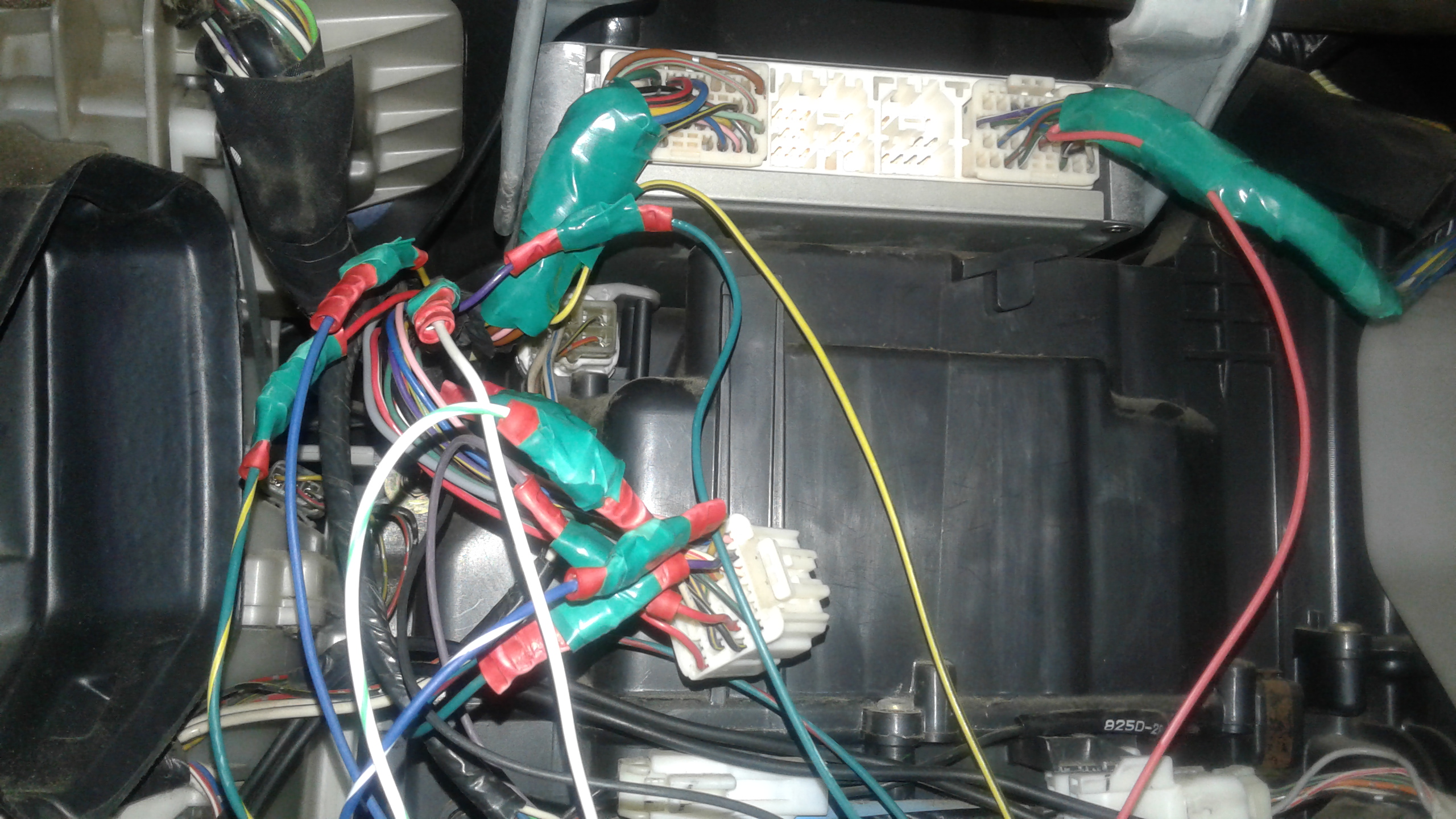

next job wire supercharger computer back in.

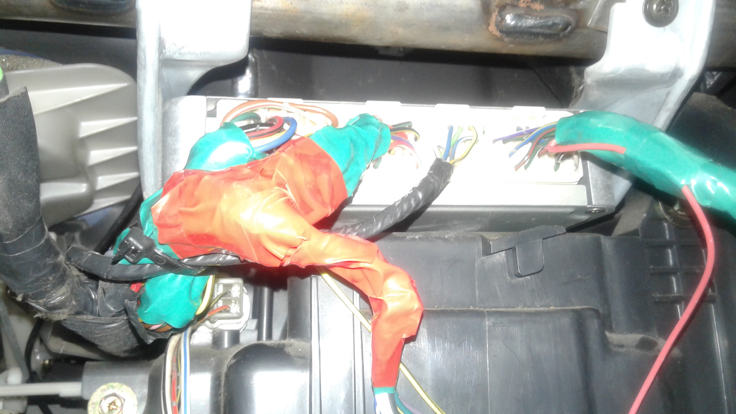

mudsurfv6
Posts: 640
Joined: Fri May 23, 2014 6:29 pm
Location: pahiatua
Re: 96 v6 surf
Postby mudsurfv6 » Sat Sep 24, 2016 5:00 pm
Sc computer wired :lol: :roll: in, haven't started it yet.
Auto sparkies close eyes now....
And a bit tidier.

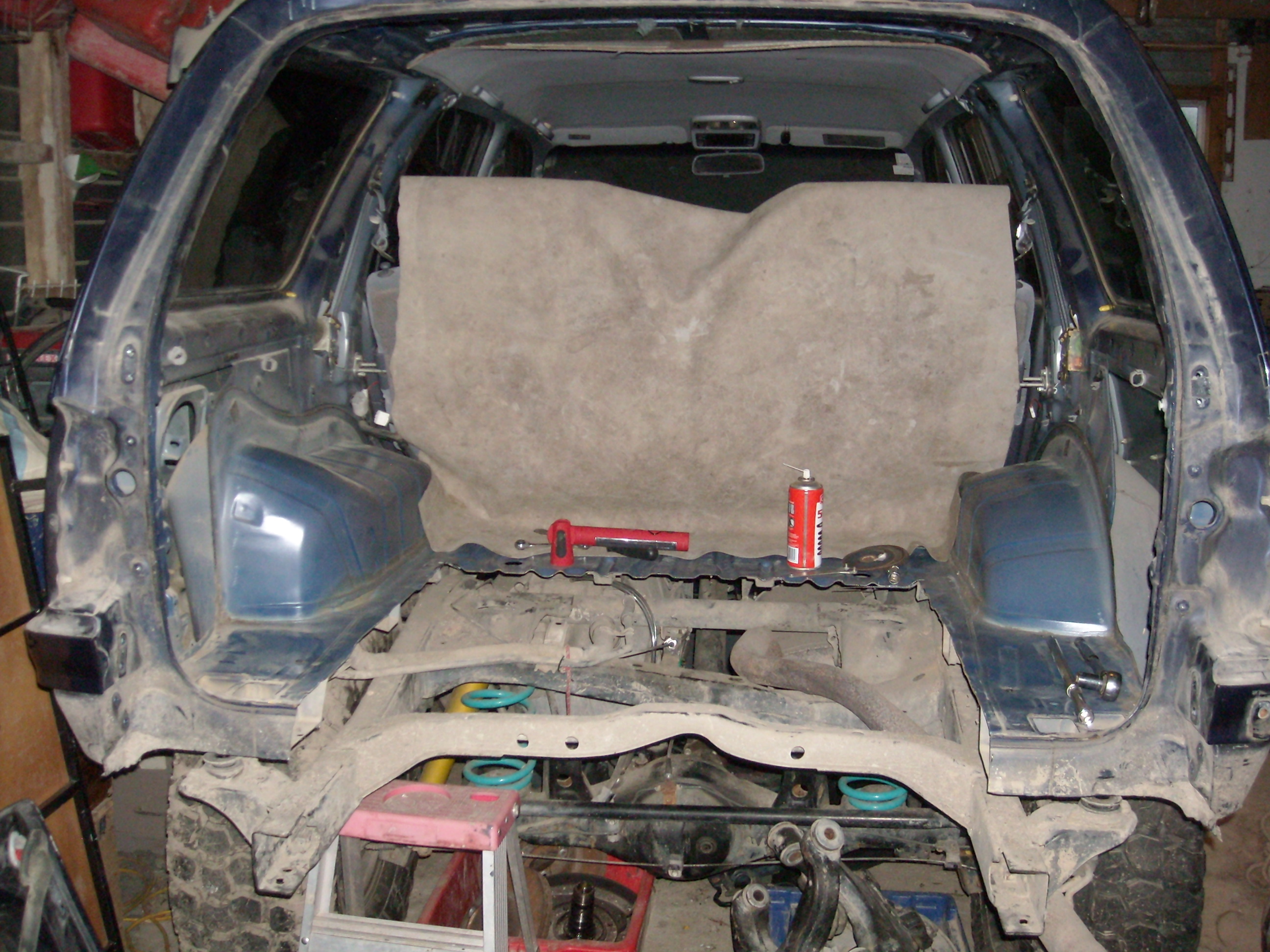

back nearly stripped out ready for cutting. roof lining to unclip and windows to take out.
seats can stay there until back is in right place then take them out.
1996 vzn185 surf, TRD supercharger, SAS, 35s, 4" lift, 2 lockers, ute chopped + more happening. Andrew 0272226292.

All closed in, just some bog to smooth off and paint. :D quite pleased considering it's the first time i've used a mig.

BlakeNZ wrote:Can i assume you are retaining the rear window function of being able to be wound down, electrically?
that was the plan, but would only go down to top of arches, which is about half way. also I had to cut the bottom off the runners the window slides in to fit around arches. so window now doesn't move.
plus the rear radiator will either be behind window on the left, or horizontal on roof straight above rear window so be safer if window didn't open anyway.
