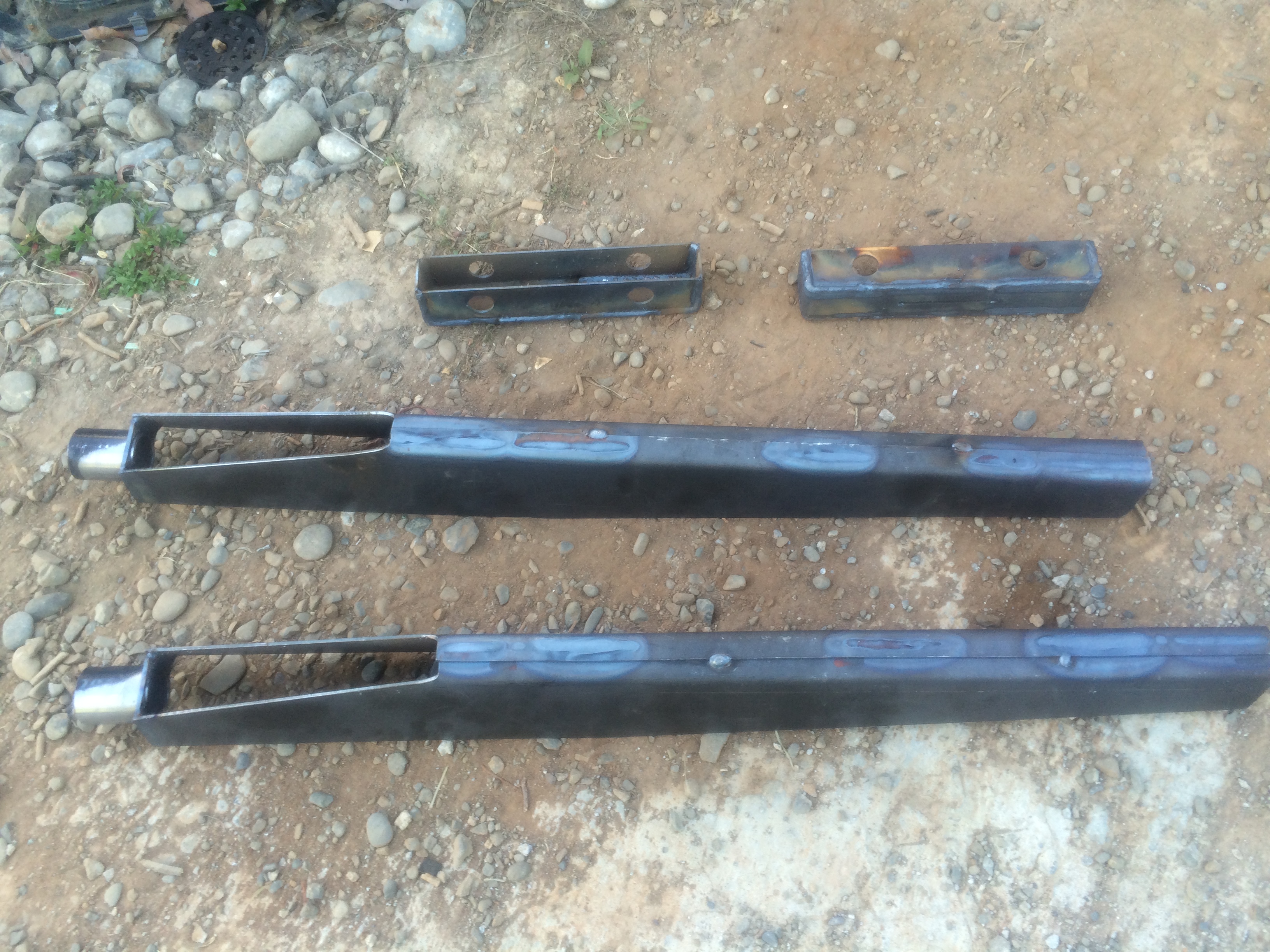

I guess the next step was welding them up.
Here's what I started with.
Then started putting it all together.

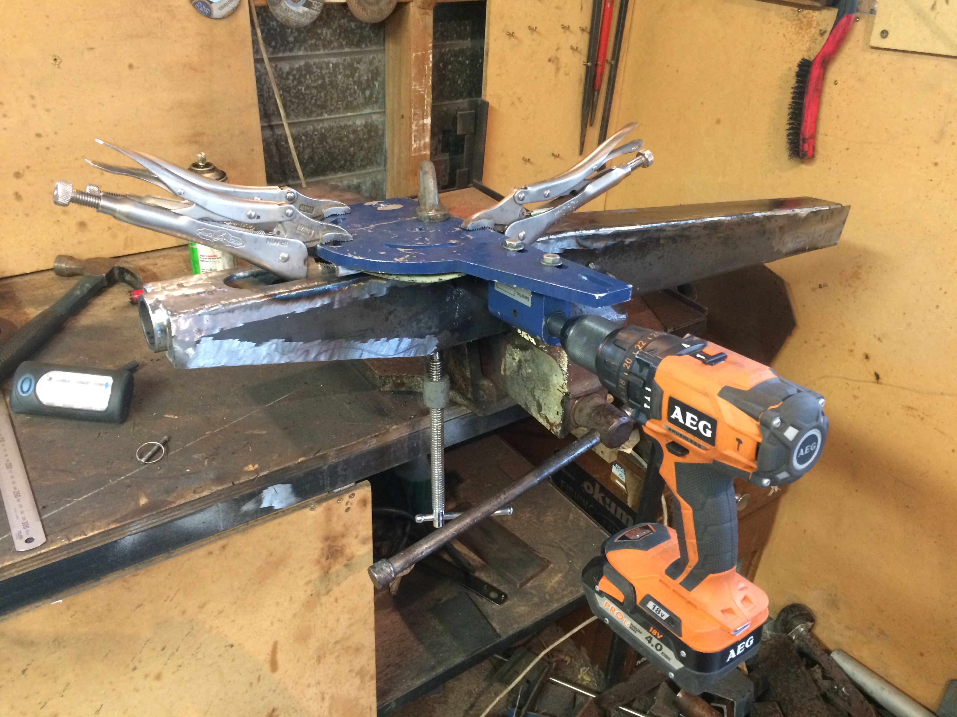

Then had to cut some holes for the shock mounting points.
First method was a bit rough.
Next method was better but not beautiful.

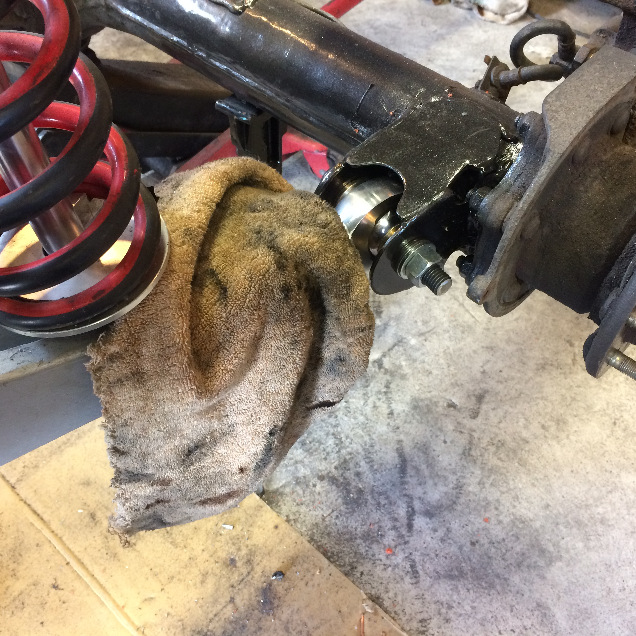

Painted (in the free-est colour I had, would have preferred black). Here they are hanging to dry, with a standard Saf arm hanging up for comparison.
Safe to say the weld-in threaded bungs wont be coming out. One of them required lots of heat and everything the 20 tonne press had. The other one went in with just heat and banging it on the floor.

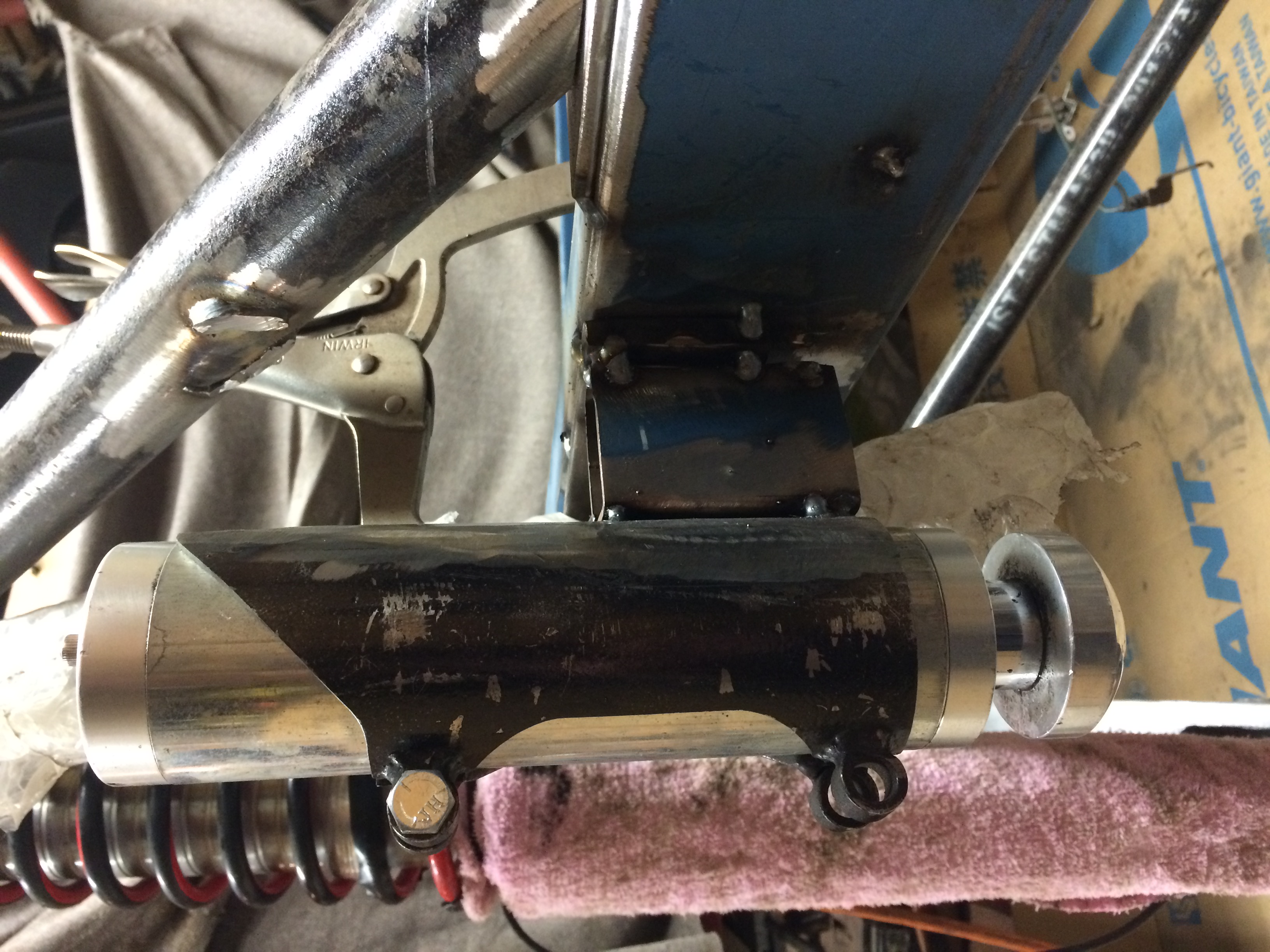

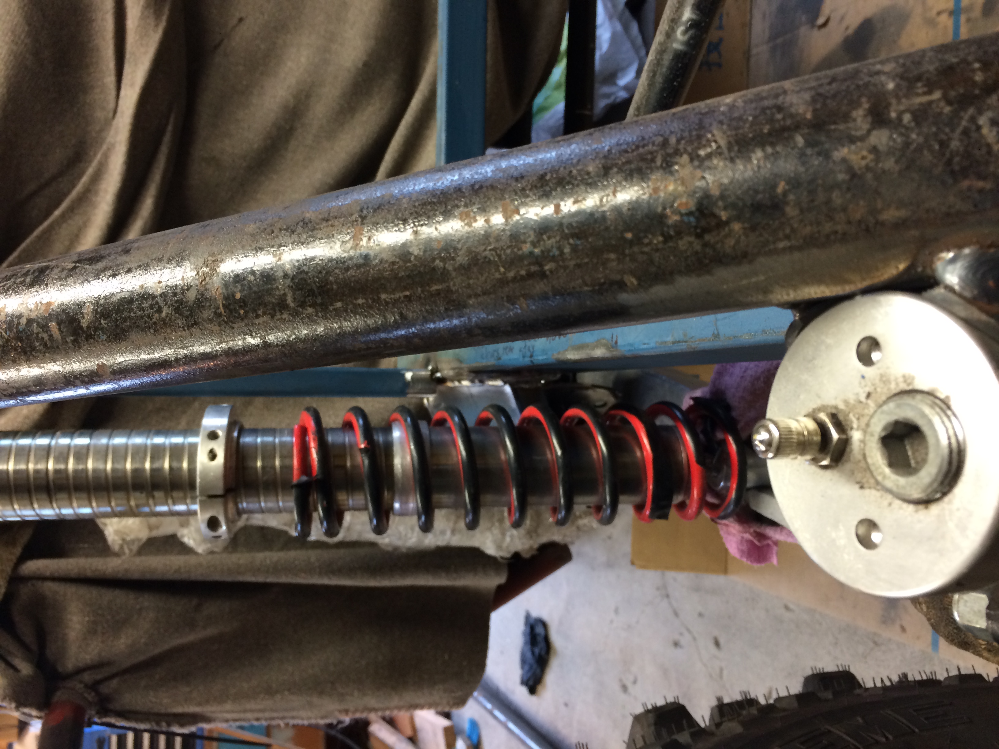

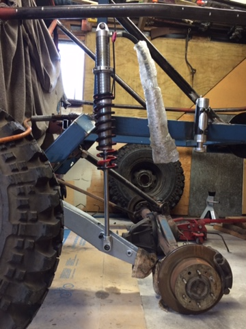

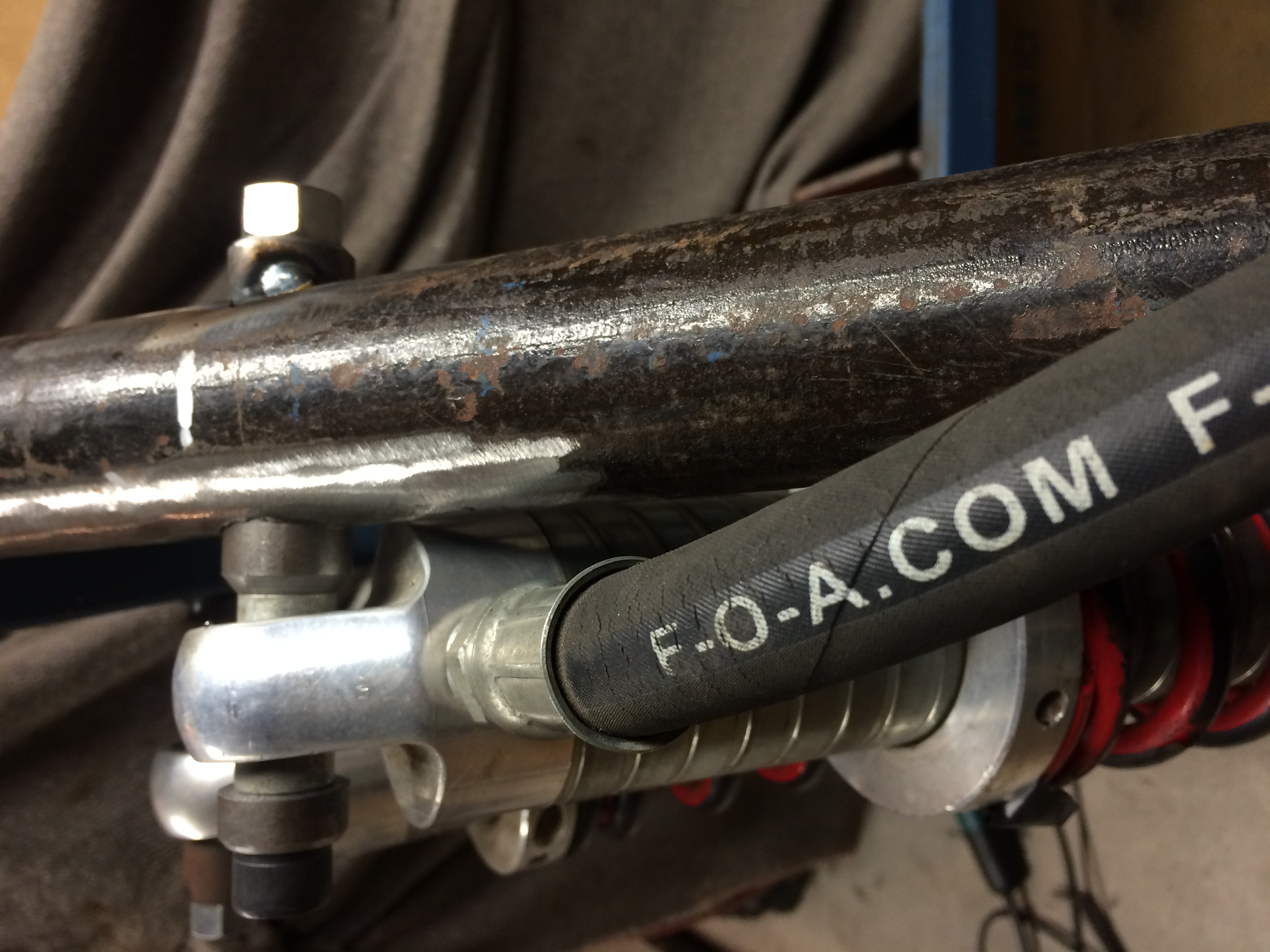

Next it was time to see where the tops of the shocks could actually fit. I had a plan, but it didn't go a nice as I would have hoped.
I ended up trying to walk a very fine line between enough clearance from the chassis on the inside at one articulation, and enough clearance from the tyre on the outside at the other extreme of articulation.
Leaning the shocks forward a little helped, but I didn't want to go too far from vertical. I was already working the shocks hard in terms of mounting them part way up the control arm, thus increasing the leverage against them.

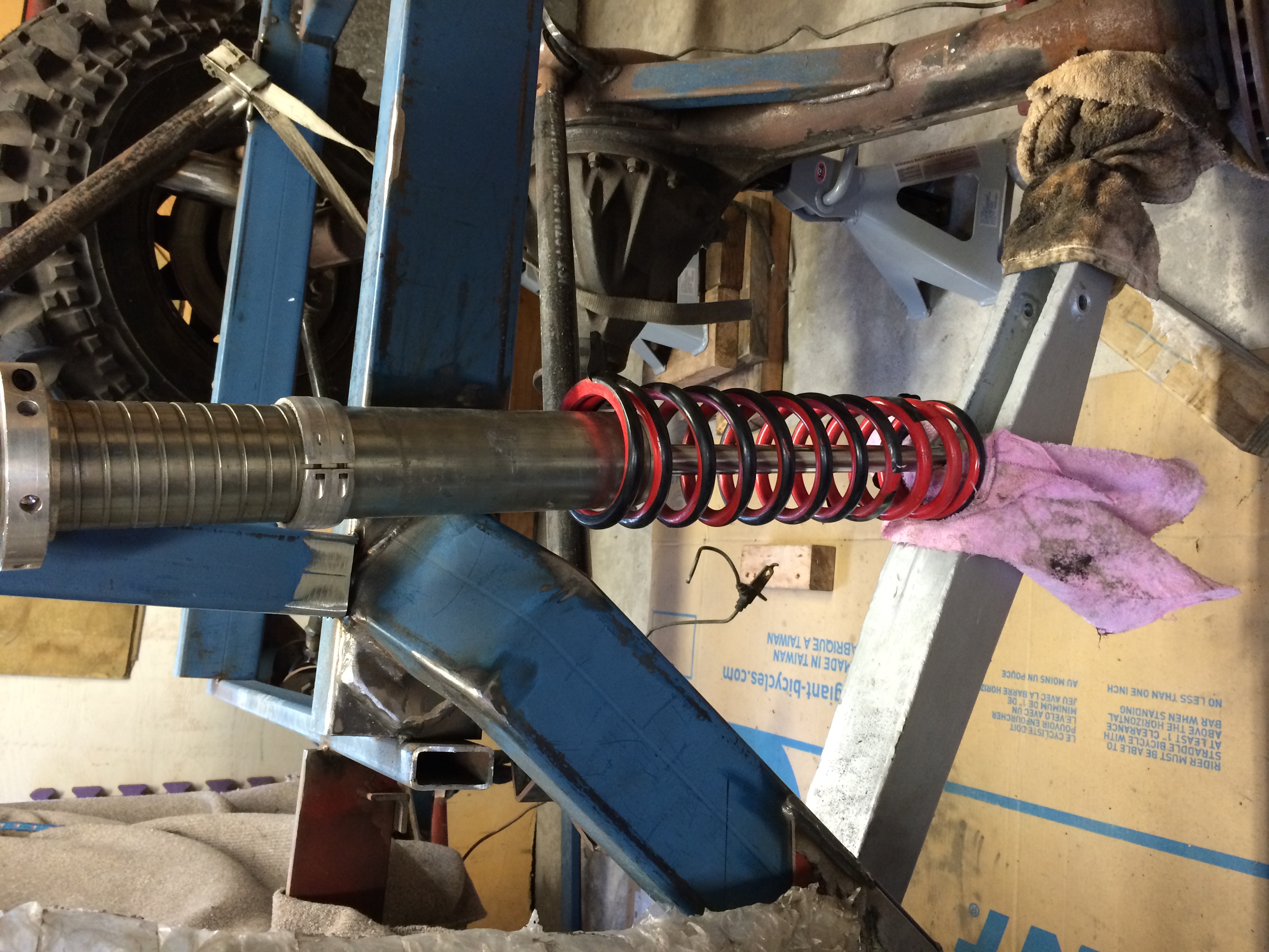

I had measured and mounted the bump cans.
P.S. No idea how to rotate the attached images, but if you click on them they are rotated when they open.

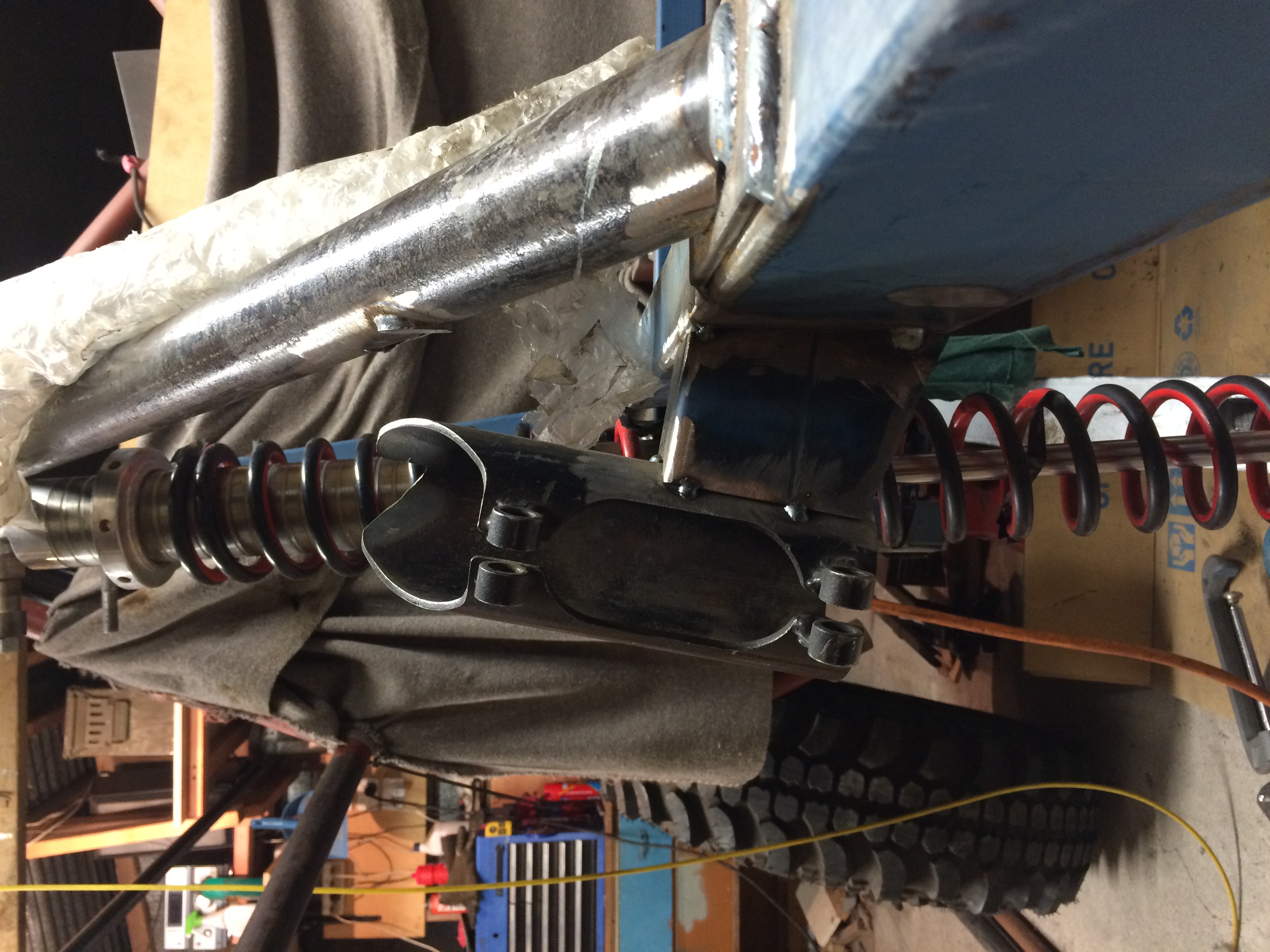

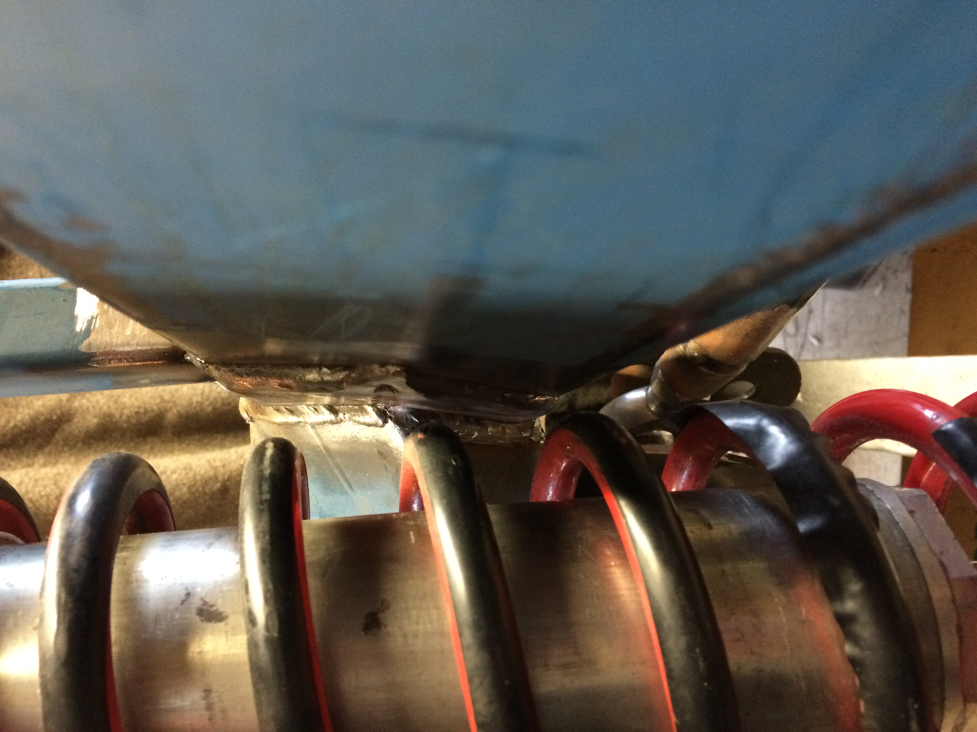

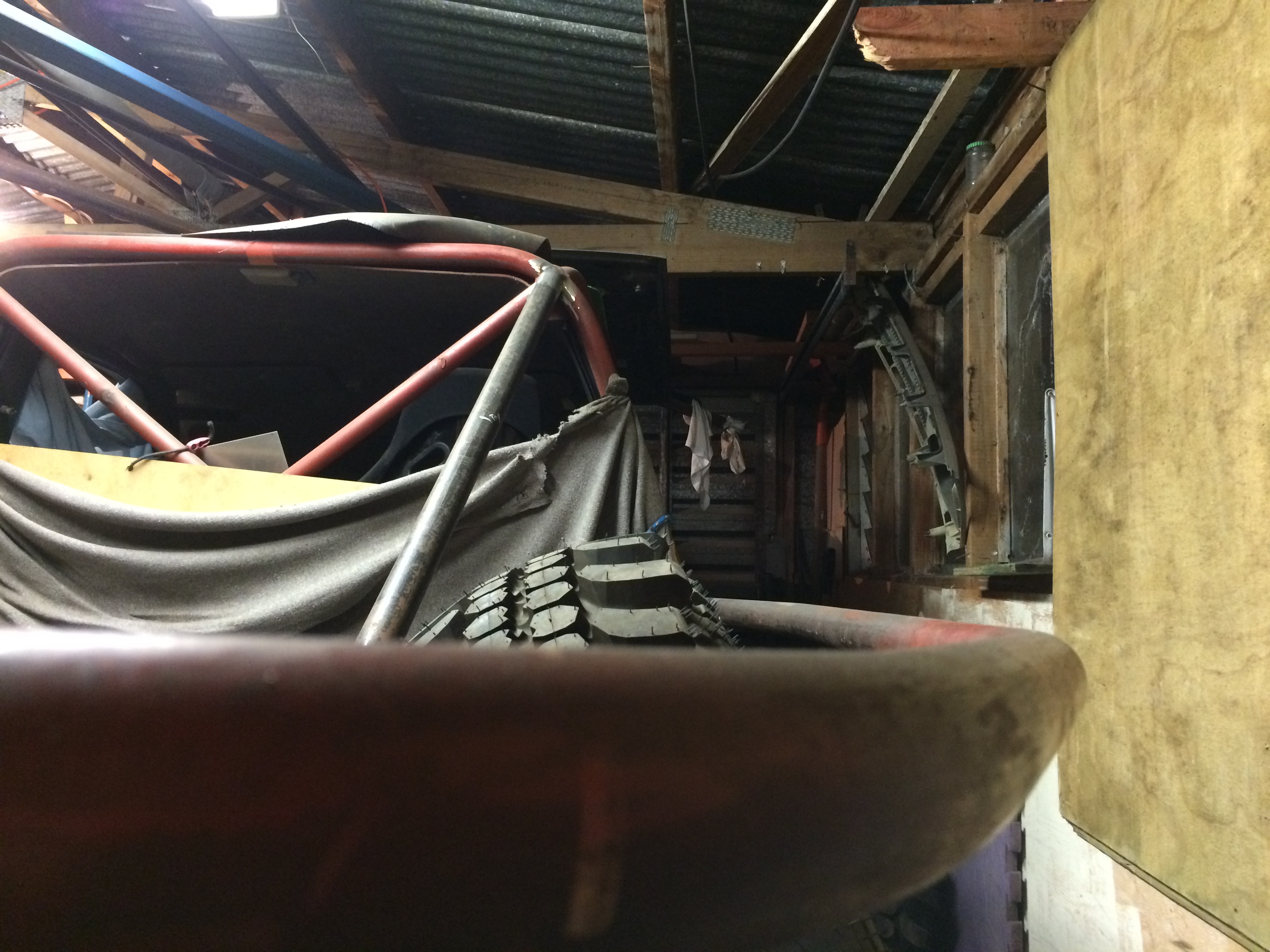

Had even notched the bump can to make them sit nice and flush against that rear cage stay.
The old Saf suspension kept the tyres below the deck level (the bar in the pick). The new chassis/4 link did not :? .
So to solve my shock and tyre/chassis clearance issue, and to reduce the tyre vs deck height problem, I needed to reduce articulation.
The way to do this without losing up travel was to move the bump cans wider. Damn it. So I did that.
And ofcourse they were sweet at full compression/articulation, but the tyre rubbed the top of the cans at part compression/articulation. :roll: So then I angled them in a little, which solved the problem.

But I still could not fit my shocks in. :evil:
So I had to notch my already narrowed chassis. Heart breaking. But its done.
Now I could finally have my shock in a reasonable position without smashing it on anything.
So then I made up a crush tube type thing and drilled a hole for that in my rear cage stays. Note that the shock bolt is in single shear at the moment, but it won't stay like that. Also the rear stay will get some bracing.
So with that sorted, time to finish or at least improve the axle end lower control arm mounts. Yes, its only 3mm. But it's 700 MPa and it will get an extra piece welded on the outside to increase thickness where the bolt goes through.
With the new bump stops positions and shocks mounted, this is max articulation. Still better than standard even though I wasn't seeking to improve articulation in the rear end.

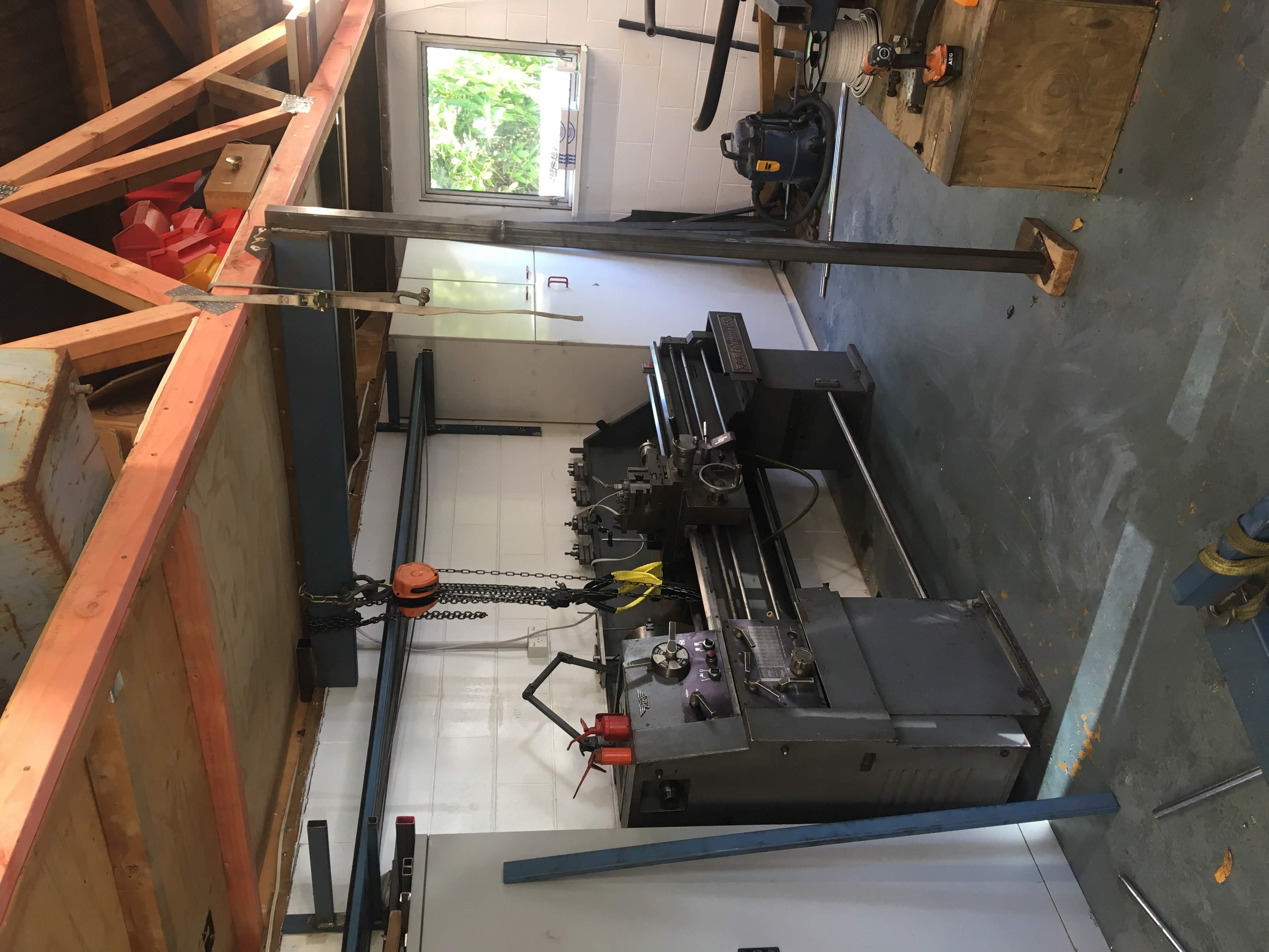

I have purchased, but not quite installed a lathe
I've done a couple of seasons co-driving in this thing. This is the creation of Andy (Team Tonka on here). He's a bloody clever guy and has done a great job. He's still improving it.
I hope to be making some progress on my project, now that I've "finished" working on our house and have nearly got the garage sorted. Don't hold your breath, but I'll get an update on here on day.
