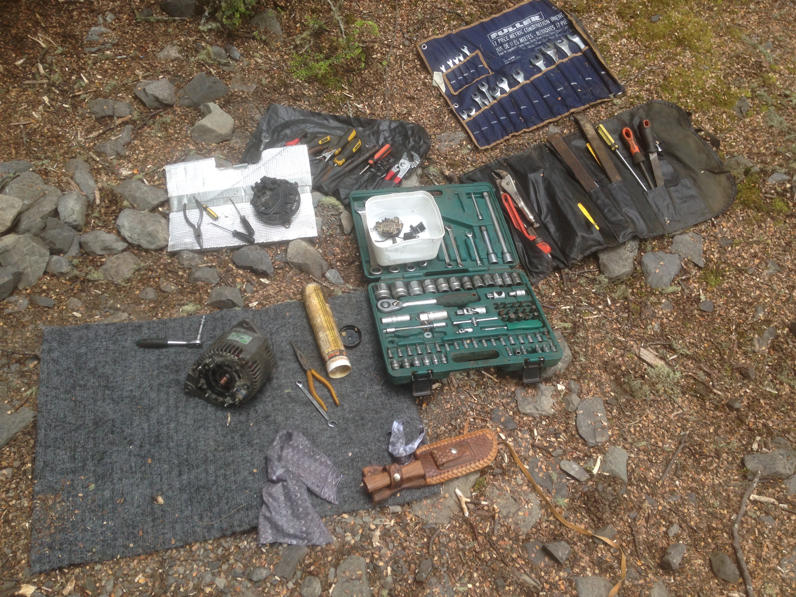

Hey folks, we are on the road as is everyone at this time of year and have been majorly let down by the auto sparky I use.
I sent both of Betsies Alternators in for a full birthday a few months ago, one of them lasted to Lake Tennyson, so fitted the spare and that lasted about 4hrs.
On both alternators, the shaft is spinning inside the rear bearing, while the bearing stays still, making a horrendous noise!!!! Suspect they've fitted the wrong bearings. Bearings are mint.
So now we sort of stranded. I have bush fixed it as much as I can but it's only lasting a short while befor my repair fails again.
Is there anyone with a 300tdi alternator we could buy, beg, steal or borrow anywhere in Canterbury??

Or if you can make it to chch and you want to turn the alt shaft and bush it up to fit the bearing, I'm about 15km up the south side of the waimak, and have precision lathes and mills coming out the wazoo

Cheers folks, looks like I have one jacked up to pick up tomorrow morning in Cust so fingers crossed!!
Mongreled the both the Alt's a bit more with a BFH and a center punch, so hopefully it will make the 2hr drive between them!!!!
