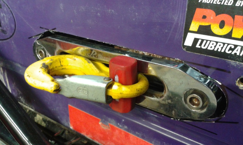

All the main bits done now just need to make a cover to keep fingers out the winch, and also so u can climb over in to the back seats.
Had a bit of soft plastic left over that I cable tied in to the winch hook to keep in in place in the fair lead. So u can open the back door with out moving the hook. Works mint

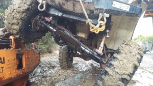

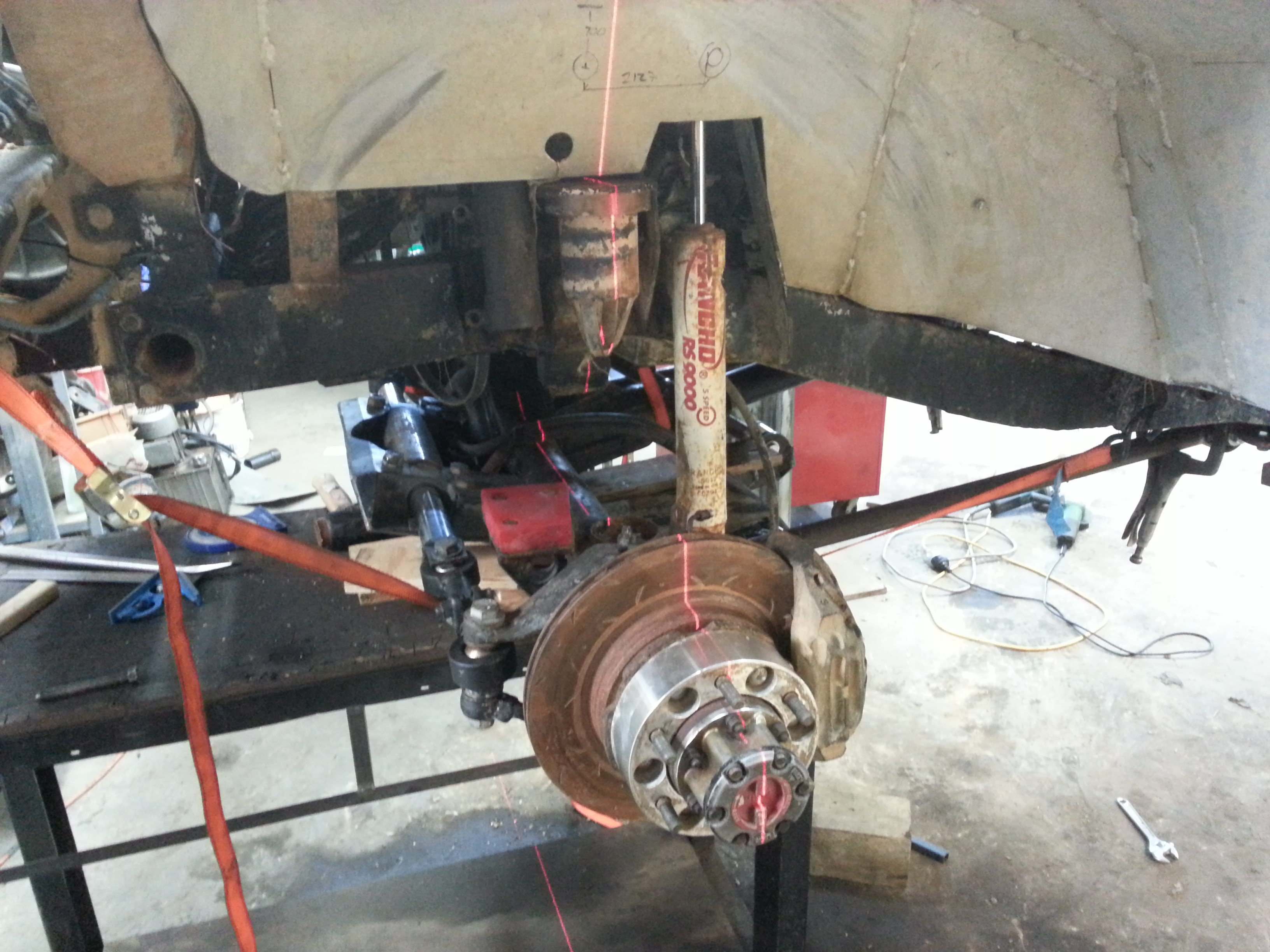

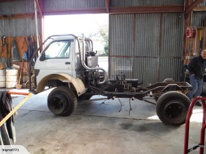

Found My new project. Built by a guy in Hamilton, but work and kids means he had no time to finish.
Full custom chassie, 5 link front and 4 link rear, hydro steer and mid mounted ld28 turbo.
Set up for dual wheels all round.
Heaps to finish but the major stuff is done to a very hi standard.

Re: Suzuki+SR20DET+Hilux Axels+coils+Exo Cage
Well that's kinda random. What axles is it running?
I see some 40" Treps in your future.
Yup my trademe adiction leads me in some unseen direction. Ha ha
Have my old muckyTimpson baja claw to go on.
Its running landcruzer fj40 axels
also has pto
but needs some work on the front aproch angle it suxs
also has pto

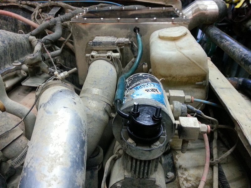

Latest upgrade after the woodhill mud pit run is water proofing the ARB pump. Made a cap to take the place of the old intake to plump it back to my air box.

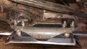

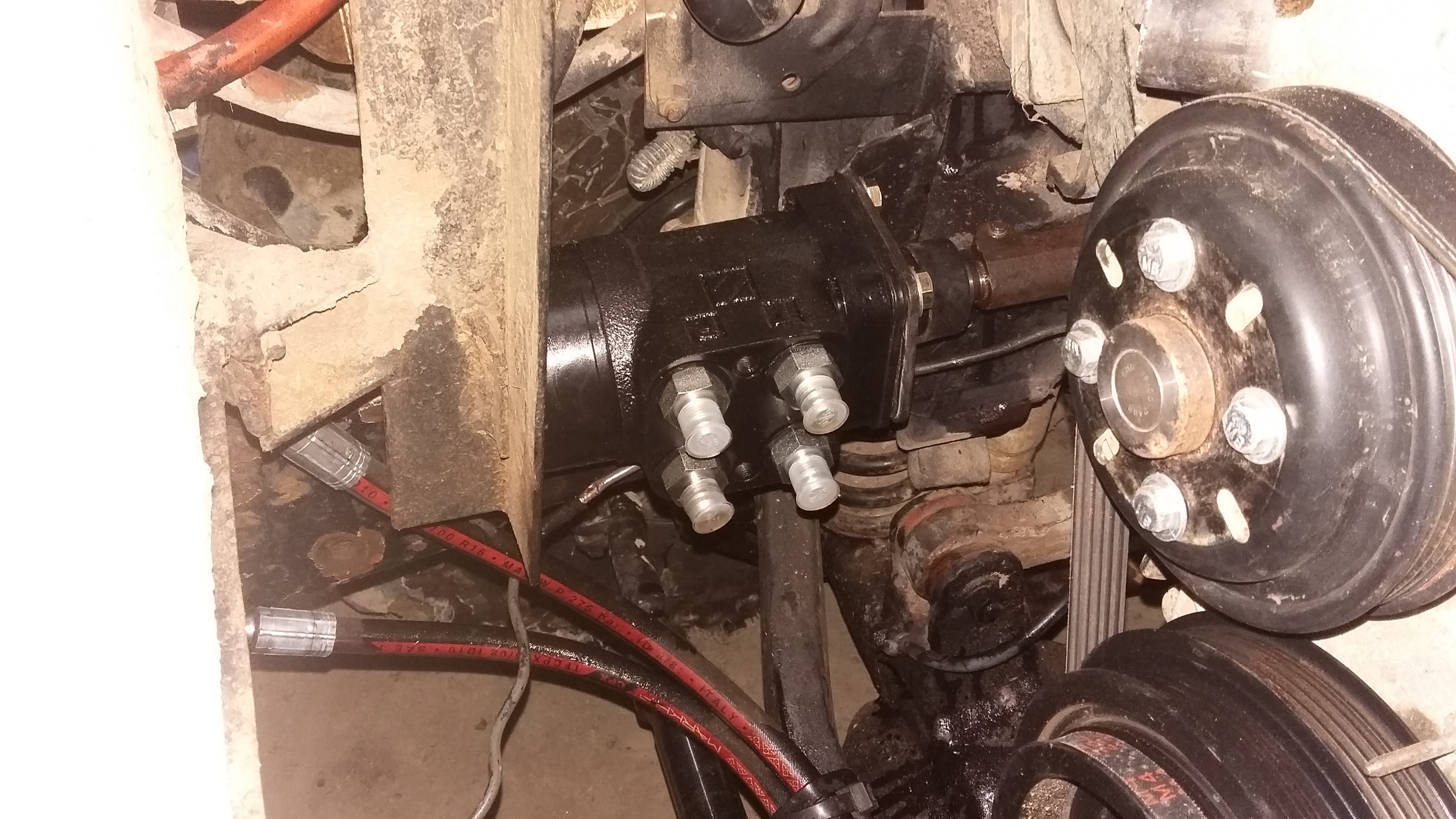

Went on a club trip, my steering was real sloppy almost rolled out of lack of control and by the end the box was stuffed. So got me thinking, Hydro steer

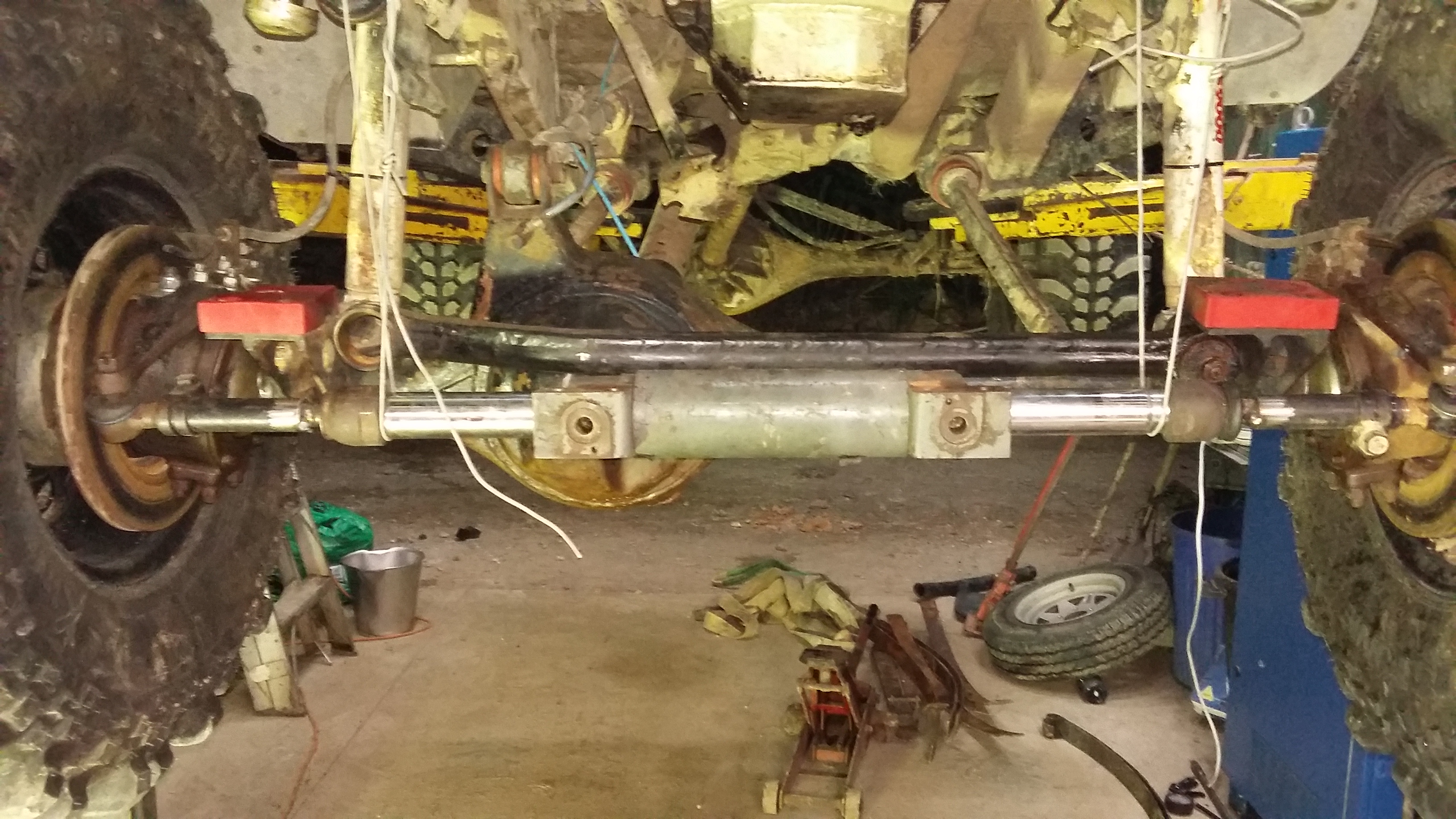

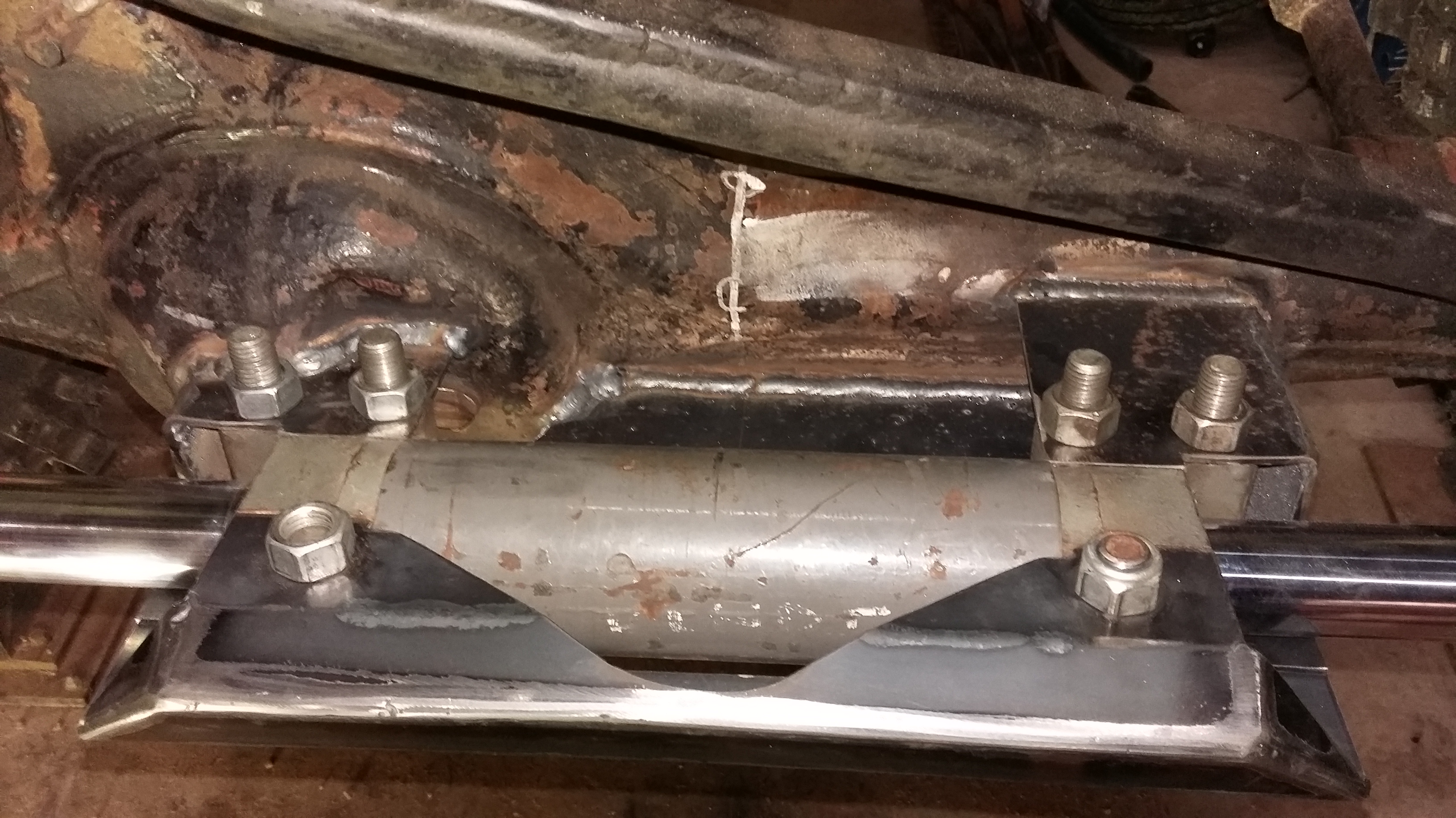

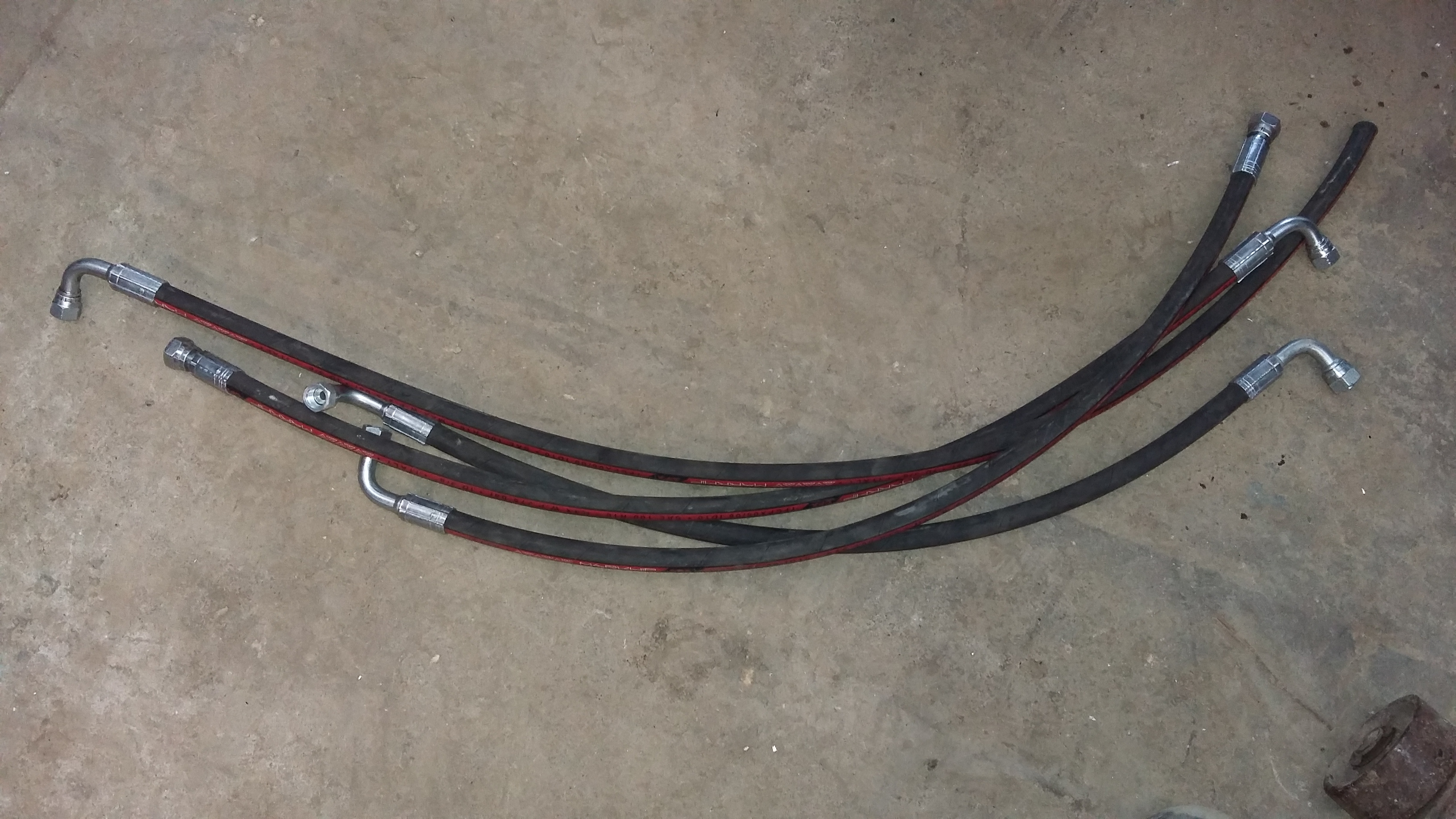

This is all the hydro i got off my other project, was told the ram is from a tractor. last pic is my idea of a wheel alignment ha ha.
Finished it but the steering valve was not matched for this size ram so it was 8 turns lock to lock so almost impossible to use. but hay it was almost free. I was also using the SR20det pump so that wouldn't help ether.
The fix. got a Trail Gear orbital valve matched to my ram. And also a 1650 psi pump. Its mint now also it is self straightening. real nice control now and so easy to steer love it

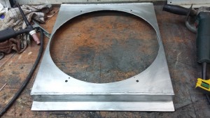

Rear mount my radiator. Wanted to keep it nice and small and out the way. The first plan was slim 16 fan to suck it in and out but couldn't keep up, being cheap Chinese one

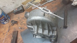

Now for the fun stuff. Rebuild and upgrade my 8274. My father law got me in to put 3 phase to his shed to set up his work shop with a vapor blaster so got him to blast the winch nice and shinny.
Ordered the air actuated free spool with extended drum.

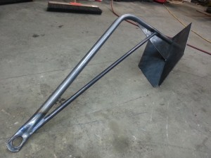

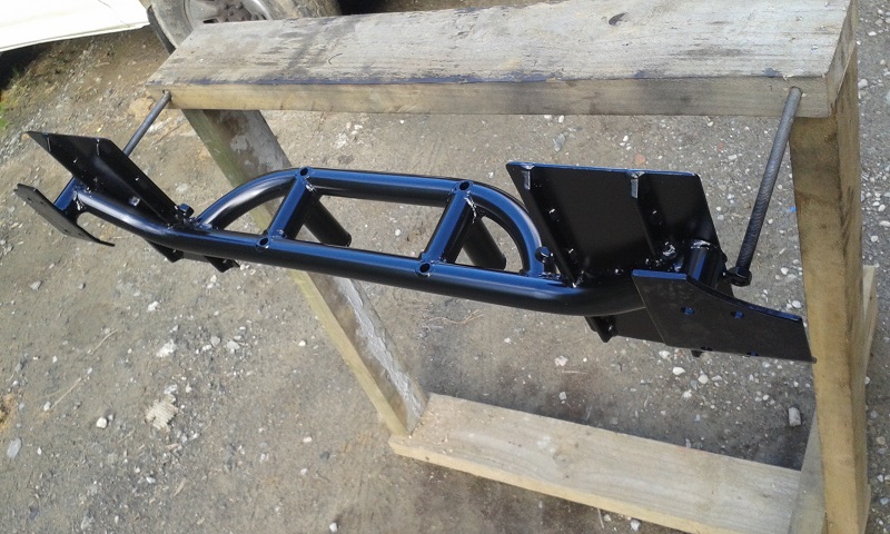

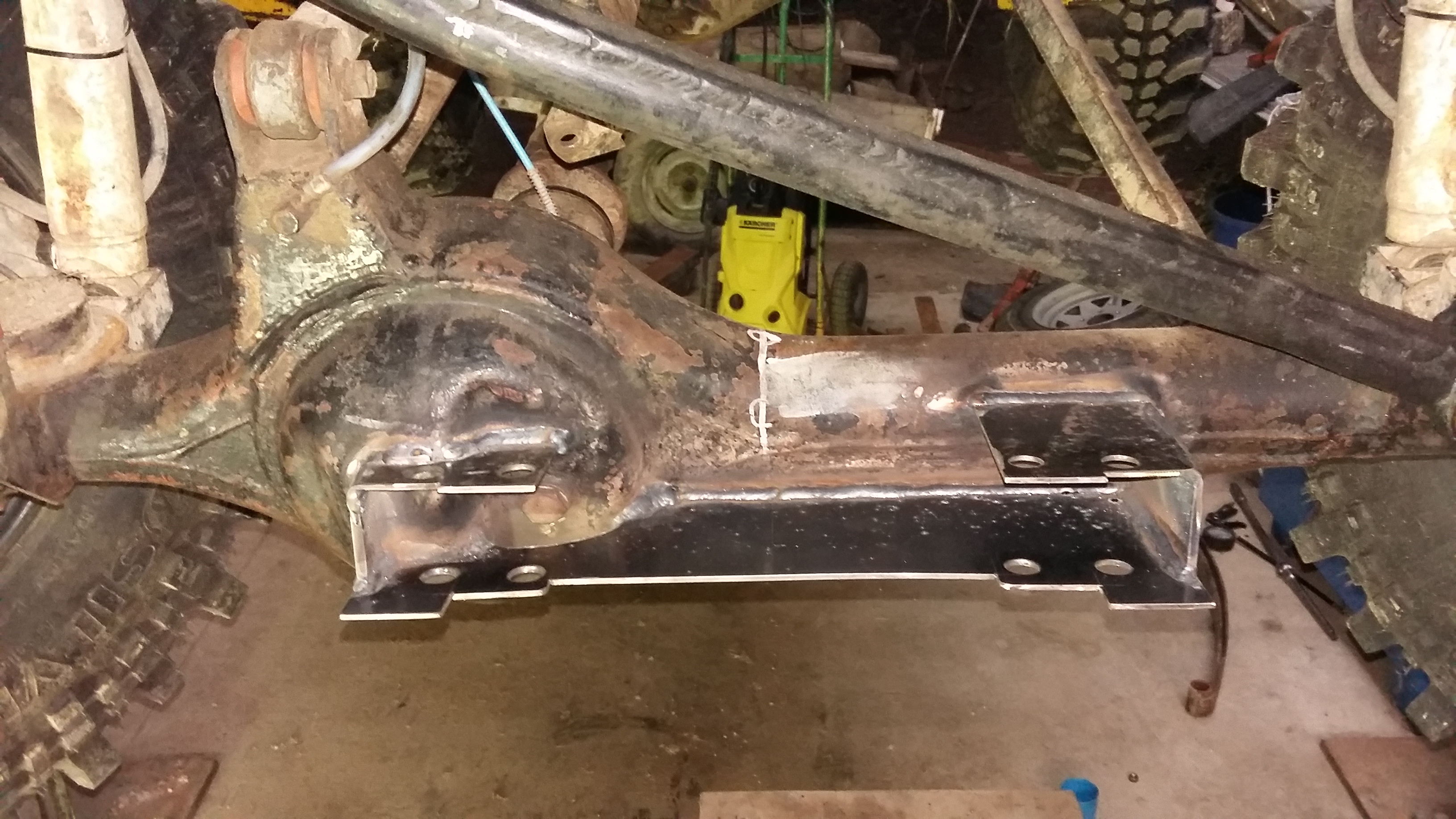

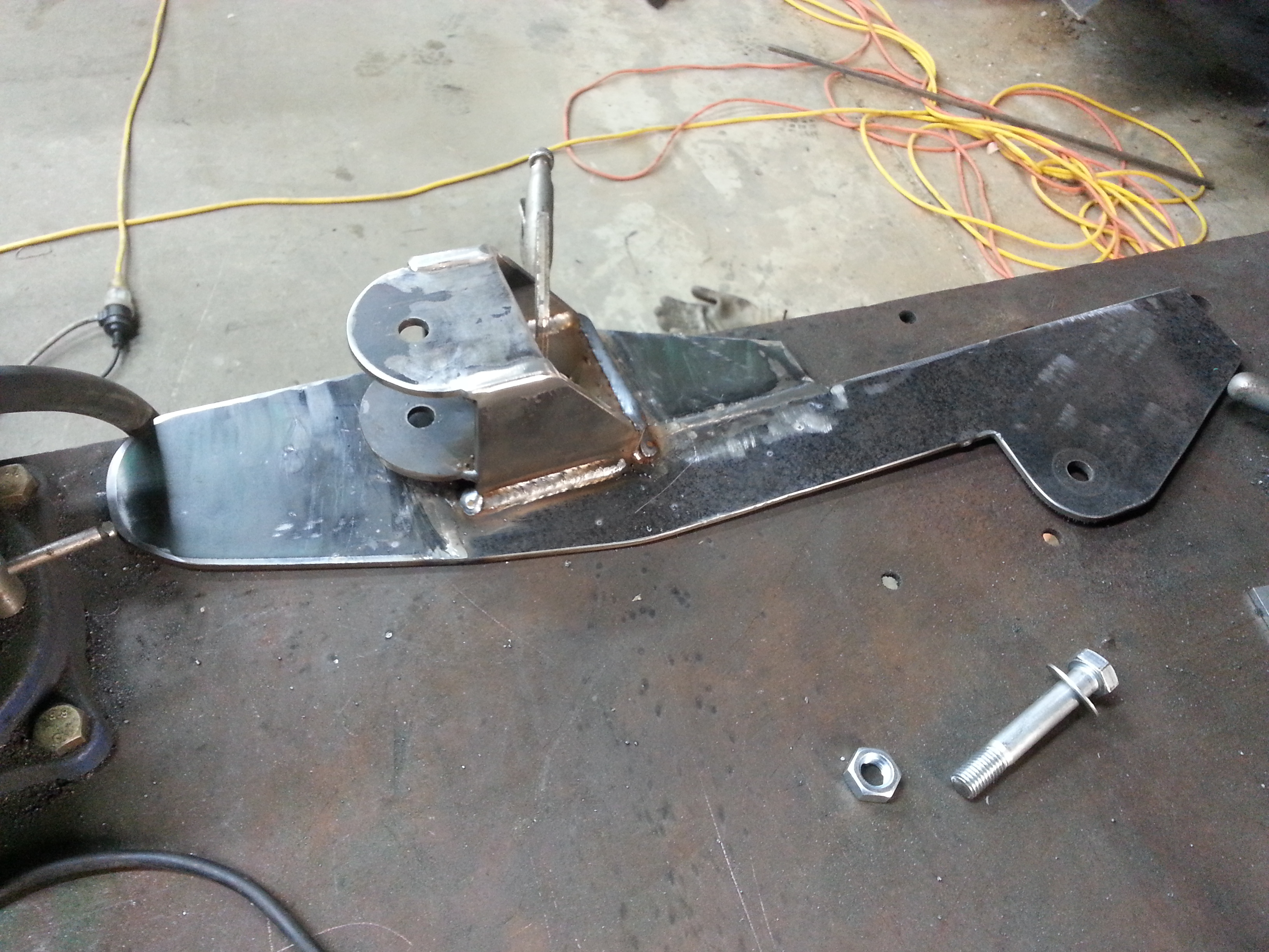

Welded on some tabs to help support the drum and stop it from twisting and help align the drum in the gear box.
10mm steel rod with aluminium tubing cover.

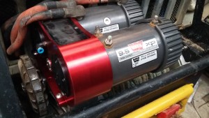

And a second warn xp motor. This crippled my finances but dam its cool.

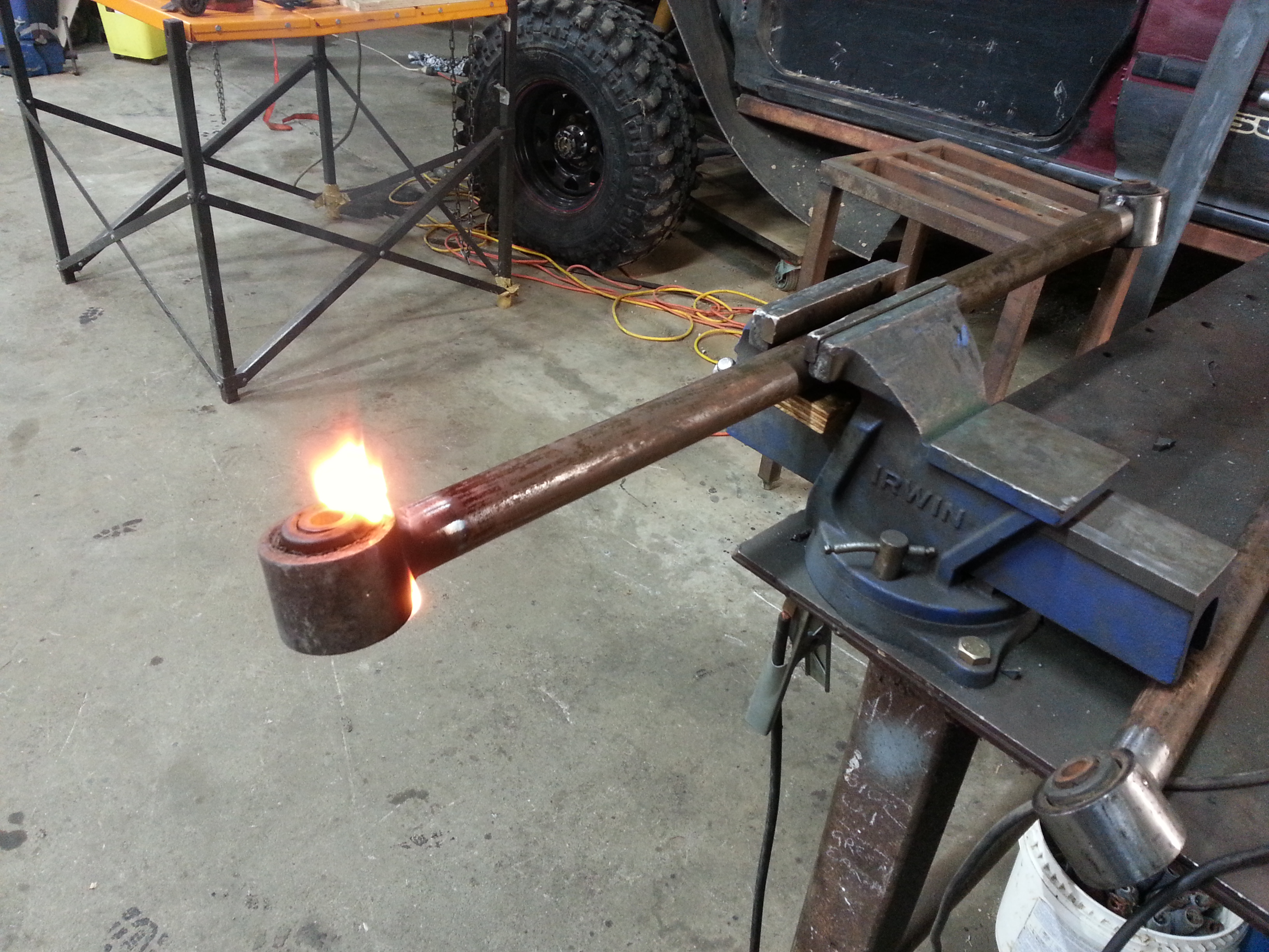

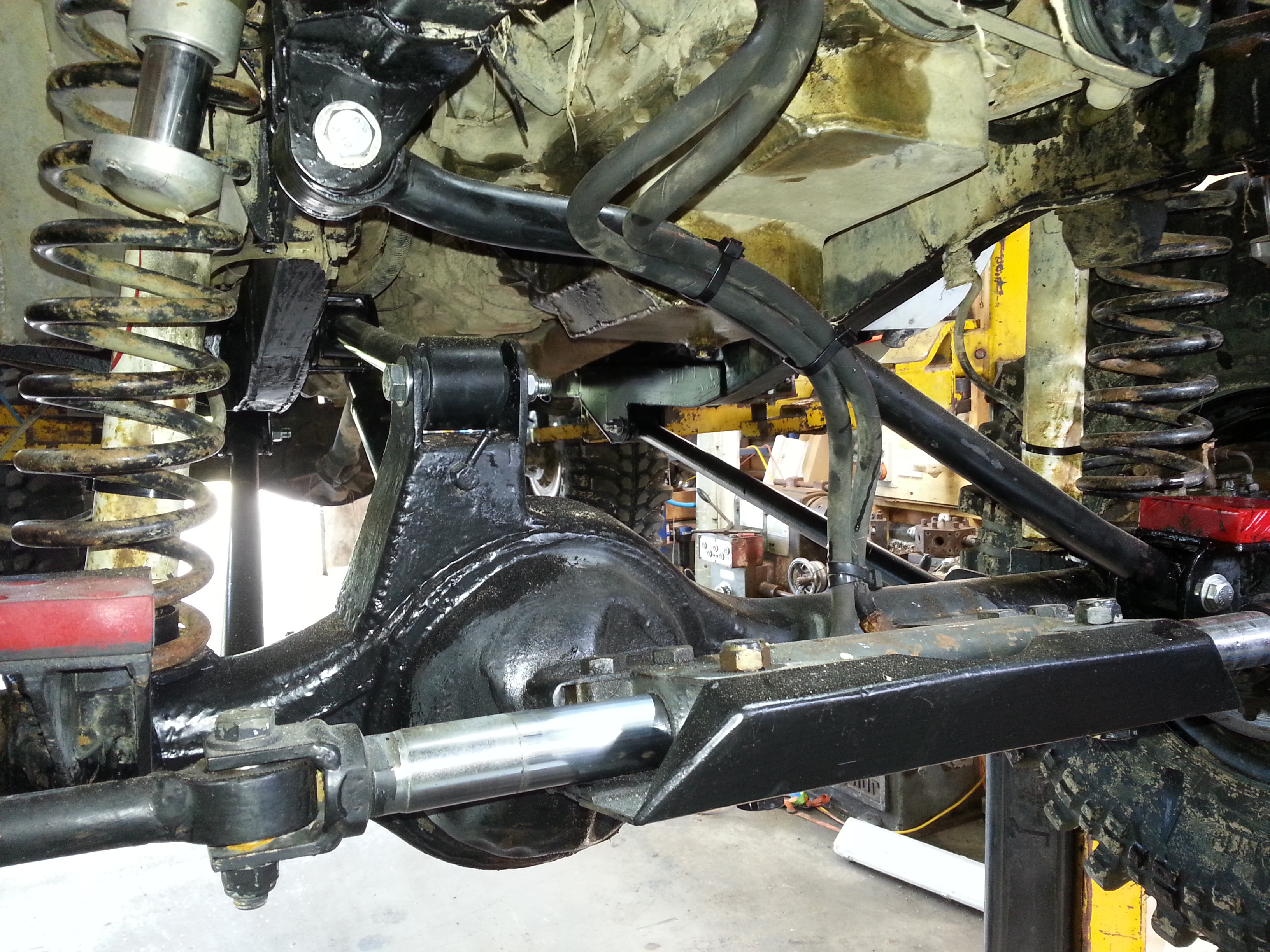

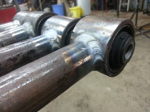

rebuilding the front 3 link. Using Nissan safari trailing arm bushes and schedule 80 pipe.
