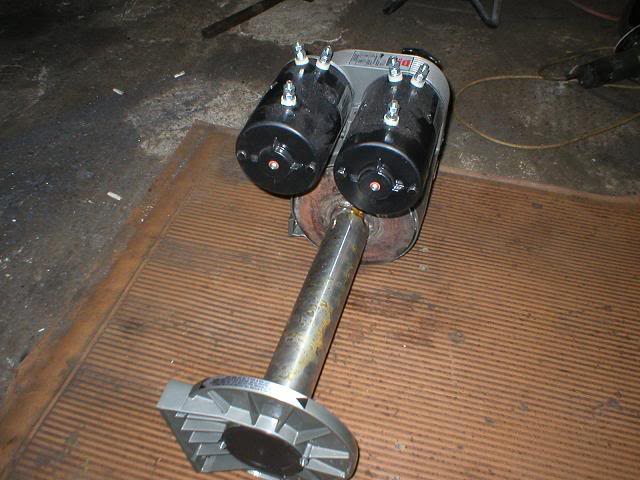

Re: Modifying a Runva winch?
Found this on the Web. Your skills could pull this off. U can get aftermarket overdrive gears to fit in stock case too.
Mattrade wrote:Found this on the Web. Your skills could pull this off. U can get aftermarket overdrive gears to fit in stock case too.
Is that not just a twin motor warn?
It is the first one that Gigglepin built and yes it is a twin motor 8274
