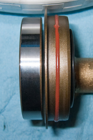

Anyone used Marlin Axle Seals on their 80?

Havent seen those seals looks interesting..
