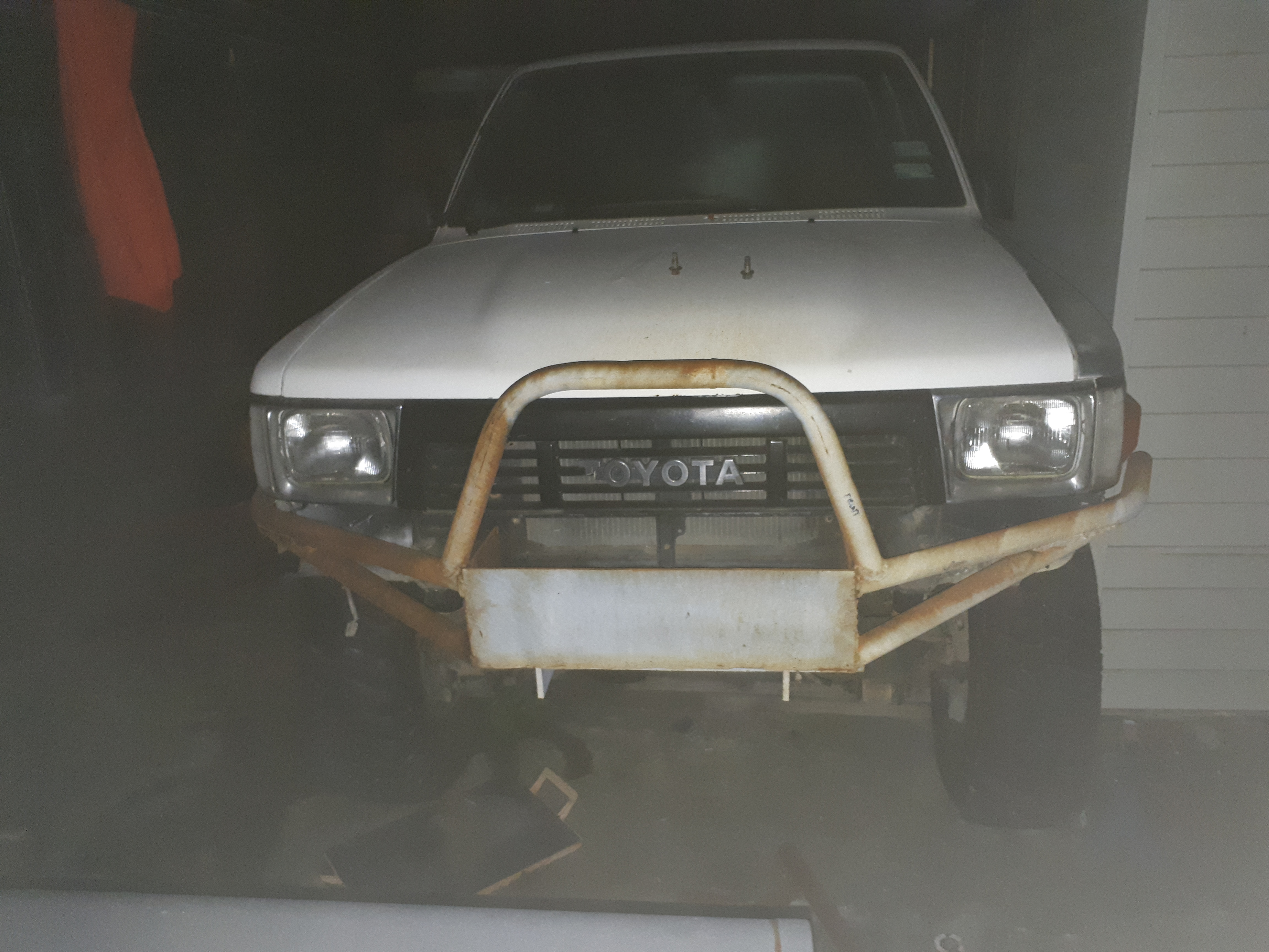

High steer kit and extended shackles are on there way
Drop crossmember is almost done
And bar is all bolted up
Might add a few gussets here and there to keep it nice and strong and then a clean up and lick of paint
