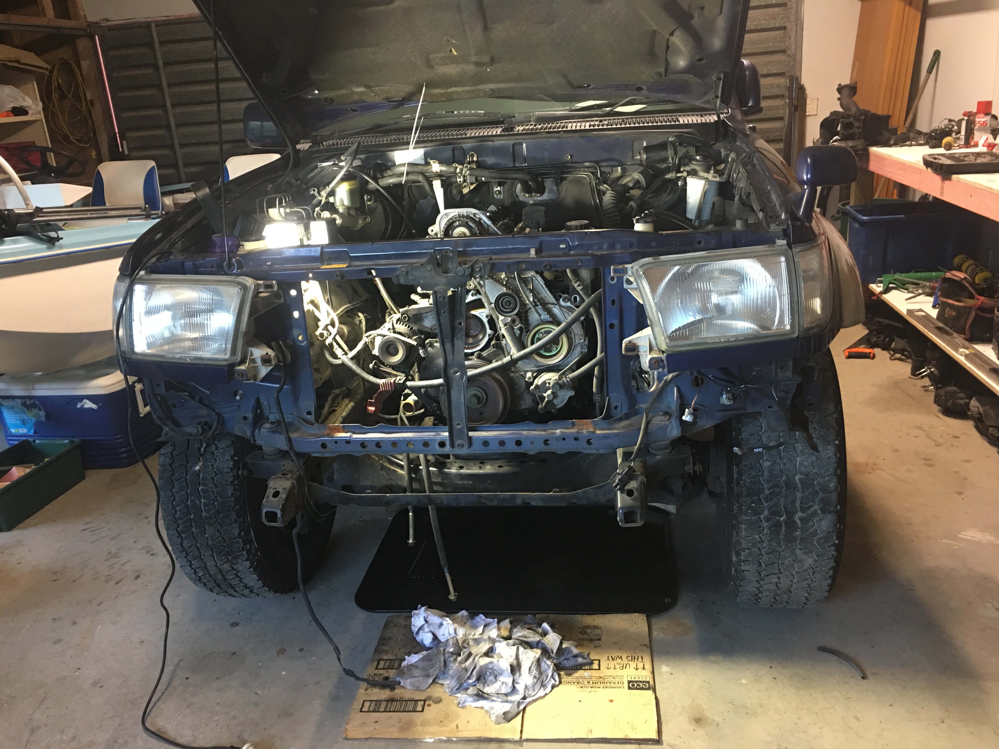

Strip it right back
About 8 cans of degreaser later, turbo off, manifolds off, rocker cover off.
New water pump, new timing belt kit, rocker cover gasket - responsible for the oil paint job. New gaskets everywhere.

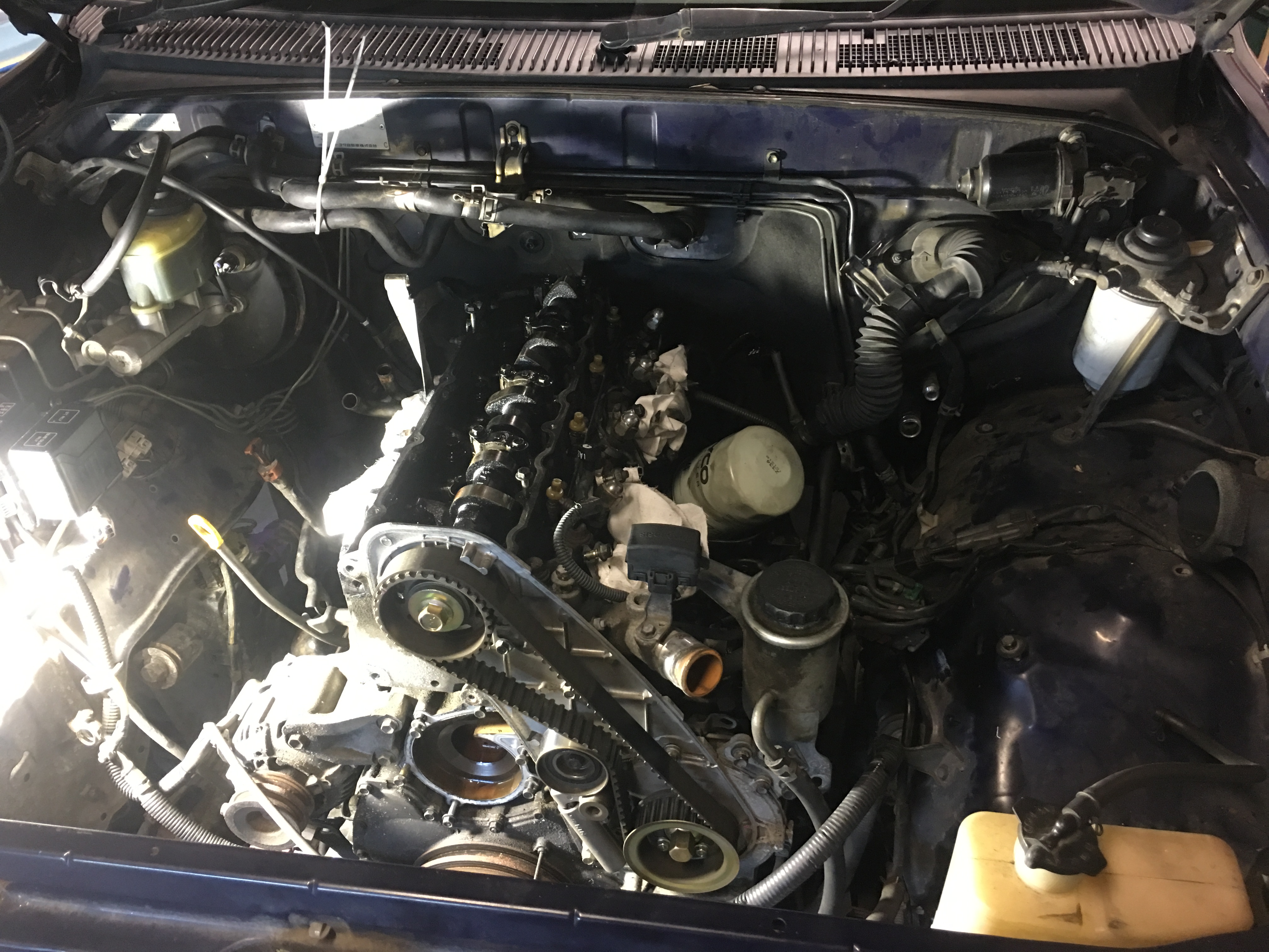

Strip it right back

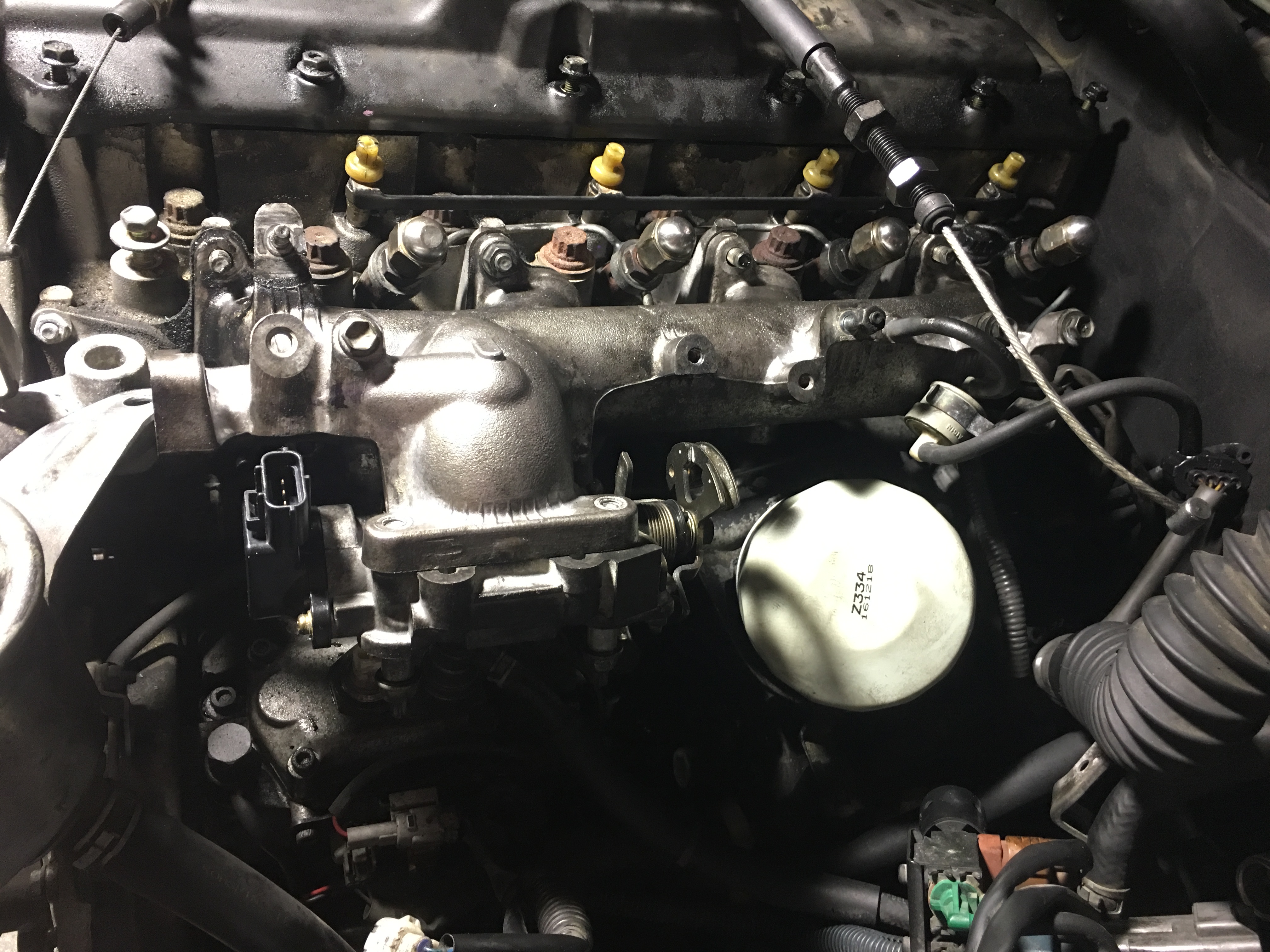

Going for a front mount intercooler after the epic results I got on the nissan.

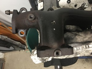

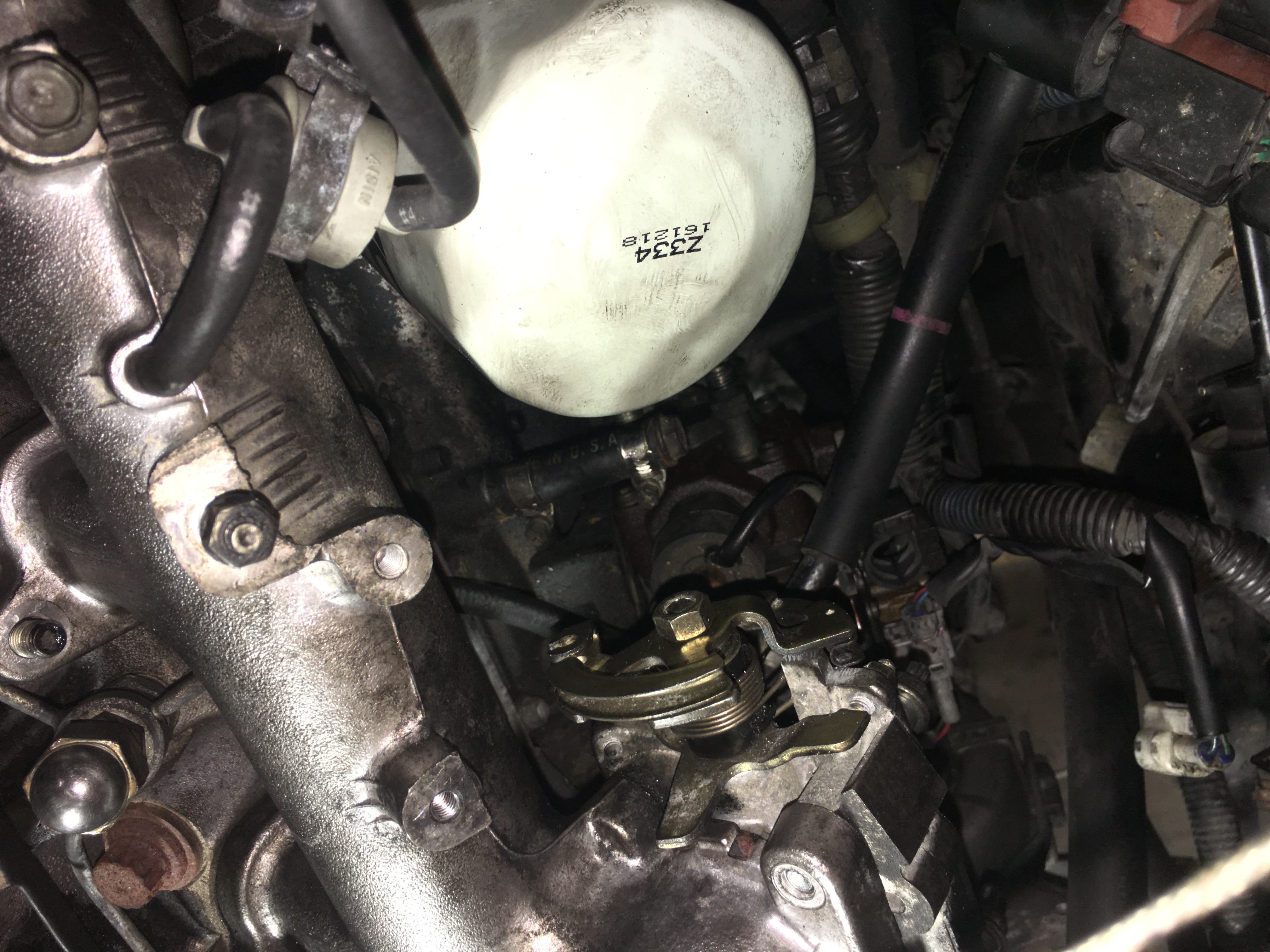

That intakes getting flipped no way I'm running 180 degree bends anywhere
Hardest part will be making a bracket for the different angle the throttle and kick down cables connect to the T.P.S. And that's not hard.

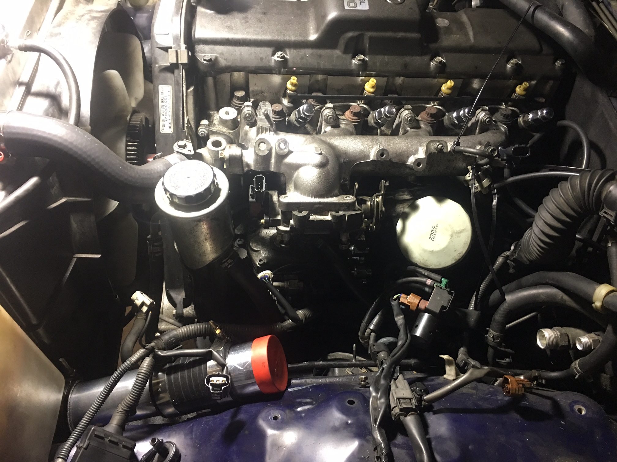

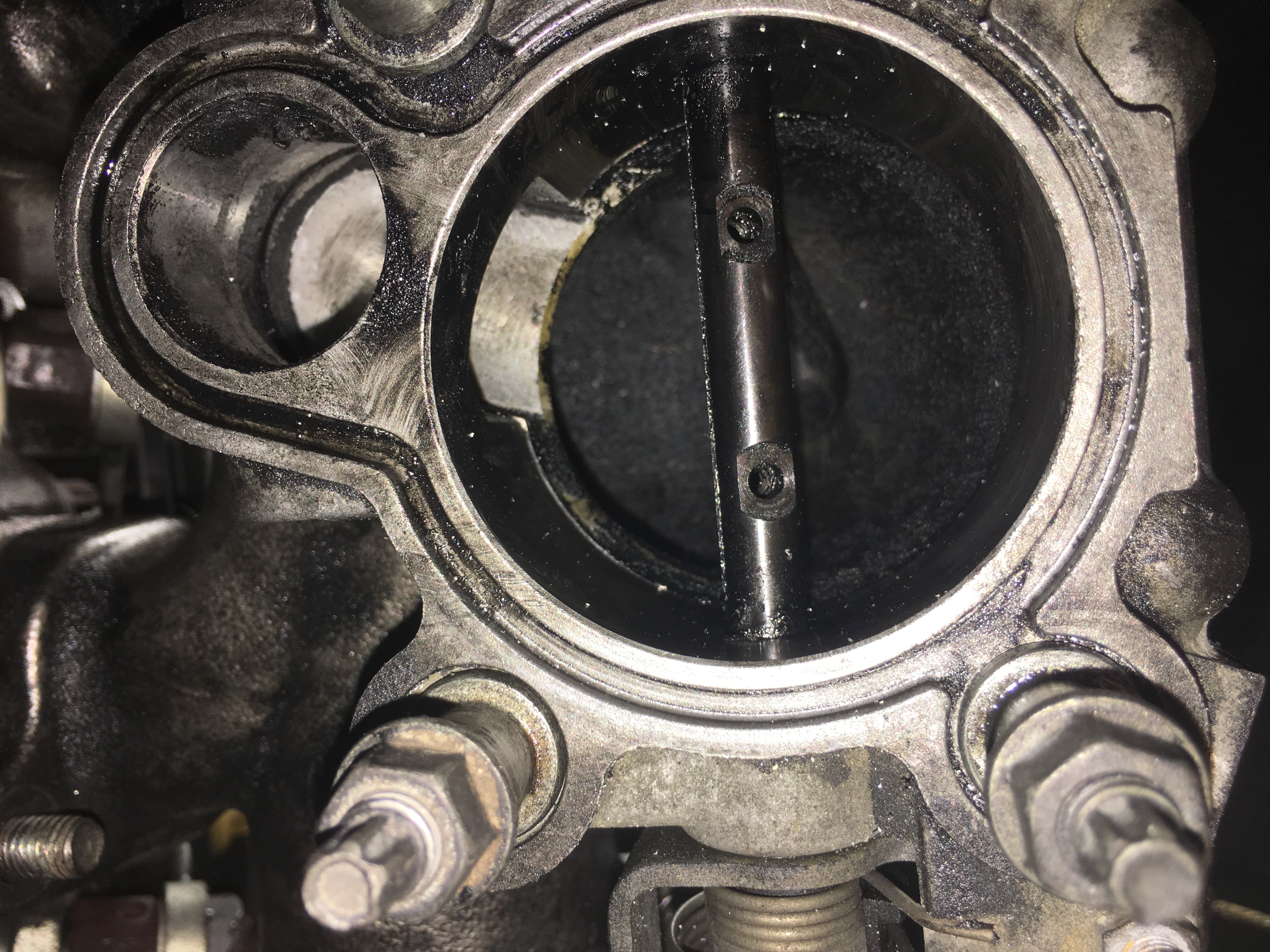

Throttle plate? you don't need one of those your a diesel get outta here. Yes, the intake and head ports were de-egr-gunked after this pic

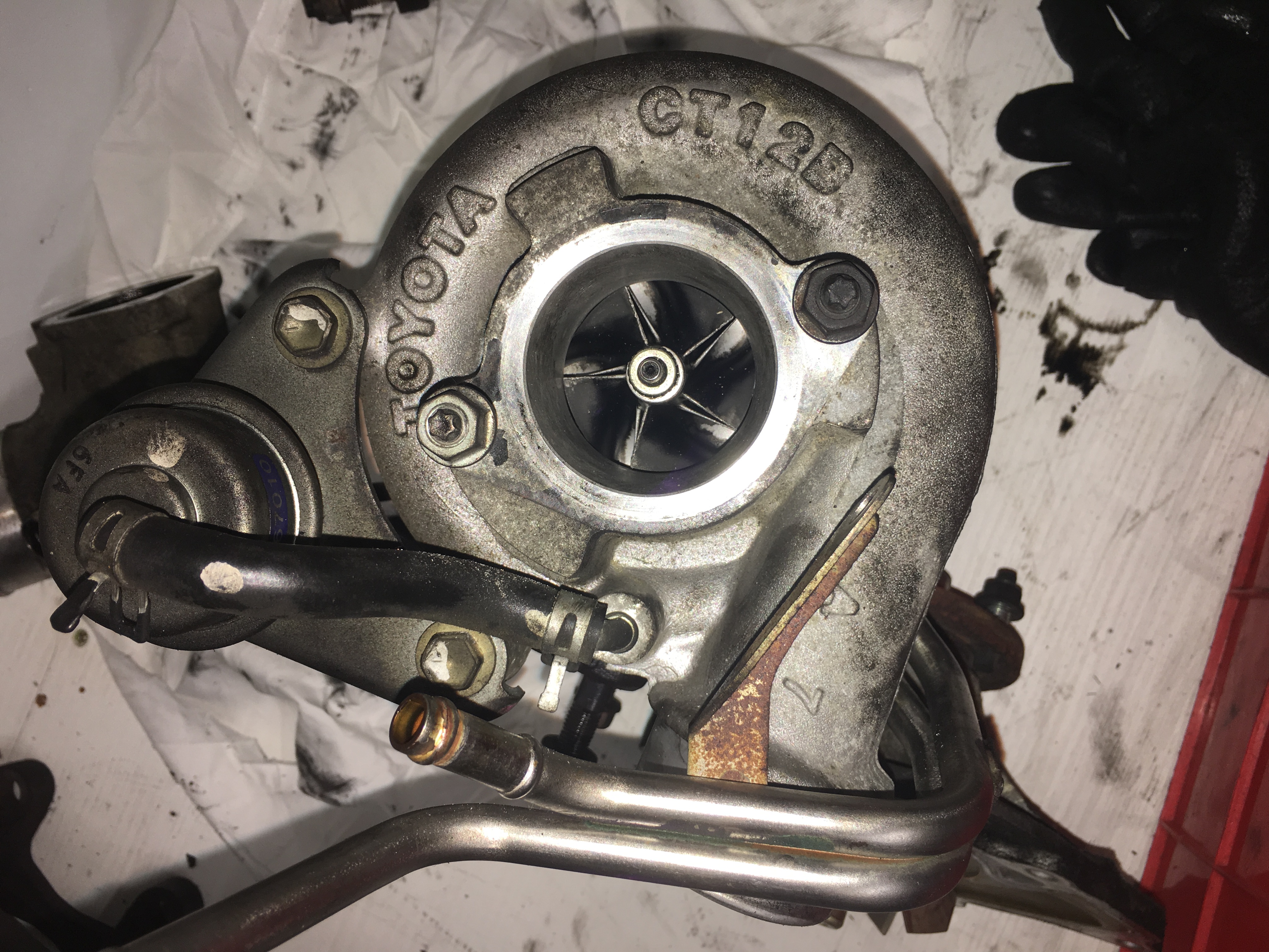

Aaand spot the pitting on the turbo wheel. The intake flexi was completely snapped when I took it off and someone had (failed to) repaired it with masking tape. like who needs an air filter? she'll be right. Off for a rebuild, with a cheeky hi-flow on the side.

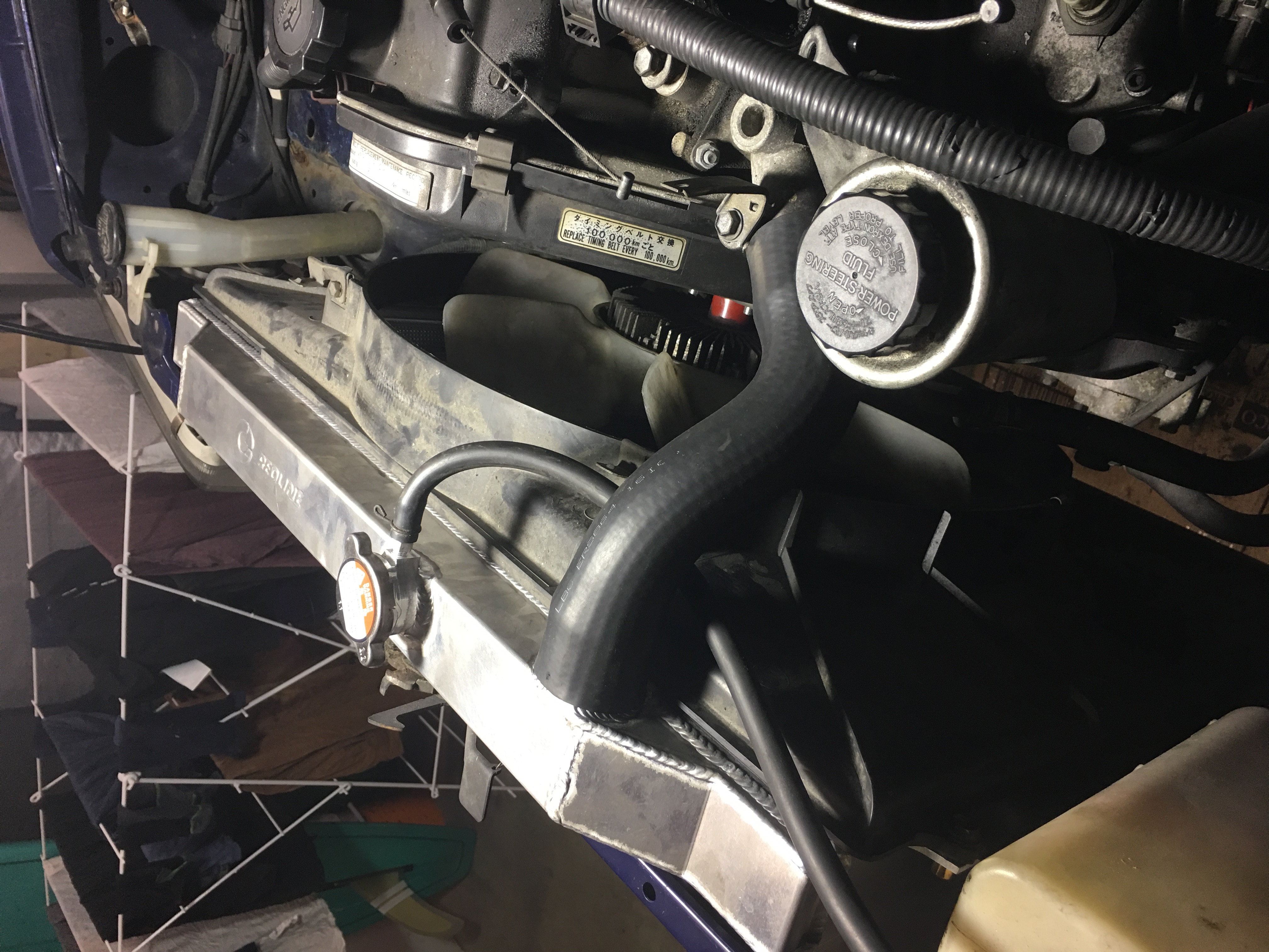

intercooler in, trans cooler in, manual oversize radiator in, viscous fan adjusted and refilled, lower temp thermostat in.

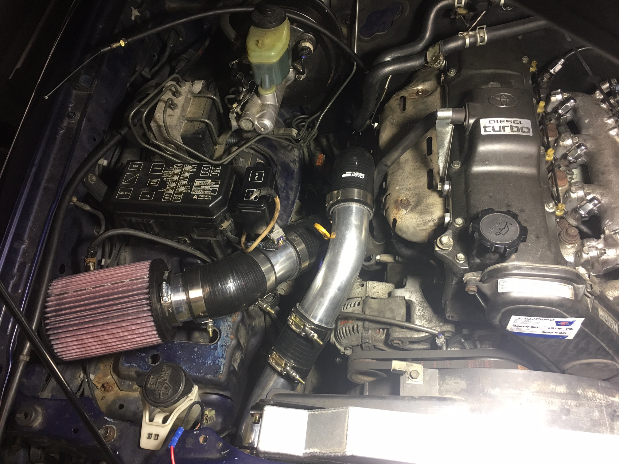

a bit of piping in, just need intake flange, hope to do some heat sheilding around the air filter as this really does make a difference. Will also later install a drivers-side snorkel from the petrol model to link up to this before diving in water.

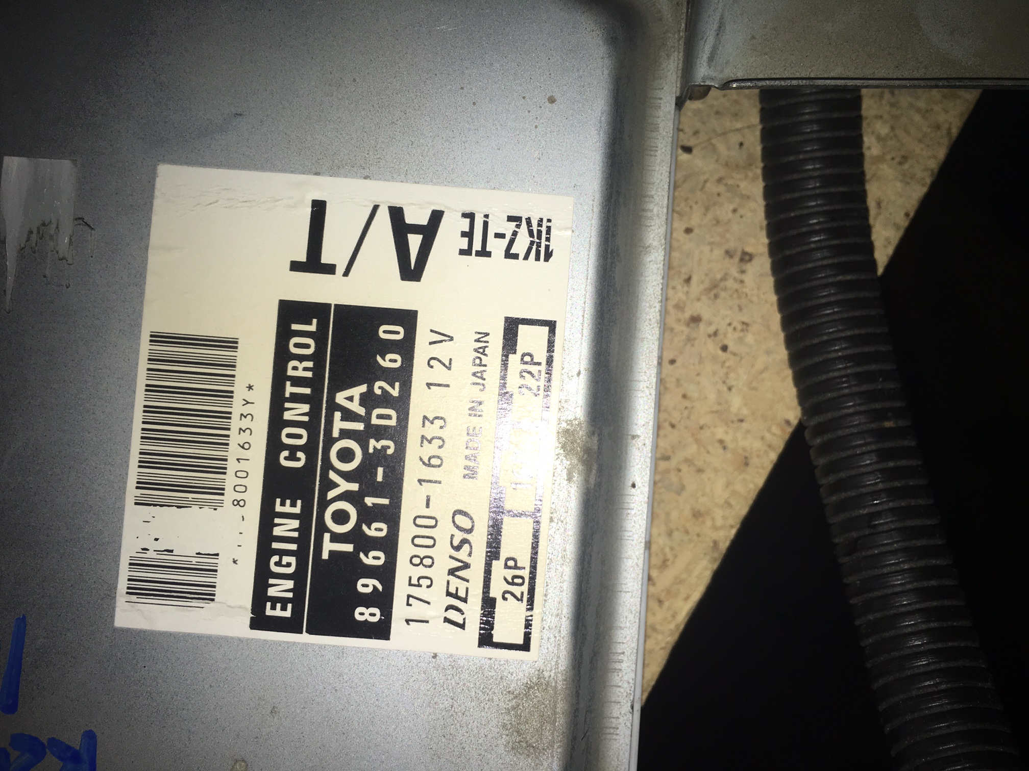

and just because I like to go that extra mile, a recapped ecu from the intercooled model. you also need the intake sensor that goes with this so it can read post intercooler temps. part numbers if anyone wants to be as crazy as me (all prefacelift) -
non intercooled ecu 89661-3D240,
intercooled ecu 89661-3D260,
intake sensor intercooled model 89424-60010.

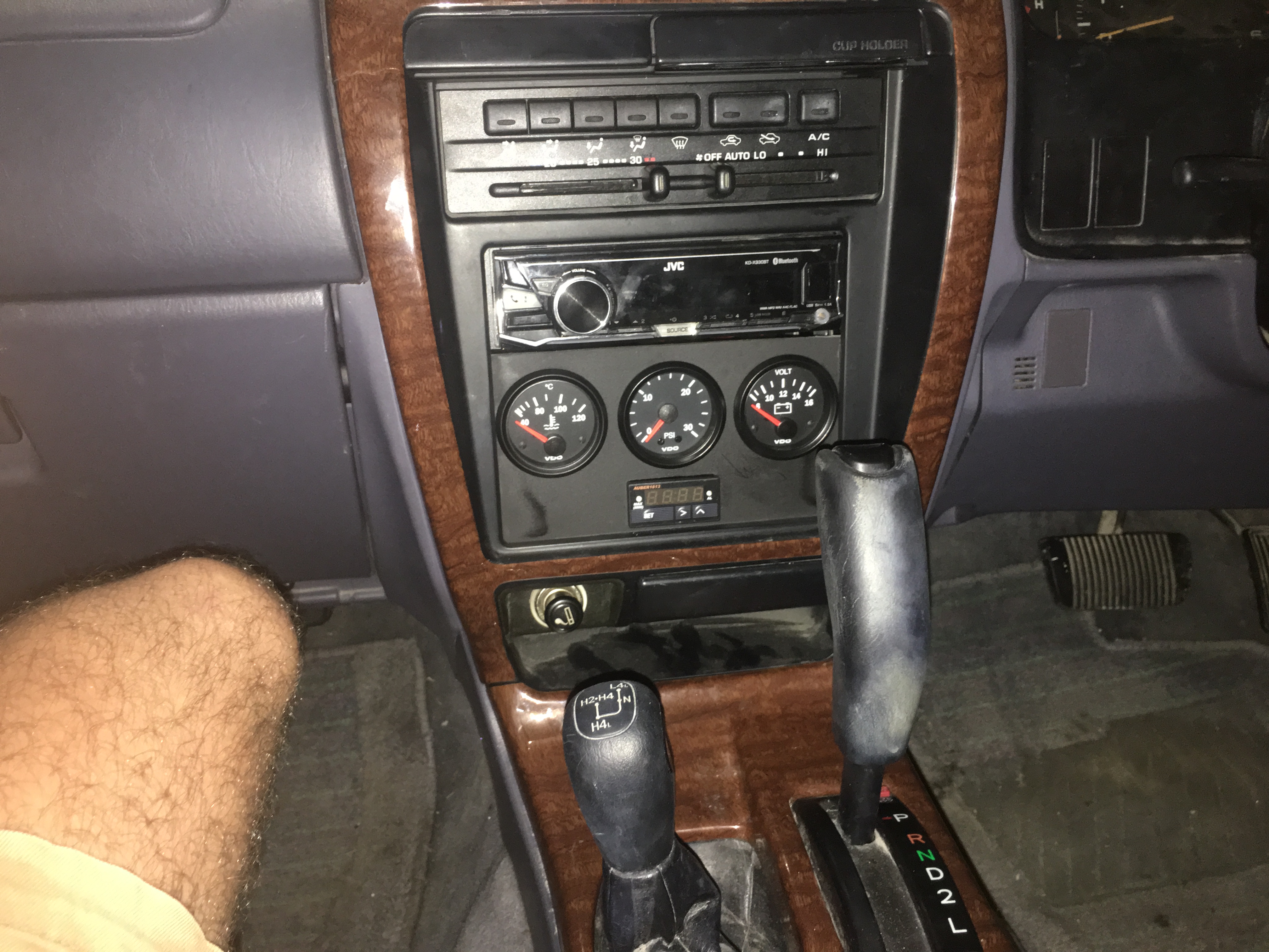

Here's some gauges
Here's some gauges

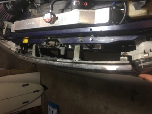

great work. Is the radiator custom built, or off the shelf "larger manual" unit?
Is there any way to front mount a cooler and NOT lose the air con core?
Re: KZN185 Surf: Just want a reliable horse
I recon you could do it. There's still heaps of room there between grill and bumper. Piping would be the hardest bit, you'd have to shift that factory fusebox.
I only ditched AC as it didn't even fart when I tested the valve and I like to drive windows down anyway.
Yea cheers , radiator was something they had at redline, 50 something mm dual core as opposed to factory single core.
Factory one was Ali. This ones Ali just thicker. So hopefully better. With the Nissan i had, I noticed the cooling of the factory copper single core one was better than the alloy dual core. It wasn't till I got the custom built copper triple core that things stayed reaaal cool.

currently building the throttle cable bracket, can anyone tell me if the second cable that goes to the trans is just a kickdown cable or does it control something else like line pressure
from my experience with the a340 trans( admittedly in RWD toyotas) the second cable does both. (unless it is the a340 from a jza80 RZ supra(twin turbo,1993 onwards), in which case there is no secondary cable, the line pressure is controlled by the ECU).
bugger, im struggling to get it to hit both its fully open and fully closed limits, from what I can hear audibly anyway (there is a click at each end). will just have to experiment.
what might the symptoms of bad trans line pressure be so I know if ive got it wrong ?
edit: had a quick search, from what I could find it doesn't control timing of shifts at all. only line pressure. tighten for harder shifts, loosen for smoother shifts.. also on the harder side is better because the clutch packs aren't slipping for so long between shifts.
yes, sorry, The ECU uses throttle position and load to control the shifts I imagine. the "kickdown cable" ups the line pressure at appropriate times.

Here's the clearance with the bumper back on. You could fmic with the AC still in.
