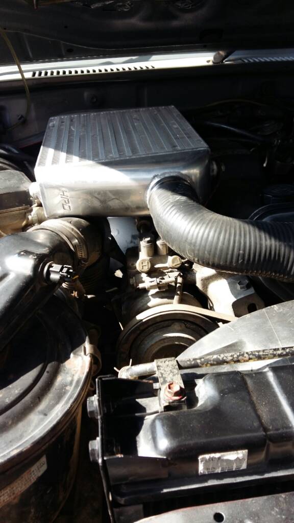

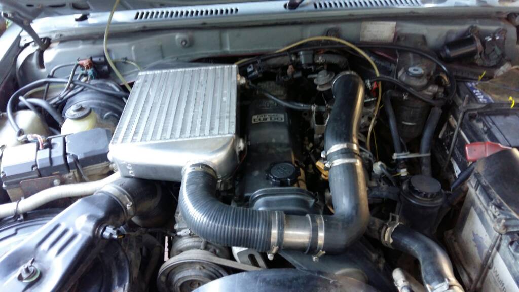

Here are some pictures of my IC project. I finally purchased a full set which was supposed to fit a 1KZ-TE HILUX as they run in OZ. I had to find out that not only the rocker cover hump was in the way but also the valve throttle body builds too high and due to our strict regulations I cannot just drop that part... when doing my research I found that the factory intercooled version also uses a different intake manifold which builds flat and the throttle body sits horizontal on it instead of tilted some 30 degrees to the left.
out of question that buying those parts would mean facing bankrupcy. Toyota is asking about 1000 EURO for intake manifold and throttle body. hahaha. if somebody is interested in how it would look I do have a screen shot.
so...as my front is crowded with AC radiator, Oil radiator for the A343F and AC pipes no chance to go front mount without huge efforts.
I´ve seen other KZJ with AC where the pipes run differently, well not mine...
after some fiddling I found that the best space under the bonnet without lifting the body is parallel to the rocker cover, see for yourself.
Does anybody know the temperature of intake air after turbo? may that be around 140 Celsius? Well, actually I can still touch the surface of the IC after a ride, but you wont rest your hand there. must be around 60 - 70 C I would guess.
I am planning to do a custom scoop with two air channels so that front and back get a fair portion of wind. at the moment I have the scoop as used on HIlux, came with kit.
I got an adapter for the throttle body mady from stainless steel which even gave the opportunity to mount the accelerator and kick down cable. nice part.
here we go, cheers and again thanks for the inspiration!

another one...the core is slightly wider than the factory IC but 3" thickness.
I have run a hose from wastegate to the adapter for the throttle body to receive pressure input from there instead of at the turbo outlet.
Finally I have changed the Fuel Pump setting by doing an extra 1/4 turn. At this setting there is absolutely no smoke at no time, not after start and not during full throttle. I guess there is some potential left but first I need to pass my road worthyness test in september. :mrgreen:
that was pretty much it

Nice truck and some good work going on there. Great to see people giving it a go.
Intercooler looks like it would work fine for normal driving but slow off road would get heated up by the turbo below it. Suggest a heat shield and a fan if it would fit?

kbushnz wrote:Nice truck and some good work going on there. Great to see people giving it a go.
Thanks Calvin!
You are right and I´m also worried about the heat in that compartment. the engine bay is so cramped and the IC basically rests on the AC tubes and next to it is the Webasto heater. Nevertheless I plan to do something like heat shield and fan. for the heat shield I´m not sure how to do it best. I don´t dare to cover the heat shield of the turbo with another layer of insulation as this metal sheet has some cooling slits. would this matter? regarding the fan I´ve seen a lot on Ebay like 8" diameter but I would really need something more compact as I can´t put another 3" layer on the IC itself. Any ideas?

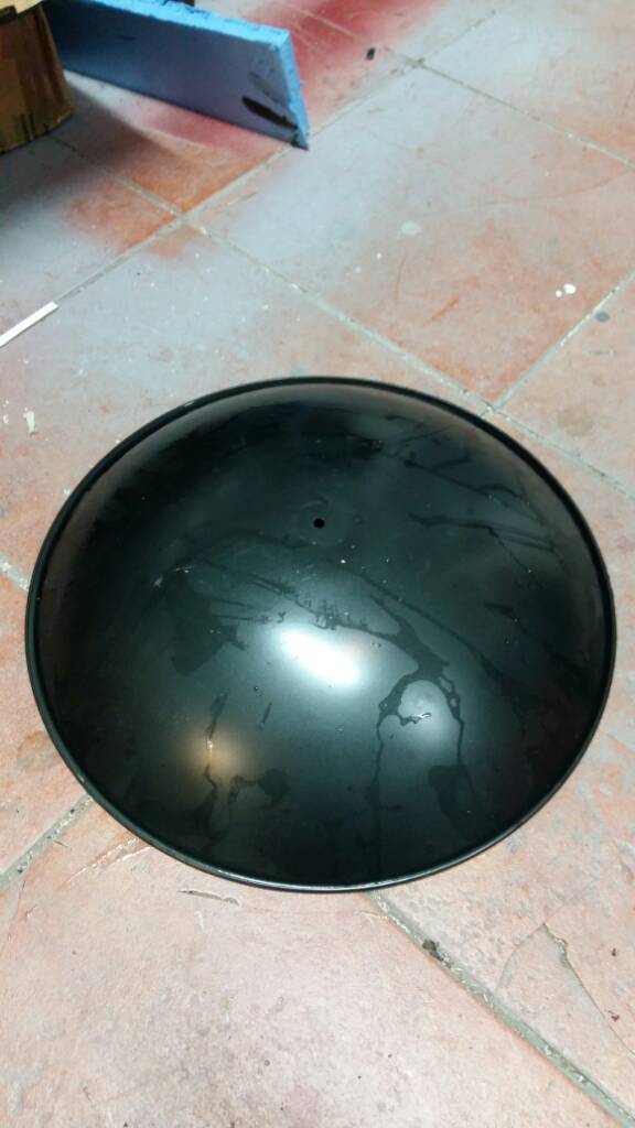

so, I followed Calvin´s advice and gave it another shot...
space is too tight for a fan underneath the IC so I decided to put in an additional heatshield just between the heat shield of the turbo (there are cooling slits right up to the IC :twisted: ) and the IC itself. would say there is a clearance of about 2,5 " between the two.
was thinking how to do that and was searching the garage for some tin sheet when I found the lid of an old Wok pan :mrgreen:
as I like the recycling idea in general I just started to cut it out and bend it into shape an screwed it to the cylinder head.
as there is a nice airstream from the visco fan I finally decided to place some rubber mat from on top of the fan shroud to the lower side of the IC. this way there might be some air stream to blow away the hot air between the to metal sheets. or not. we will see. trial and error but better than before I guess. hope it won´t harm the turbo ?
[/attachment]
lid of wok pan :-)

so....did like 4000 km now with the IC fitted and still glad I did it. good torque and accelaration.
put in an 8" fan below the IC now to support it at low speeds. as it´s autumn now so we are having temperatures at below 10 celsius, summer will tell how it works.

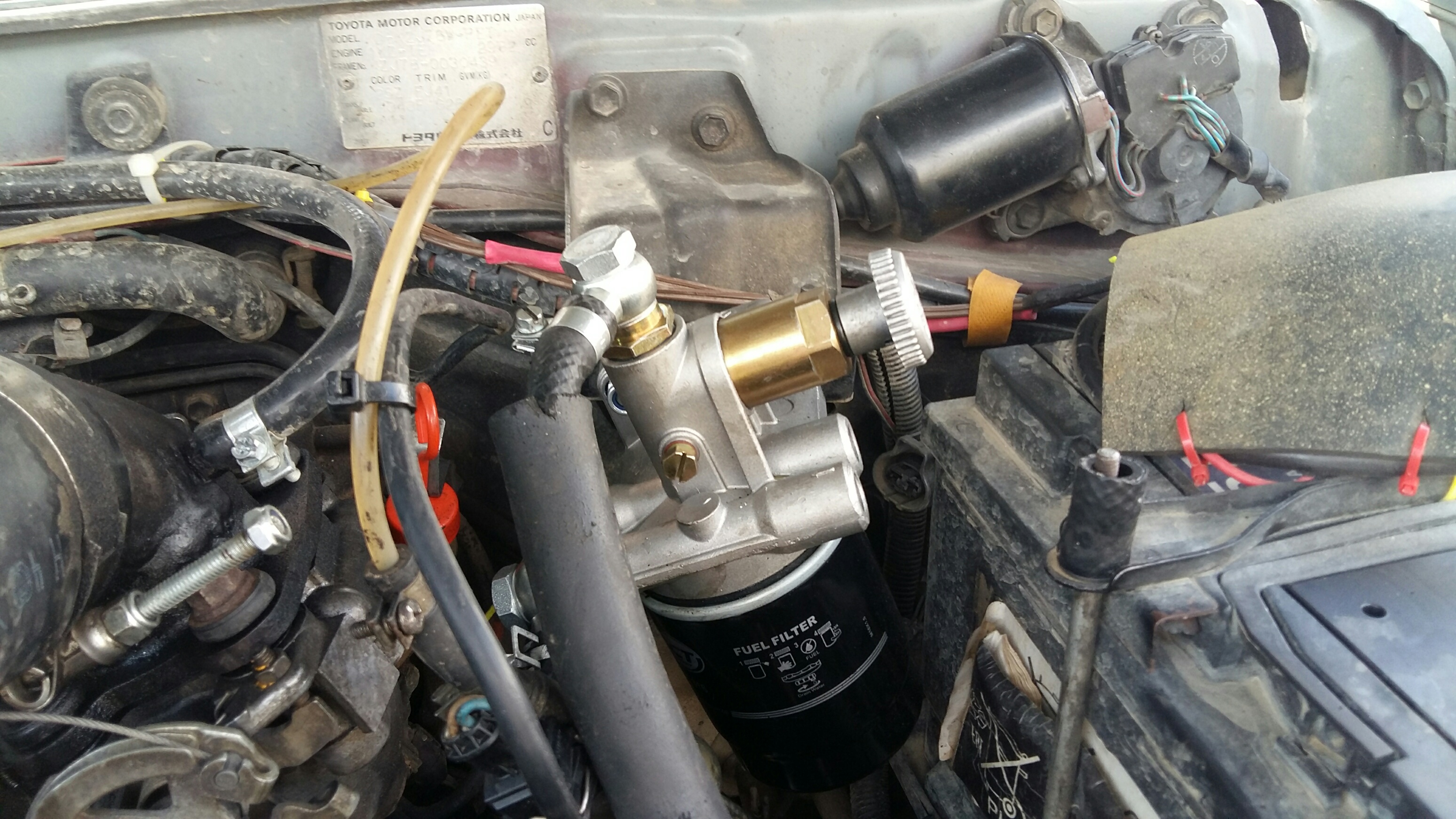

had to exchange the fuel primer pump too.
probably the third time that I have that job done because of leaking membrane.
no I just went for an aftermarket pump used on dumpers or tractors.
goes strong and hopefully will last. if not, membranes are exchangeable. pump was 1/3 of toyo part. ok, has no heater built in but I don´t really use it in winter time.
