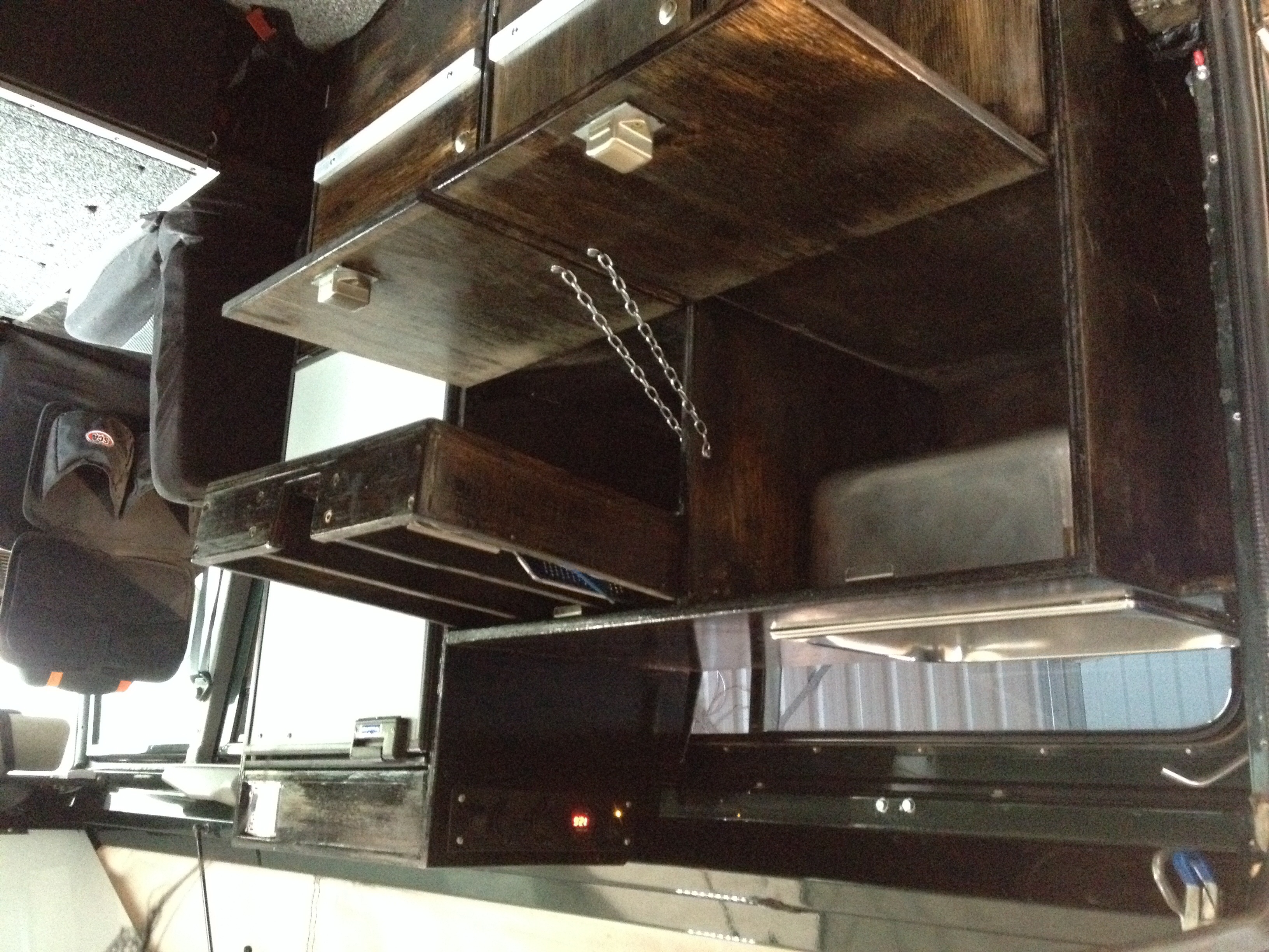

Re: D.B's Defender 110
After 3 solid weekends and a couple of hours after work each day it's finally finished!!!!!
It's really hard to take photos inside a vehicle and get the lighting right!!! The photos seem to correct their orientation if you click on them and open them up fully.
Finished product:
Cupboard doors double as tables/benches:
Sarah's only request was that she got a cutlary draw as the click clack lunch box she was currently using left a lot to be desired:
Finished product:
To protect the back of the fridge from the sun, 5% tint and a hacked up sunvisor thingy that you use on your front windscreen. Also hides the wiring birds nest
All the plumbing tucks away nicely not talking up to much space
On the panel left to right is the master switch for everything in the back running on the house battery, house battery voltage gauge, twin USB socket, 12v Socket, switch for rear outside flood/camping lights.
Still plenty of room for sleeping in the back with the roof down, although this Alex's bed normally
And finally, I get to ditch the jerry holder over the left rear window, no idea how pleased I am to be rid of that monstrosity!!!!!

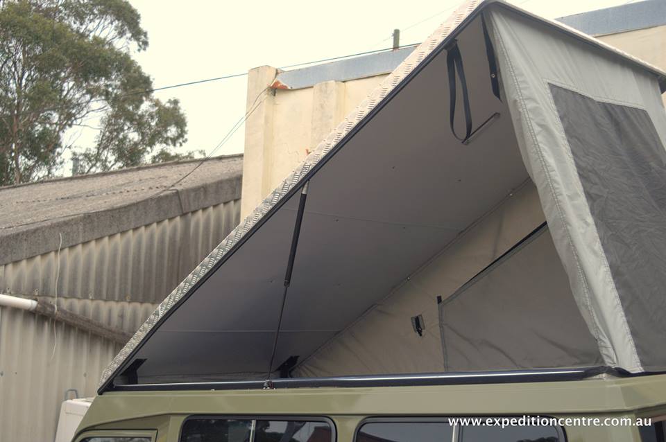

Epic use of space! Is there an upper sleeping platform too?
lax2wlg wrote:Epic use of space! Is there an upper sleeping platform too?
Yeah there is, its really hard to show though. This is a Troopy, but its exactly the same system on the Defender:
Bed in the Up position:
Bed in the sleeping position:
