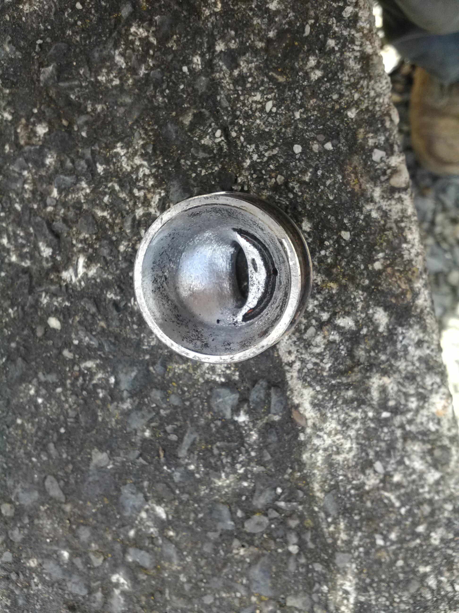

Re: Angrier td42t build
Starting to have a play before i buy a new set to port and fit,
Will get it how i want it then make some tin profiles to get them the same.
Mainly a blend job an slight enlargening of the mouth.
Also a small radius on th tip point in the cup to stop the heat cracking it so much.
Bit more into it.
Might be time to get a virgin set and lay into them.
Precomp chamber volume will be increased and air/fuel exit resistance decreased.
Also going to set the injectors 60 thou deeper by taking down the heat shields.

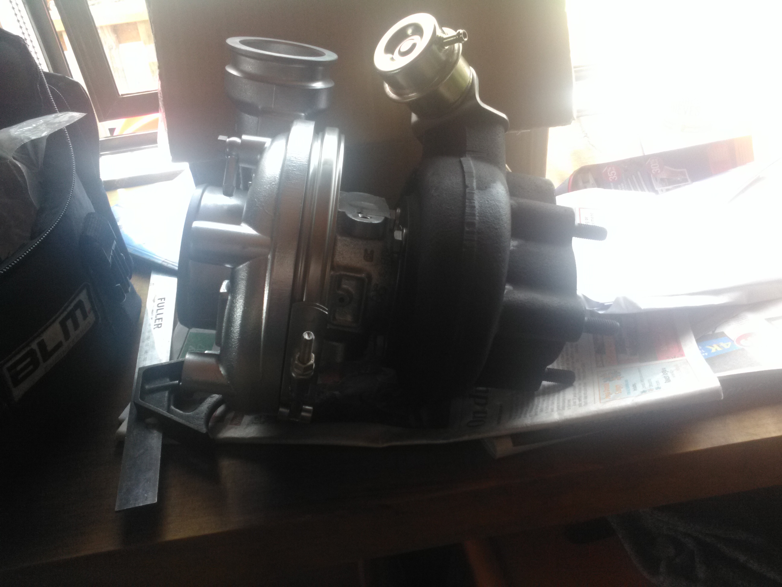

More pieces to the puzzle.
Turbo and precomps turned up.
Picking up flywheel Monday.
Cheers to Jarrad at turbocare for the loader turbo
Even the young Sid's happy bout dads plans

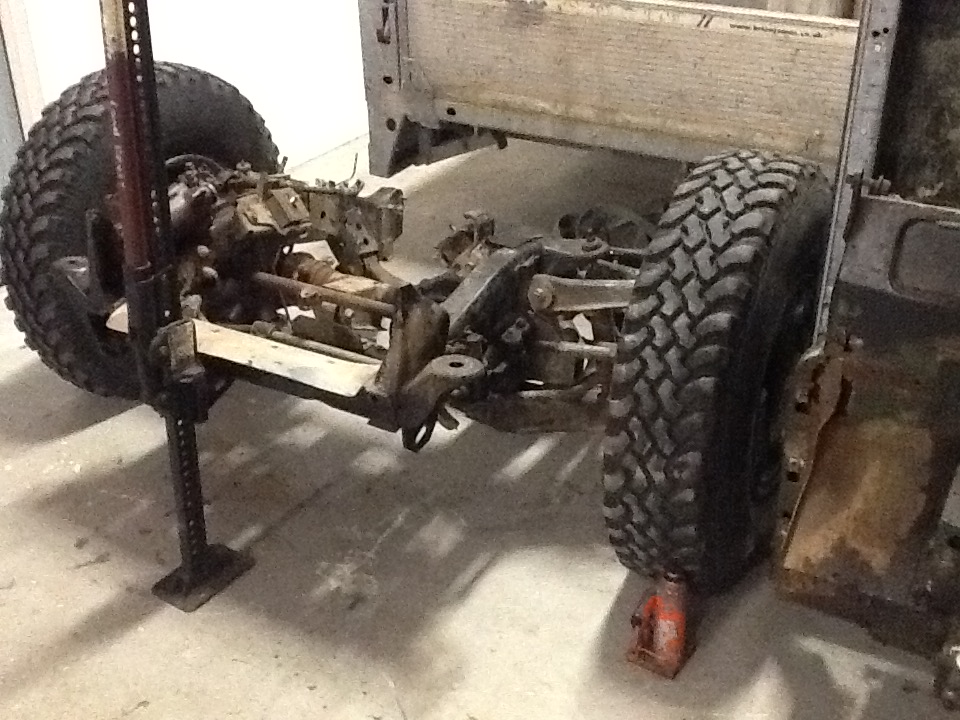

slidenyo wrote:Cheers josh wheres the rano now? Still in storage?
Can't shake the stupid thing
Low priority at the moment, but I have this IFS front cut sitting in the corner, will eventually use it as a testbed for the coilover/long travel project...
Get the diffhead bang in the centre using an irs half shafts? Then a second transfer case to get drive out the side?
Or just narrow the ifs diff?
slidenyo wrote:Get to the diffhead bang in the centre using an irs half shafts? Then a second transfer case to get drive out the side?
Extended a-arms, increase total track width by about 4-6" for mega stability Then a full float Atlas rear end/spacers to match the rear.
Defo IRS shafts, likely the 300ZX turbo 30mm axles with Safari outer CVs. Seems like the inner spline count might be the same, and they are a good length
