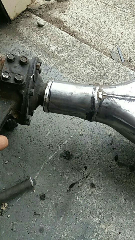

diff all centred up and made to suit the job as in offset of the head etc

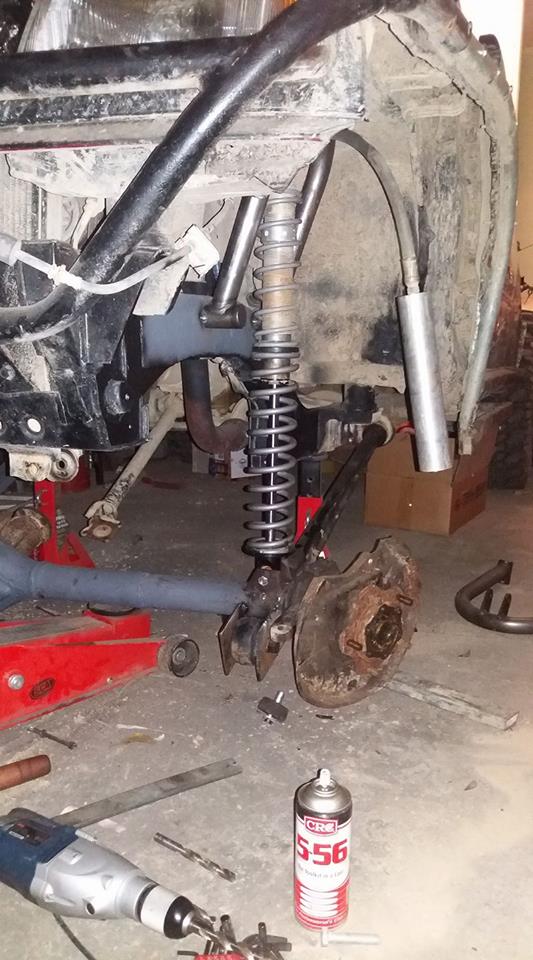

swivels are just tacked in untill mounted on the radius arms thenn caster can be sorted when its at ride height

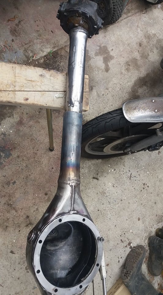

have slipped the 413 axle housing into the vitara housing by 80mm and will end up braced as well

got these cool shocks for it as well cant wait to set it up and use it
foa 12 inch travel
foa 12 inch travel

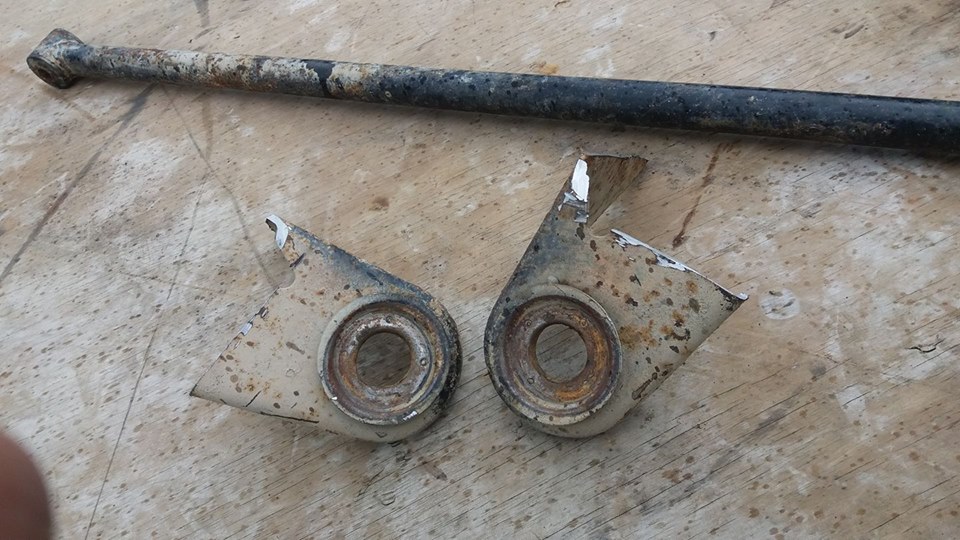

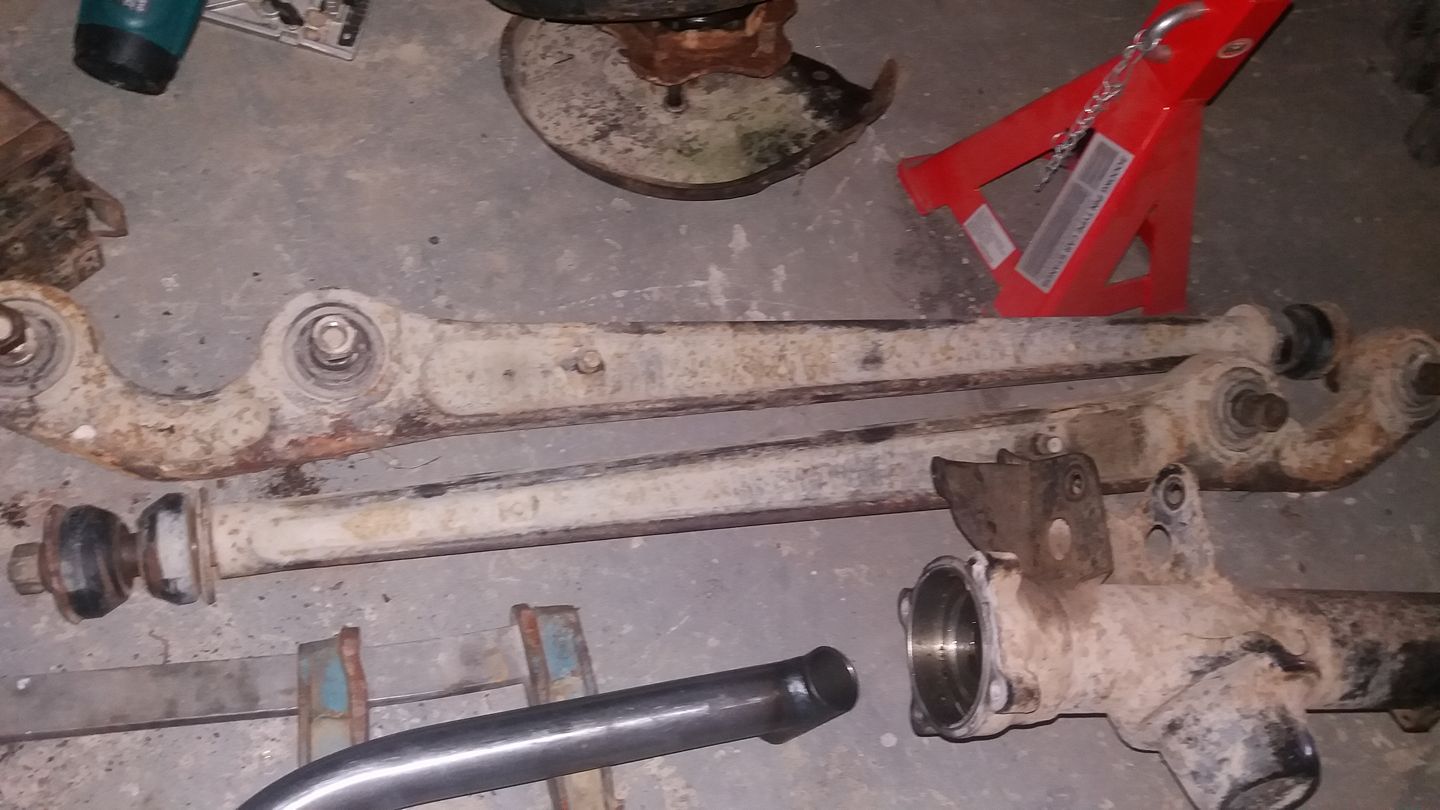

next up is sawing the factory trailing arm mounts off a poor un suspecting pajero for the trailing arms im planning on running
i was going to make my own at the chassis end but have herd of people punching the arms through brackets because there wasnt any support on the bush at the piviot end
heres a pic of the trailing arms

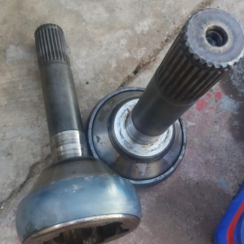

going to get a locall company to cut soem shafts for me they did my last set when i made the same axle

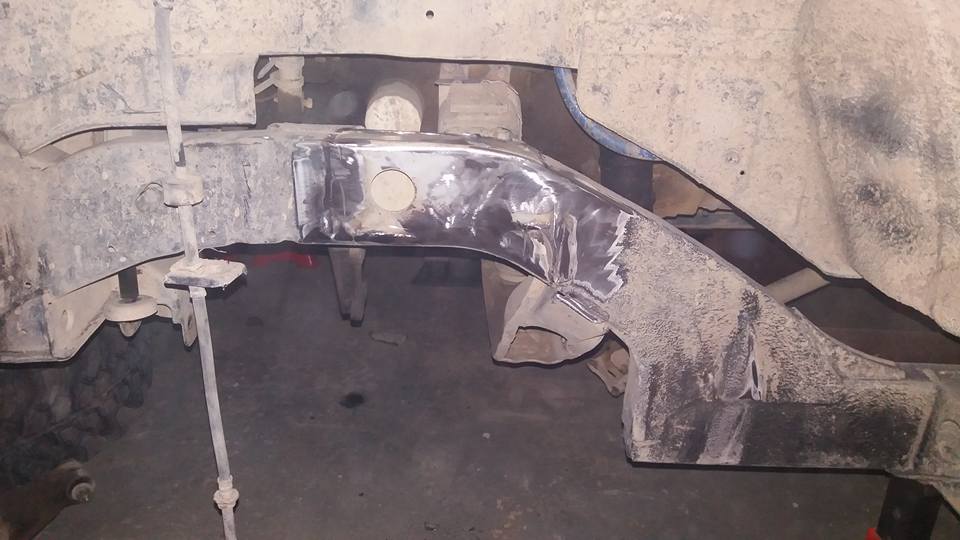

so been a few days since i posted here .... week or so haha
went and sawed the factory mounts off a pajero chassis for the trailing arms what a arrrssseeee of a job lol
cleaned them up and fitted them onto the chassis where i needed them i wasnt sure of placement as in do i run them on the under side or out side but i went with out side so far so good .... fingers crossed

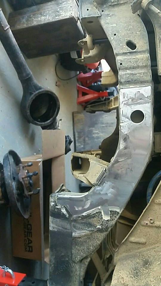

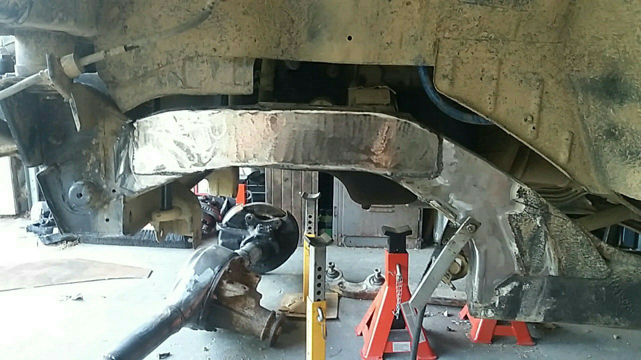

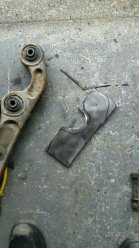

made a plate to beef up the chassis rail at the front as chassis was only made of 2mm so ran some 3mm down it to make it stronger you cant see in the pic but i have drilled a large hole through the plate and secured the plate in the middle also so plate is fully welded on the edge and also in the middle
went to the scrappys today and got some heavy wall pipe for the steeering shafts that are now longer so have sorted that as well today
i allways go for the paint it when its together method and it allways looks crap and cheap so i buffed the diff head down today primed it and brush painted it with a couple coats of blaaaaaaccckkk my favourite colour haha
ended up fully welding the brackets and priming around the brackets and the parts of the housing i was finnished with
yet to come is the panhard mounts and the shaft it self i was planning on running a pajero factory panhard but i think the bushes will bind and steal some travel/ flex
ill dump a hole heap of pics here
not bad for a young bugger in a cramped single garage i reckon haha quite stoked how its coming along

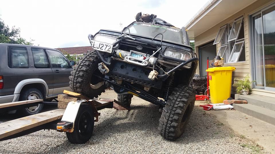

got the truck together enough to drive it today after making the panhard brackets and making what may be the most piece of over kill panhard for a suzuki haha i ended up going with a cat1 size tractor link (for using impliments behind tractors ) they use a very robust rose joint / rod end so i have sorted that mounted it heres a flex shot i think i need softer springs yet

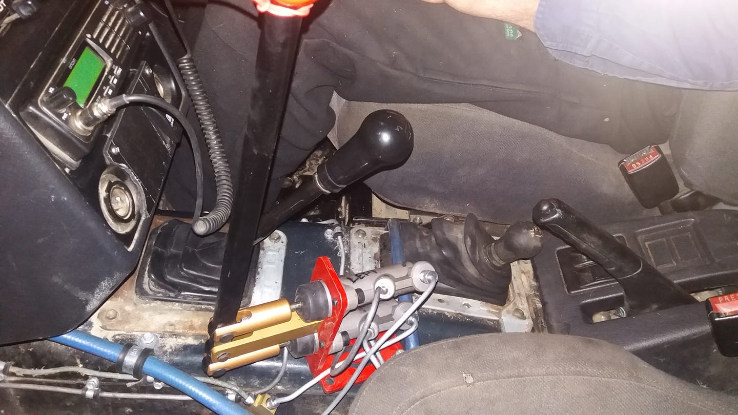

heres some pics i have since plumbed in my fiddle brake to the front
pic of my cv rings fitted to factory birfeild cvs
let me know what ya think

Looks awesome Greg, loving your ingenuity. The CV ring is a good idea!

shaved the bottom off the diff ,added diff trusses mainly due to having them laying round for a 413 so made them fit

added a fiddle brake set up as well got this from e bay and mainly went with this design to save space in a tight cab
and man what a bastard to bleed up !!! took 3 litres of fluid and a lot of time and swearing !!!

axles back and fitted up all is well lost a bit of huff on the project and want something turn key fun ! so this is up for sale at the mo see what kind of hits i get

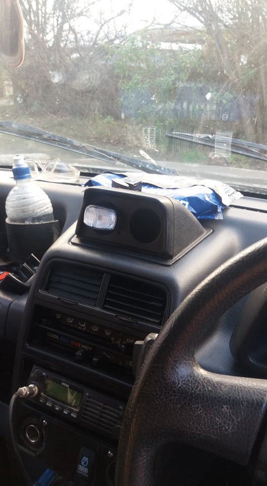

since my last post ive decided i should grow a pair and keep the bastard truck haha

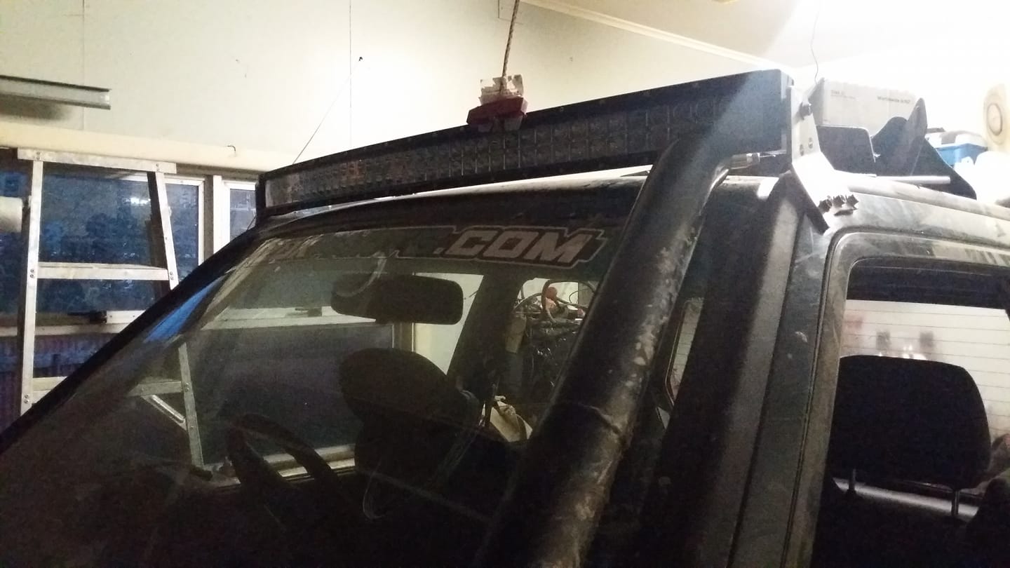

so today i fitted up the axles and fitted some sweet interior lights ! 60mm square led work lights its like day time in there !
ordered a air locker ... cos you know nothing like a freshly imported part to re ignite the drive to finnish the build !
also collected some auto trans parts so i can convert it to auto !
one so the mrs can have a drive ! two i love having a park position knowing there is a steel pin locking you truck in place is allways nice !
and 3 i loose omentum between 1st and 2nd and can create wheel spin and make hill starts a head ache so auto should solve that ive chosen the 4 speed ecu controlled unit so i can later on make a manual controll computer for it when i feel all the creases are ironed out
also picked up some spare front guards as they are just a consumable item

so another weekend is here !
i ordered some mean 10 inch travel bilstein shocks from 4wdstuff gret guys btw! (shameless plug there !)
fitted them up yesterday used the modified mount i had made on the diff housing earlier andc mr suzuki the legend put a crossmember right where i needed one so drilled through that 100mm off centre and ended up using honda accord 97 ish 2.2l front springs in it they are damn close to being grouse ! soft enough that with all my junk on the tray it dosent loose too much height but still a long ass spring !!!
today should see the airlocker being installed into my spare diff head
and hopefully my gearbox in the old tow rig re installed and sold welll fingers crossed !
will post pics of the tre airlocker and install when i do it
heres some pics for ya troubles
subaru seats from a subaru outback
the front drive flanges
rear end
and also my tray i want to change but not sure on design yet
