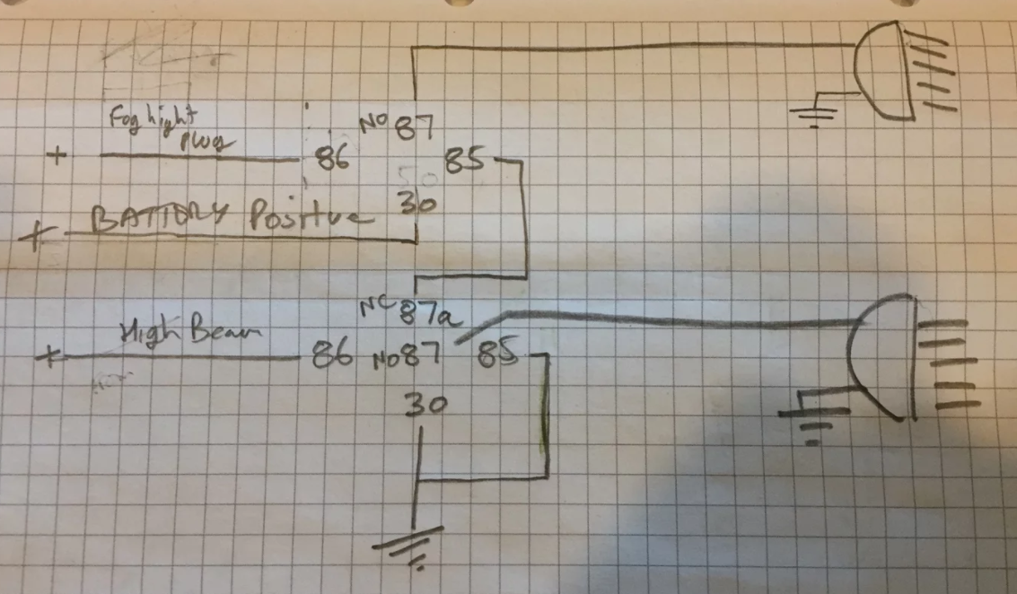

I drew up a wiring diagram for my new lights but forgot about the negative switching on the high beam:
The fog lights need to turn off when I turn on high beam. As you can see I have wired NC on the high beam relay to the earth side of the fog light relay.

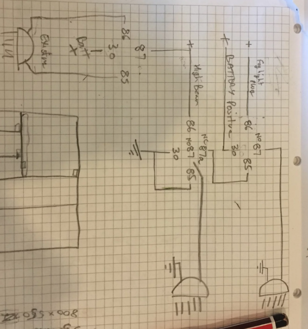

Right now I’m thinking easiest way to solve this is a third relay connected via the existing high beam:
Anyone got any better ideas?
Thanks,
