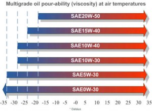

What grade oil are you running??
The reason it's quick when warm is that oil is thin so it's easy to pump around and up to pressure. Normally bottom end wear shows itself as low oil pressure in hot idle, as in the oil pressure lights comes on or flickers.
Diesels suffer from oil thickening due to the soot particles produced during the combustion process, that's why they have such a short service interval.
With that in mind, depending on the service history of the motor (lots of sludge in there??) , the cold weather, and the incorrect grade of oil, and a bit of engine wear, it's probably not panic time.
I would fit a mechanical oil pressure gauge to see what it's doing at hot idle, do a engine flush, and run 10w40 so it's nice and thin on start up.

Cheers, used a 15w40 diesel oil which is what this motor is supposed to run.
New genuine Nissan filter with anti drain back valve fited.
Might try a pack of 5w40 diesel oil and see if that help, Supersheep has them for about $70 at the mo.
