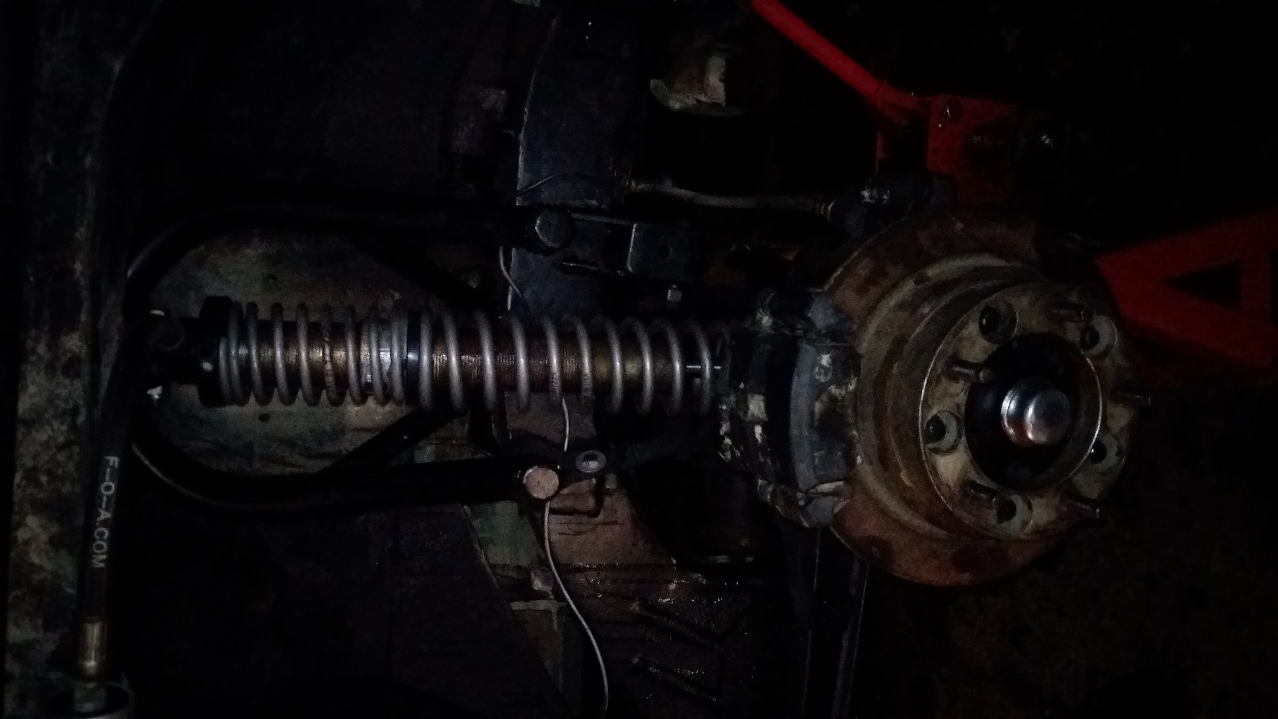

Some up dates for ya swapped bearings over drilled the air fitting hole

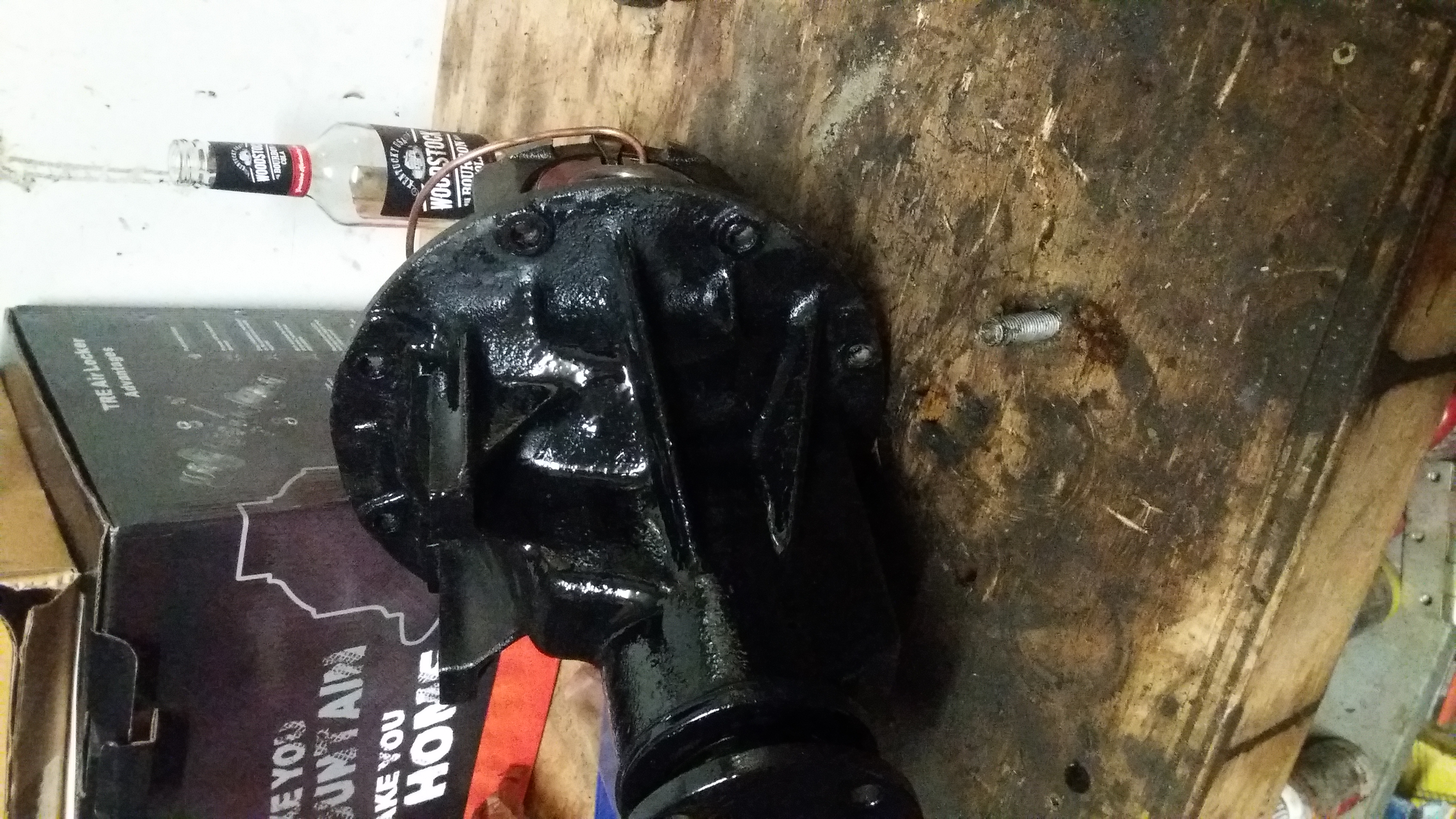

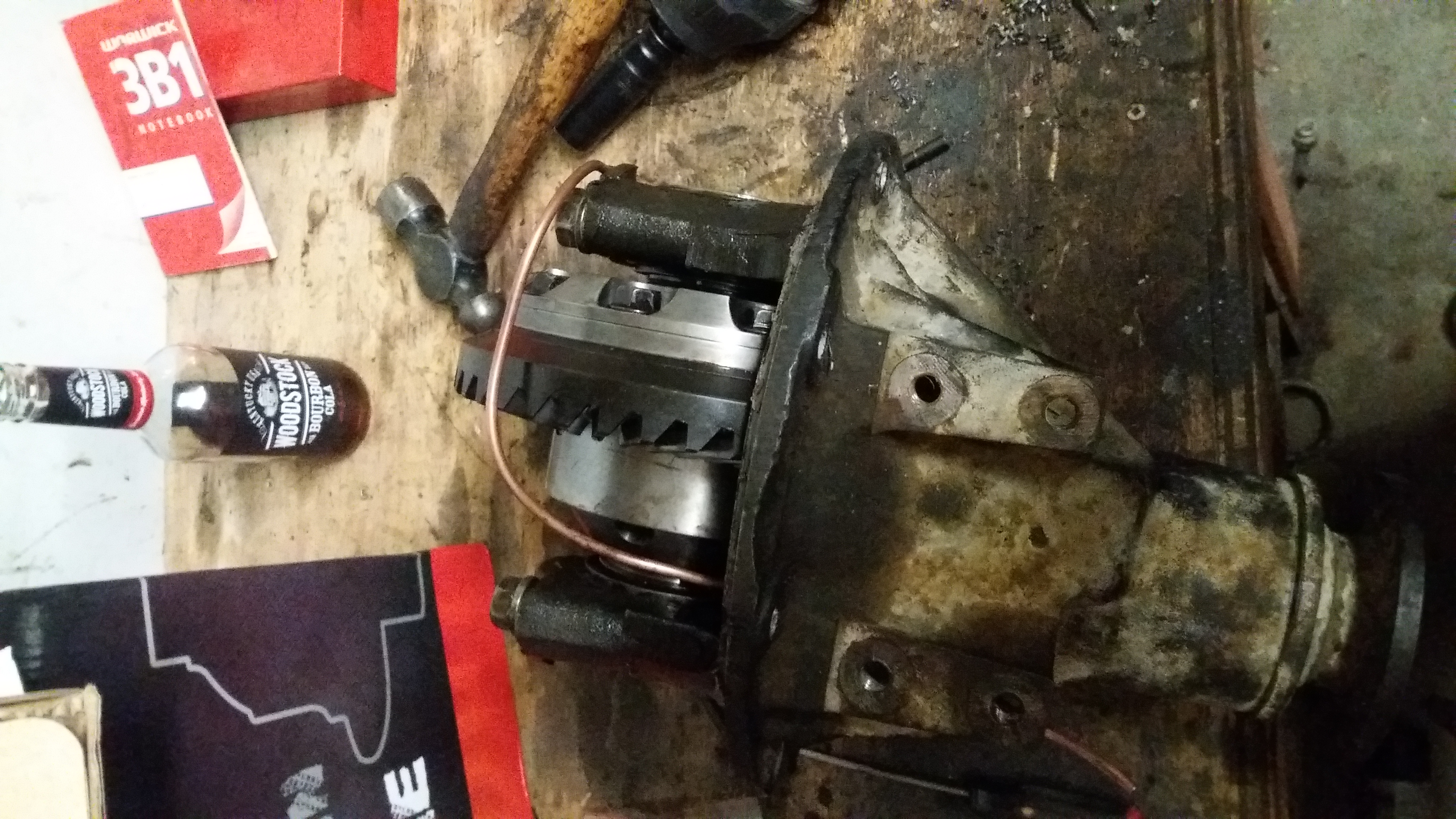

So today wasn't too hard at work so I got some work done on the zook tonight !
Got the air locker unit swapped into the crown wheel
Drilled and tapped the hole in the head
Fitted it up checked back lash and tooth pattern
Ran the line for the locker line to the sliding collar
Here's some pics I must say that the tre locker instructions are well done and not chinglish at all ! Great supprise !
Pics
Pics

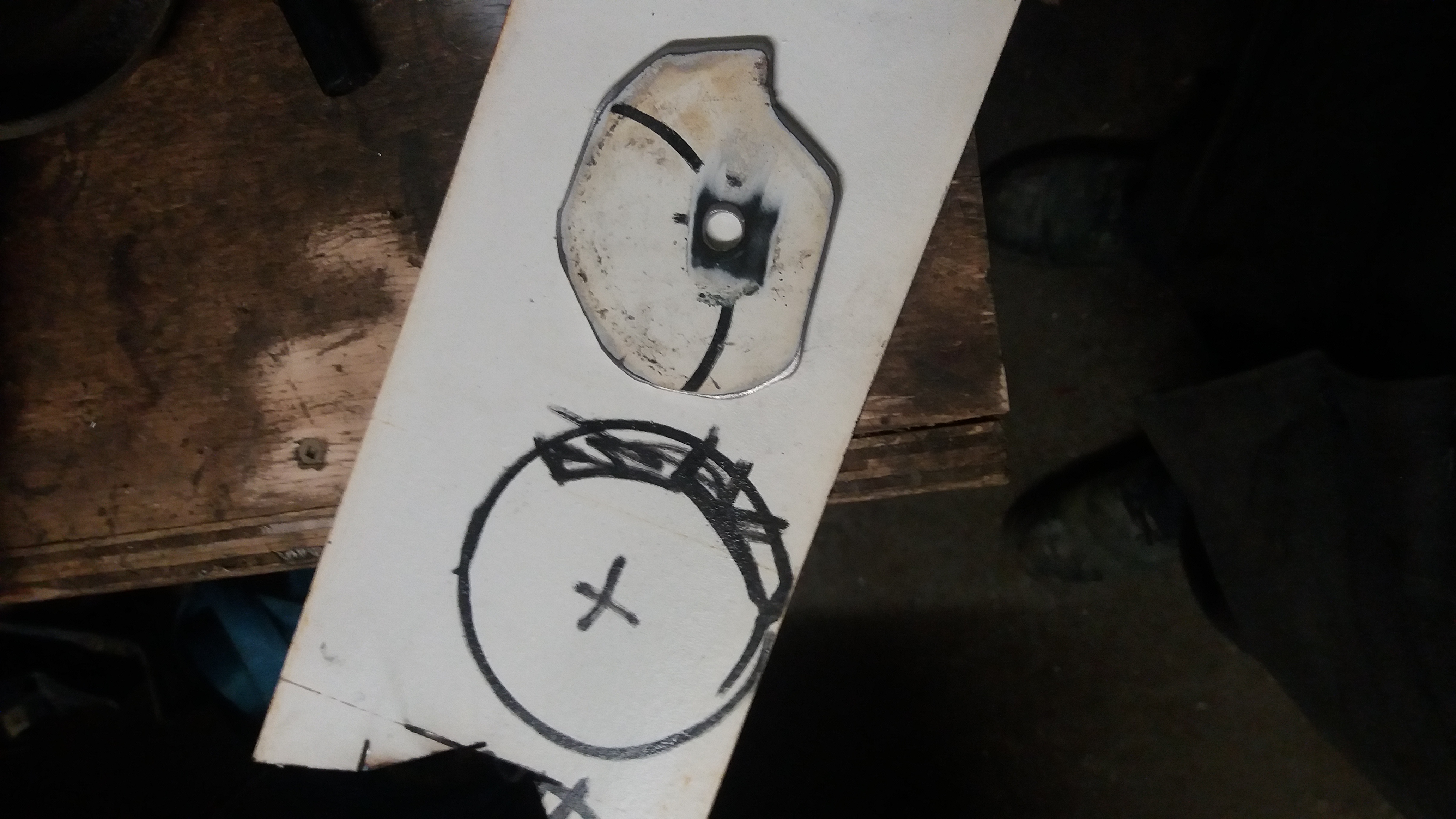

back at it tonight with the new shocks and the mk3 upper mounting choice the springs become loose on full sag so spring clamps are inorder ! Took the springs out drew round them and took note about the coil placement and made them up drilled a hole and used some 10x1.25 long nuts and was able to extend the bump stops as well all in one hit !
Messed up and installed one ontop of the spring rather than below but it's cold and late and dinner and a shower is calling !
Here's some pics for ya Thursday night !

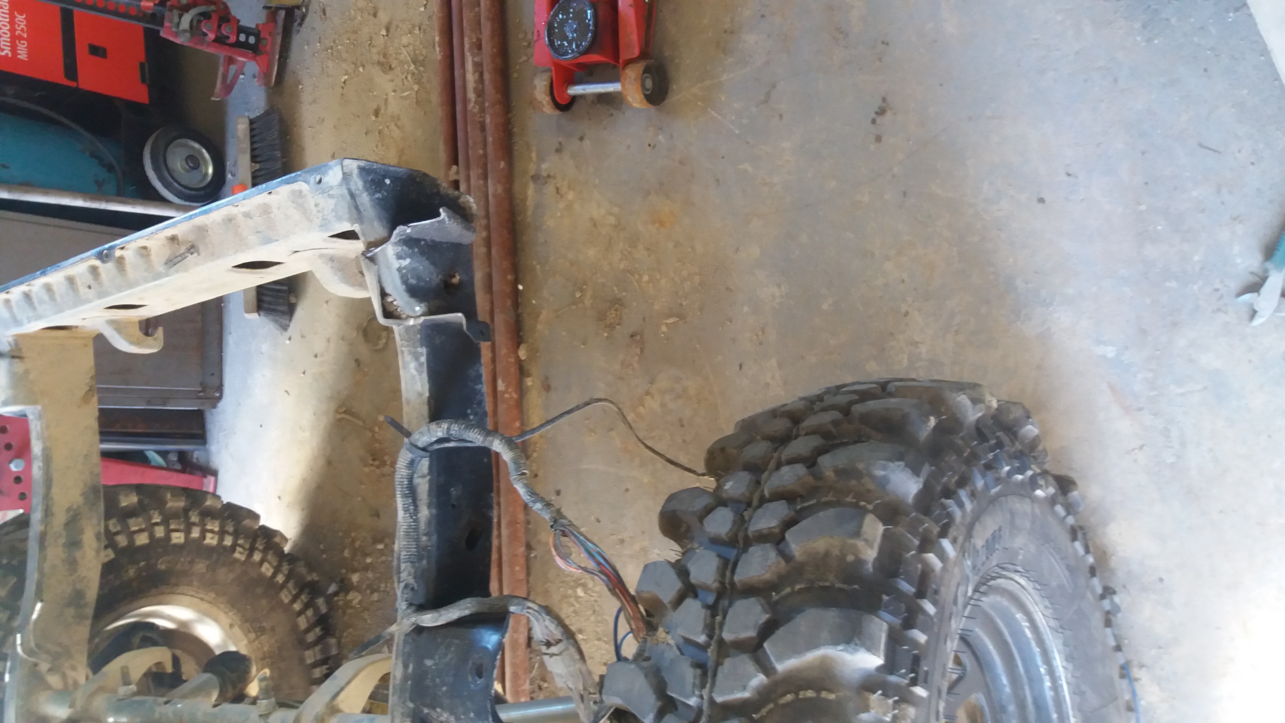

Sunday fun day !
So today brought the end of some annoying jobs !
Front diff cover clearanced and plated back in
Spring disslocation cones done ( altho I don't like them I can't think of a nicer way to do it yet
Front end oils bolts and General check over done

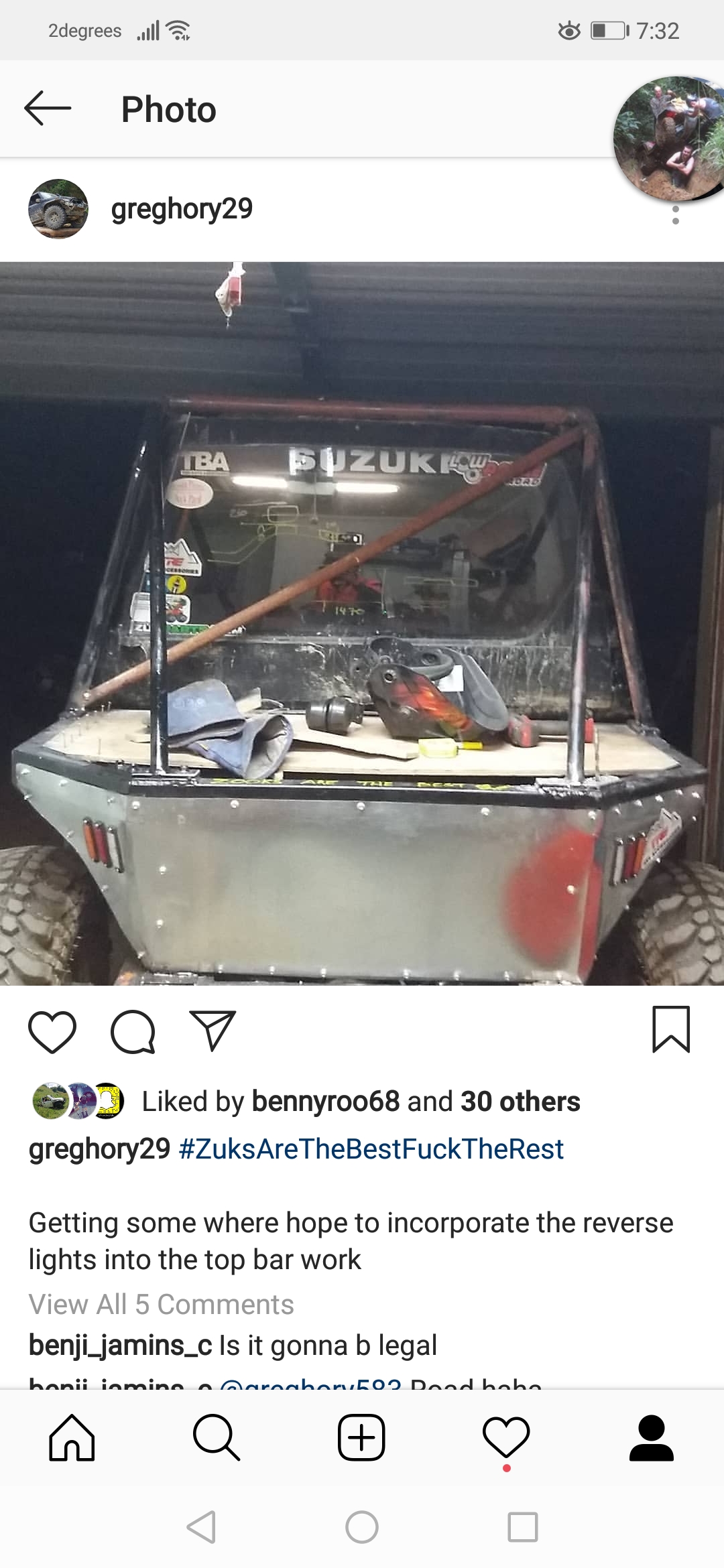

New tray build at the mo using 75x50 x3 should be plenty strong
Covering in the sides like inner guards as it gets really clogged up with mud and then gets heavy so to help reduce this I'm doing none guards and fix some extra storage ice got a big ass drop box in the back of the tray for strops and recovery gear .
Also future proofing the tray by making space for a winch tray in the back too
Rear crossmember is 65x40 x5mm fully welded and braced back for extra strength
Removed about 200 mm chassis when I removed the old croasmember from the back
Tank is moved to behind the cab now too
Also on the hunt for a 8274 or similar to make the front of the truck complete haha
Had a moment of weakness and sold my 8275 and regret it since !
Even a box of parts will do me for now of 8274 stuff
Greg
Greg

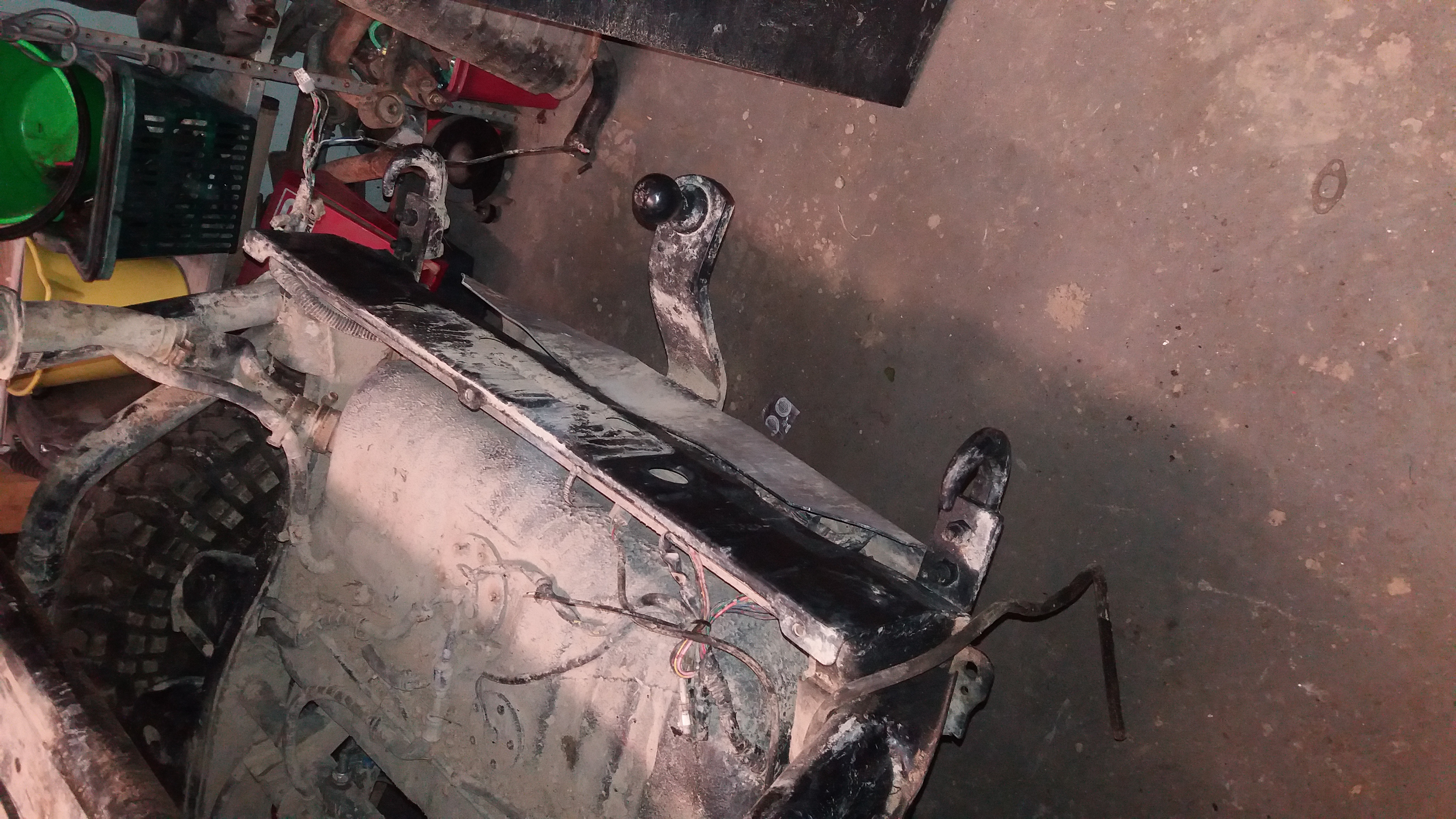

Re: vitara solid axle build

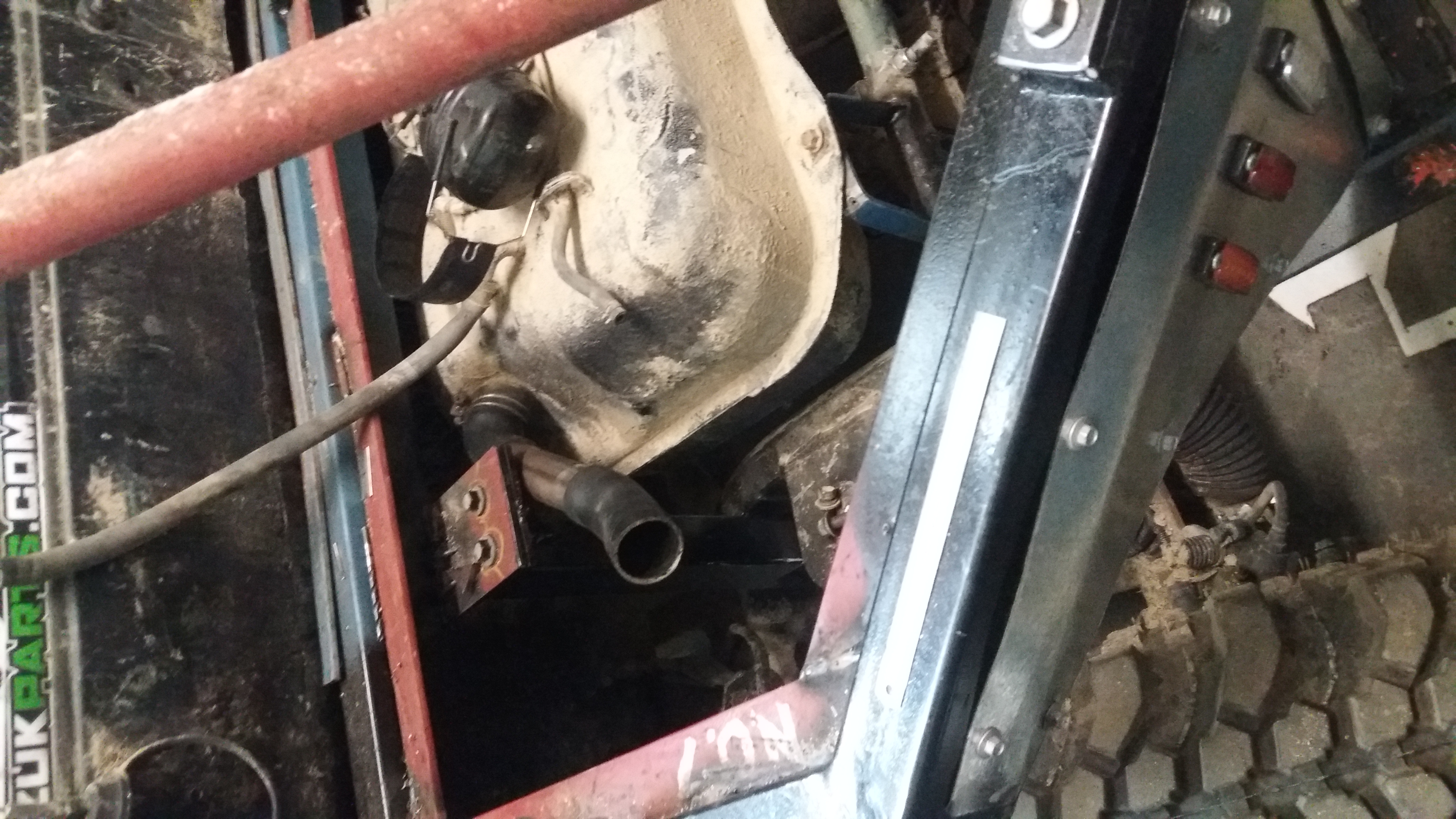

Bit of progress on the old girl new tray and hook mounts and eco cage started as well as rear radiator

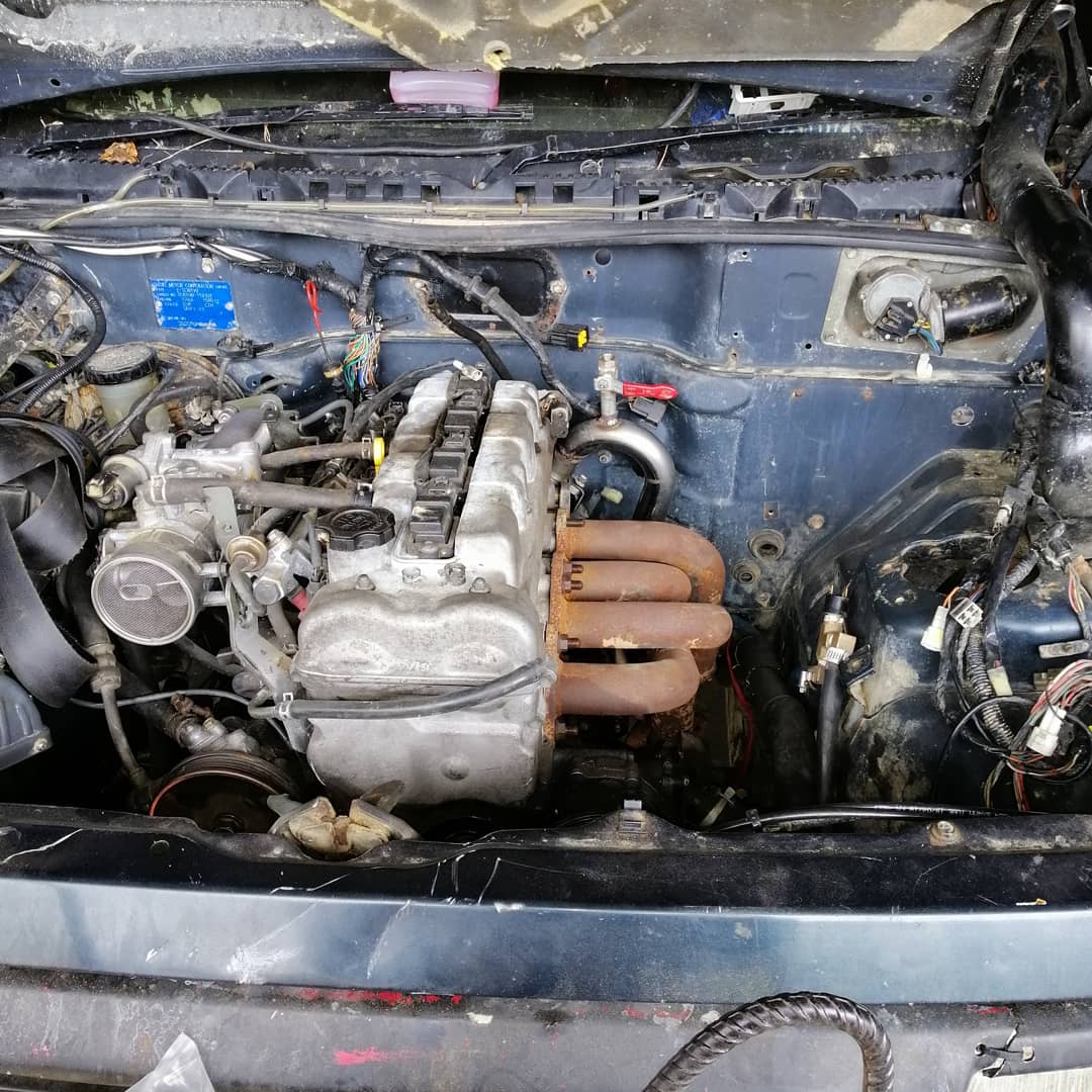

Shit it's been a while so much has changed since the last posts
Tray is done. Tank Moved. Exhaust done for the J20a motor. Drive shafts nearly done
Water pipes for rear mount radiator are run and sorted
Only a few wires to go till engine loom is done
Will post some pics for ya troubles
So I took a week off to do some shit on the truck
Got the water pipes done
Beadlocks done
Axle sorted on left front
Tray back on for last time
J20 to run
Had to replace the oil pump in the trans
Lots to go yet but its only Thursday
Hope to have a drive over the weekend
Beadlocks done
J20 to run

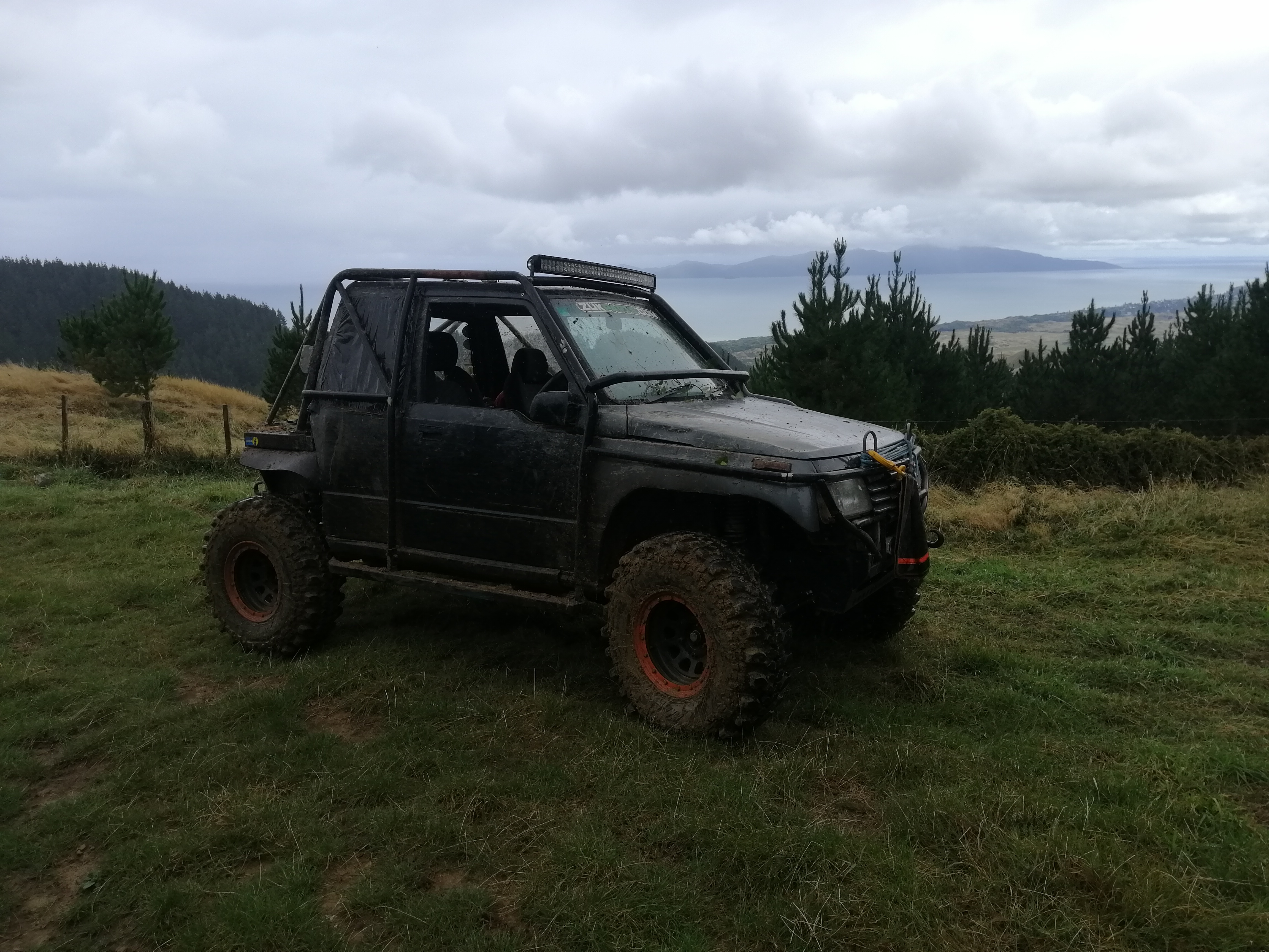

Took it for a first trip..... with out a breakage!
Went really well love it here's some pics

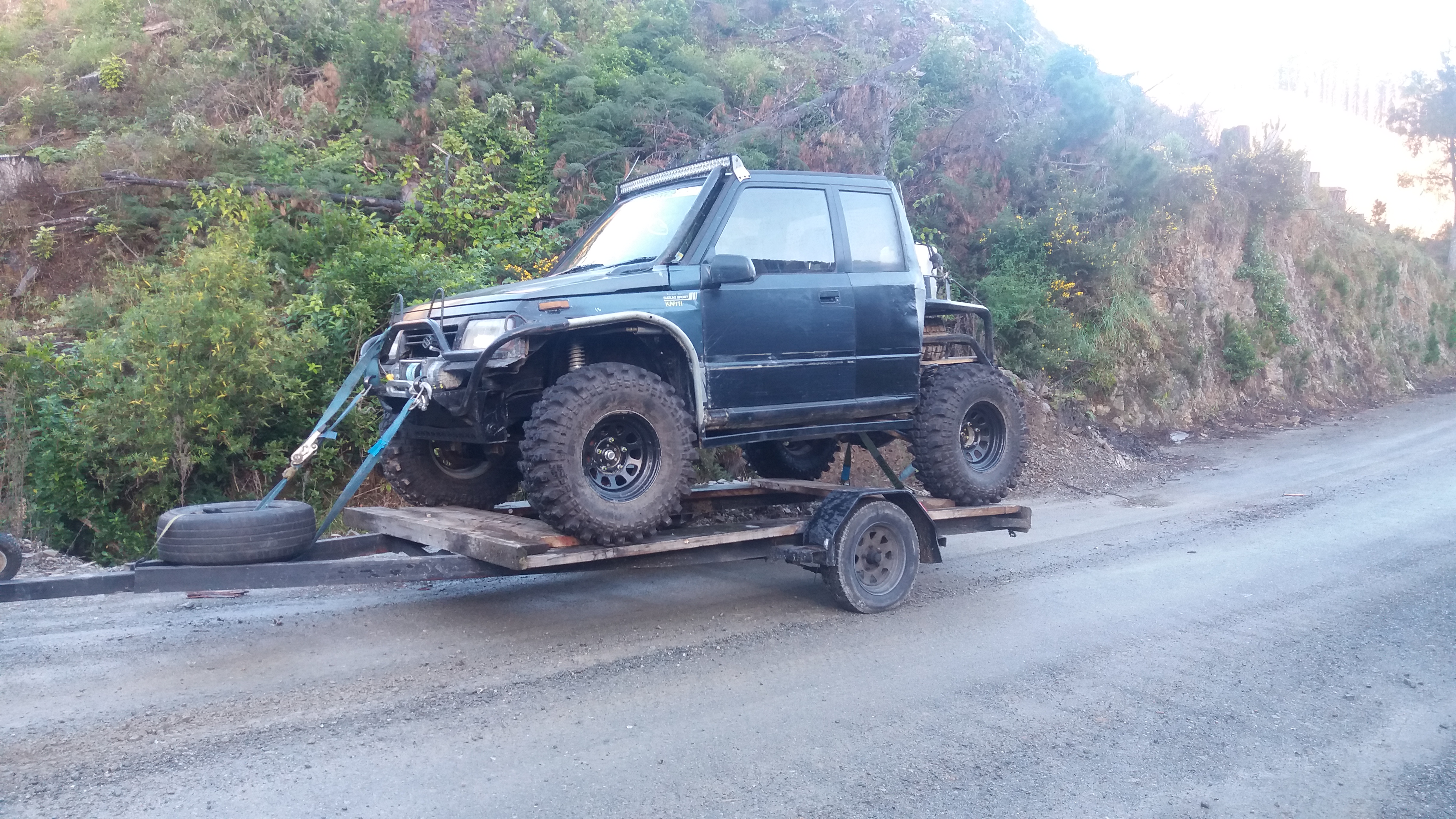

so since im crazy ive decided to sell this and build something else
truck is on trademe or call me on 0272012916
comes minus winch and on a trailer for 6800 ono
wellington
wellington
