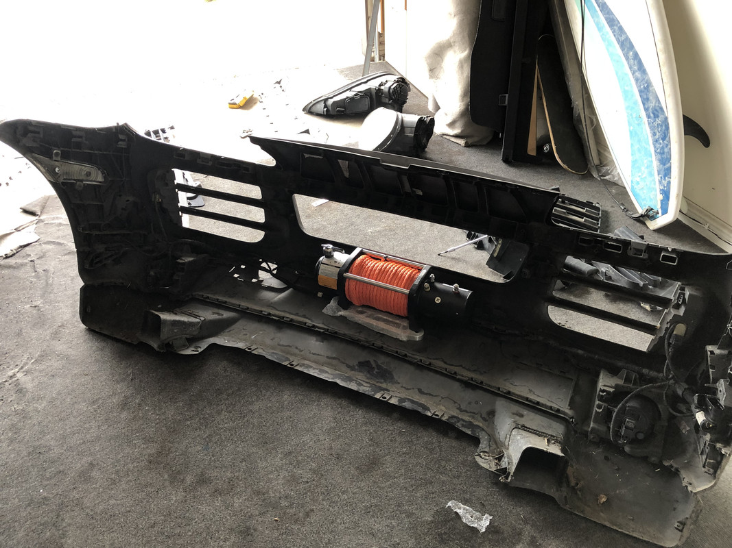

So was a quite day work wise for me, so started on the winch mount, Stripped down & position worked out (Fingers crossed) looks like it will fit very tidy.!

Winch mount tacked & ready for trial fit. still go a lot of bracing etc to go.
Re: Porsche Off -- A Cayenne Offroad Project
Got a heap done on the winch mount today.. Not pretty but not seen in this case. Seems to be strong AF..
the Fairlead needed to be slightly adjustable so Had the bolts poking outward with a piece of flat bar to stop the head spinning while allowing the bolt to move up/down by 5mm that way I can still undo it if the thread gets damaged etc.
Also has lightbar mount & solid recovery points.
Well thats the winch fitted.
