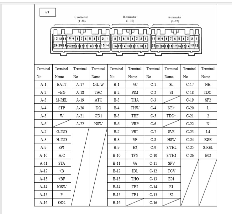

What vehicle? I have some pin outs for various ecu's....
You are looking for SL, here is the ECU pin out for the surf.

Cool then the above pinout is the same (for the trans) for the KZJ78 as thats what I used....

Thanks for that Calvin
