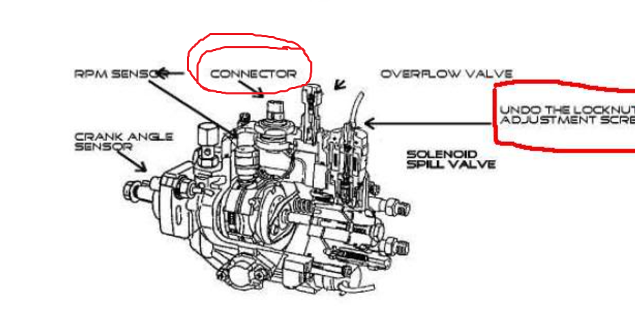

the one connector on top of the pump, is it kind of a power supply for the pump?
is it the speed sensor?
actually I DON´T get any voltage there.
we double checked the fuel pipes and today ABSOL'UTELY NO diesel arriving at the injectors.
so most probably immobilizer?

Re: !997 Prado 1KZ-TE Starting Issues
connector top center is rpm sensor. you will only get pulse readings from that. if that fails ecu should flag an error code.
spill valve won't get voltage all the time, only a pulse when it fires an injector.
to rule out immobilizer i would check voltage going to ecu. that the most likely one they would disrupt.

I have installed the exchange SCV yesterday but it would not even work up to the point the old one did.
my car is a prado KZJ78 and I got the SCV from a prado KZJ95 , I would not think there is a difference, even connectors are the same...
I have got an ECU of the KZJ95 as well which seems quite the same. I heard that the only difference is that the KZJ95 has a factory immobiliser which is triggered by the ignition key and once you overcome that part you may just use the ECU on the KZJ78. any thoughts or experience there? would be nice to have an exchange unit to try instead.

now i tried to hook up the ECU from a Prado 95 but it would not work as well. starter motor turning strong but no firing up. probably as assumed the immobiliser. didn´t expect the starter motor turning at all.

short update here:
ECU was checked at electronics shop, capacitors are still fit for the job, no flaws detected.
this reduces the source of error to the cables between pump and ECU.
