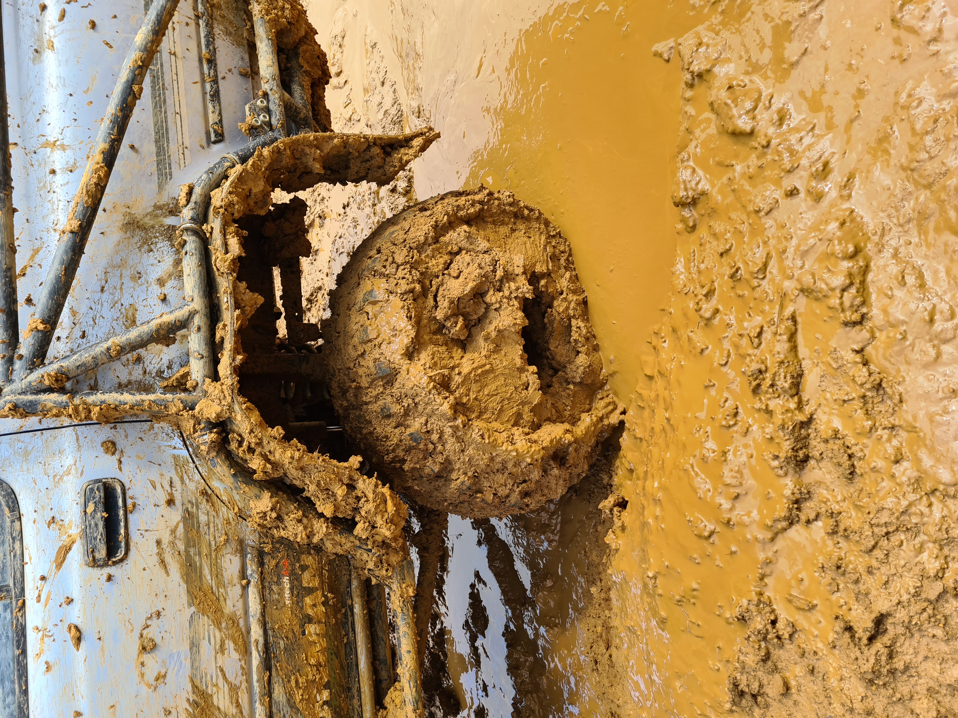

had a brief play with it at the Toyota fest at Hampton downs, was expecting a little more the what was there from there advertised track...
this little water decided to kill my alt and a few idler bearings...
also cooling fan shat itself again- intermittently it would not come on. I think the control valve in the pump was sticky.- but unable to find replacement parts, and now not trusting the hydro fan I've removed it.
made most of the new mount with some high flow 12v fans. this has freed up some extra space now.
potentially look at fitting a hydro pump where the ac pump used to be, and an additional toothed pulley like a lot of poms seem to do on there land rovers.- still a long term plan
also I got sold organic coolant when i first put it together. what a prick of stuff that is, solid jelly clumps clogging up my radiator, intercooler and water heat exchanger.
going to try some coolant flush, but I imagine I'll need a rad shop to try flush it out.
