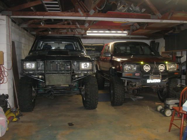

I am not just picking on your new truck but if you want my honest opinion my main concern would be its height .
I personally would lack confidence on steep stuff because the centre of gravity is quite high compared to mine.
What are they gaining with that height because the diff clearance is the important thing.
Looking forward to seeing it

Hi Richard, thanks for your input, I want to see how it goes before I start altering it, but one plan is possibly to lower it a bit and put it on 35's, gotta wait till I see how much room to lower is available due to hi steer etc, May not be enough gained to worry about it, altough hydraulic steering could be on the plans for lowering.
Can tell you it's not too high, there are rigs out there doing the rounds taller than this one......the lux's always sit lower than tall bodied counterparts such as Prado's, Safari's, and Cruisers.....and they all go pretty damn good (when well set up) as well
I guess the formula in most cases is pretty similar unless you're building a trials buggy, the bigger the feet the higher the rest of the shite sits, and the more diff clearance you'll get

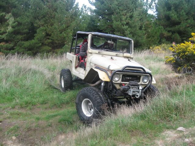

I took a pic tonight for you Richard, before I dragged it out of the garage, compared to Dads double cab which has a 2 inch spring lift, 2 inch body lift and running 33 inch tyres.......It was 2 inches higher (not incl the EXO).... pretty much right on for 36inch tyres.
Tomorrows job now I finally have a chance to get a look at it, give it the big once over

hosehustler wrote:I took a pic tonight for you Richard, before I dragged it out of the garage, compared to Dads double cab which has a 2 inch spring lift, 2 inch body lift and running 33 inch tyres.......It was 2 inches higher (not incl the EXO).... pretty much right on for 36inch tyres.
Truck looks mint!!! I'm sure this wagon will be awesome offroad.
Are the doors welded shut? Noticed how close you parked to the garage wall - must get back in Dukes of Hazzard style

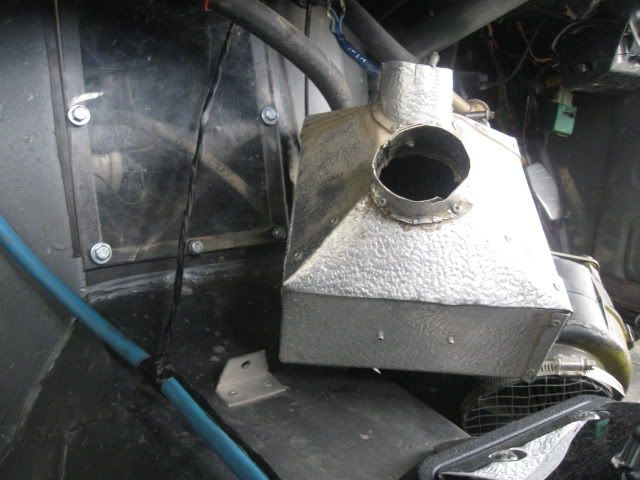

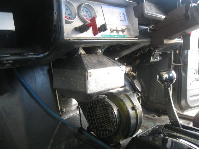

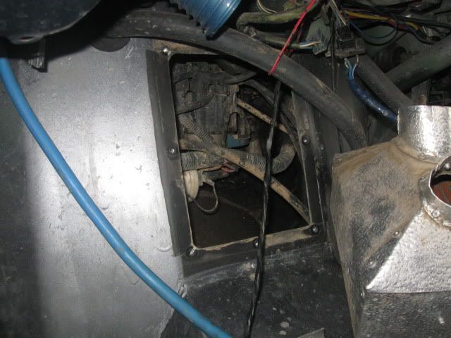

The springs are retained with hose clamps at this stage
One of the jobs today was have a go at getting to the dizzy, as I know next time it'll probably be pitch black in the bush he's done a mint job and made up a box which holds a small heater core, heater tap, and a 12v fan which all swings easily out of the way with hoses still attached by undoing 2 screws, then remove a plexiglass panel and you're in

Cool. He has put some thought into that

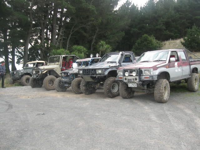

1st outing today, went up Worsleys with a buch of top fella's.
The plan was to take it easy and get used to the new sled, that was on the way up
had some fun on the way down
still grinning from ear to ear.....
What a hoot, was more fun than a rattlesnake down ya trouser leg
couple of pics of the day, but can't shoot and drive at the same time
