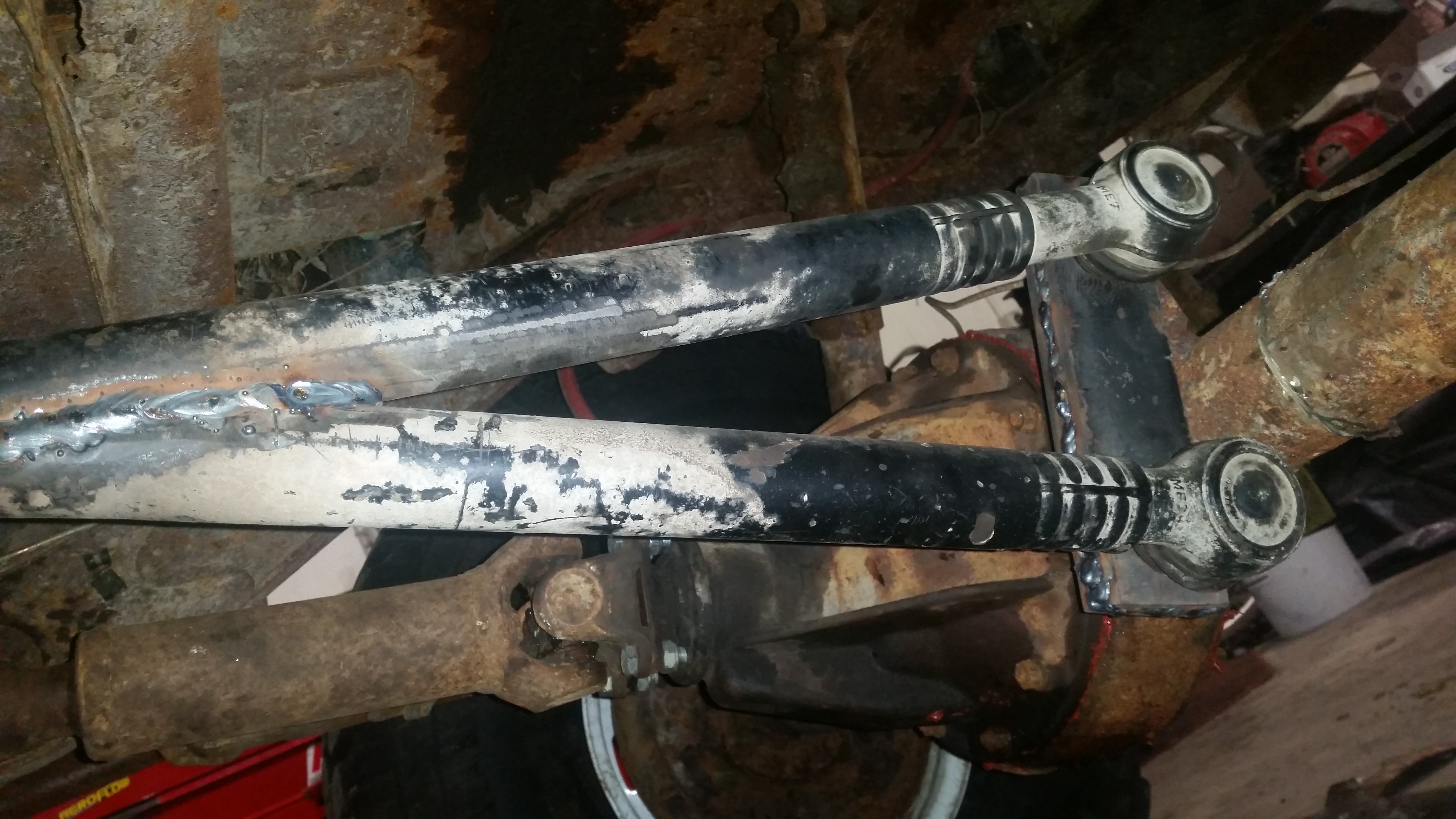

Hey man, I'd try and position the front pivot of the tramp bar where the front mount of the leaf spring is. I don't even know how it works at the moment cause it should just jam up looking at it. Also what angle is top UJ on? The bottom one looks straight so if the top one is on an angle it needs to be swapped for a double cardan joint otherwise you fatigue the shite out of your drive train. Another thing you can do is get the diff angle parallel with the gearbox out put angle and this will reduce the vibration unless the angle are very steep.

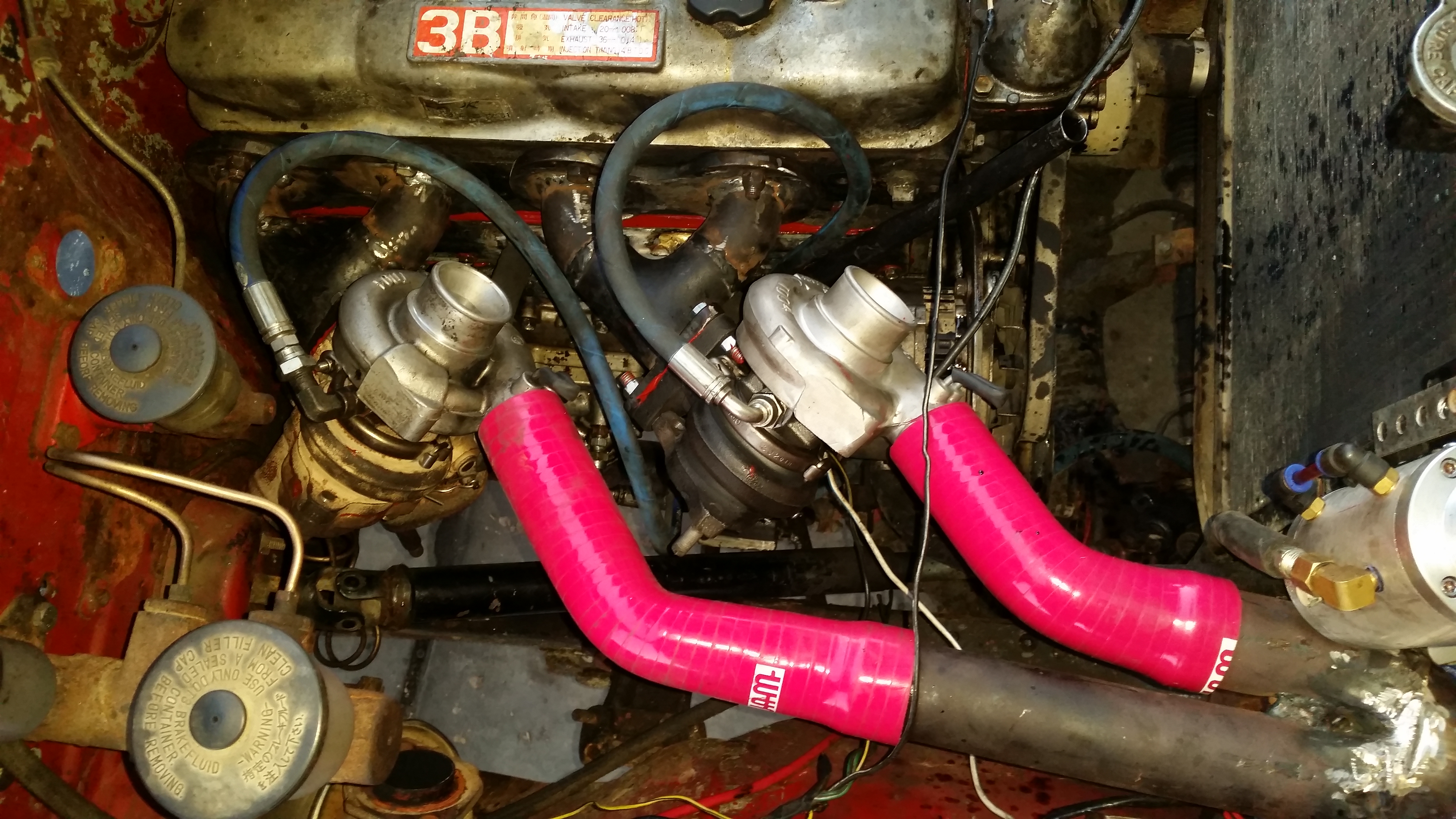

just fitted a 3b and turboed it and added a front mount intercooler. One turbo just won't do it so there will be another one added soon, just for the crack!
Re: FJ40 "just for bashing"
I wouldn't be doing that .. the 3b doesn't have the oil sprayers that cool the pistons like the 13bt does.. and all you'll do is fk it .. keep it low psi don't ask for much and it'll go all day everyday.. otherwise get another engine ready..
I'm fairly sure it does have the sprayers, it's a late Daihatsu built one. Anyway,if it does die then I'll just have to build it stronger next time
The turbo is a tiny thing off a 4d56 and is pretty much spooled up at idle, waste gate is set at 10 psi.
I'm going to run a pair of them in parallel one off 1 and 3 and the other off 2 and 4 to get even pulses and short small pipework to keep the gas speed up.
The ONLY reason for two is because someone said I couldn't do it

l made a bit of progress on the tramp bar last night. There is more work to be done on the axle case bracket but I don't think I'll be able to break those balljoints they are from a daf truck suspension link.

Twin turbo conversion is ongoing, it runs but I need to finish the intakes and exhaust.

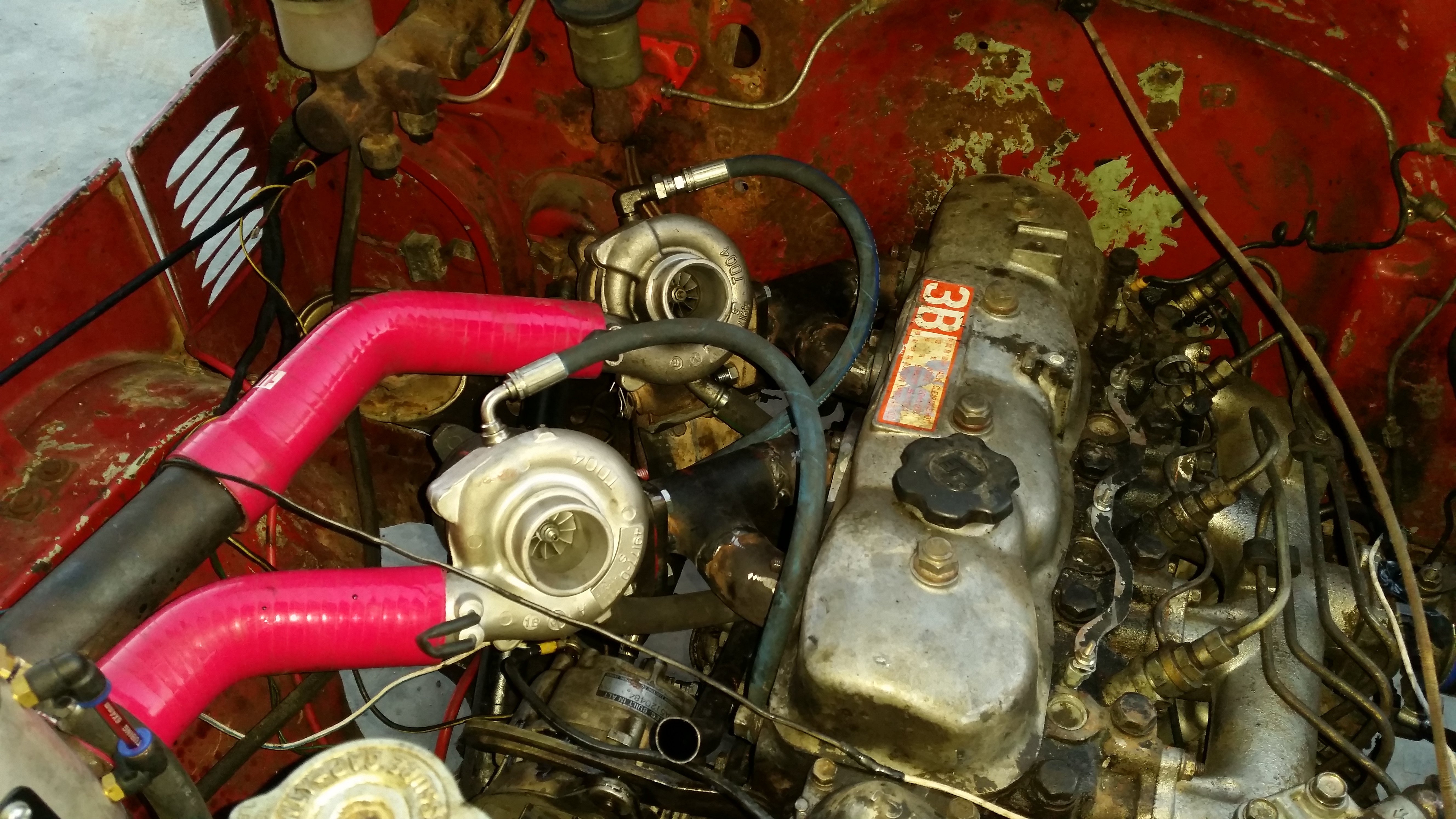

I've gone back to a single turbo and I had the sump off to fit a drain as I was getting a lot of oil out of the breather with it draining into the tappet chest.
It DOES have oil sprayers as I suspected

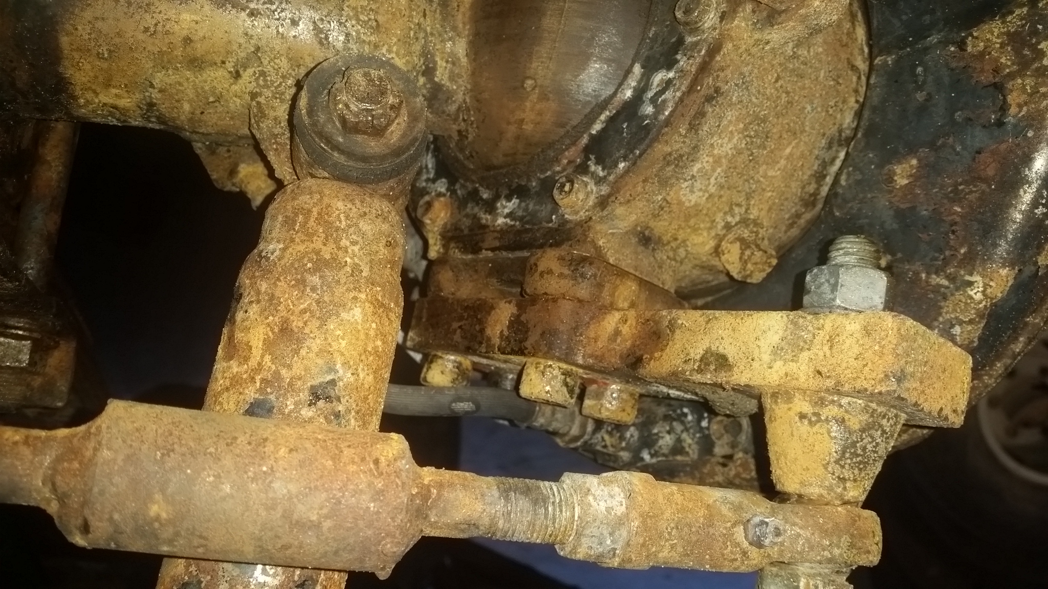

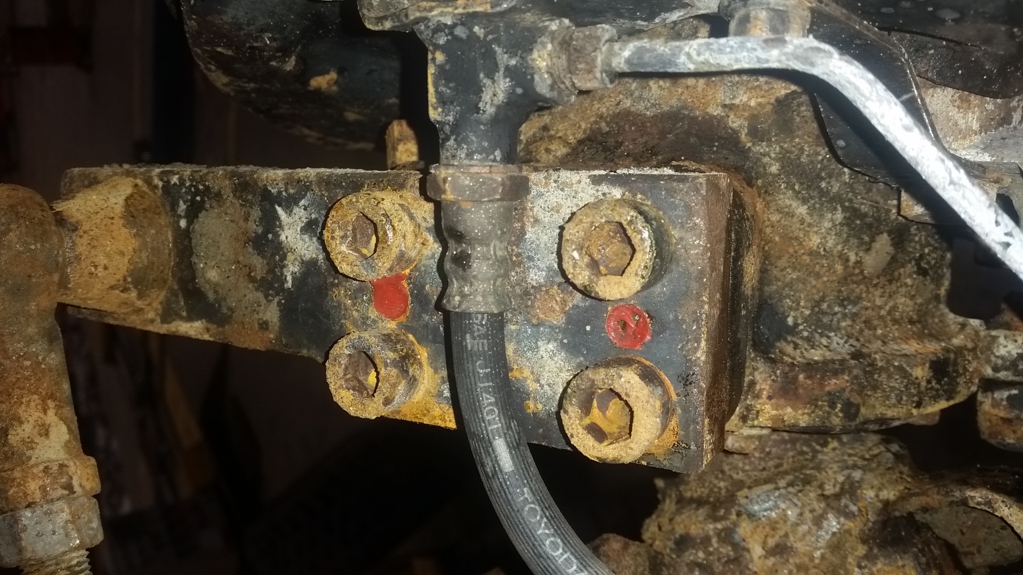

I got some snaps of my homemade steering arms too.
The blobs of silicone cover up two 10mm dowel pins that run down ito the knuckle.

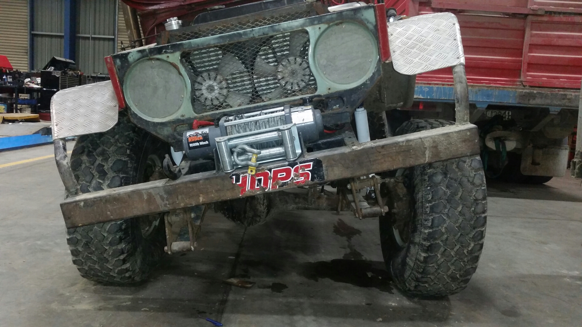

More detail of the legacy power rack installation.
You can see the pair of cooling fans in pusher mode so they can't hit the radiators if/when I drown them. I found a cheap winch too:)

It might happen again, if I can get it reliable with the single. I'll have to make a different exhaust manifold joining 1 and 3, and 2 and 4. Hopefully that will stop the pulsing.
Its getting hot now, I think the rad might be blocked internally so it will be out for a spot of flushing and/or replacement this week.

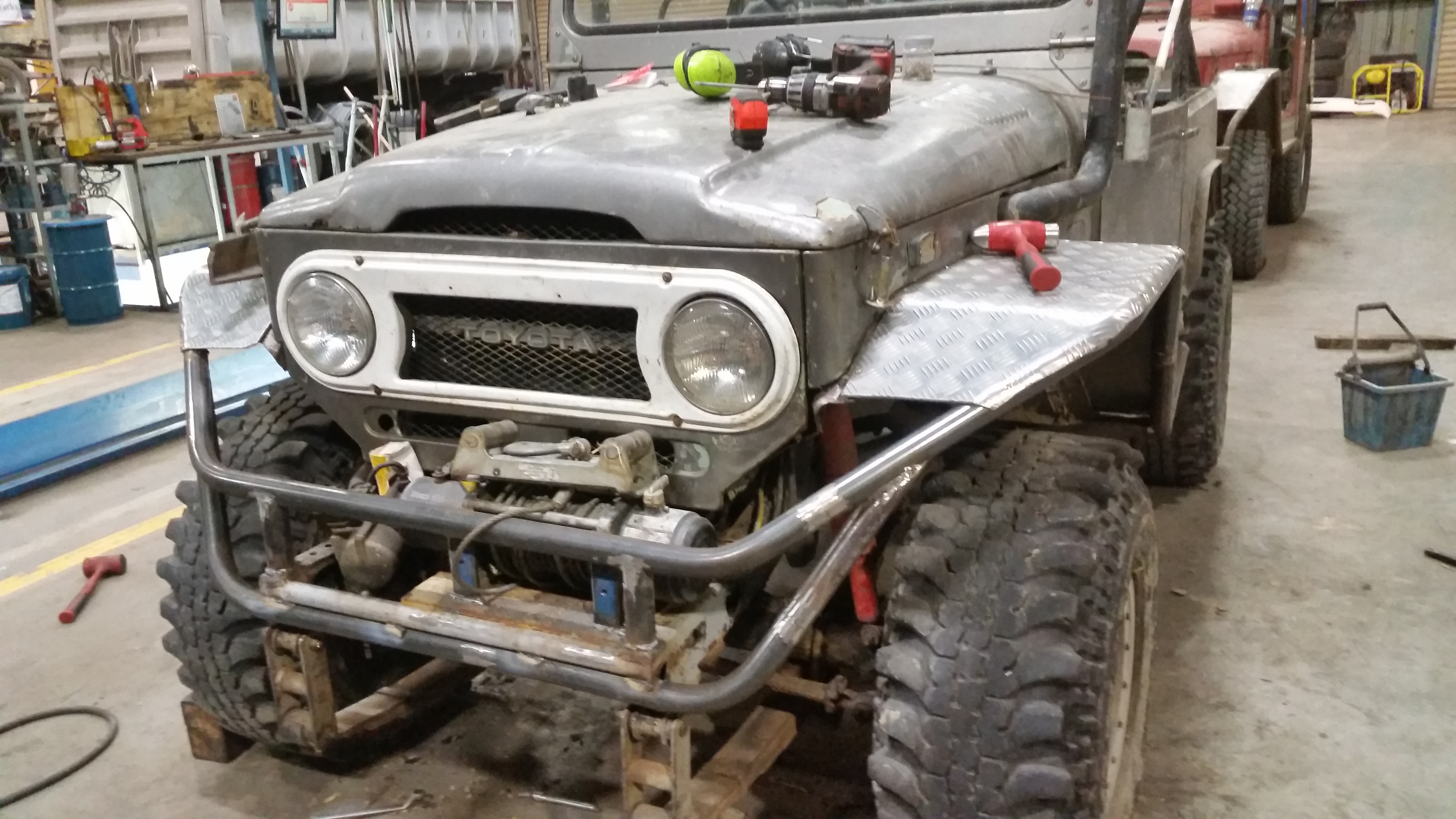

Made up some new front guards for a mates fj40, they have come out better than my ones still not a patch on Tom's work though!
Thoughs guard look good. Might have to borrow that design if I ever redo mine.

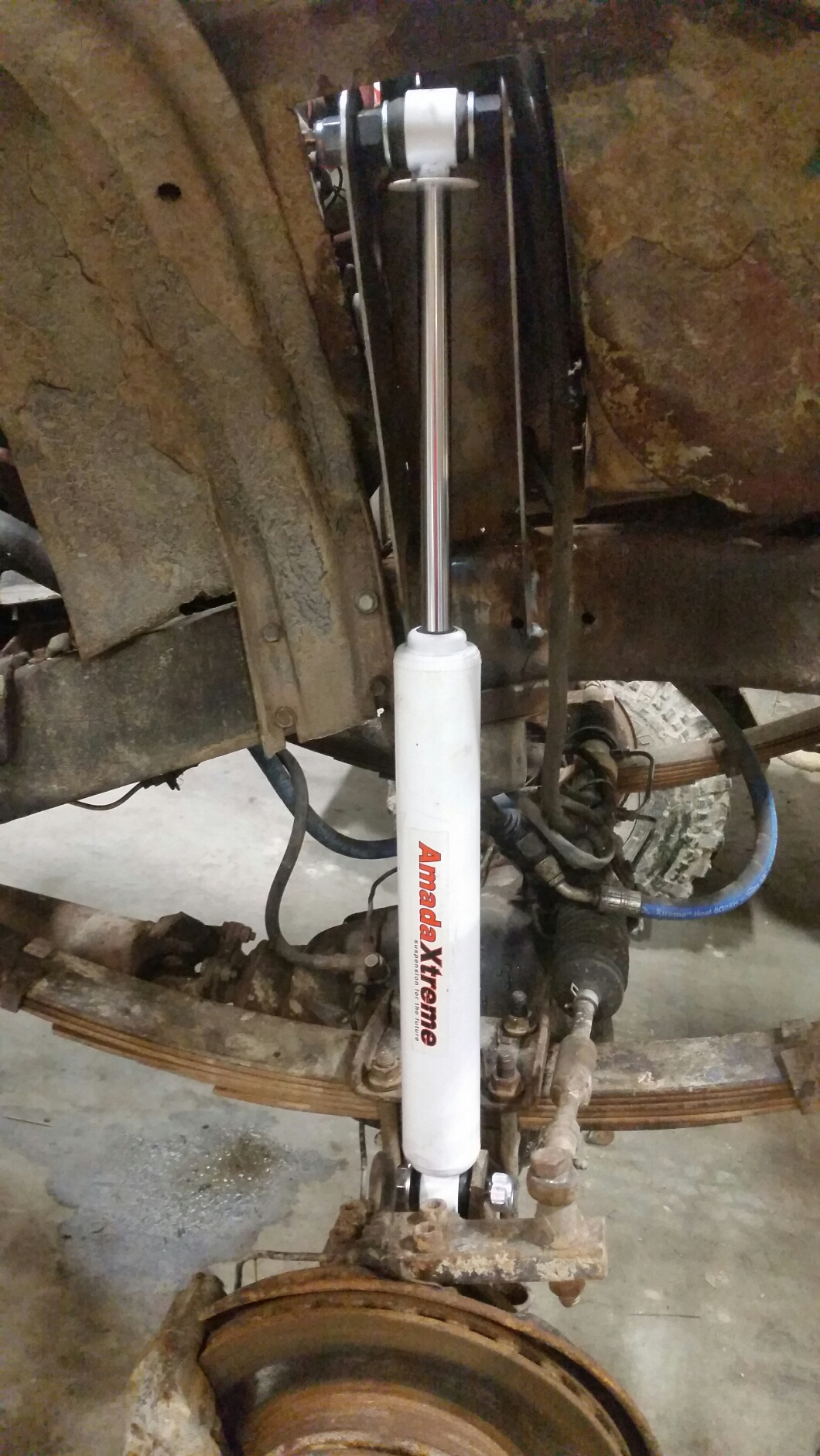

New shocks going in, thanks to Tom's offroad. They are rear GQ +6 inches!
That's pretty much 300mm of travel all used up ☺

Bro you need a longer shackle at the chassis end of torque rod
tomsoffroad wrote:Bro you need a longer shackle at the chassis end of torque rod
Is this any better?

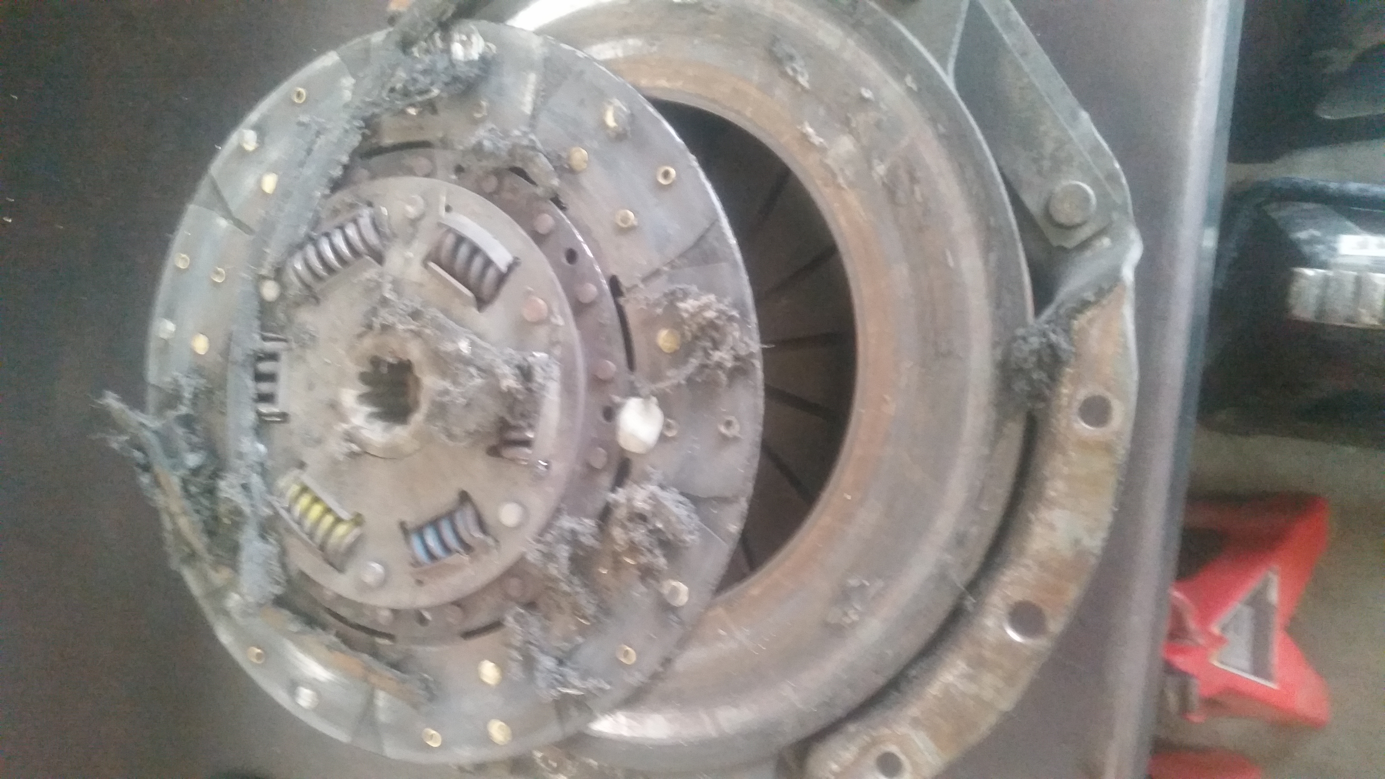

I've been neglecting the 40 as I have been doing the 45 instead but as I have a long weekend on call I have dragged the truck to work and pulled the box out to fix the clutch. Unfortunately it has got a petrol coarse spline plate in it as it's been converted from a 2F to a 3B-T. I should have remembered as I did the conversion! Now I need to find a clutch plate on Easter Sunday
